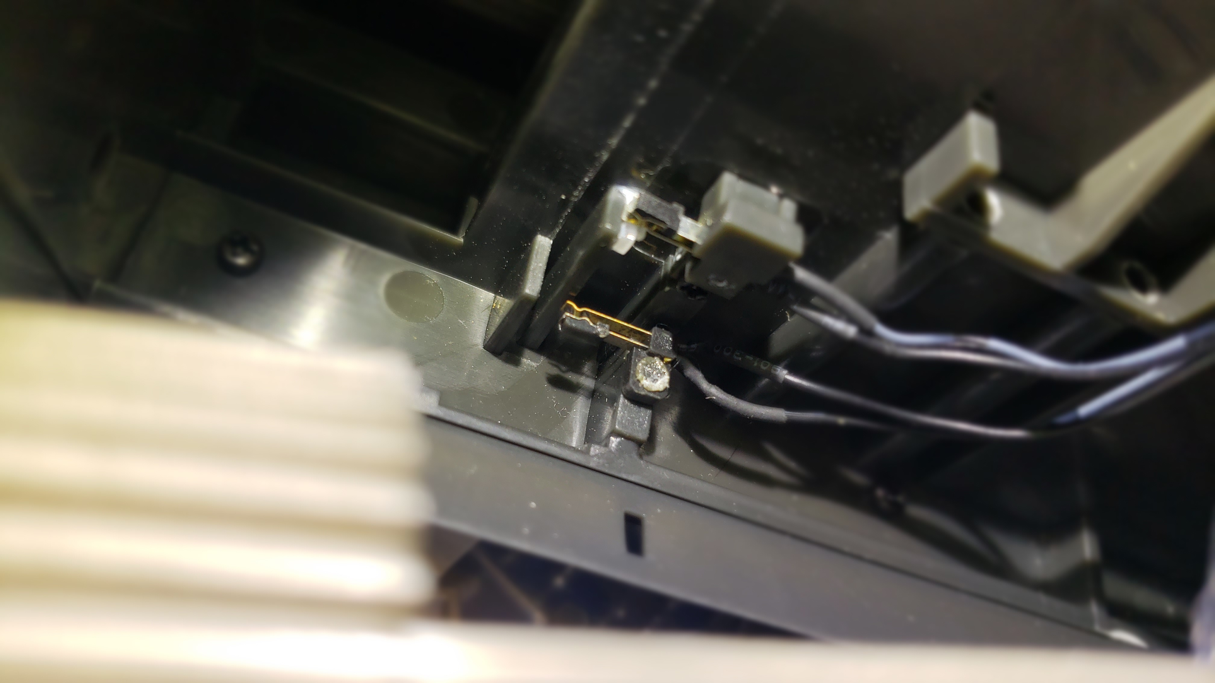

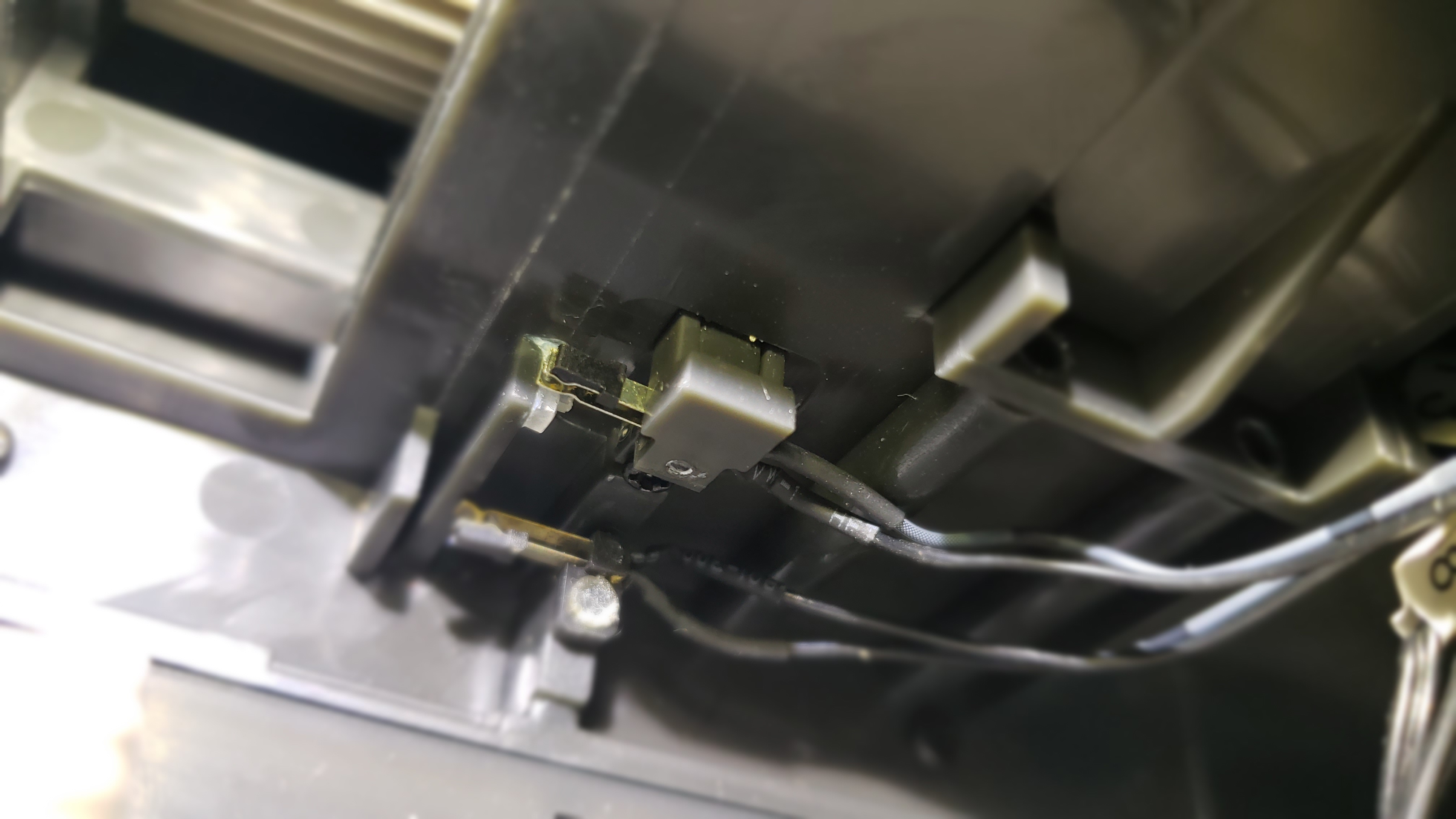

I wanted to give you an update - Sorry for the delayed response but work has been out of control lately.
I was able to get the circuit board to work - but I now have another problem.
When I press the center button the wings want to keep opening and won't stop.
At the moment I can't close them and seems to be only 1 direction (open), The button on the craft seems to stop the opening process. Only the right side (Gear side) opens and the left side does not open - it moves freely. Did I miss something. I took the rods out that hold the wings and re-positioned the wings again and checked the sensor (looked at it),put it together and same thing happens.
Thank you,
Jeff

#12 Posted : 07 December 2021 03:06:49
Groups: Registered, Forum Support Team Germany, Official Builds, Tech Support, Moderator, registriert, Administrators
Joined: 27/09/2016
Posts: 73
Points: 209
Location: Berlin
Hello jllaclair,
Please have a look at the link below, I think the limit switches are reversed or not working properly. Please also check whether the wings are in a line. we also made a video about it

All wing parts should be interlocked, if the wings should move freely, your transmission is broken one of the gears no longer has any teeth.
please check this. but one of the four wings cannot move individually,
you can show subtitles on YouTube and turn on the translation function.
Your limit switches look good. please check whether you have swapped the plugs on the circuit board

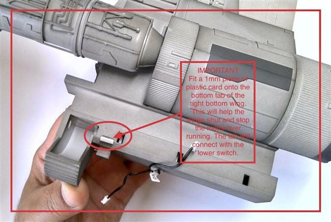

#15 Posted : 07 December 2021 10:43:23
Check here on the official build for guidance on the shims as well.
https://forum.deagostini...uk/?g=posts&t=33711

#18 Posted : 12 December 2021 17:28:31
jllaclair wrote:
OK, thank you everyone for your help. I am almost there.
Fixed the sloppy wing issue and the wings stop to the open position. (not sure what I was thinking or doing when I was assembling it first time)
I am having the issue with them not stopping going into the closed position.
So I will follow the instructions on that page and see if it works.
Thanks,
Jeff
Hi Jeff
The shim should cure the over run when closing. Good luck.

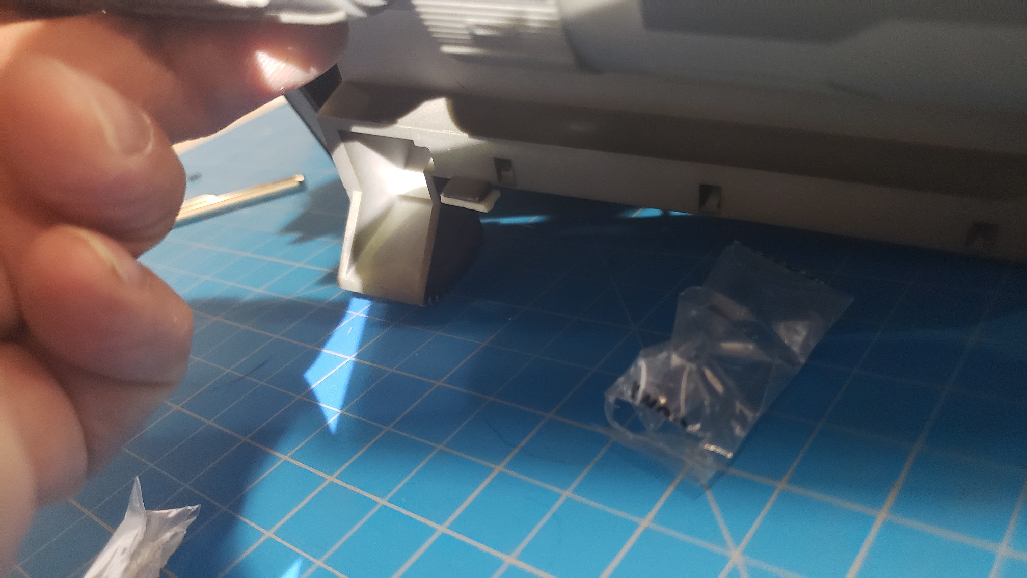

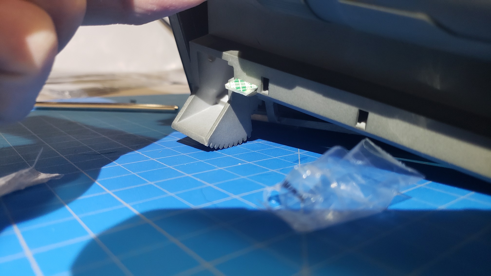

ok, I'm kinda getting to the point where I am getting fed up with this thing and just leave it in the open position. I've taken the wings apart about 1/2 dozen times. I have some pictures I've included... I guess some clarification is needed when they state 1mm board... what is "board"? Card board, foam board, Plastic??
I've attached a piece of 1 sided sticky foam tape as a test on both the bottom and top of this plastic piece and still the x-wing still grinds when closing.
#20 Posted : 14 December 2021 23:26:00
Here is a picture from the official build log. The shim is a piece of plastic card, 1mm and placed as shown in the picture. Hope that helps.
