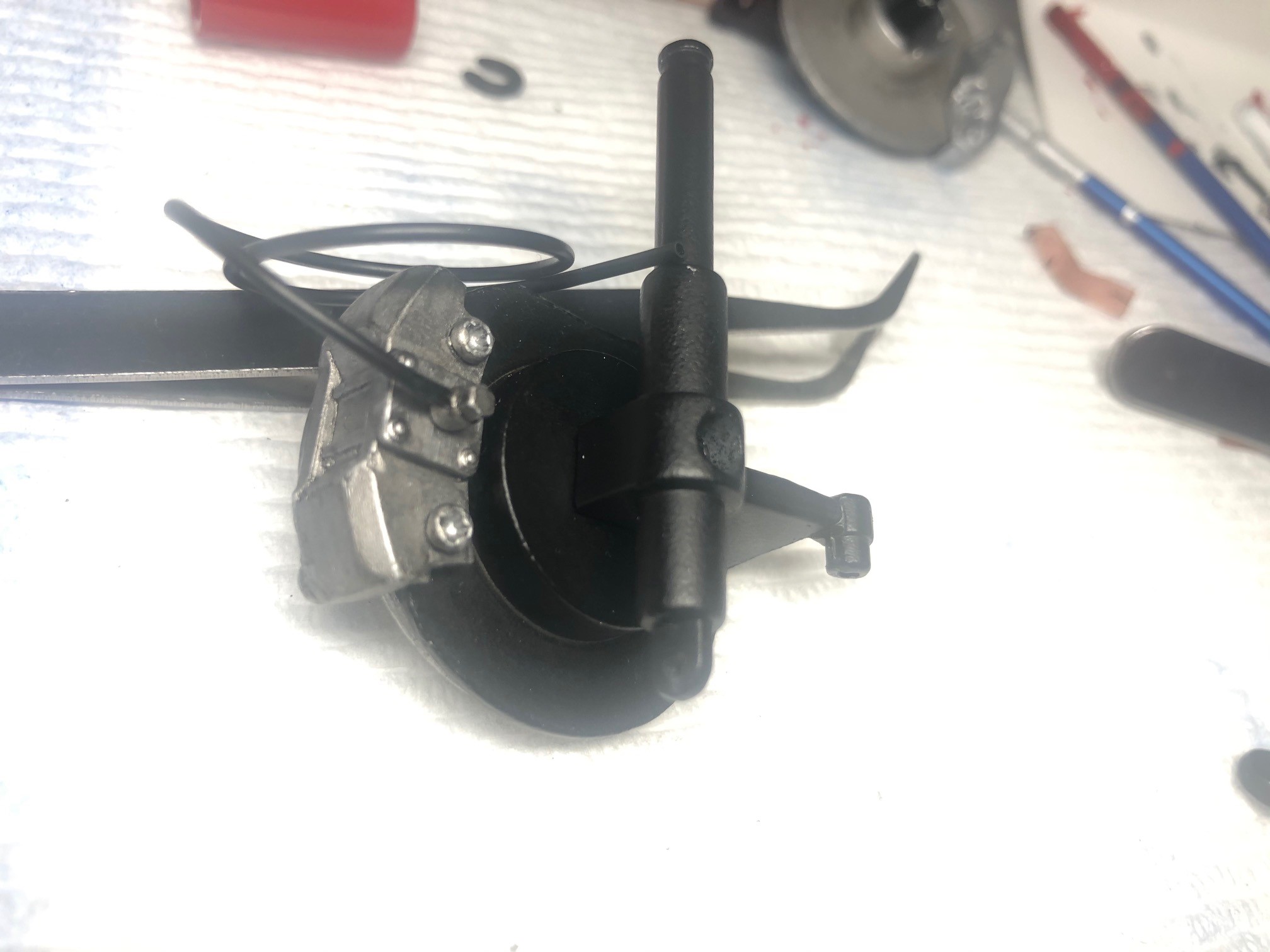

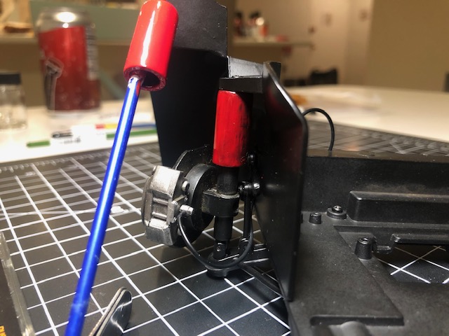

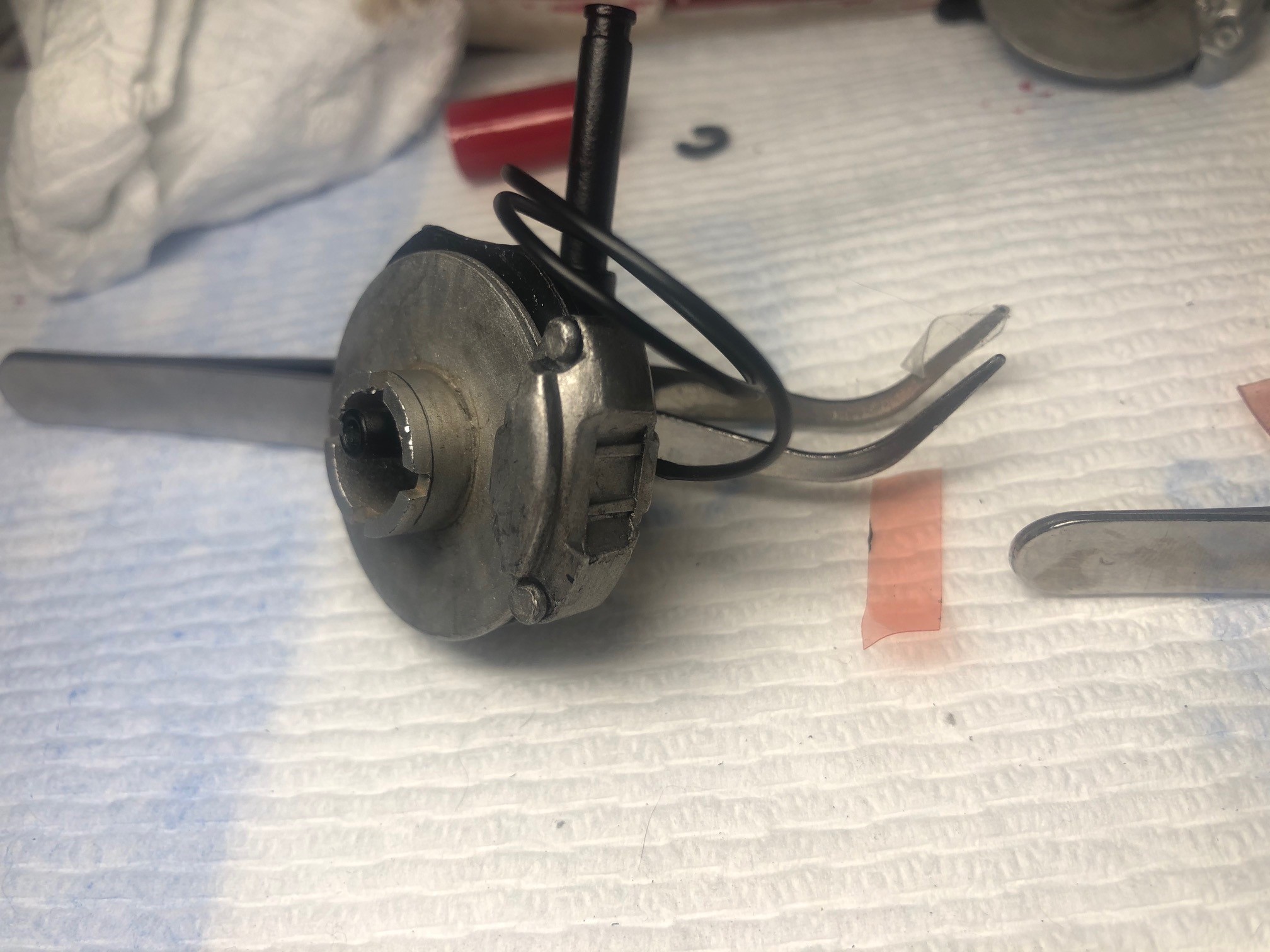

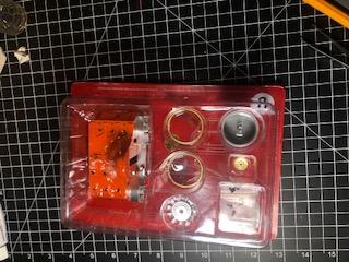

Well, I've owned a lot of cars, but this is my first Porsche LOL
This is also my first part work model, so I'm excited to see how this goes.
My primary goal going into this was hoping to avoid buying and setting up an airbrush and painting station. A small, mobile brush painting station is fine, as I would like to add some extra details and hopefully some mild weathering. It's been many years since I've painted plastic, and I've never really weathered. Fingers crossed!

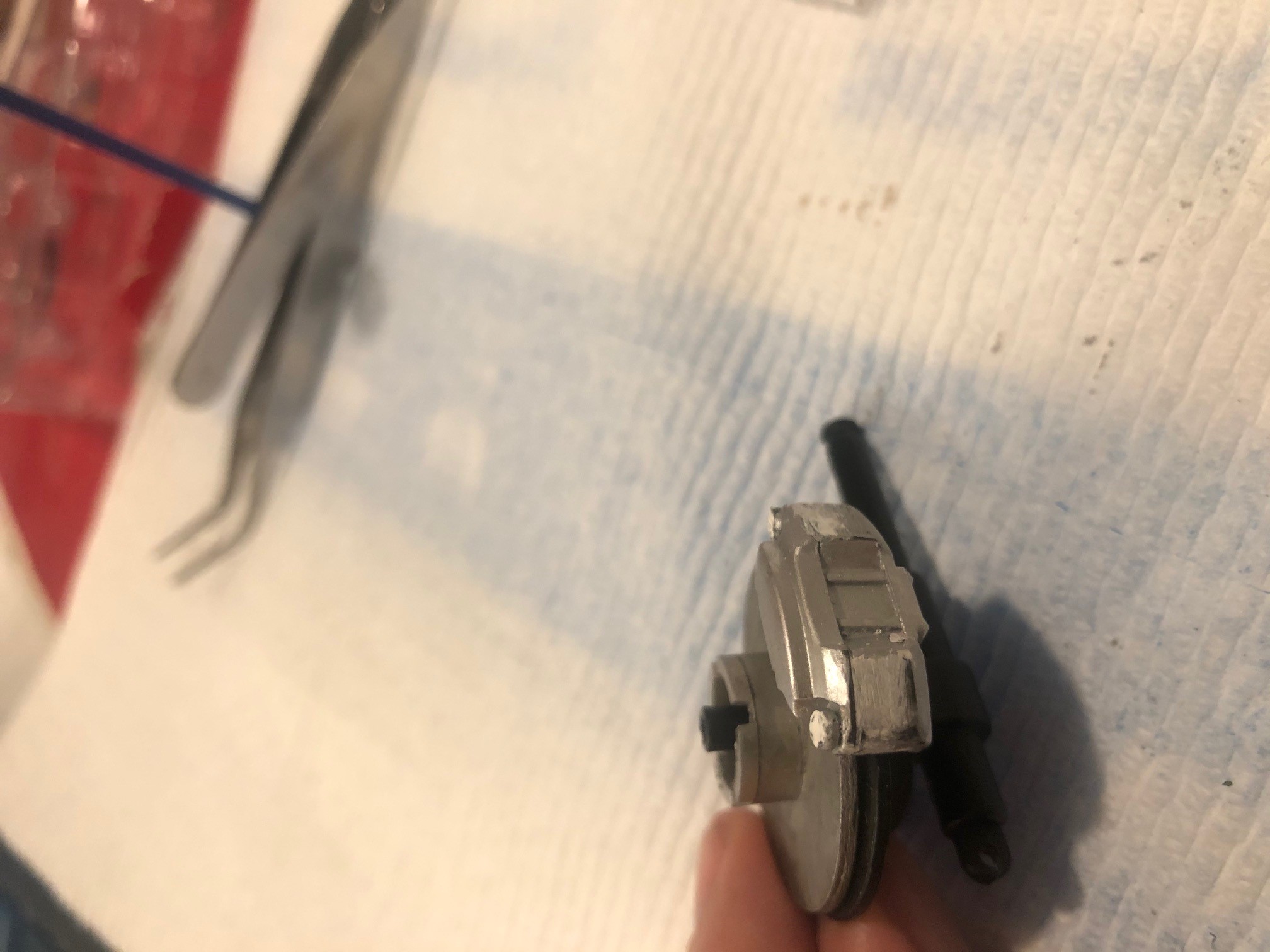

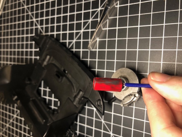

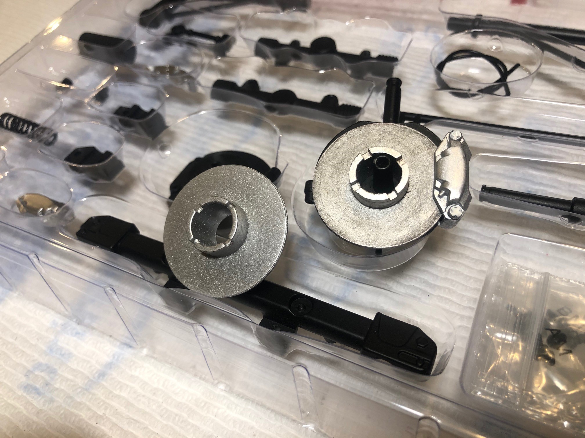

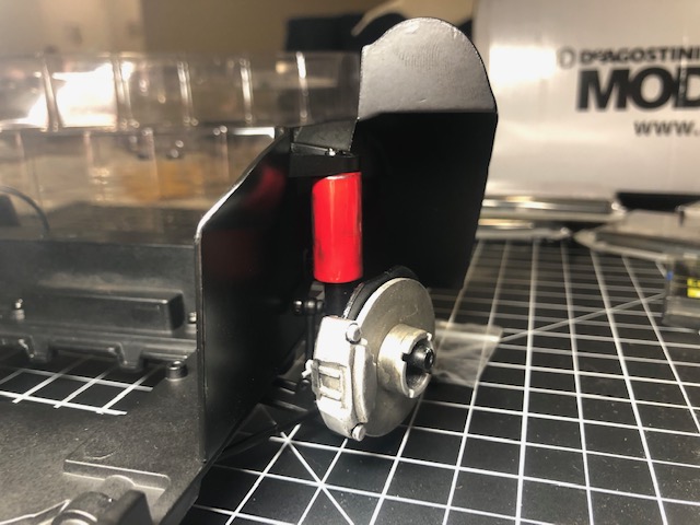

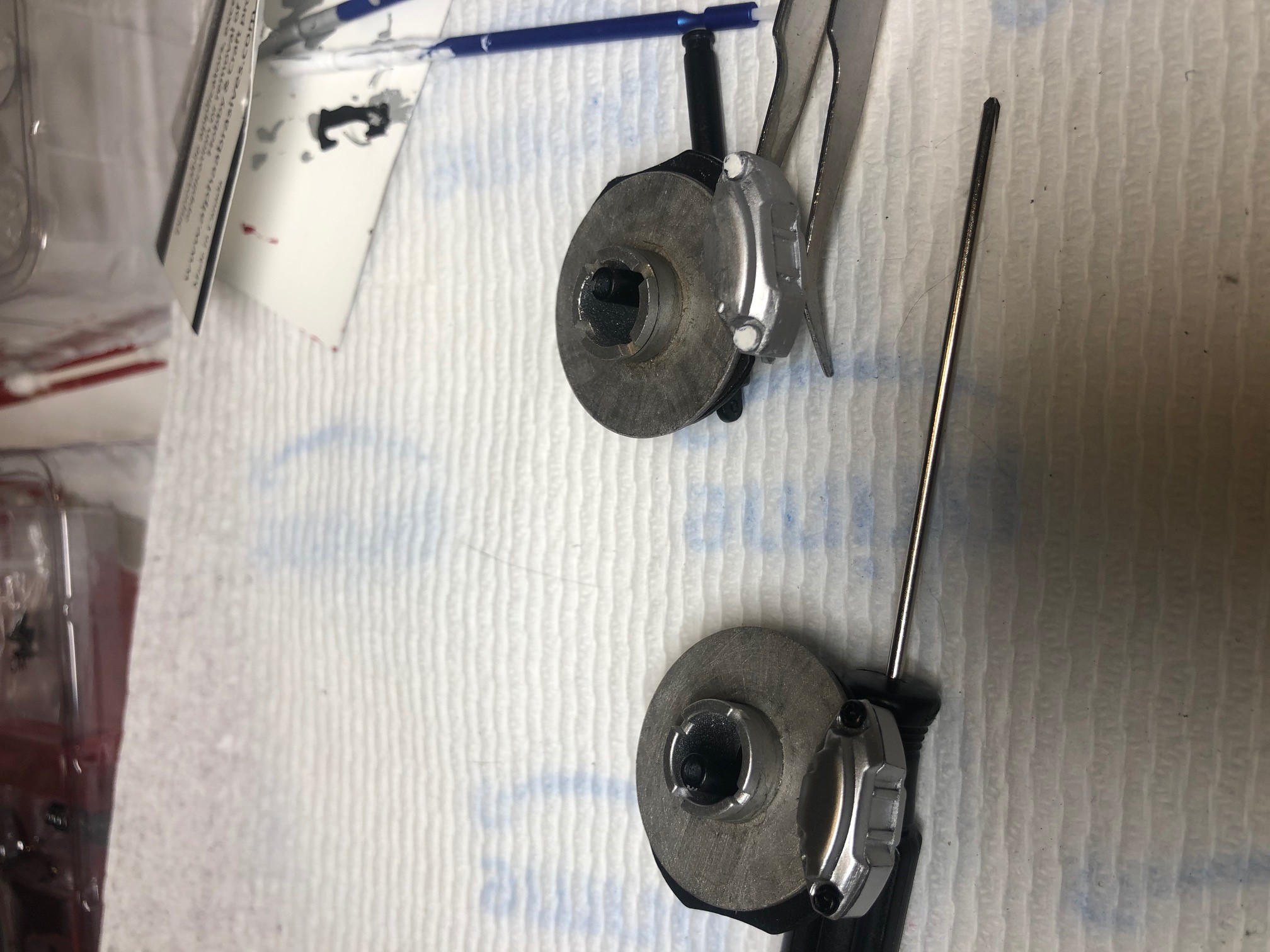

I started with the brakes first.
Caliper 01.jpg (314kb) downloaded 74 time(s).
Caliper 02.jpg (577kb) downloaded 67 time(s).
Caliper Putty 01.jpg (493kb) downloaded 58 time(s).
Caliper Putty 02.jpg (398kb) downloaded 58 time(s).

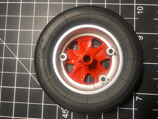

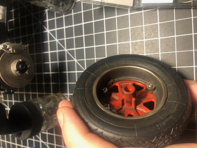

Thanks Roy! I think I hit the mark with the file sizes this time.

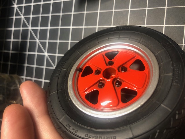

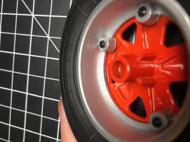

I'm currently still working on Month 3, so a decent amount of progress has been made.

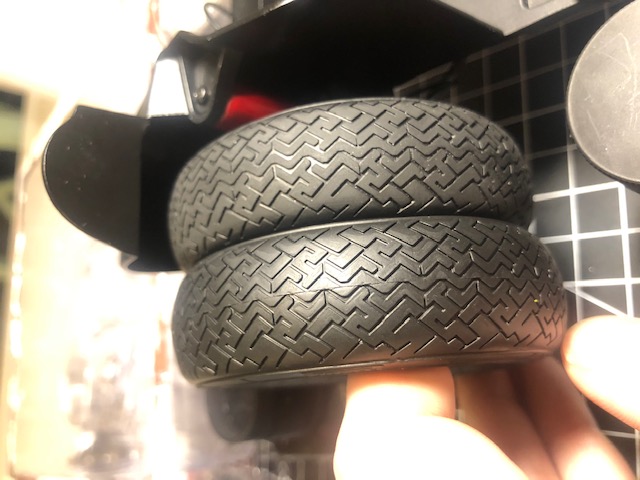

I started out all brush painting, and I wasn't very happy with the end results on the shocks until I weathered them. So, moving forward I have switched to rattle cans for painting larger parts, and will probably end up with an airbrush before too long.
I have a small issue with one tire slightly popping out of it's rim, and wont hold itself back in when pushed. But, it's on the back of the tire, so not too big of a deal.
You can see the before and after weathering and sanding done to the front wheels and tires.
bfam4t6 attached the following image(s):

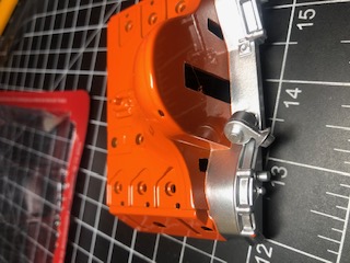

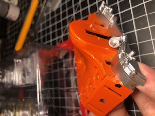

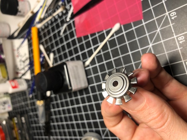

And finally on to more exciting things, the engine!
The top half the engine did come with some minor paint damage, and a little flashing on the plastic bits. I've touched it all up.

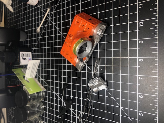

Here are a couple of the reference photos I've been using.
Of course Roy's Custom Build Thread has also been a great guide. I've painted the fan housing rear black as he suggested. Also puttied over the screw hole in the fuel pump.
This shows my first attempt at making hose clamps from aluminum foil and double sided tape. You'll see I changed them later.
Here are the coils before I cleaned them up.
The injectors needed some clean up too
All Sanded
Painted with Tamiya Flat Aluminum

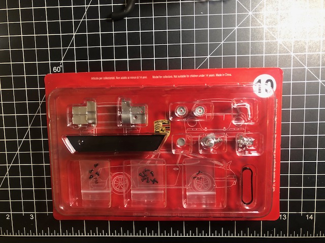

The 3rd month shipment was nice to get, and really put the whole size of the car into perspective.
This piece was a little warped, but I'm sure it'll straighten right out upon being screwed down.
These all needed some sanding.
Modified to match the real car. I'll be adding small studs and nuts to the four corners as soon as my next shipment of micro hardware arrives.
This is the necklace/leash part of a kid's toy whistle that I cut off and soaked in brown wash to be used as hose wrap.
Test fitting. Still original aluminum/tape hose clamp. Wrap in place.
Not the final product, still playing around. New hose clamp from Model Motorcars on the left hose, modified with aluminum foil and .6mm hex screw
The final product.

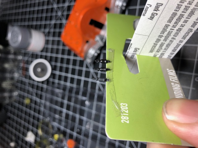

I decided to add studs and bolts to the manifolds and throttle bodies. Studs were 1mm and 1.2mm brass threaded rod cut down and sanded, with respective hex nuts added, then super glued in place. Even with hardwood floors and a good LED light, I still lost a couple bits. I had to buy a new pair of fine tweezers just to hold on to these bad boys.
Started adding spark plug wires. Might need to trim them back a bit still.
