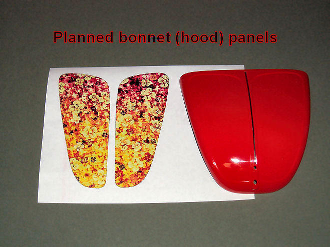

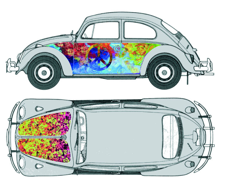

The picture below is to give an idea of the custom paint scheme I will be using by making waterslide decals.
Don't worry - I will provide full size art for anyone to freely copy and print their own decals if they wish.
There will also be a much simpler two-tone colour scheme in case anyone doesn't want to go too wild...

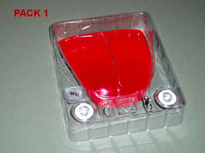

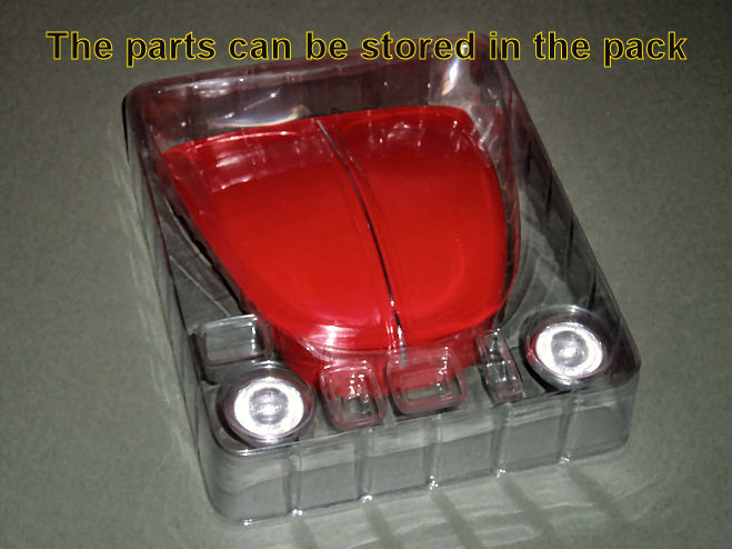

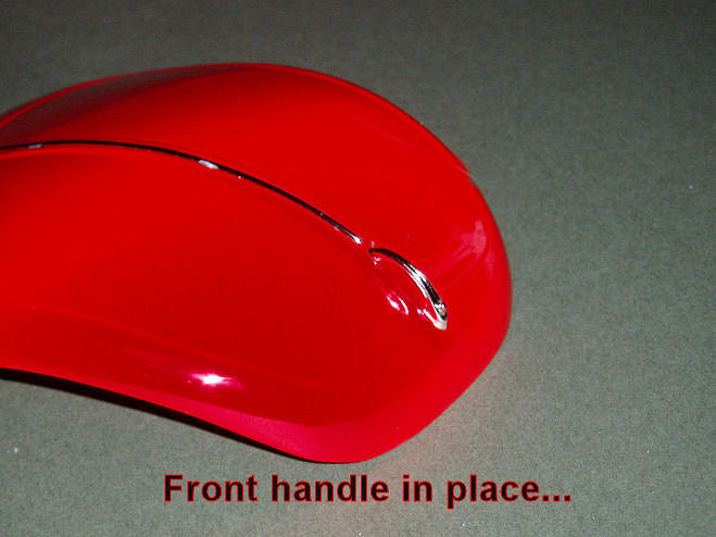

STAGE 1
The build begins with the bonnet as we call it, the hood over the pond. (When you think about it, both things are hats, and as it isn’t fitted yet, I suppose it’s ‘hats off’…)

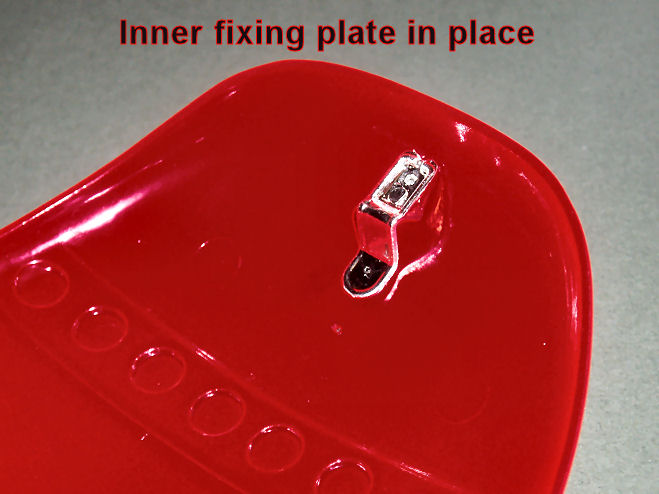

Anyway, the assembly of this part is very straightforward but the pack comes with the front lights which aren’t needed yet.
For safekeeping, once the front panel is assembled, put it back in the original package.
I’m going to make some water-slide decals to replicate a custom paint finish later on but I’ve shown the artwork below.
I will be posting full size art for anyone to use a bit further along.

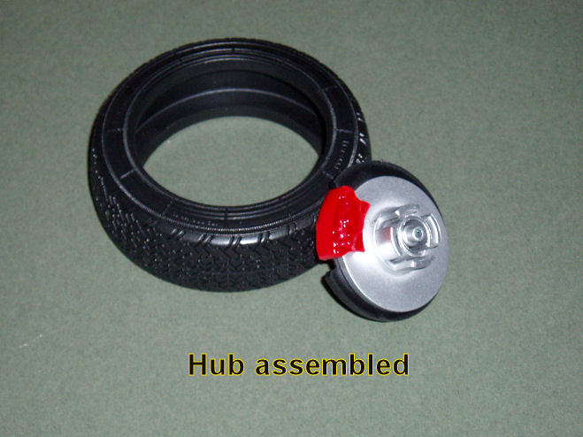

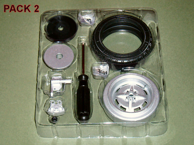

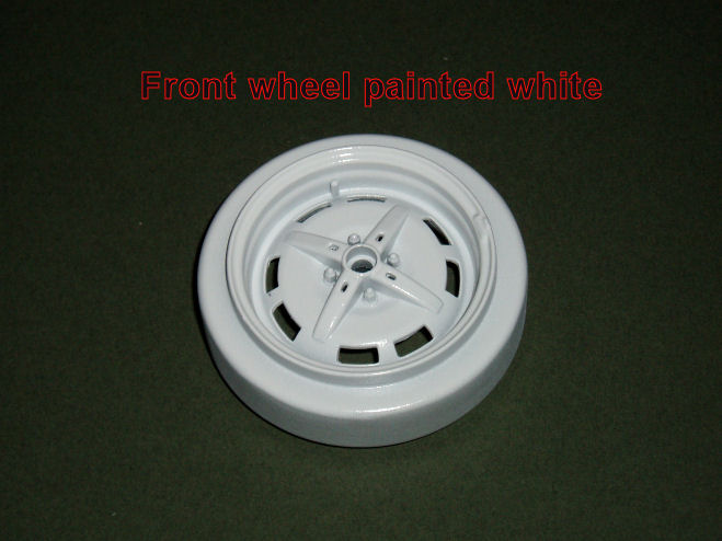

STAGE 2

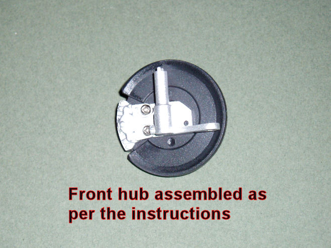

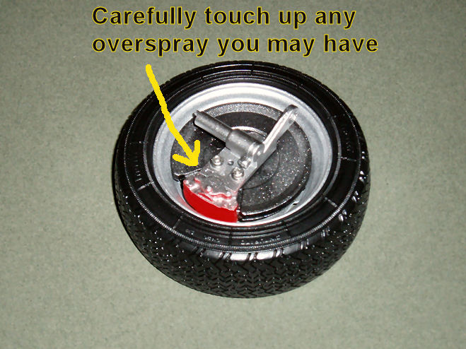

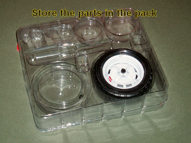

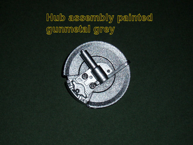

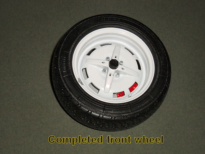

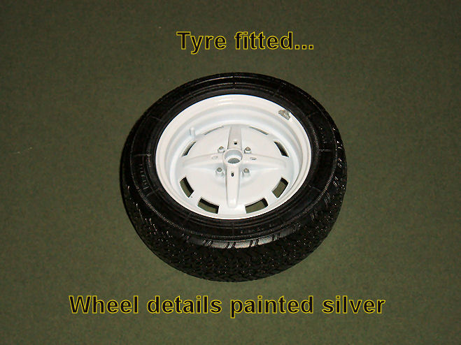

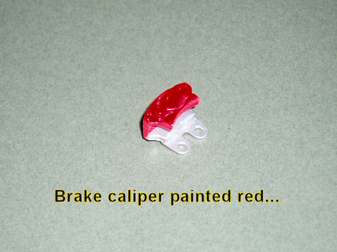

Pack 2 contains the front wheel, tyre and hub/brake assembly with the disc or rotor (a ‘pond’ thing again.)
The first thing that can be done here is to paint the wheel a different colour if you are going for a customised look.
Frequently, wheels were painted either white or gold as it was a far cheaper option than buying alloys or mag wheels.
The wheel part can be primed with a good automotive white primer, followed by an auto gloss white. The details can then be picked out in silver.
To fit the tyre, soak it in boiling water for around 5 minutes. Dry it, and you will find it goes onto the wheel with no bother whatsoever.
The brake caliper was painted bright red and then the hub was assembled.
Custom car fanatics don’t only ‘trick’ up the visible parts. Very often pieces not often seen will also get a makeover so I painted the rear of the hub assembly a darker graphite silver.
Then, the wheel and hub were assembled together.
As before, store the parts in the original pack for safekeeping.

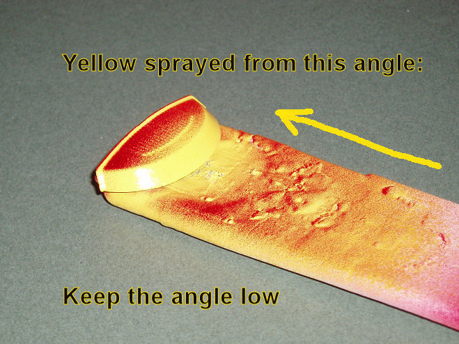

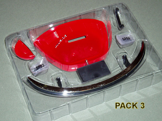

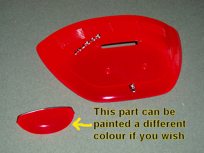

STAGE 3

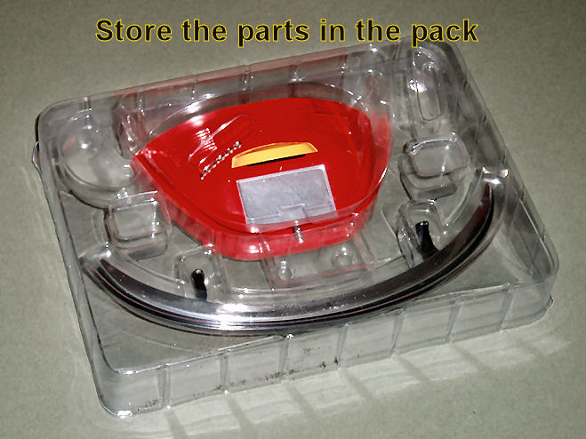

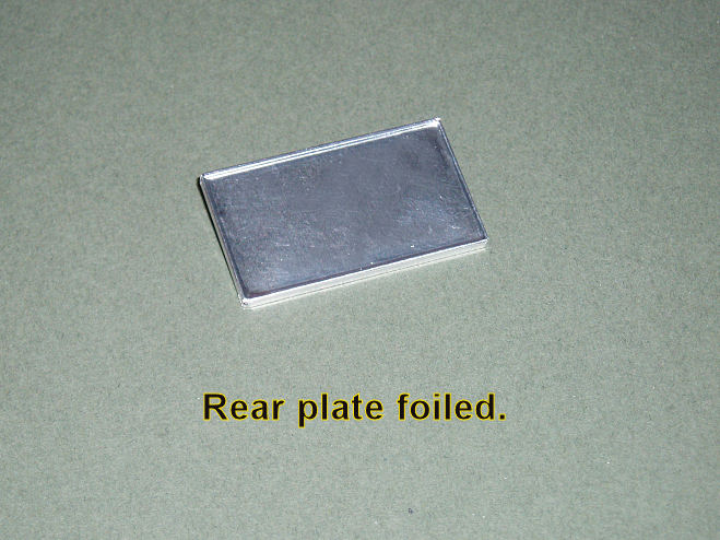

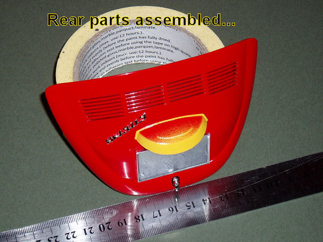

This set contains the engine cover parts.

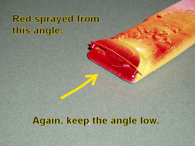

Again, assembly is very straight forward but I decided to make the lamp cover a bit more interesting by spraying it a ‘sunburst’ red/yellow.
It was done very easily by sticking the part to a wood strip using sticky-tac. (A kind of adhesive chewing gum, but don’t eat it)
The part was primed white first, and then the yellow was sprayed on at a very low angle from one direction, meaning that it was painted predominantly in one area and not that a certain musical crowd had anything to do with it.
The part was then sprayed red from a similarly low angle but this time from the opposite direction.
Result – a nice sunburst effect that will go well with my later body colour scheme.

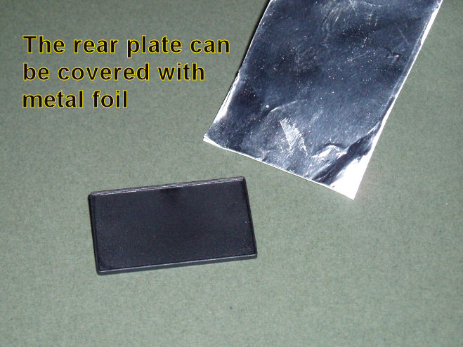

The licence plate was covered in real aluminium adhesive foil which can be bought in large rolls from any bargain shop. My 10m roll cost a whopping 99p.
The engine cover was then assembled according to the instructions and was again, stored away in the original packing.

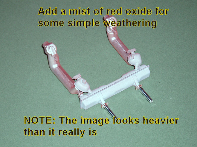

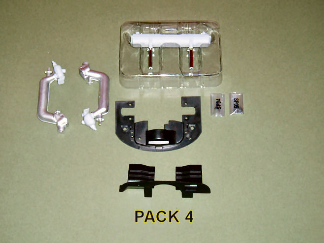

STAGE 4

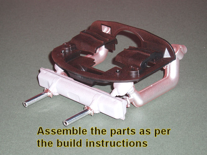

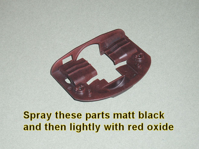

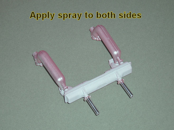

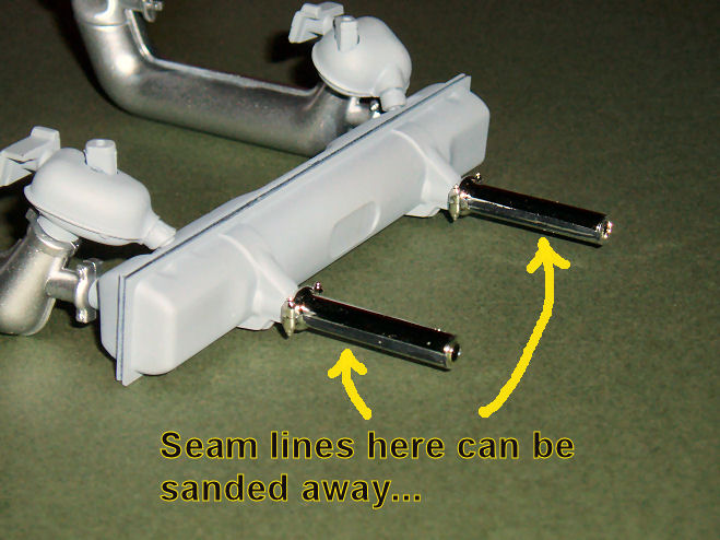

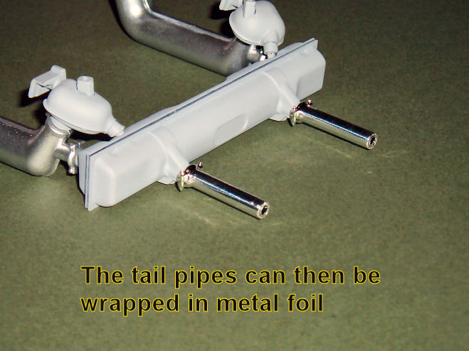

This pack contains the engine compartment floor and the exhaust system.
All of these parts go together easily but you might want to remove the mould seam lines on the chrome tailpipes as they do notice.
A light sanding will do it and then the pipes can be wrapped in metal foil and polished.
Now – a subject that many people shy away from.
Weathering.
I do not intend to go overboard with highly realistic weathering, washes, oil effects etc as the purpose of this build is to make a custom model that anyone can manage so I intend keeping the weathering simple, yet hopefully, effective.
When building large model cars you really can’t do much better than giving certain areas a light misting of spray red oxide paint.
Please note that the photos below tend to make the effect look very heavy and dark. In reality it is not like that at all. The misting is quite light.
Of course, those of you who wish to fully weather the parts will no doubt be well aware as to how you can do it.
For now though on these parts, the red oxide is enough to give the appearance of dust and surface rust.
Store these parts carefully as there is no moulded packaging to keep them in.

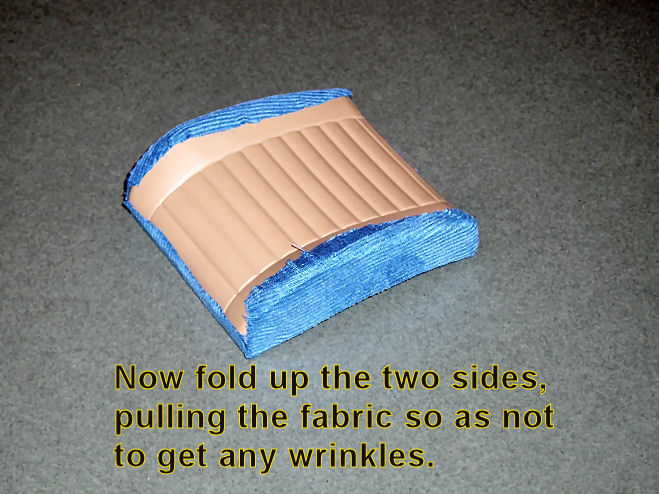

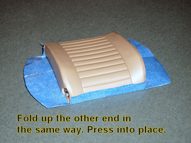

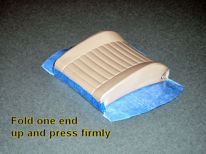

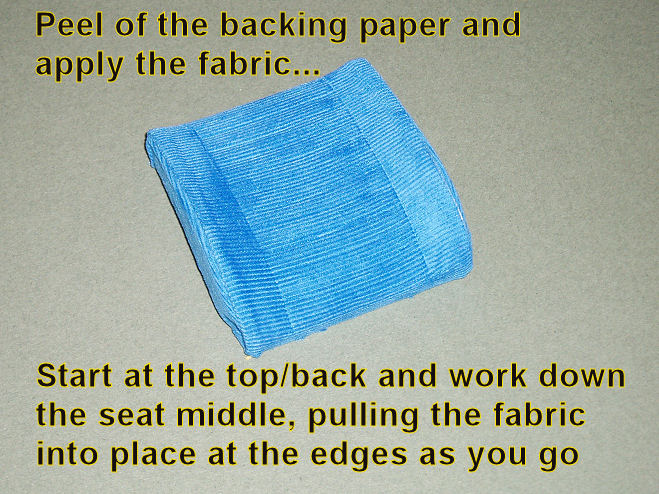

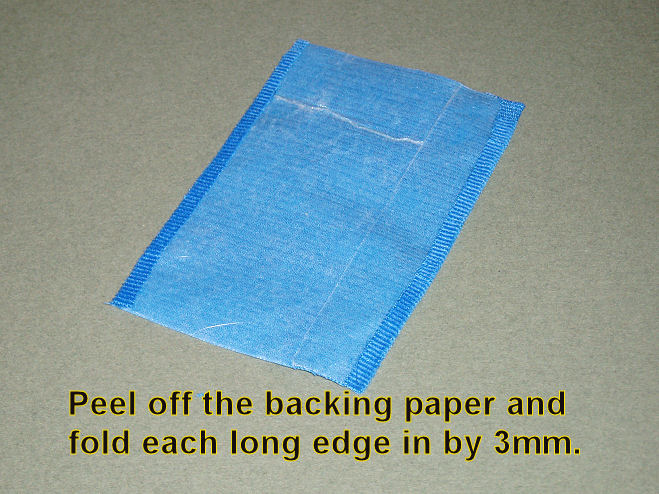

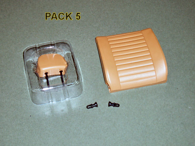

This stage contains the first parts of a front seat.
The seat parts can be left as-is, or they can even be painted with special vinyl paints that you can find on the net.
I shall be trimming my seats in fabric although you could use very thin leather – the method is exactly the same.
I shall use what is known as ‘Baby needle-cord’ as it is extremely fine and looks in scale for 1/8 models.
Also, I’m not sure that many Beetles would have had real leather trim – correct me if I’m wrong.
I will also show later on, how custom bucket seats can be used to good effect on the model.

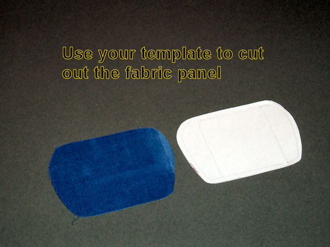

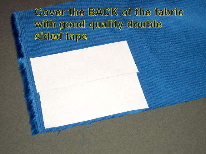

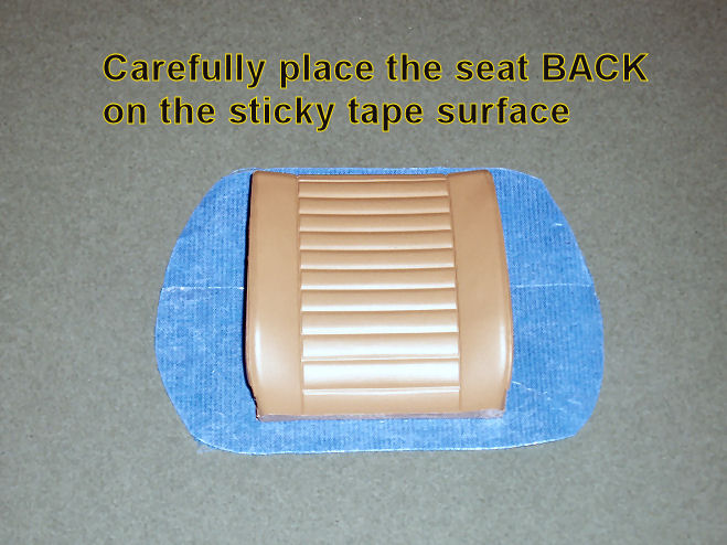

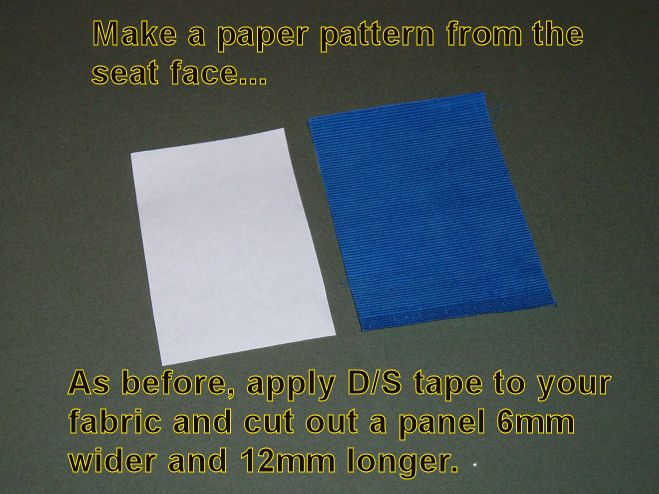

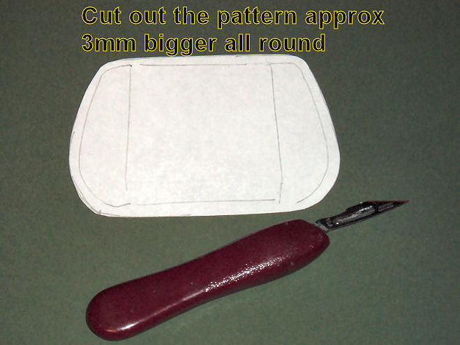

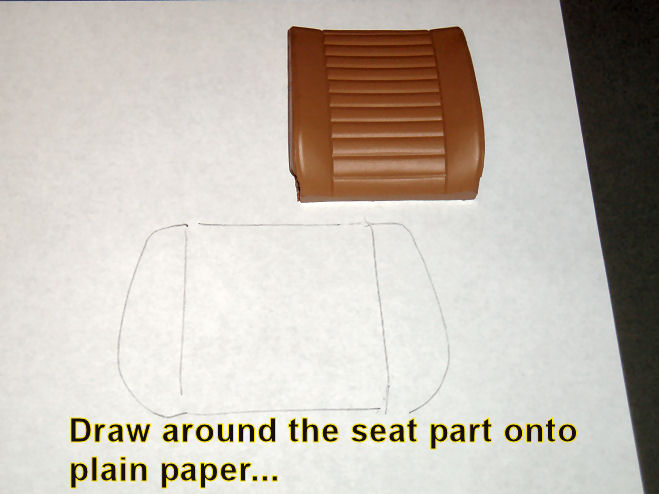

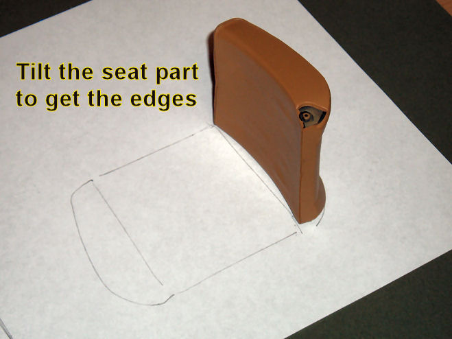

First you will need to make paper templates of the seat back/sides, and another for the seat face.
This is done by simply drawing around the parts onto plain paper. Don’t forget the seat sides, as part of the back template.

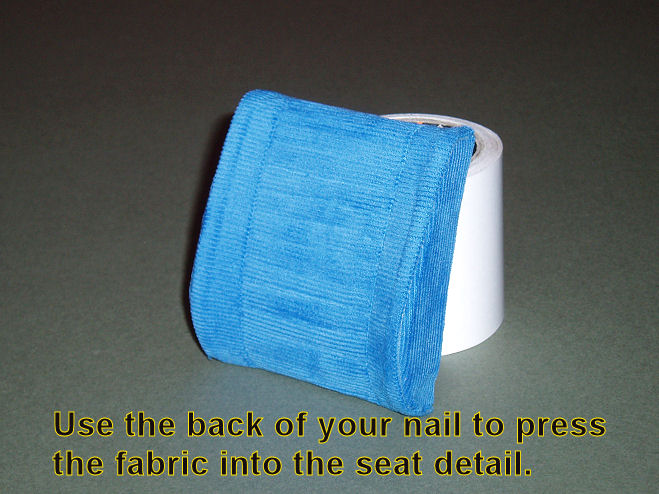

Apply a very good quality double sided tape to the back of your chosen fabric.
Use GOOD D/S tape. You don’t want it starting to come apart in a few months’ time.
Lay your template on the back of the fabric and draw round with a biro.

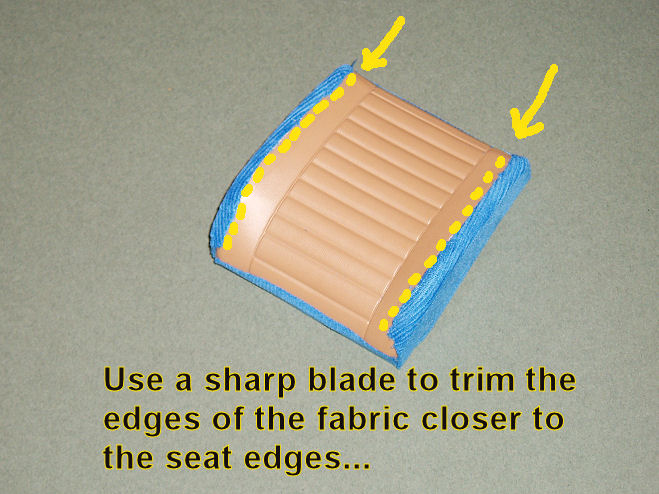

Cut the fabric out with a new blade so you don’t get stray ‘fluffy’ edges.

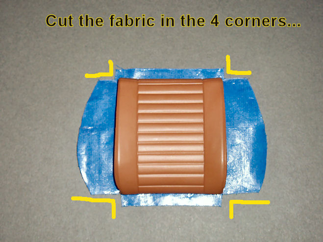

Stick the seat back to the fabric and then cut the material as shown in the pictures.
Fold the fabric into place, again following the pictures.
Cut away excess fabric on the seat face with a new blade but leave about 2mm overlapping the seat front.
Make a similar template for the seat face, allowing about 3mm each side wider, and around 10-15mm longer.
Transfer this to your fabric as before.

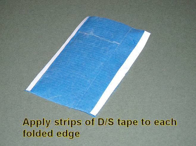

Peel off the backing paper from the tape and very carefully fold in the long edges by around 3mm.
Apply more D/D tape strips to the newly folded and ‘bare’ fabric.
Peel off all the tape backing and starting at the very top/rear of the seat face, stick the fabric in place.
As you work down the front, apply the fabric in the centre first, pulling the edges out tight as you go to remove any creases.
When finished, stick the end of the fabric under the bottom of the seat part and cut off any excess hanging at the rear.
Use the back of your nail to press the material into the seat detail.
Later on, I will show you how to cover the head rests but I won’t be using them on my build.

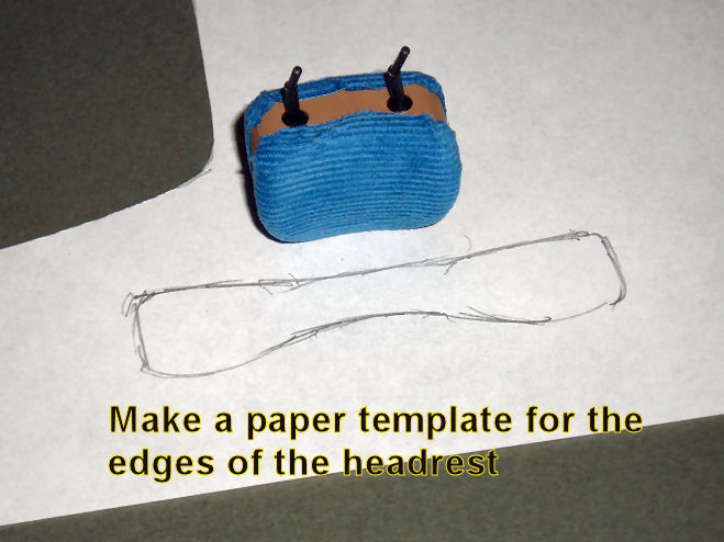

#17 Posted : 24 July 2019 17:15:11
Posts: 5,188
Points: 15,713

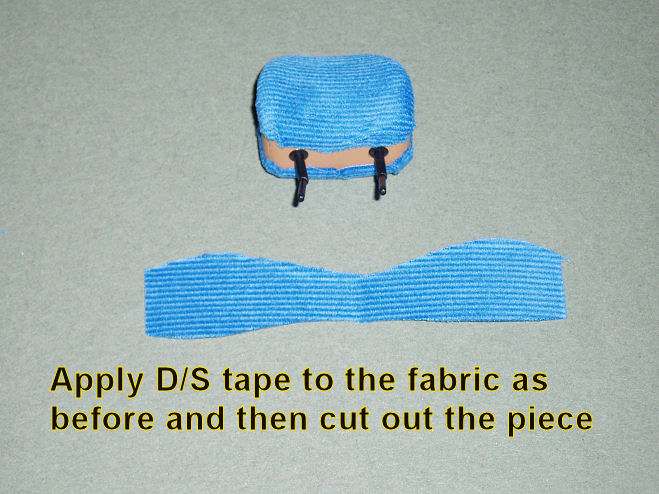

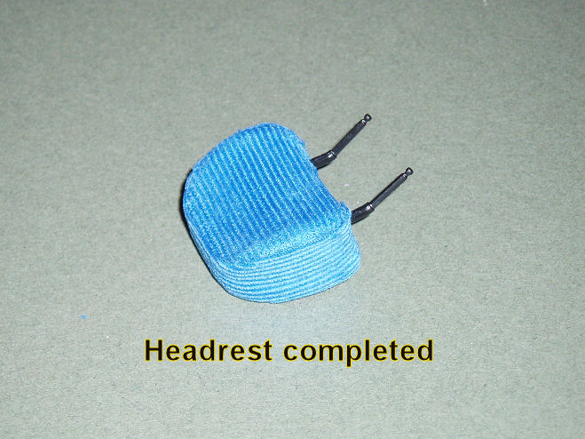

PACK 1

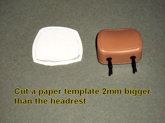

Head rests.

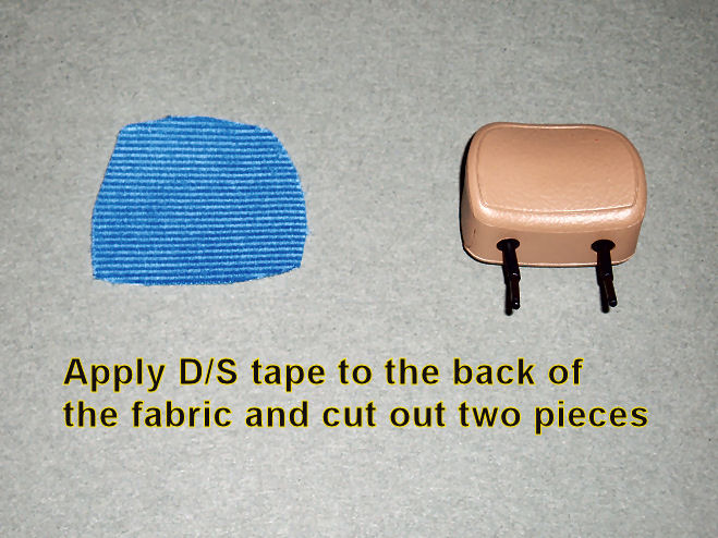

These are trimmed in much the same way as the seat base.
First, make a template of the face of the headrest but then enlarge it by about 2mm-3mm larger all round.
Transfer the template onto your chosen fabric which has been backed with D/S tape.
Cut the part out x 2. (Front and back)

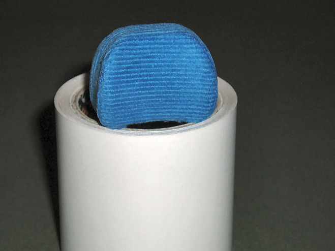

Apply the parts to the headrest, making sure it is pressed down really firmly all round.
Now make a template for the upper edge and sides of the headrest.
It really does not need to go underneath as that part of the headrest will never be seen.
Cut the fabric part out in the same way as all the other pieces and apply it to the headrest, starting at the top centre and fixing the fabric in place down the sides as you go.
Voila…!
Headrest sorted.
