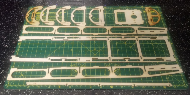

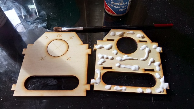

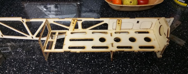

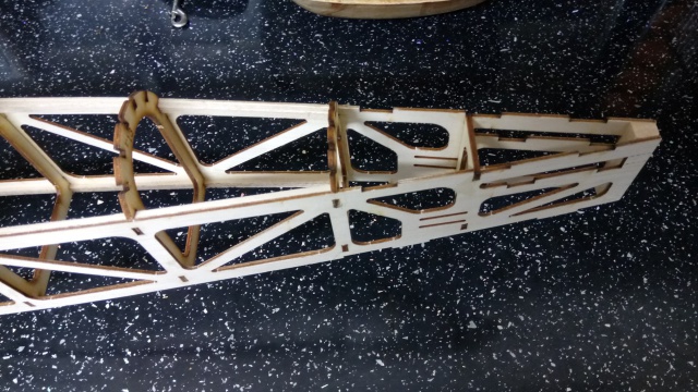

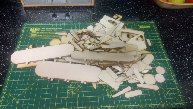

Mad Enough of me rambling on heres, some pics of the parts used construct the removable section of the upper fuselage which will be for access to the battery.
Dry fitted only nothing glued yet until I get my work board ready.

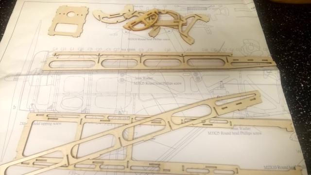

The last pic is a pile of cut outs for keeping the weight down. Still a lot more to comeLove
Going to keep a hold of those shapes you never know they may come in handy.
Thank for lookin'

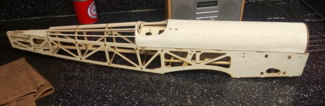

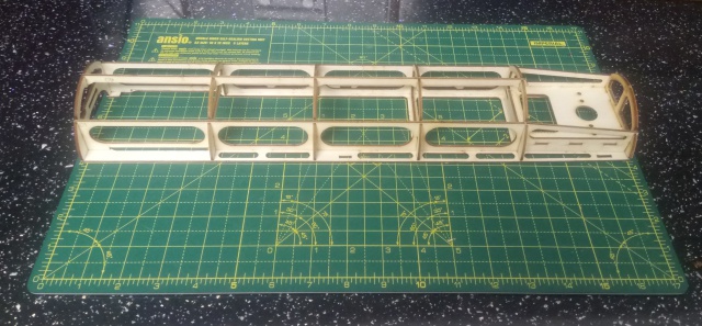

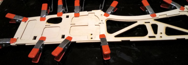

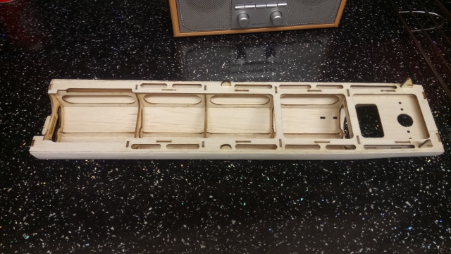

Not done much this week

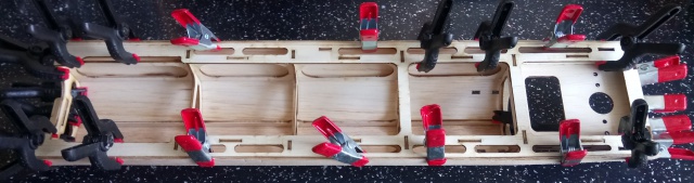

The upper fuselage was place an old glass sheet from a tv unit (can't get a smoother flat work surface than that)
I was going to glue the parts together but the CA glue I have is too thick to run into the joints.
Flapper Will go and annoy my local hobby shop later on today.Flapper

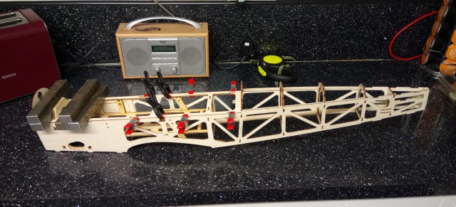

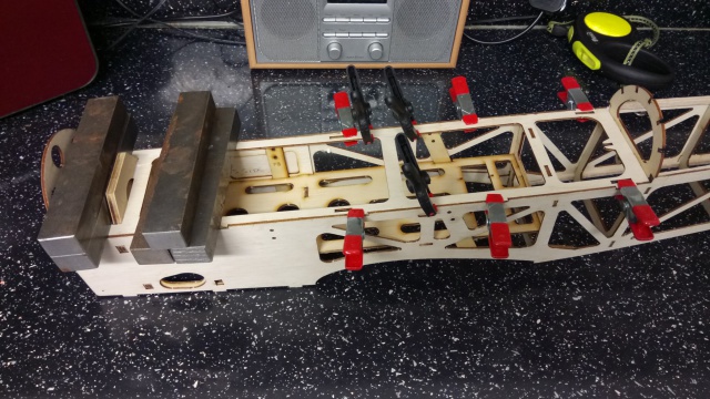

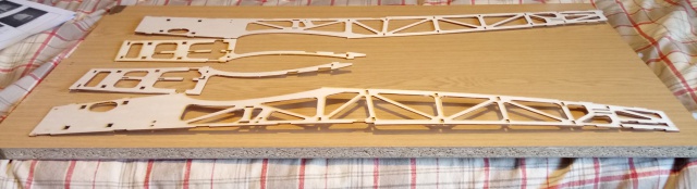

The main fuselage has been cut out but is a wee bit flexed so I will weight that down for a while
I am enjoying preparing the parts and the only criticism is that I wish they had turned the laser up higher so it cut through the thicker ply
Thanks for lookin'

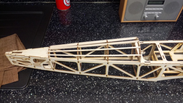

On with the fuselage
The kit caters for either EP or IC so depending which option you choose the build will be slightly different from the cockpit forward.
I have opted for EP with a brushless motor.
I cannot justify the expense of a real engine as this is my first rc aeroplane.
Progress so far
budgie attached the following image(s):

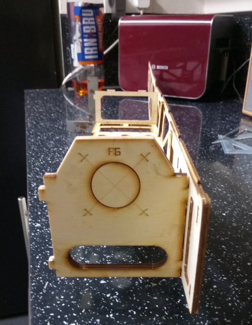

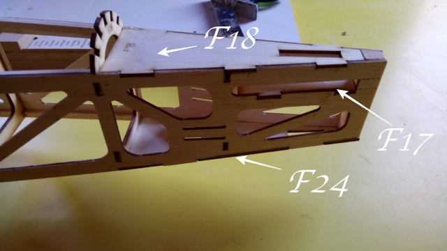

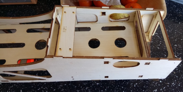

Progressing with hull Blushing oops I mean fuselage
All seems to fit together nicely
Did get held up by a couple of days as I couldnt find a part
Instructions says glue F16 to F2..Cursing Cursing searched high and low under the furniture, dogs basket, trooser pockets everywhere.Cursing Cursing
Then it dawned on me....maybe that part is not made of ply, like all the rest of of the parts I have fitted so far.
Blushing Blushing Opening the sealed bag of balsa parts there it was the only part that has not been premarked with its number

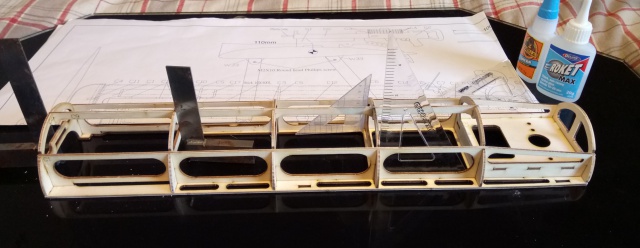

I was thinking of jigs for the build.
Very much so required for the wings
As for the fuselage, I was expecting my self to rig something up, but as I dry fitted parts in advance of my actual commitment to glueing everything they seems to fit ok
If was squint the parts would overlap or underlap etc.??
Main thing is that I am enjoying the build and I am happy to try again if I **** it up

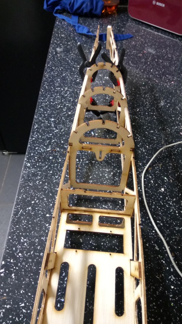

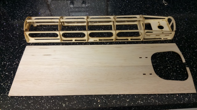

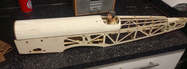

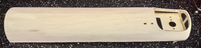

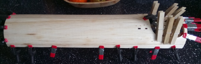

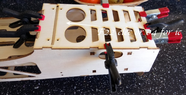

The upper fuselage balsa sheet was soaked in the bath for 10 minutes and pegged to frames to dry out

Just found out i can add arrows and text to my photos Cool
Me thinks i may get carried awayFlapper

The balsa sheet covering the upper fuselage is very soft and using clamps while the glue dried had left a few dent marks
Think I have got most off them filled in with very soft filler and a light sanding
Will need to check before covering in nylon later in build

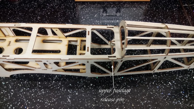

The catch and release cable has been fitted and a wee bit of "planking" done
LOL Thats enough planking for me in one goLOL
