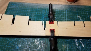

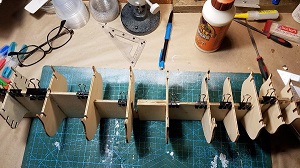

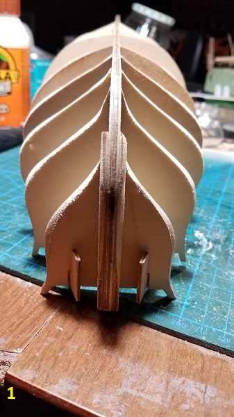

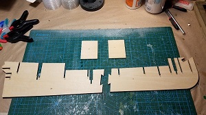

Step 1
Remove Parts 1 thru 15 and carefully clean up the edges with a fine grit sandpaper and needle file.
Lay the false keel (#1 a and 1b) on a flat surface and test fit together. When satisfied with the fit, glue them together.
Fit the keel stiffeners ( #2) to each side of the joint in the false keel keeping the frame slots clear. Glue and clamp them, set aside to dry.
Starting at the bow, test fit frames (#3-12) into the false keel. Once you are satisfied, glue the frames in place making sure to keep the frames perpendicular to the false keel. I use medium sized binder clips to hold things square.
Next Fit and glue the Mast bases for the foremast and the mainmast (#14 x 2) in the slots on the false keel between frames 4 and 5 and next to frame 9.
Attach the deck beams (#13 x 2)to the forward side of frame 9.
This completes step 1.
Thanks for looking in...

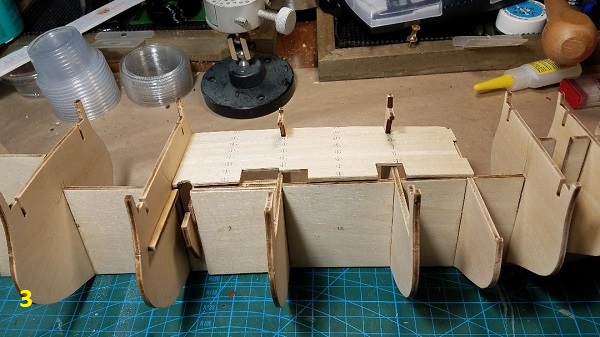

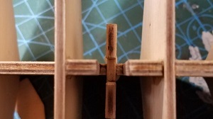

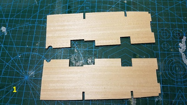

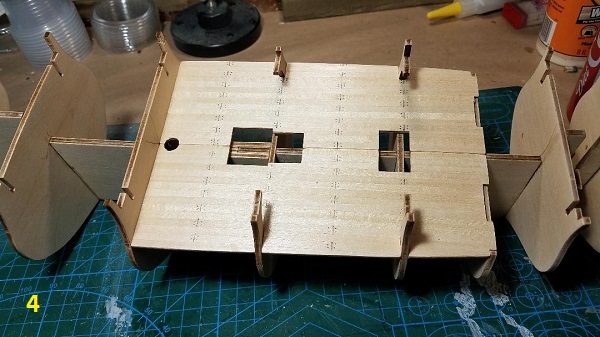

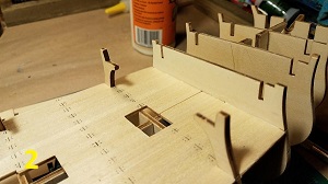

Step 2
Well, I am about 4 steps behind on my my build log so I finally tore myself away from the bench to catch up.
I'm gonna blast the next few steps out in rapid succession so hold on to your hats.....
Locate part 16, lower deck half (x2) and clean up the edges and gently smooth the surface.

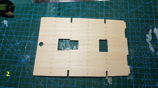

Starting at the center edge of one of the deck halves, place the 0.5mm x 4mm veneer strips edge to edge, covering the entire deck surface, making sure they are firmly adhered. Set this aside to dry completely. Repeat on the other part 16.
When dry, turn the deck sections over and trim strips from the edges with a sharp craft knife (pic 1).
Gently sand the edges and deck surface. Use a needle file to clean up the notches. then apply 2 or 3 coats of clear matte acrylic sealer.
Using a sharp pencil, draw the butt joint lines on the planks according to the measurements in the instructions, then apply 2 or 3 coats of clear matte acrylic sealer. (Pic 2). Allow to dry.
Spread PVA glue across the deck beams and in the notches on the sides of the deck parts and down the center edge of one side. Align the notches on each side with the frame uprights and lower the deck halves to the beams fitting the inside edges together (Pics 3 & 4). Clamp and/or clamp the deck in place and leave to dry.
Step 2 complete.
Onward
mwstratton attached the following image(s):

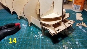

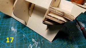

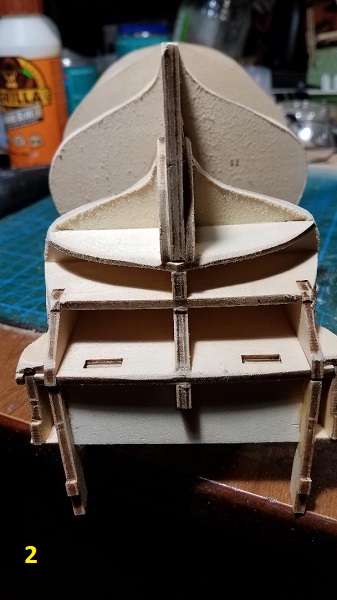

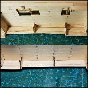

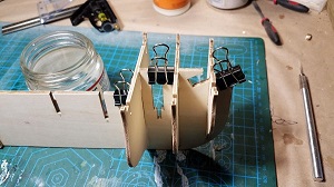

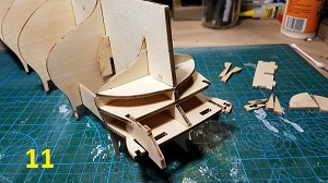

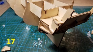

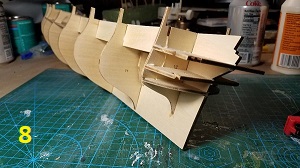

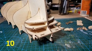

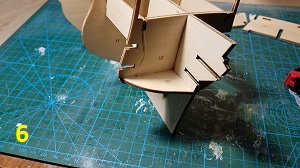

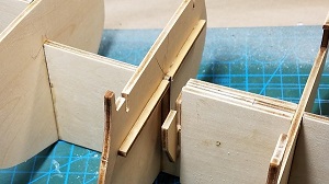

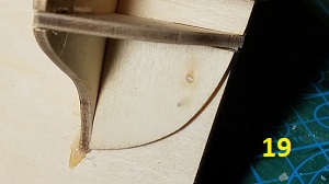

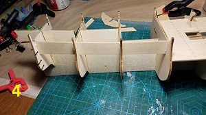

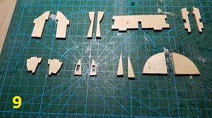

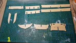

Step 3

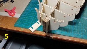

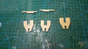

Locate and remove parts 18 thru 24 from the frets and clean up the edges (Pic 1).
I fit the bulkhead (Part 18) to the slots on the lower deck and frame 6, making sure it is at 90% to the deck (Pic 2).
Then the bow supports (Part 19 x 2) are fitted and glued to the slots in frames 3 thru 6 on both the port and starboard sides (Pic 3). Likewise the stern supports (Part 20 x 2) are attached to frames 9 thru 12 on both sides (Pic 4).
Glue the 2 bow stiffeners (Part 21 x 2) to both sides of the bow of the false keel (Pic 5).
The Transom supports (Parts 22, 23 and 24) are fitted to the slots in the stern of the false keel and frame 12 from the bottom up (Pics 6, 7 and 8).

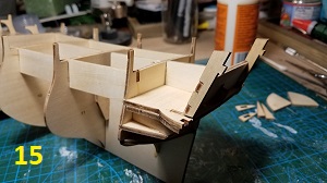

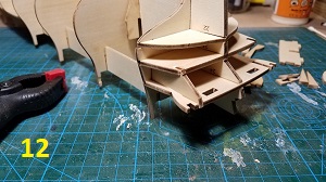

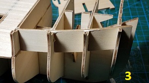

Locate parts 25 thru 32 and smooth the edges (Pic 9).
From the underside of the hull, glue the 2 supports (Part 25) in place between parts 23 and 24 (Pics 10, 11 and 12). Add the stiffeners (Part 26 x 2) to the bottom of support 24 on each side (Pic 14).

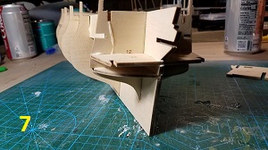

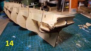

Fit the transom (Part 27) to the false keel and support 24 (Pic 14). Then I placed the 2 transom upright supports (Part 28 x 2)on both sides of part 27 (Pic 15).
Take 2 part 29 and 2 part 30 together to form 2 sides of the stern gallery. Attach these assemblies to the lateral slots in part 24 (Pic 17).

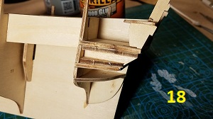

The 2 stiffeners (Part 31) are attached to the top of part 23 on each side (Pic 18).
The right angles of the stern stiffeners (Part 32 x 2) are butted up against the rear of frame 12 and bottom of support 22 on each side of the false keel (Pic 19).
This completes step 3.

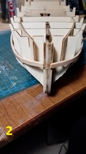

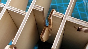

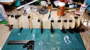

Step 4
So this step is quite simple as far as the log is concerned. At the bench, not so much. It's all about the fairing process.
Fairing the frame is very important to the rest of the build. Get it right and planking goes well. I won't go into detail on the process. Detailed instructions on how to 'fair' is available elsewhere on the forums.
See y'all soon

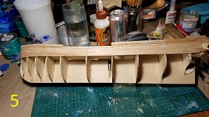

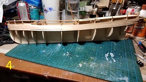

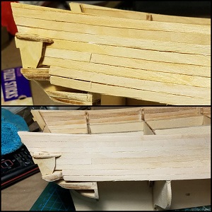

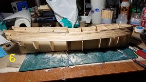

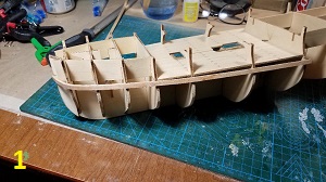

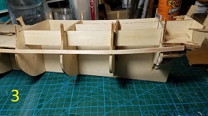

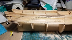

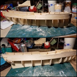

Step 5

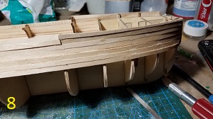

Step 5 is all about planking the upper hull. I started by carefully measuring and marking the frame ribs to locate the top edge of the first plank to be installed. I put several of the 2 x 5 x 300mm birch planks to soak then bent them to follow the curve of the bow. Starting at the bow, I fit the first plank in line with the marks just made, ending in the center of frame 9 (Pic 1). This procedure is repeat on the opposite side. I made sure to leave a 4mm gap along the front edge of the false keel (Pic 2).
I continued the first course of planking from the center of frame 9 to the curve on the front of part 26 keeping the top edge in line with the marks made on the ribs (Pic 3). I repeated this on the other side. Next I fitted the next row of planking above the first one at the bow keeping the forward edge in line with the edge of the false keel ending in the center of frame 8 this time. The row is continued aft of frame 8 to beyond the stern of the ship, slipping the planks behind the side gallery assemblies.
To attach the planks, I ran a bead of PVA glue to the top edge of the previous row between the frames and a spot of CA glue on the ribs to provide an instant hold. Clamps were used to hold the planks together till the PVA dried.
Next I dry fitted the upper decks to the frames and secured them with masking tape. This helps to achieve the proper shape of the planking.
I continued adding rows of planks toward the top of the hull (Pic 4).
The very top row of planking at the bow stops at the deck level forward of frame 3. Between frame 3 and frame 7, I stopped planking at the tops of the frames. Stopped the planking between frame 7 and 9 at deck level. Planking continued up to the top of frames 9 to 12 and the transom (Pic 5).
Using a sanding block the top edge of planking was smoothed flush with the frame tops (Pic 6).
After the glue has dried completely, the planks at the stern were trimmed and sanded smooth (Pic 7).
As you can clearly see in Pic 8, the planking did not go as smoothly as I had hoped. Going forward, I need to slow down and use more care in the planking process. Oh well, nothing a bit of filler and a lot of sanding cant fix.
Step 5 is done and my build log is caught up to date.
Stop by later to see how the sanding turns out.

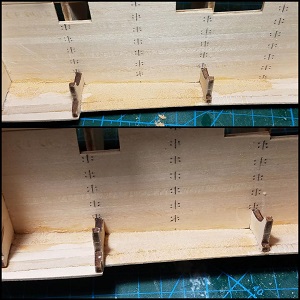

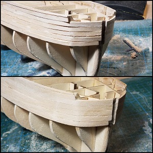

Step 6

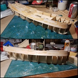

Using a sanding block and 120 grit sandpaper, I sanded the top of the upper row of planks smooth and to the height of the various rib uprights.
This basically finishes step 6. Since I have the sandpaper in hand I will continue on with the first part of step 7.
I don't know if it was the complex curves of this hull or me being too careless but there is A LOT of sanding to do. I used 120 grit sandpaper to knock down the ridges. The inboard bulwarks were sanded using 100 grit emery boards.
Next I filled the gaps with wood filler. The only area that needed significant filler was the inside bulwarks between frame 7 and 9. After that more sanding. Once I was satisfied that the gaps were well filled, I gave her a final pass of 220 grit paper.
Boy does my hand need a break.

#19 Posted : 23 February 2019 08:21:17
BigGrin Planking always looks rougher than a bears LOL LOL LOL untill sanded back and then it takes on a new life.
You could also try tapering the edge of the plank that is to be glued a little to get a better fit.
You could also try adding wood glue to some of the gaps when you sand back the sawdust will stick in the holes with glue in them and become a filler that matches the colour of the surounding wood.Cool
mwstratton
Thanks for the tips. It's funny to me that the bow and stern planking so far came out well but the midship area was rough.
