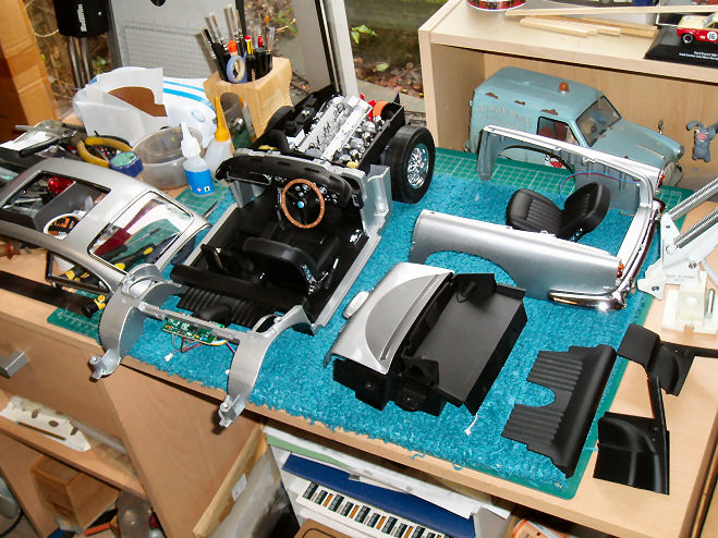

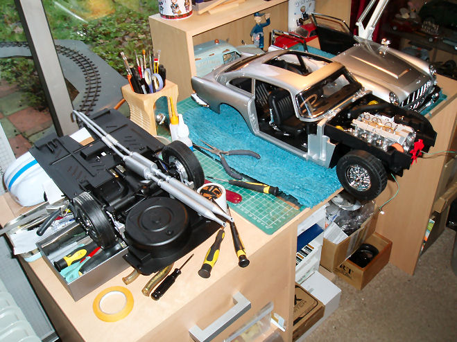

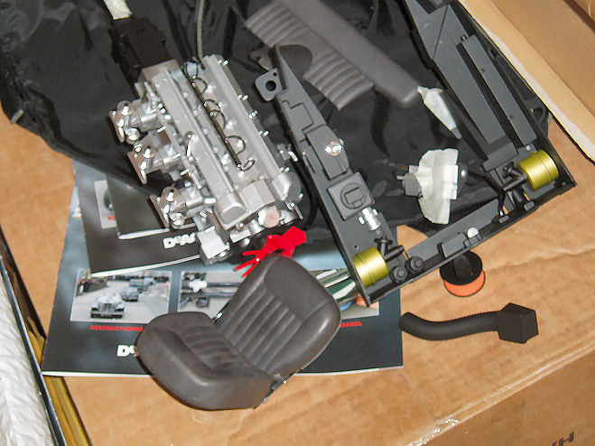

I've been commissioned to trim and detail a DB5 for a chap who bought one of the ready-built models from EM.
It still has all manner of mis-matched body panels but I'm not repainting it.
It arrived in a box the size of a fridge with a mountain of packaging.
First task is to dismantle it.
A right pain, as every screw has to be labelled and stored so I know how to put it all back together at the end.
On we go.

#3 Posted : 05 February 2019 11:55:04
Points: 15,326
Thanks Malc.

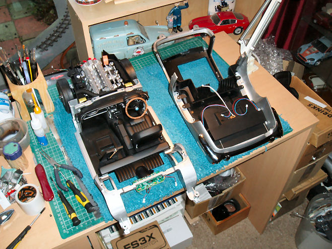

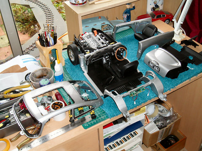

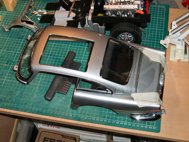

It's proving to be simple enough to take it apart but the labelling and keeping of the umpteen different screws takes longer than the dismantling!
I've still got a few bits to disassemble and then I'll start on the carpets and leather.

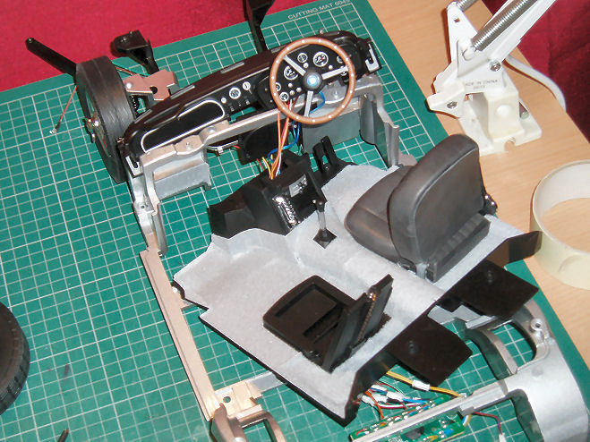

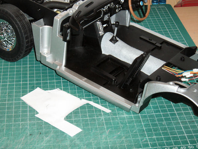

#7 Posted : 05 February 2019 22:56:56
Points: 15,326

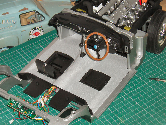

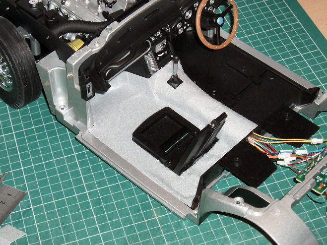

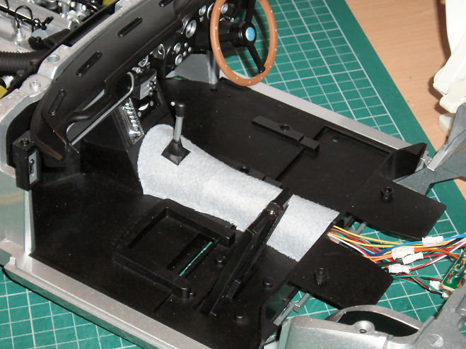

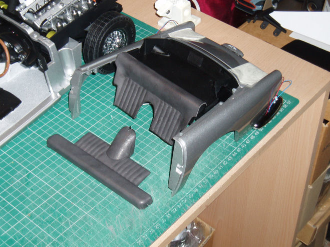

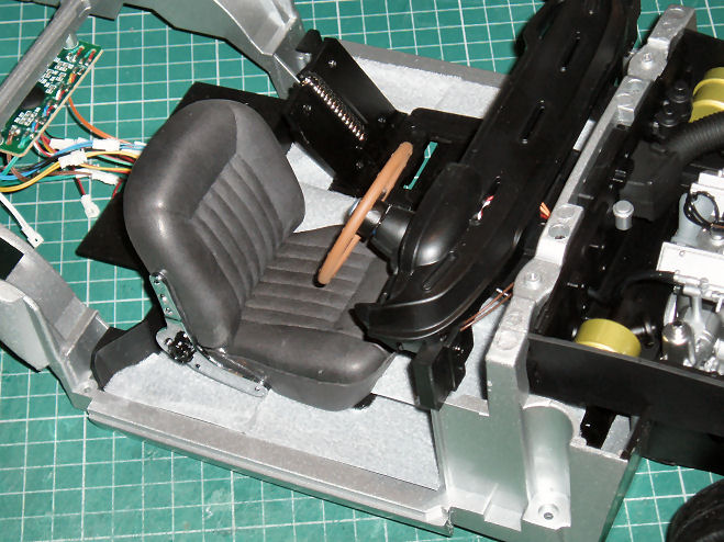

Well, here we are - interior carpeting almost done.
Lots of fiddly paper templates but at least it's now pretty much done.
Leather trimming next...

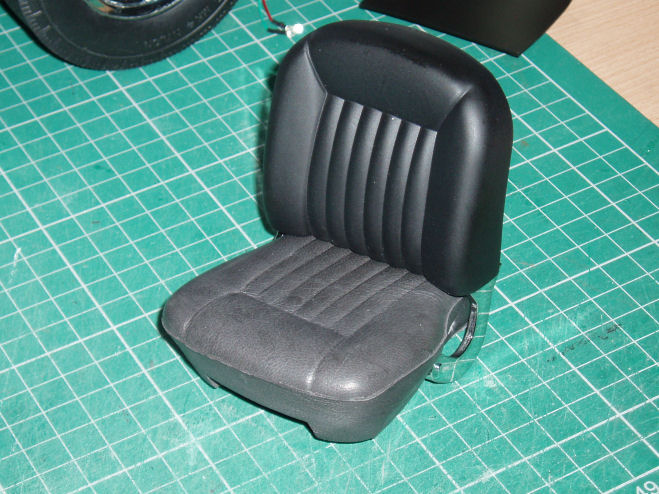

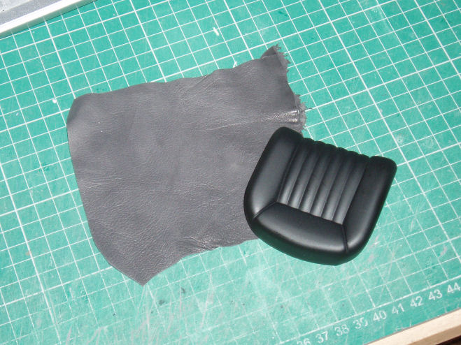

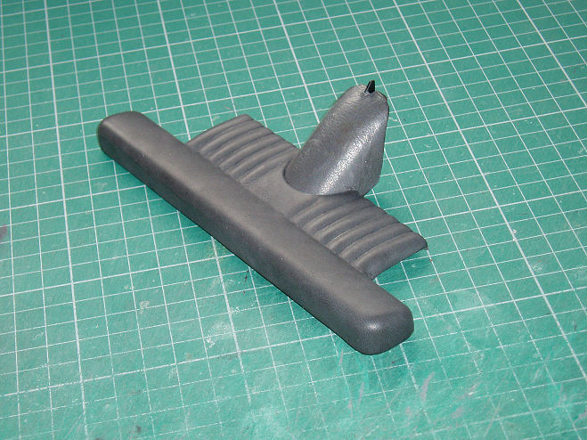

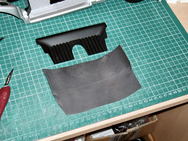

#14 Posted : 08 February 2019 15:03:41
Points: 15,326

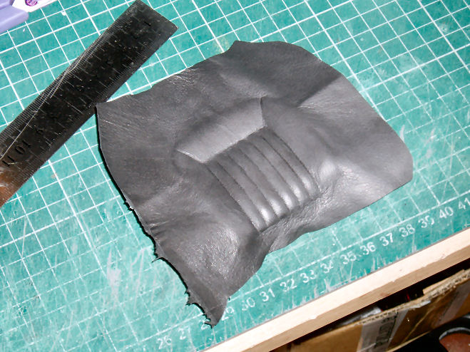

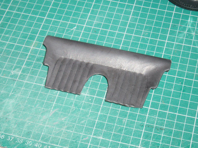

The seat parts are getting there.
Again, paper templates first and then cut/stick the leather taking care to get it as tight as possible into the flutes on the seat parts, and over the compound curves.
The kit plastic seats do look pretty grim I have to say.
Hopefully, the leather looks better.

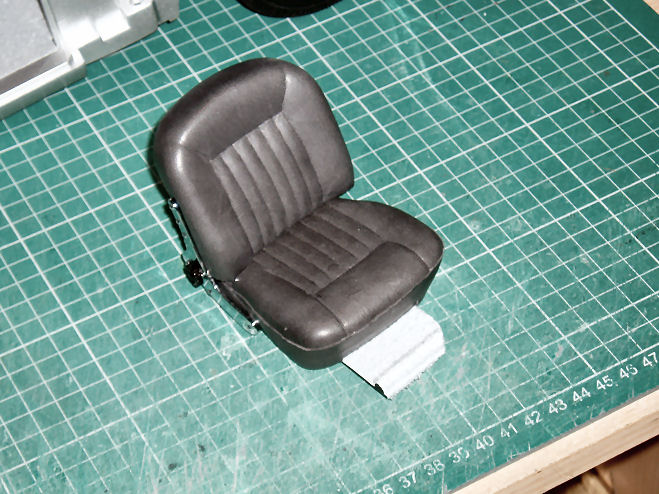

#15 Posted : 09 February 2019 16:07:38

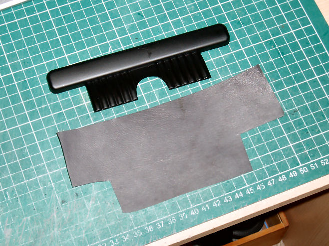

Points: 15,326

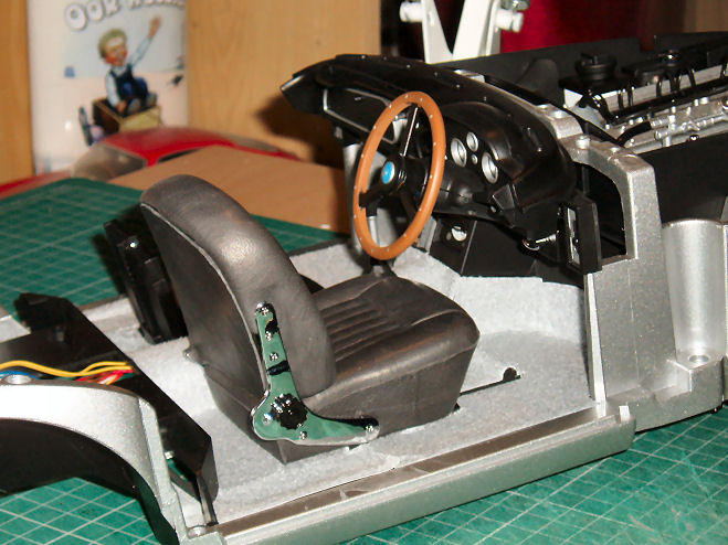

Drivers seat now covered and fitted back into the car.
Tunnel arm rest, hand brake gaiter and passenger seat next.
Then it will be inner rear panels and door panels.
On we go 'Mish Moneypenny...'

How did you get the leather to sit in the seat creases? Did you use CA and press it down with a straight edge?
#17 Posted : 10 February 2019 22:10:42
Points: 15,326
It's all just stuck with monstrously sticky (thin) double sided tape.
Lightly touch the leather in place on the seat part, then peel it off just up to a centre crease.
With your nail, press the leather into the crease, then carefully lay it over the curve of the 'flute', then with your nail, press in the next crease. Keep going, lifting the leather away from the seat, except for the crease you are currently working on.
Eventually, pull the leather tight over the seat corners, taking care to get no creases anywhere.
At the end, press down every crease again using the edge of a steel rule or a razor saw.
With practice, you can cover very complex multiple-curve seats in one go...

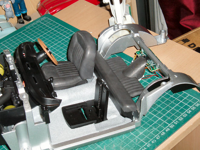

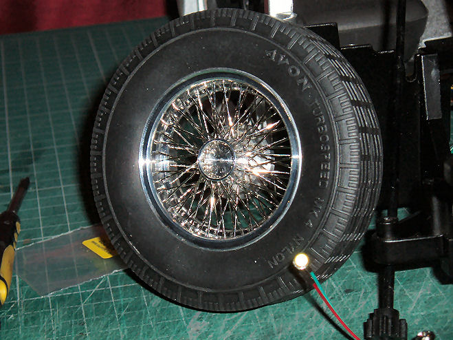

#18 Posted : 20 February 2019 13:23:09
Points: 15,326

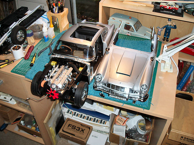

Back on this one again...
I've stripped and re-done the rear seat as it had a few little creases on the bolster ends and they irritated me.
I've also started taking the front end apart for engine bay and engine detailing and to replace the grim plastic wheels. One wheel sorted...
Roy.
