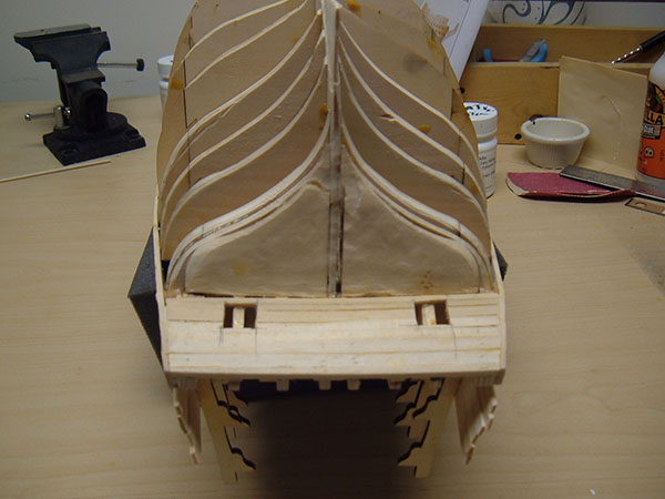

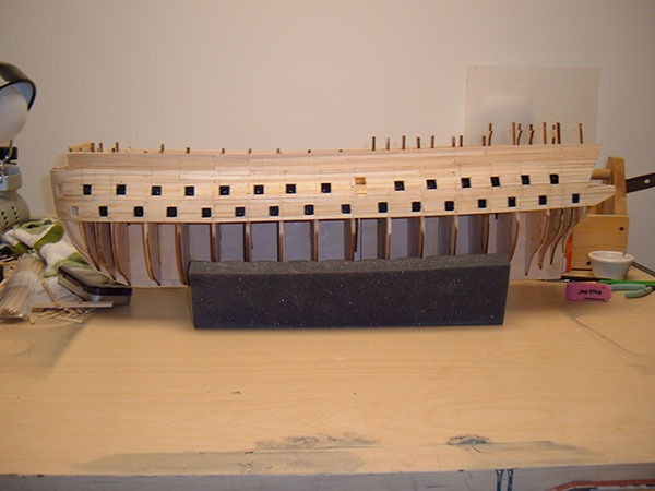

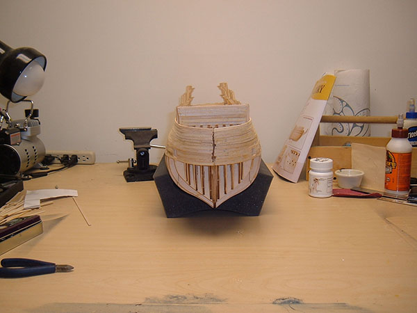

It is now winter in northern Michigan, it is a good time to but in some work on the Victory. This is my first attempt on a wooden model. I would like some constructive criticism. It is a learning experience as I go.
The project started off a little rough, but as I go along things are tightening up. I am currently on stage 27 and ready to mark out the second deck gun ports.

Making good progress. As this is your first wooden ship build I would recommend you follow closely the guidance given in the Official Build....
https://forum.model-spac....aspx?g=topics&f=17
The official build follows the instructions step by step and highlights any potential pit falls....
There is also an official video build, again this follows the instructions step by step and you can see how each step should look.
https://www.youtube.com/...pjUDnPzoDagw3u2T7tQIBv4
Take lots of pics and post often on your diary. That way we can follow your progress and be ready to assist or advise should you require it....
Hope you find this useful... Will be following....

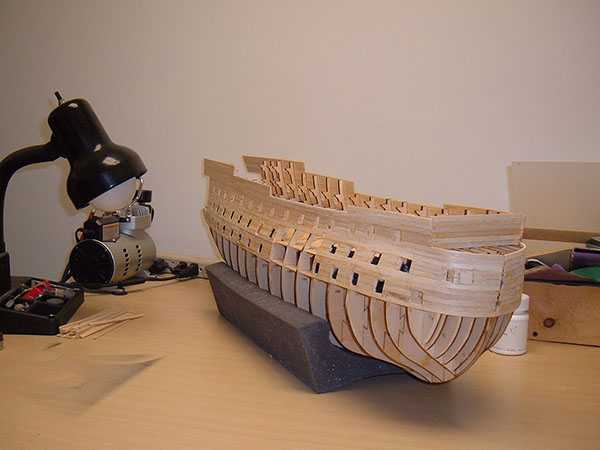

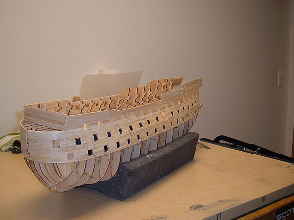

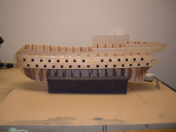

I have completed the next 2 stages of planking and the second row of gun ports cut. As you my of noticed I am getting better at planking the bow and my gun ports are coming out a little cleaner. I did notice in the last pics I posted that my exposed lower deck was crooked. I was able to break it free and build it up underneath to some what level it. it was caused by to much weight on it when I installed the deck and it bowed. I also cut one of the bow gun ports in the wrong spot and to patch it, OOPS. Cursing

Coming together very nicely, looking good....Cool Cool .. I think you will find that there are very few ship builders out there who have built one of these kind of models error free. We have all have made mistakes but the trick is spotting those mistakes and taking corrective action to put them right before it turns out to be disastrous. Its all part of the modelling experience.....Cool Cool .. Look forward to seeing more of your work...

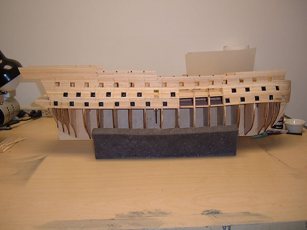

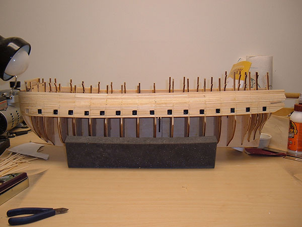

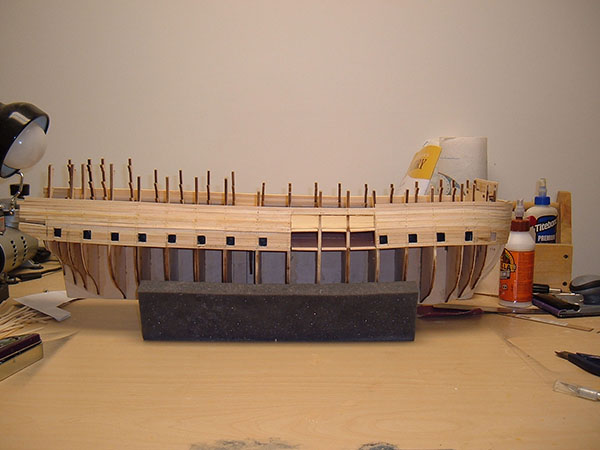

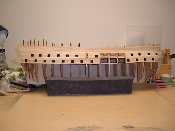

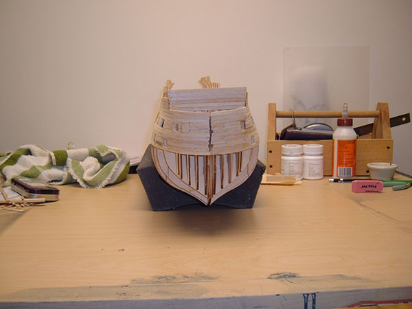

I have completed the upper half of the hull planking and ready to start on the lower. I learned from the upper hull I did not shaping the ribs enough so I am going to readdress that both on the bow and stern. I do have a couple of question before I continue.
1) Should I be at least rough sanding the planks as I go or is it better to wait and do it all at once ?
2) I have seen on other diary builds they have install foam blocks between the ribs both bow and stern. Should I be doing the same and if so is expanding foam or is it packing foam cut to size and fitted ?
3) I did notice on some of the builds that the foam was proud of the ribs by several millimeter at least that what it looks like . any thoughts.
All your comments are greatly appreciated.
Willie
FightingWillie attached the following image(s):
#17 Posted : 08 December 2018 20:53:20
Coming along nicely Willie, looking good... In answer to your questions:
1. You should ensure all of the faring of the frames is complete prior to commencing the planking phase of any build. The instructions give guidance on how the shaping process should be done.
2. In most cases the blocks you see between the frames are balsa, rough blocks are inserted and the shaped down to frames. For new builders these can assist in getting the profile of the bow and stern areas correct. I wouldn't use expanding foam on any build.
3. Any block used should be sanded down to the ribs and not sitting proud.
Thank Alan, as I was planking the upper hull I found I hadn't sanded it enough I am going correct on the lower. So there balsa, it look like foam, OhMyGod live and learn. I will think about the blocks it sound like a good idea.
I will have a lot more question I am sure. I know I drove the guys on auto restoration forums nuts when I was was restoring 1956 Chevy Bel-air
