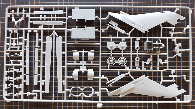

THE KIT

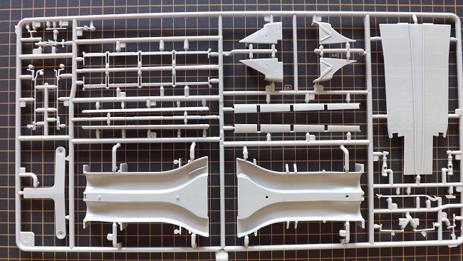

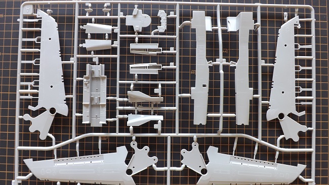

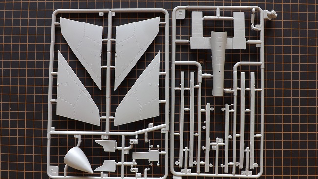

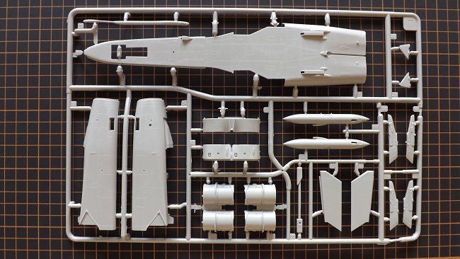

For my build I will be using the Revell kit number 04924 Tornado GR.4 in 1:48 scale.
Bearing in mind the kit is not that old what did surprise me was the fact that it seems to be only available via the likes of eBay.
I managed to get myself a “bargain” direct from Germany and it was upon receiving that kit (as new and un-opened) that the reason this kit disappeared became evident.
I will explain that a little further as we progress but for now here are some pictures showing the box art and the frets holding the component parts.

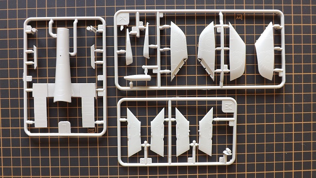

On the whole the parts are very nicely done with lots of nice recessed panel detail but in one or two places there is evidence of flash on some of the parts. Also evident is a fair amount of parts scratched and mark were multiple frets have been added to a single bag and they have scuffed together in transit.
The kit as supplied does come with some very nice markings and I was very tempted to use these but in the end I have settled on an aftermarket set in which to finish this build.

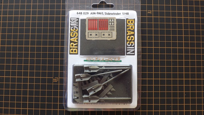

Eduard Brassin ED648237 Litening Pod (please note I have shown the 1:72 scale here as still awaiting delivery of the 1:48 one I ordered)
Eduard Brassin ED648239 Brimstone with AGML III Rack
Eduard Brassin ED648029 AIM 9M/L Sidewinder
Flightpath RAF Laser Guided Bomb Set

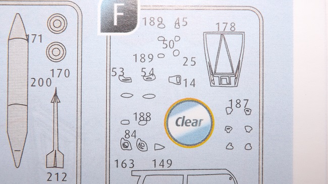

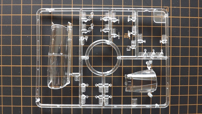

I mentioned at the start of this log that I was surprised how “scarce” this kit seems to have become. Even the Revell Shop had it listed only to cancel my order when I had placed it due to it being unavailable.

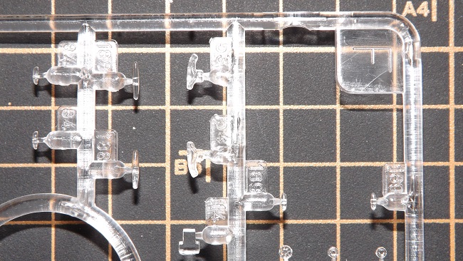

When I received my kit, I had a quick look through the instructions to see what was to be expected in the build and it was then I noticed an error.

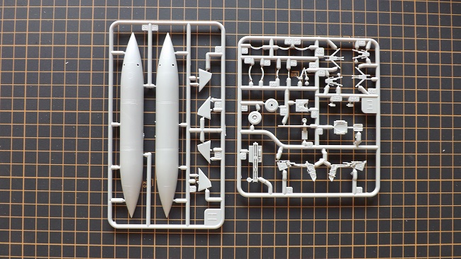

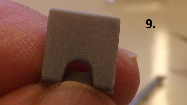

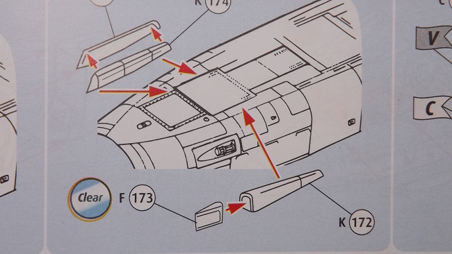

In the below pictures you can see parts 172 and “CLEAR PART 173” being joined to form the “LRMTS” pod. However, looking at the parts layout in the instruction book there is no part 173 on the clear frame and same with the actual clear parts themselves.
Now at first, I thought it a case of the wrong clear parts being added into the kit but then realising the instructions parts breakdown do not show it thought this needed further investigation.
I am no expert on the Tornado but apparently you cannot build a GR.4 without this pod.
It is possible to pull this from the older Airfix or Italeri kits but unless you have one on hand it gets expensive to buy these just to get that one part.
Similar with aftermarket sets such as Flightpath and Olimp which both have this item as part of their upgrade sets but again an expensive way of obtaining this part.
Having done an internet search on “Revell Part 173” a number of refences to this issue were found. It appears that when this kit was launched the manufacturers in Poland had not been advised to “switch on” the part of the clear mould that produces part 173.
There are references to a number of companies in the UK pulling this kit from their shelves due to this issue. While Revell did rectify this by providing a replacement clear part through their spares service it would appear that a number of the kits people are selling on eBay are first production kits and are missing this part.
In my case luck was on my side in that the Revell Spares desk is still operating and a quick email to them saw the replacement part arriving a week or so back so what could have been an awkward situation is no resolved.

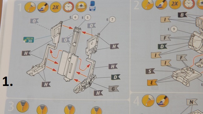

PICTURES 2 & 3

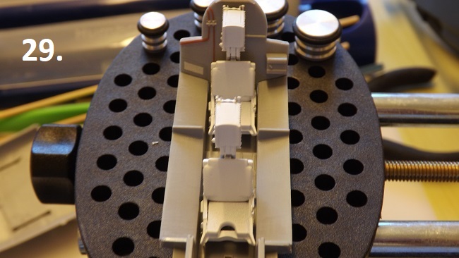

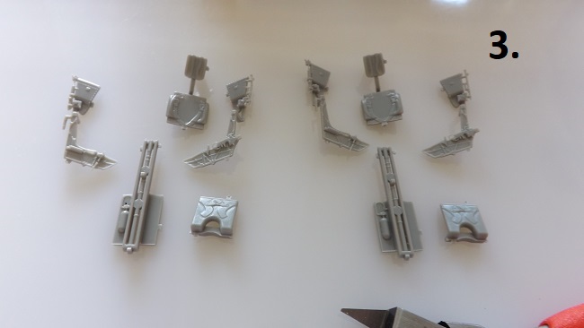

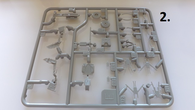

So, we start with the seats and these are each made up of 5 parts. The parts are duplicated across 2 matching parts trees.
PICTURES 4 & 5

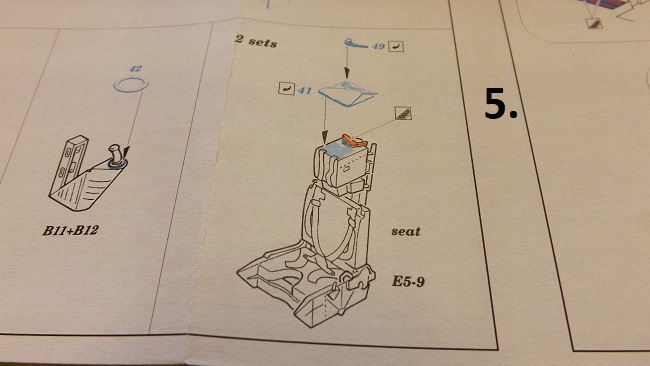

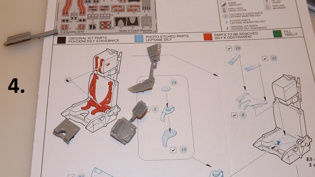

As I am using the Eduard etch set on this build its important to keep an eye on the Eduard instructions as you progress to check for any of the kits parts that may need to be modified or removed.
In the case of the seats the Eduard instructions will have us remove the moulded in seats beats from the seat cushion and backrest/headrest. There are also little squares on either side of the seat headrest that have to be removed.
What you can see in PICTURE 4 are the Eduard instructions for the seat upgrade set but it was worth looking at the Internal upgrade set as seen in PICTURE 5 as that will have you remove the detail on the top f the headrest to enable an etched piece to be added at a later stage.

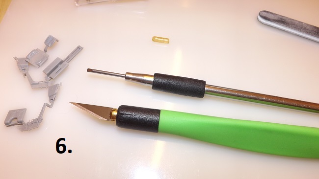

PICTURES 6 & 7
Some fairly basic tools needed to remove the detail from the kits seats including a nice sharp blade (and yes, it is sharp and I managed to “stab” myself in the thumb (what a fool). I normally use a Swan Morton scalpel and number 11 blade but thought I would try something with a slightly fuller handle but this knife does not feel “natural” in my hand.
A micro chisel. This one I have had for a number of years – it was produced by a company called “Mission Models”.
Just visible top right, is one of the Flexi Files.
To get into some of the tighter areas that need clean-up these Mini Sanding sticks from Albion Alloys are ideal.

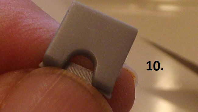

PICTURES 8, 9, 10 & 11

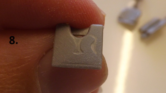

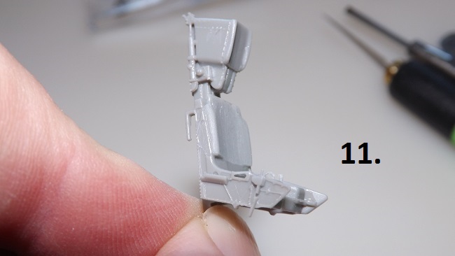

So, we start to use the various tools to remove the seat belts from the parts. The roughest of the sanding sticks does remove the plastic very quickly but leaves a rough finish so just a case of going down through some of the finer grades to leave a smooth part.
Having removed all of the details as shown in the Eduard instructions we can glue the seat together.

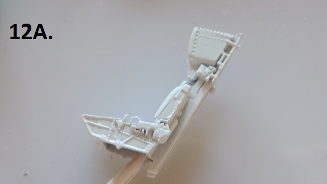

PICTURES 12 & 12A
And here is one of the seats after a quick coat of primer.

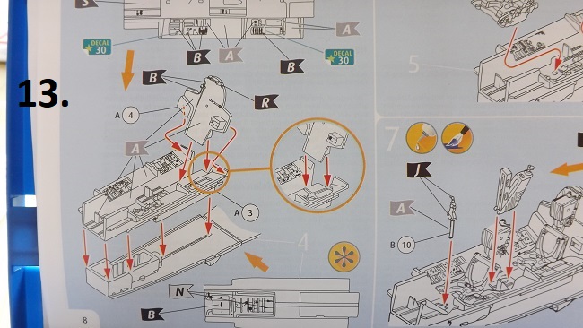

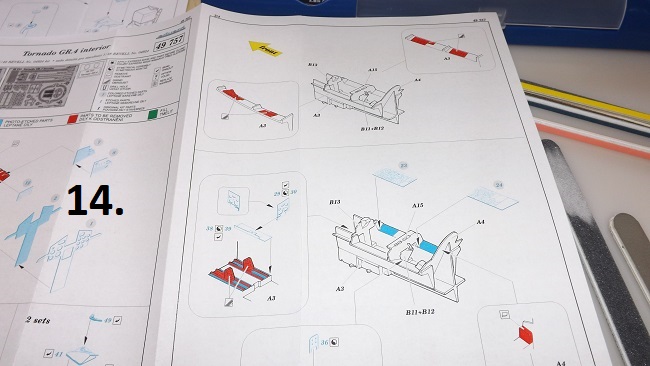

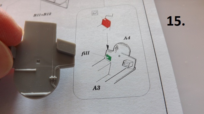

Next, we move onto the Cockpit tub using Revell Parts A3 & A4. Again, we refer to the Eduard instructions to see what parts have to be removed or modified ready for the etch parts.
PICTURES 15, 16, 17 & 18

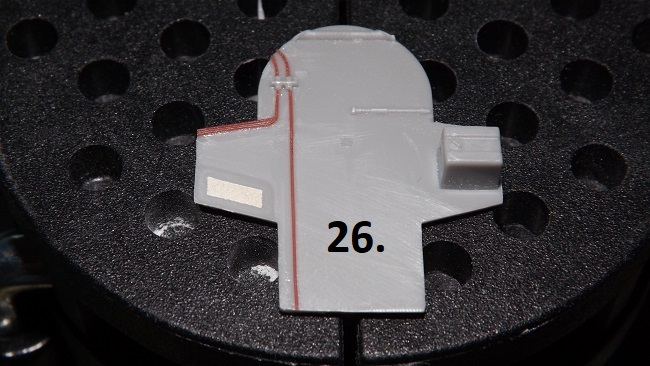

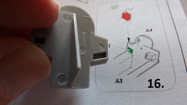

In the rear bulkhead Eduard will have us remove a moulded in Box and it does show that when this is removed we are left with a through hole in the part.
As its easier to fill something with a back to it I decided to fill this void now with the hope that when the “box” is removed from the front of the bulkhead we will be left with a nice already filled void.
For the filling I have used Squadron White Putty. Its not designed for filling very deep voids as its Toulene based and if you use this in large quantities you stand a very good chance of completely melting the plastic part.

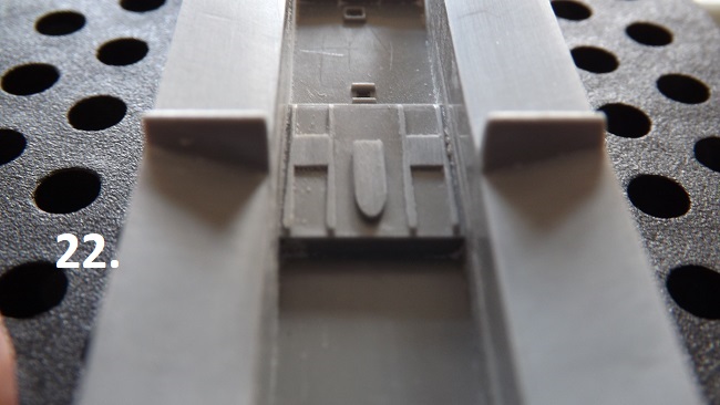

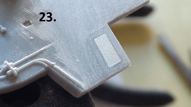

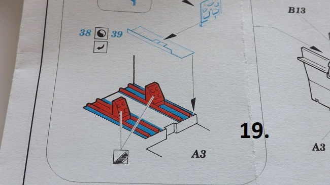

PICTURES 19, 20, 21 & 22

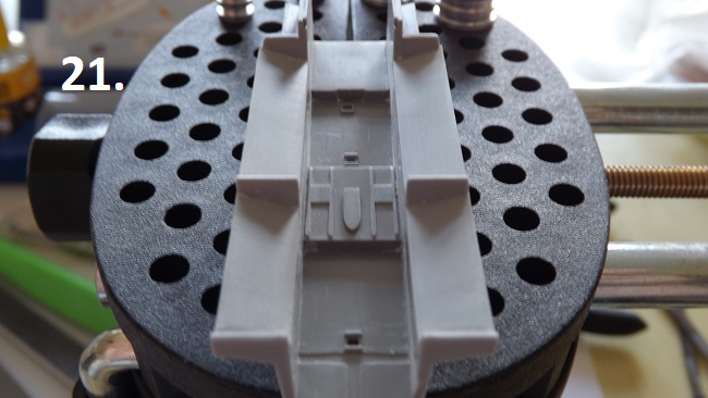

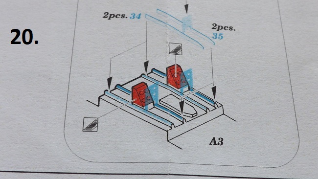

From the Eduard instructions we can see in PICTURE 19 that we remove the moulded in foot pedals and the rails leaving this area clear to add etch parts.
PICTURE 20 caused me some confusion because if you look carefully it appears to show the toot pedals are reduced in height (to the same height as the rails) and onto these some etch strip and replacement pedals are added.
This area seemed a bit odd to be and I did wonder if this complete area should be removed but looking at the etch replacement parts they will need to be mounted against something so I guess leaving some of the original parts (albeit modified) is the correct path to take.
In PICTURES 21 & 22 we can see the modifications I have made to this area.

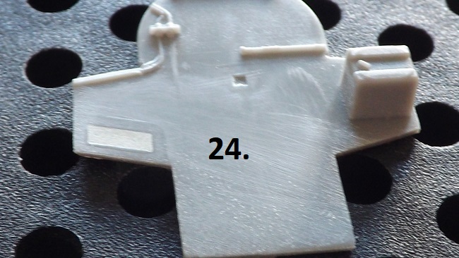

PICTURES 23 & 24
Having removed the moulded in part that prefilling of the void paid off. However, because this is a very confined area to work in I managed to removed some of the moulded in cable detail.

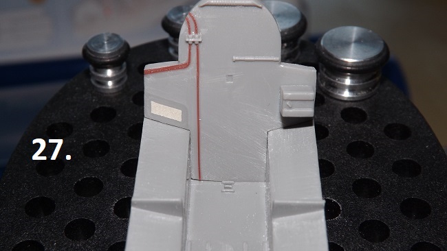

PICTURES 25, 26 & 27

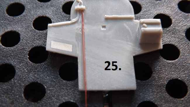

Rather than just leave off the detail I damaged I thought I would have a go at replacing it and was fortunate enough to have some 10” thou plastic rod in my modelling box so used that to replace the damaged cable runs

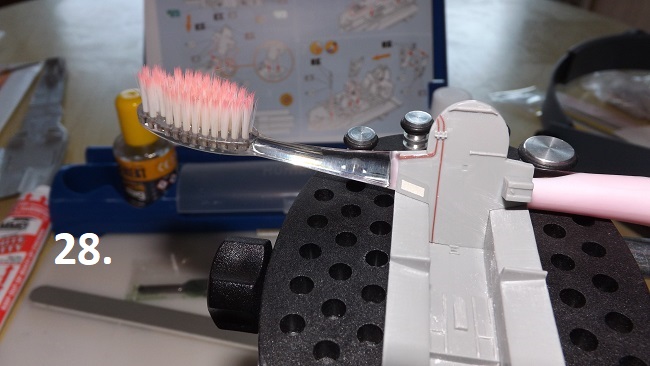

Having rubbed down so much plastic the parts have dust and debris in all of the crevices so to clean this up A soft toothbrush (not one I am using 😊) and some warm soapy water cleans up the parts well.
And the final picture here is a dry assemble to see what it all looks like so far.
