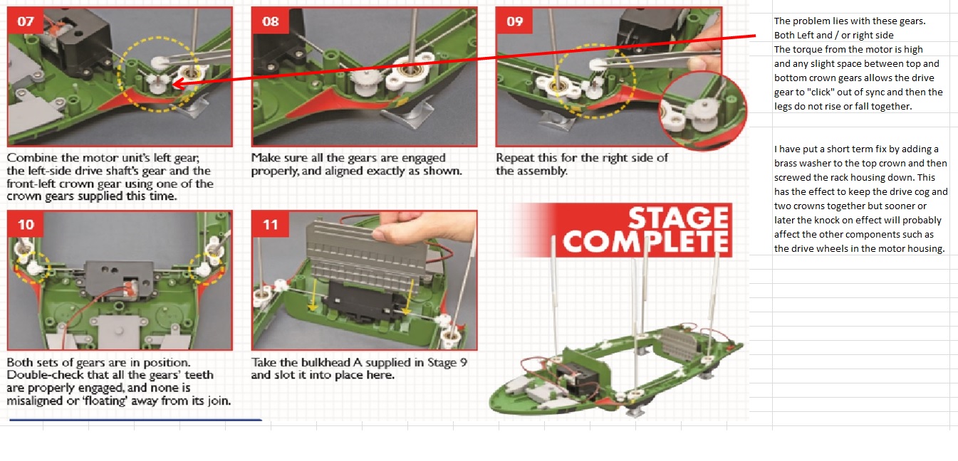

Just finished my mighty T2 but find the Achilles heal is he gearing for the legs.
As the cogs are nylon they can easily unmesh which causes one side to be wonky I was wondering if anyone else has the same problem.
I've used a couple of brass washers to help but was wondering if anyone has a mod to use metal cogs etc to make the thing behave correctly. Nothing worse than hearing the Click of of shame when the thing is rising or lowering.

Hi Dellboy thanks for getting back to me. This wasn't a problem during the build When it was tested way back in Pack 7 it worked just fine, however I'd heard that several people have experienced this phenomena.
You tube is a good reference source to see videos of wonky legs....
So as I say I have put a washer on the top of the top crown gear and then re-screwed down the rack housing and it is a lot better but I feel this temporary fix will destroy other components in the motor housing. I have done a picture from the instruction PDF but can't seem to attach it

that's how you do it
the problem.jpg (296kb) downloaded 210 time(s).

[YOUTUBE]https://www.youtube.com/watch?v=4b90_l4zx-Y&t=77s[/YOUTUBE]
I did the video to troubleshoot this very issue.
To stop it, I've put a 0.5mm washer under the lower crown gear.
As per the previous posts I had no problems until the whole of TB2 was assembled and it appears to be made worse after tightening the 3 body screws near to this crown gear assembly.

Many thanks for providing the link to the video as it shows your issue well.Cool
I have studied the operation of your TB2 and it seems to confirm my suspicions that the gears can only slip if the black slide rail allows the gears to move and there looks to be a very small amount of movement in your slide rail.This therefore points to the fact that a 0.5mm washer will block that movement in the gears as you are in fact lifting the gears by that 0.5mm and holding them against the slide rail and stopping the gear slip.
Although it works when the upper body is not fixed its most probably only just working and near the point of slipping. The problem is then compounded when the upper body is fixed in place as the extra weight is likely making the slide rail move by that 0.5mm.
My TB2 works fine time after time and that`s with my Grandson man-handling it and there is no movement in the slide rail at all hence stopping any space for the gears to slip.
My recommendation is therefore to go back to the stage where you fit the slide rail and make sure that there is absolutely no movement in it when its finally screwed into place.
It may be worth checking that the screws that hold the slide rail down are not hitting the bottom of the blind hole they screw into as they may appear fully tightened but still allow that small amount of movement in the slide rail.
