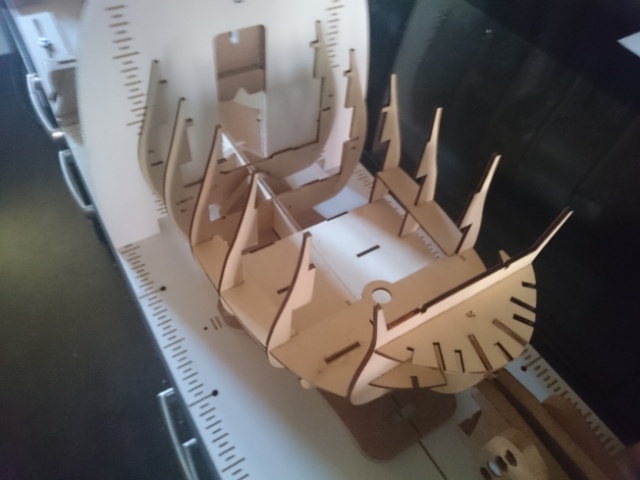

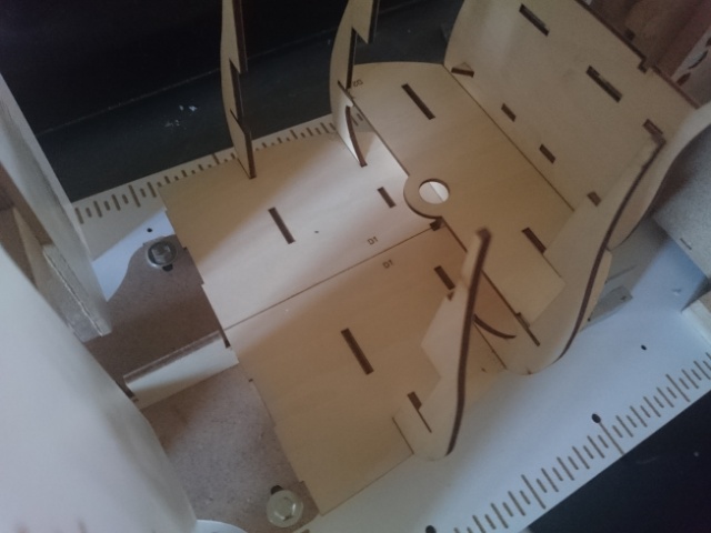

Hi built me jig up,and started to glue formers in,I glued the 2 parts of keel together first give me bit more length to hold on. I then glued the first former in and used this to square up in jig,as it mostly curve on the bottom at mo,the jig is getting them crack on square in 2 planes,

Hi thanks to all who looked in and left comments much appreciated, Thanks for the tip Alan I have been using the deck parts to check all alignment, I'd just taken them out for pic of formers,as you can see from pic they align perfect with no gaps anywhere, and sit perfectly flat on all formers,I'd worked out that with the way deck fits the formers need to be perfectly in, Arek Martyn I look forward to your diarys on this kit, and will be following your builds with interest, cheers mick.BigGrin

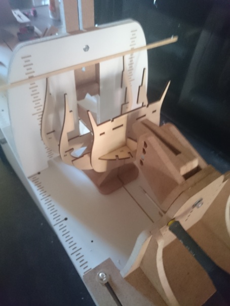

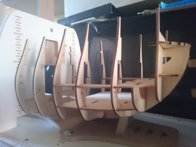

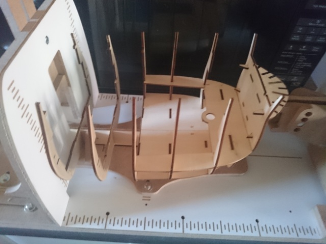

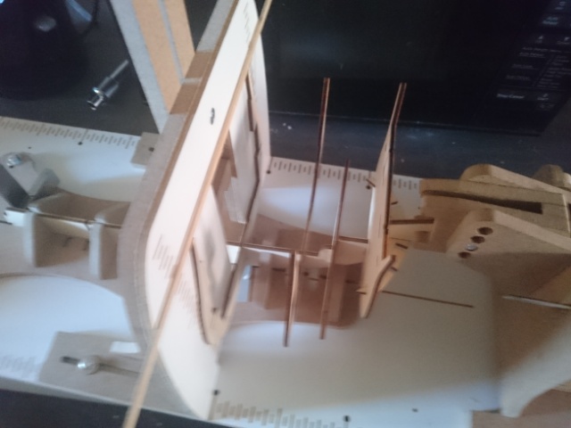

Hi bit more done, formers in to no 9 which is as far as pack one goes, the strengthing decks in, stiffens it all up well, only adjustment I made was the 2mm slots are a very small amount to tight, literally one rub with sandpaper to get them to fit,apart from that I have made no adjustments to fit at all,it goes together that well,plus the 3 more parts on the front former,all the time checking squareness, and that formers are parallel from top to bottom and across the width, mine are.next order few paints and start the decorations.cheers mick.BigGrin
