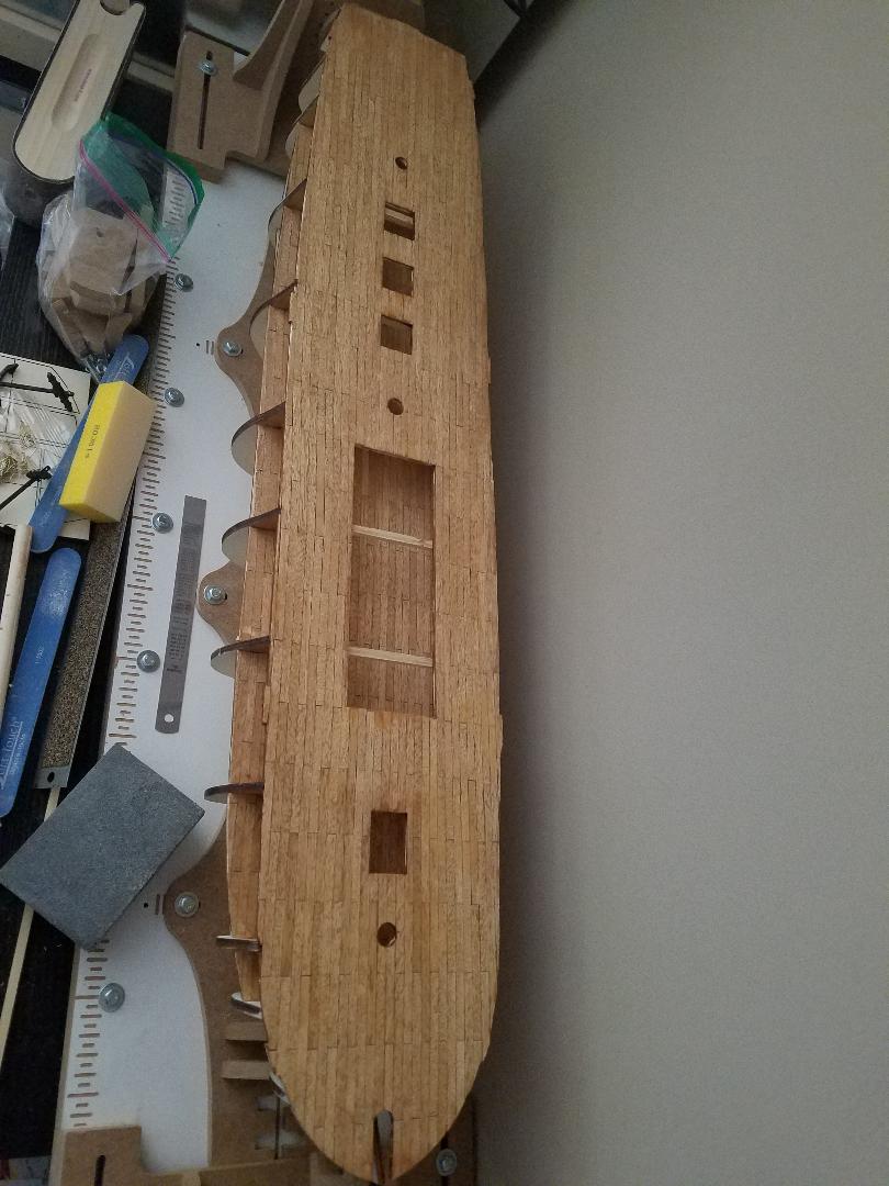

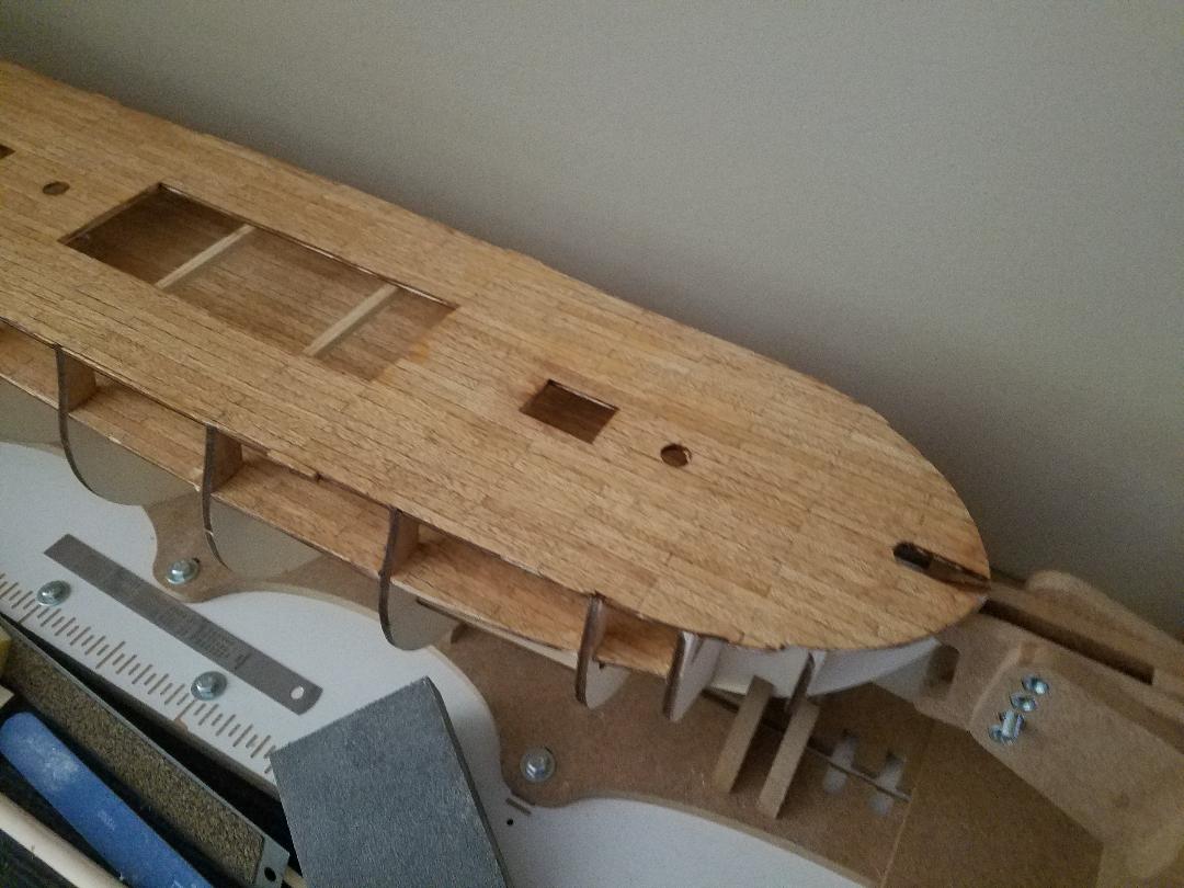

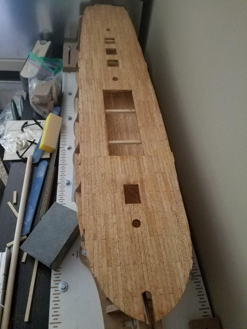

Took some quick pics as I put the stain on the upper deck last night. I went with an antique walnut as the real ship didn't have a very dark deck. I also didn't bother adding the nailheads as I did on the lower deck as they disappear in the stain. The "caulking" in between the boards was added per the instructions, but it somewhat disappears until the stain is added.
I did deviate from the instructions a little as I had some warpage on the plywood pieces. If you build as per the instructions you run the risk of gluing a curve in your hull if you have any warping. I also added all of the upper decking planks at the same time as some of the basswood stripes are a little narrow which can lead to issues later on when moving toward the stern.
Anyway, I have a busy next week and after that, I am on vacation. I will be jumping back in during early July as pack 4 is on its way to me now. I again am going to deviate a little from the instructions as nothing will be added on the upper deck until the entire hull is completed in pack 7. I also plan to add copper cladding.

That is some very nice work, coming on great.ThumpUp

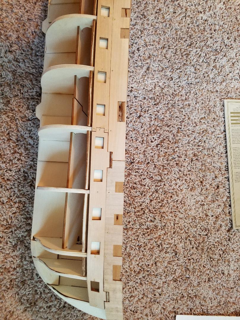

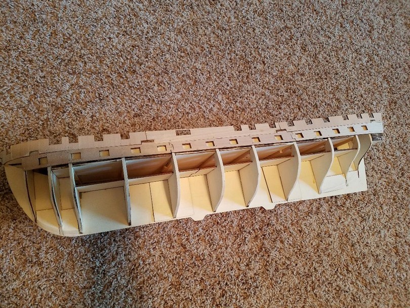

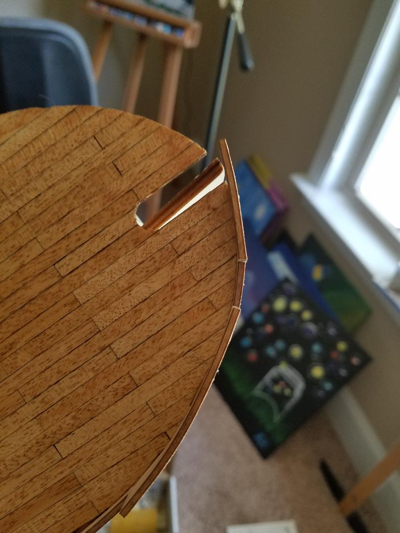

Thank you everyone for the nice support and comments. I do have some progress pics. I managed to get the starboard side precut "planking." This is such a great idea compared to others I have seen. My only complaint though is that the radius at the front is too great for the narrowed area between the opening for the cannon and the bowsprit. Both sides of mine snapped. It is ok as I basically glued it all back together and used nails to hold the curve that were driven into the plywood for the deck. Anyway, I am hoping that since this didn't take as long as I thought, that I can get the other side at least done before we leave for vacation.
BTW, for anyone reading this, micromark sells some really nice sanding blocks designed for ship building. These worked great making the hull ready for planks. I used the wide one over the main portion and the small one at the front and stern portions.

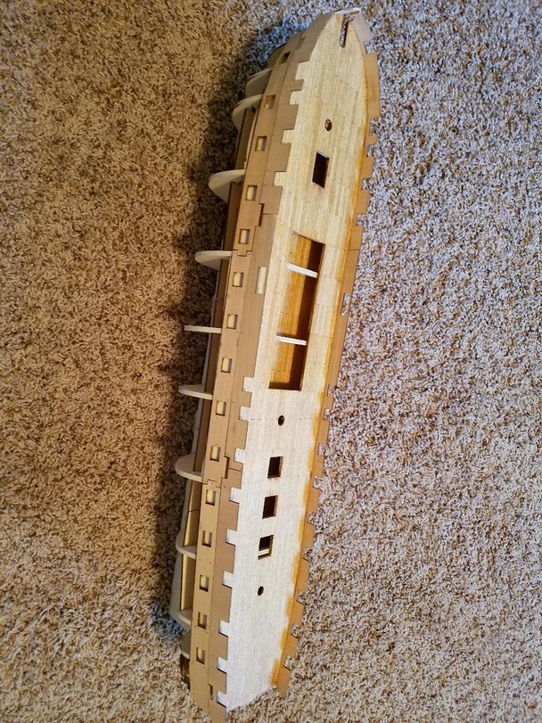

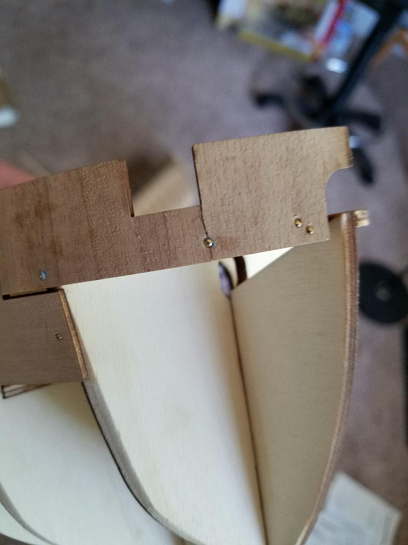

Bit of an update as I have had some free time to get a few things done. Both sides are now on. As you can see though, I had a bit of some trouble. The front pieces snapped in the same spot on both sides. This is due to those pieces being essentially plywood. Other than that, not too many issues. Will start planking the lower hull either tomorrow or Wednesday. Also, anyone want to show me how you nail that last photo in? lol

BigGrin Looking good and nice work. As for the bow ply pieces pre-shaping them helps a lot you could have used a couple of methods by either using an electric plank bender to pre curve the ply or the other method would have been to soak the ply in water and then using a suitable curve like a large paint pot or bucket and fixing it in place with elastic bands or tape to hold it overnight.Cool
