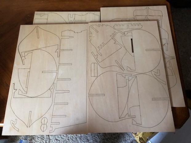

Thanks everyone for the warm welcome! The first package arrived today, and I’m going to take my time to get this right. My first question- the main frame reinforcement pieces seem to extend all the way to the bottom of the keel- does that extra thickness from 3 layers of ply get dealt with later? I did find the PDFs for the entire build on the modelspace.uk site, so presumably its in one of the build guides?
Here’s my first unpacking pix! cheers- Scott

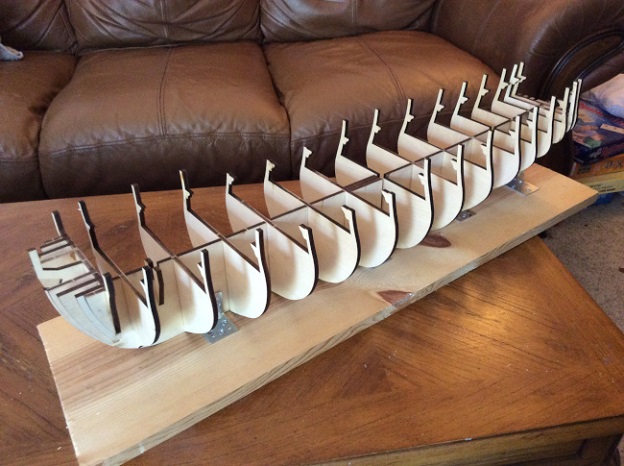

#12 Posted : 26 May 2018 19:47:44
Joined: 19/05/2018
Posts: 14
Points: 42
Location: Madison WI USA
Frame fitting- some are a bit loose & wobbly, some others required sanding of the slots. All left unglued at this point, and I’m still planning where to drill wiring holes for LED lighting.

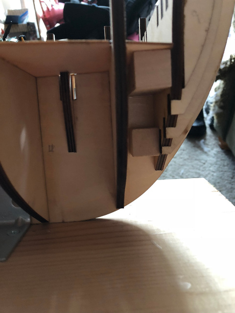

OK, now I think it's showing up- seems to take the forum a few minutes to display it? Here's the stern frame 25 with stern collars 26.
Milw attached the following image(s):

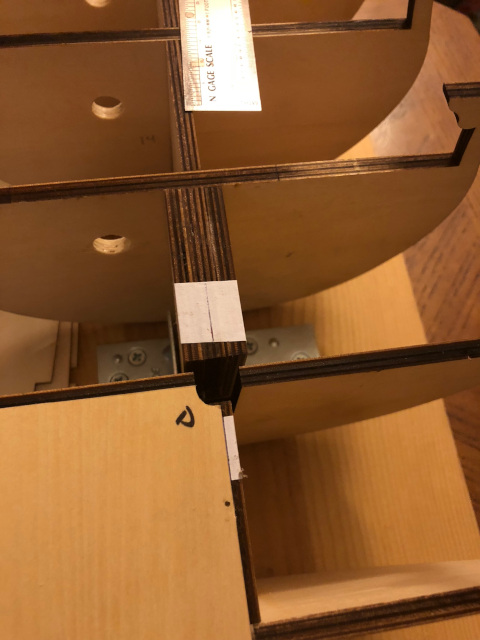

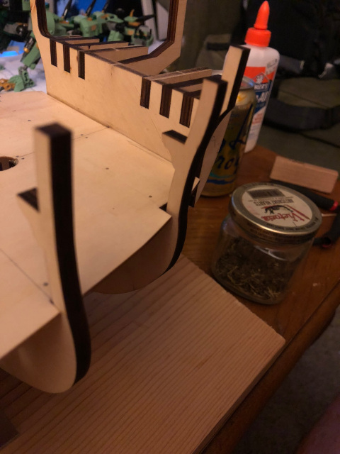

Hi all, the second installment has arrived with plywood gun deck and assorted planking for the deck and hull. I do have a few questions (lower down) but first the fitting of the deck plywoods! I glued some white paper on the vertical keel so I could mark and see the centerline more easily.

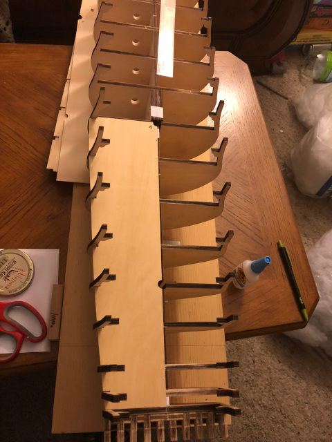

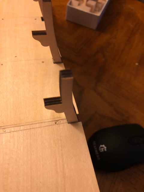

I added some extra blocking behind the first frame (Frame 5) with the winding frames, since it had a bit of play. It was clamped with a right-angle block while the glue dried to ensure frame 5 is square to the vertical keel.
After attaching the gundeck plywood, it seems the plywood extends out a bit past frame 16, but doesn't quite extend out to the outer edge of frame 10 (second and third images below.). I think the extra ply should be trimmed back to match the frame before planking, but up front the deck planking should come out a bit to be fair with the outside of frame 10?
#19 Posted : 02 July 2018 07:54:11
Looking good, the deck does sand down when faired. There also may be a small gap but isn't seen as there is an inner layer added and most of it isn't seen after the main deck is in place.
