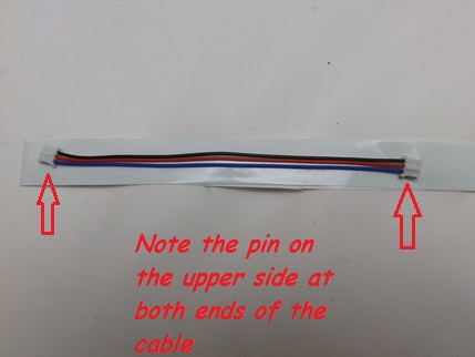

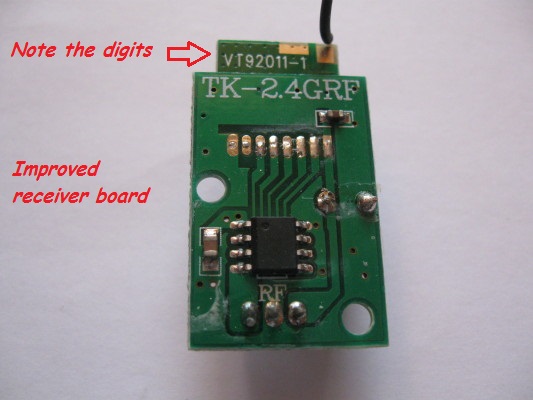

#5 Posted : 08 February 2018 08:19:40
You will shortly receive an improved receiver board which is to be swopped with the existing board in the tank, (photo shown in post #6).
Also, there is an error in the instructions on Page 155 at Stage 9, which should say: plug cable B into the B socket and plug cable C into the C socket., you need to make this swop.
Can you also check that your Cable F (supplied at Stage 40), has it’s wires in the exact same configuration at both ends of the cable and that the wire configuration is exactly as shown in the parts photo of cable F in Stage 40. If your’s differs, you need to swop around the wires to create the correct configuration as per the photo below..
#6 Posted : 08 February 2018 09:28:49
Improved receiver board

Hi Tomick, Hi Andy,
Yesterday i ve recived The nee Receiver Board. He has The correct digits.
Now is The Receiver in The Tank. The cable F is correct. The Motor Cables are A to A and B to B.
Start The Tank.... The Front lights are flashing slowly. The backlights be out.
Turn The Remote Control on, The Rex led ar still on.
But i can Not Start The Tank Starting....
I Need help 😉
