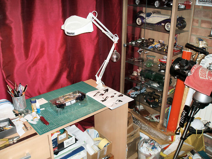

Um - yes, more space needed...
I keep building these huge models, but never learn.
They're even piling up on the dining table now.
My (infinitely) better half is even working round them to wrap Xmas pressies...

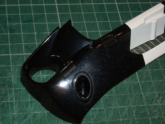

A small start.

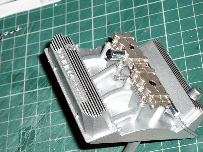

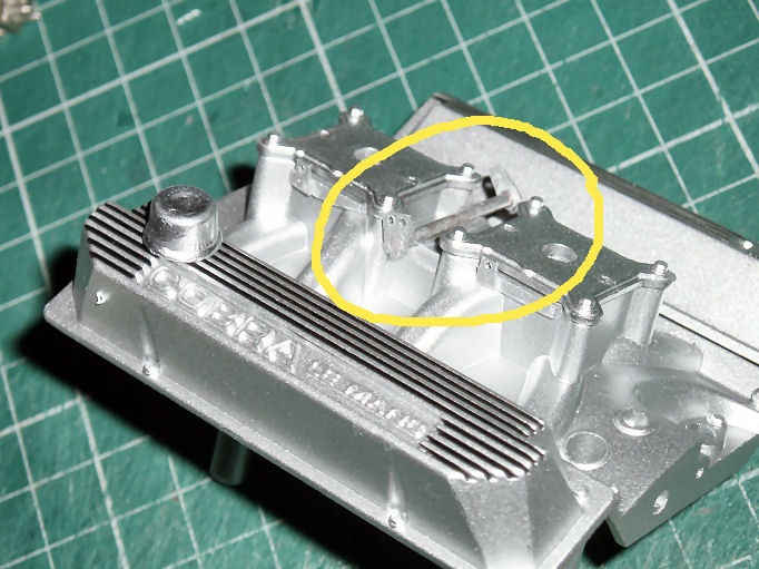

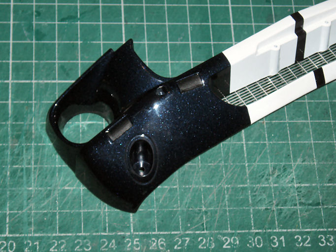

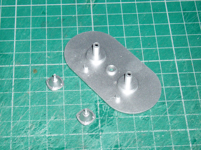

First off - the small air vents under the front bumper should be open but being metal, I just opted to colour them matt black...

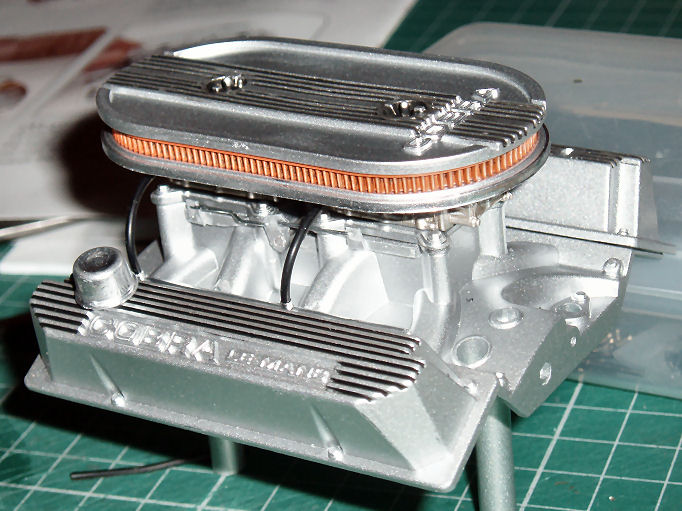

The engine.
Hmmm...

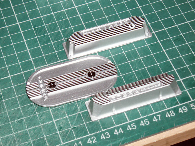

The cam covers and air filter top have been blacked in the grooves just for the sake of a bit of decoration.
Fuel float chambers were removed and shifted as they were in the wrong place - too far inboard.
Put back, and the missing balance pipe has been added...
Roy.

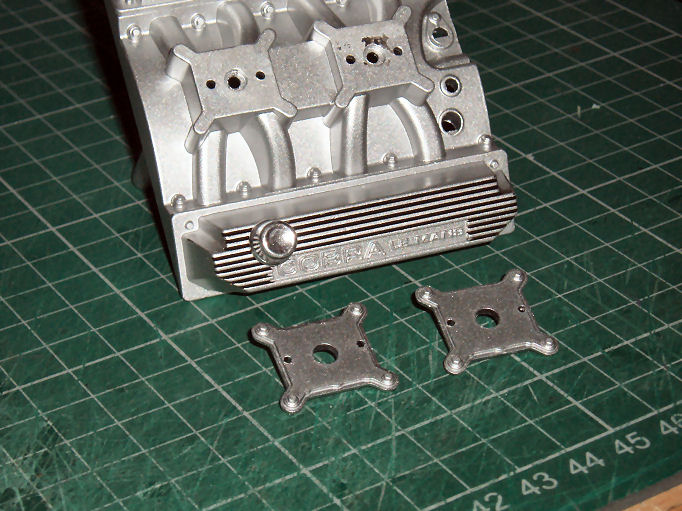

I've skipped issue 2 for now as I don't need the wheel and stub axle parts yet so why build them and clutter my already cluttered space...

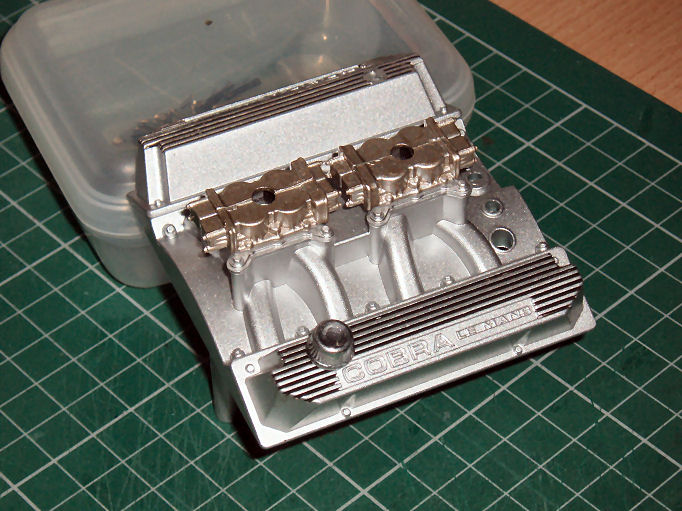

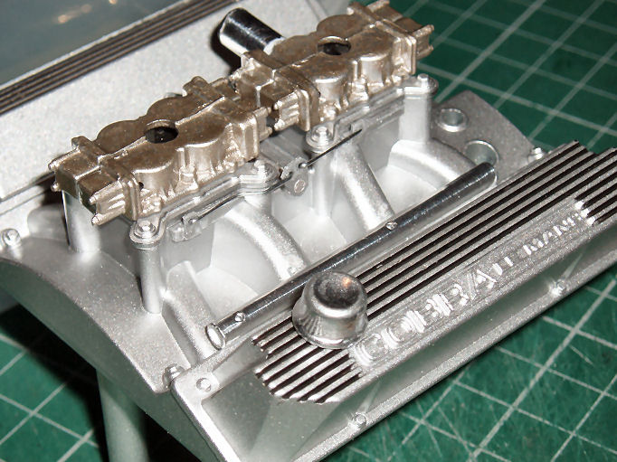

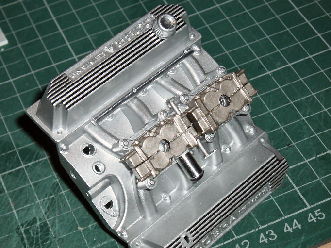

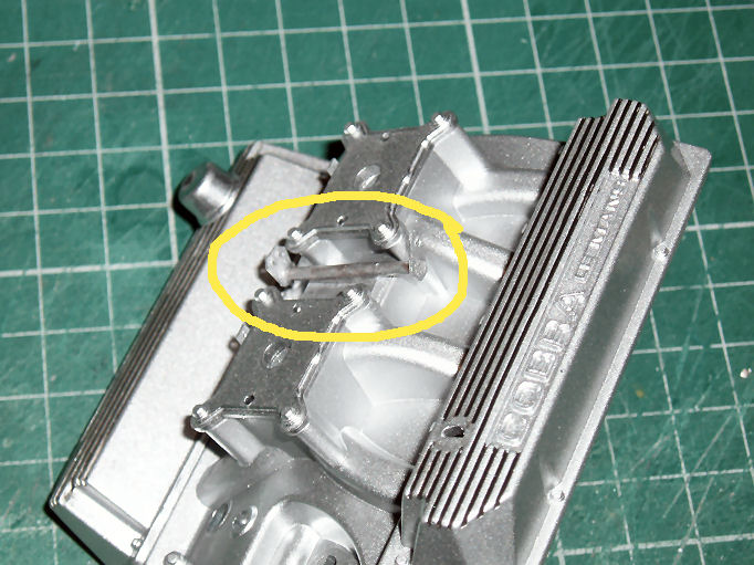

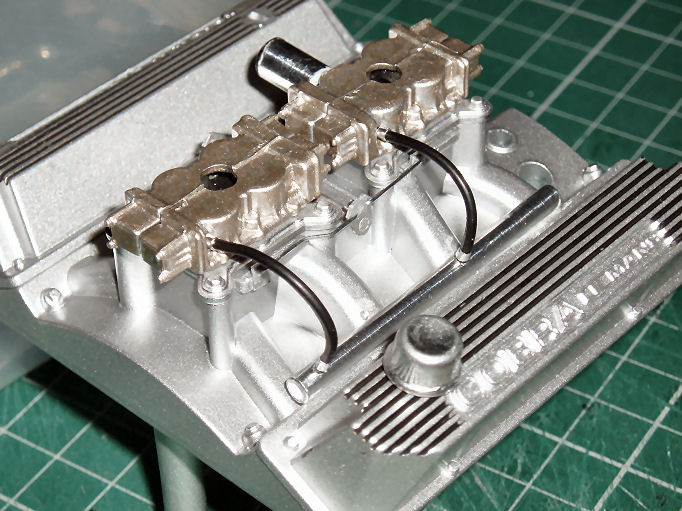

Carrying on with part 3 and lumps of the engine.

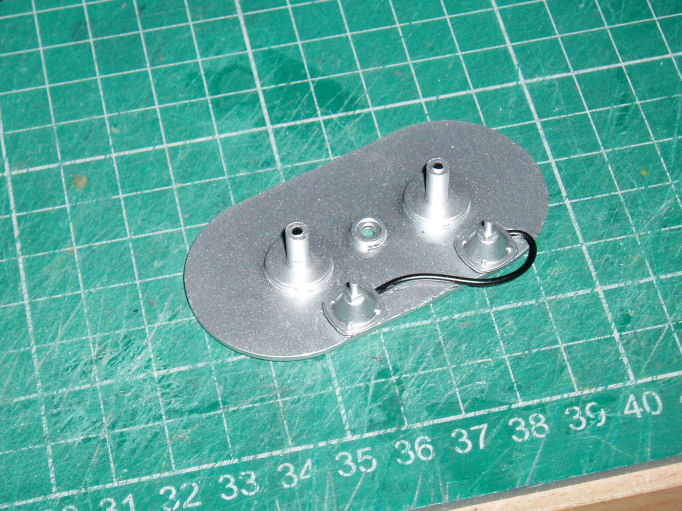

I removed the carb mounting plates as I needed access underneath them to add the throttle linkage rod (missing) and then the actual linkages.
All of these bits are 'representations' of the real thing so they are similar and close enough without rivet-counting.
I like to be able to look 'in' to a model once built, and discover things not immediately noticeable. For me, adding these little parts is all the more fun.
Once these assorted bits were added which also entailed building the manifold out on one side to take the linkage mounting brackets, the top plates were put back.
The carbs were added - painted a light bronze-silver as per umpteen Google images.
The actual linkages were made from thin wire and added, as were the breather balance pipes, again missing from the kit.
I also added the fuel bowl on the front carb. Fuel lines to be fitted later.
There are still a lot of pipes and linkages to be added but they will have to wait until the main engine block is assembled.
All good fun.

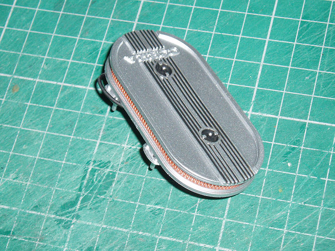

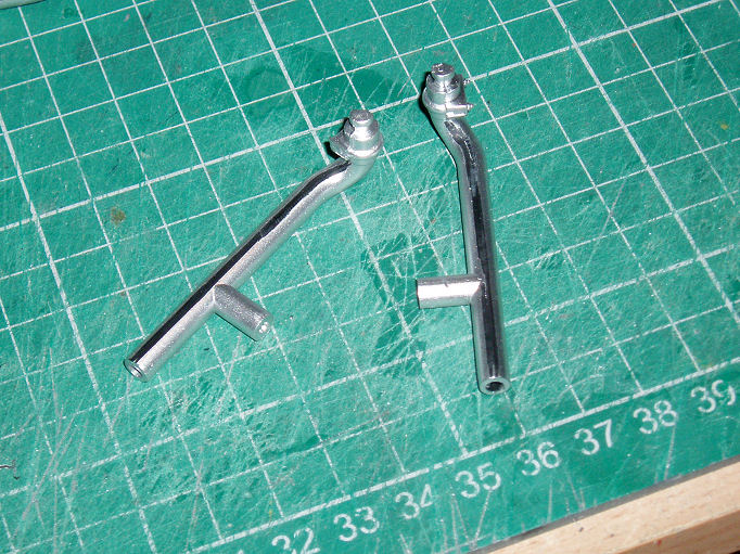

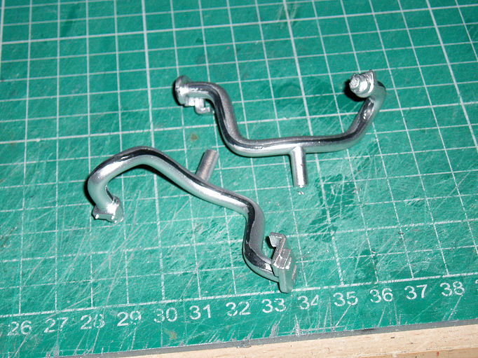

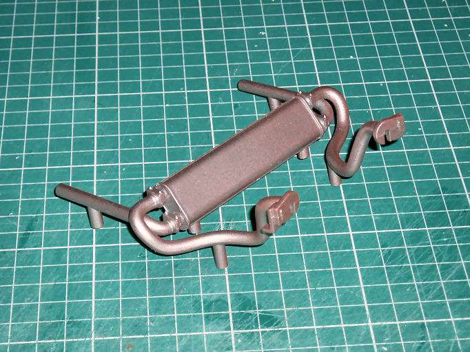

I've sorted the rear exhaust parts after de-seaming the pieces.
A light coat of Halfords steel, a touch of graphite grey, and then a mist of red oxide primer for a slight surface rust look.

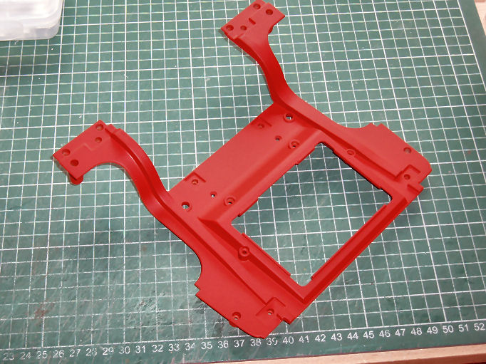

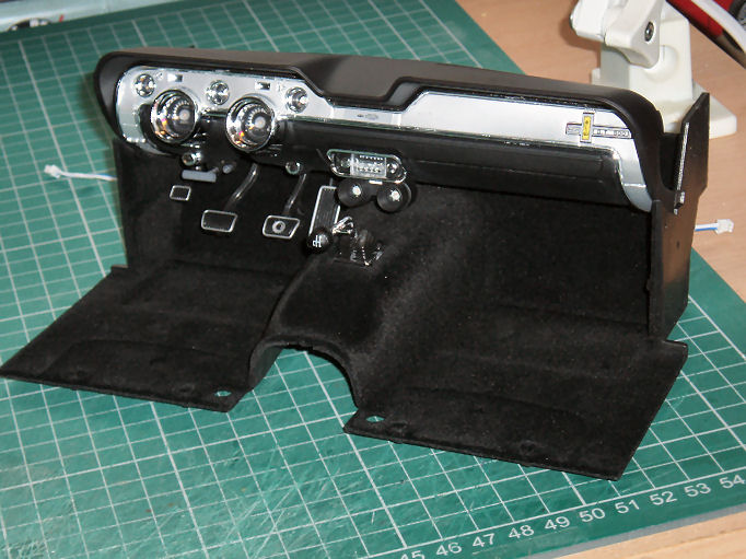

I've had a look at the floor parts and it seems that removing the flocking isn't easy - quite a bit of Googling.
Also, re-colouring it isn't really viable.
So - two options...
Leave the interior black but leather trim it all
Go with red leather on all of the seat parts, door panels, trim etc, but leave the carpets black.
I'm not sure that would look right though as I've never seen any cars with seats/interior that are different to the carpets...
Any thoughts/ideas?
Roy.

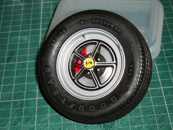

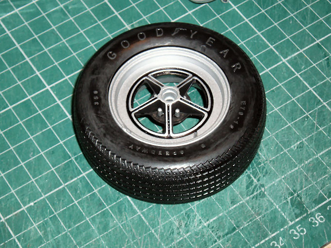

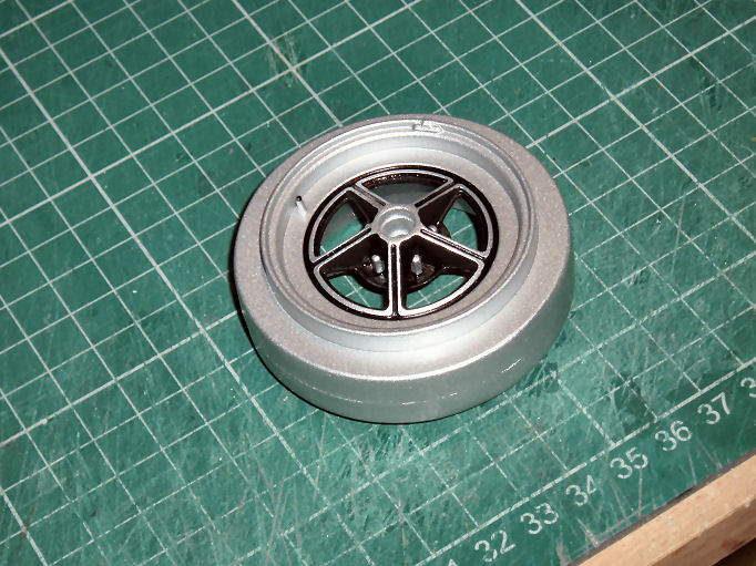

Any way, first wheel sorted.
All very straightforward although I painted the caliper clear red over the silver, for a bit of 'bling'.
I also painted in the black on the wheel.
Fitting the tyre...
It says (somewhere) heat the tyre - NOT boiling water.
I dumped my tyre in a bowl of boiling water.
2 minutes later, out, dried and laying on a marble chopping board.
I laid the wheel on the tyre and pressed down very hard with the palm of my hand.
POP... Tyre in place in two seconds.
Roy.

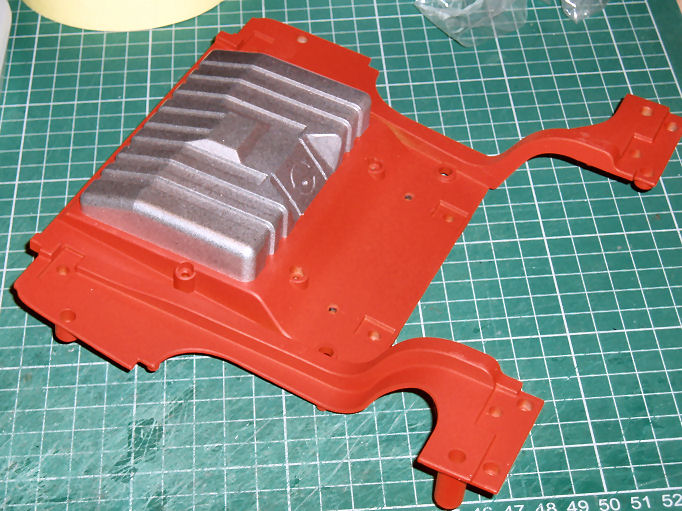

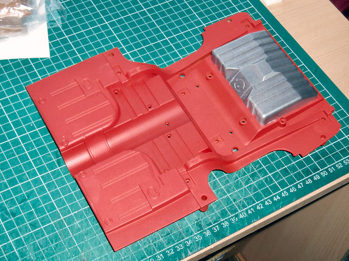

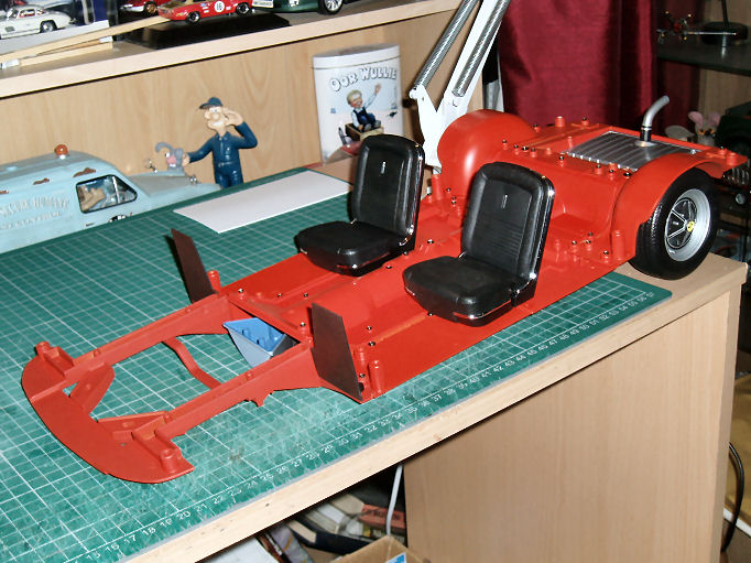

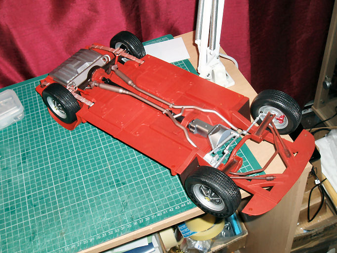

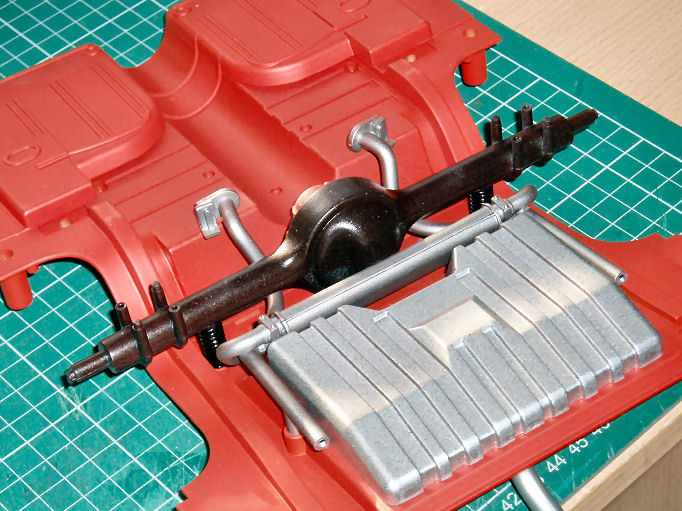

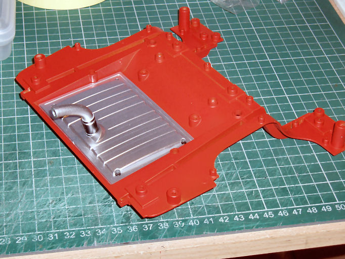

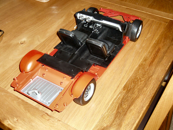

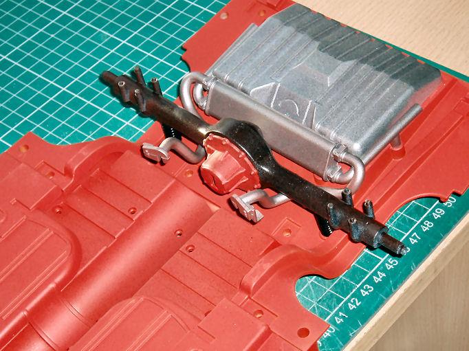

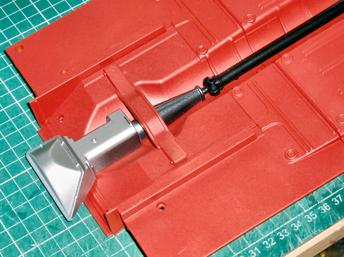

I've made a start on the floor sections.
The parts have been repainted red oxide with a light mist of matt black.
It doesn't show in the pics but the parts are now quite a bit darker than the bright-ish orange they were originally.

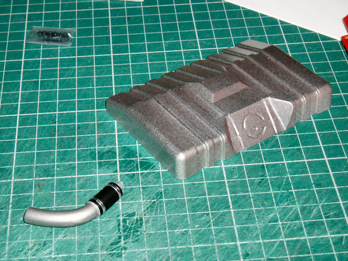

Fuel tank also repainted and I removed the moulded-in fuel pipes so I can add separate ones later on.
Also de-seamed the filler pipe and added some jubilee clips.
Rear axle also assembled and repainted satin black with a mist oflight matt brown to replicate a bit of surface grime.
Roy.
#16 Posted : 19 December 2017 17:07:21
Posts: 5,058
Points: 15,320

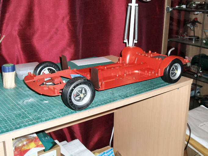

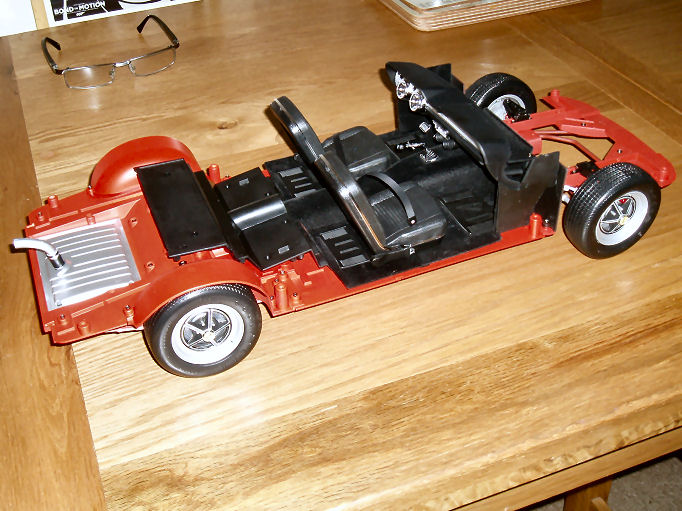

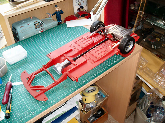

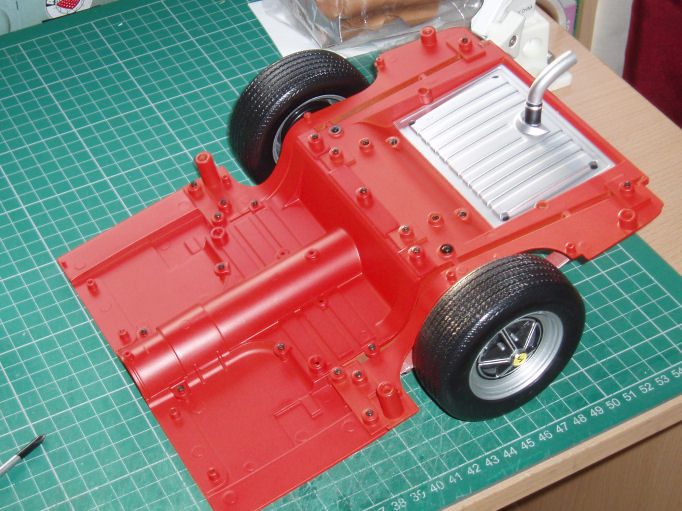

Well, only a small update although quite a lot of parts.
All the rear suspension etc is in after being toned down with matt earth and matt black 'mist' spray.
The wheels have been painted and fitted.
The transmission has been repainted ally and gunmetal as all the reference pics I can find of original cars shows that it isn't blue.
It seems that restored cars have a gearbox etc that has been painted blue.
Anyway - a bit of colour variance.
However - MASSIVE DISAPPOINTMENT...!!!

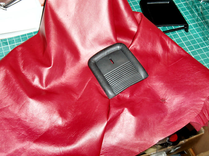

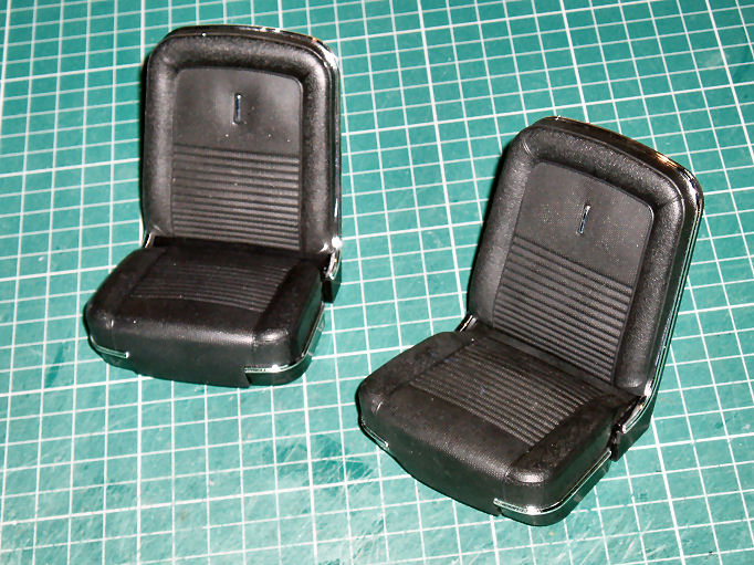

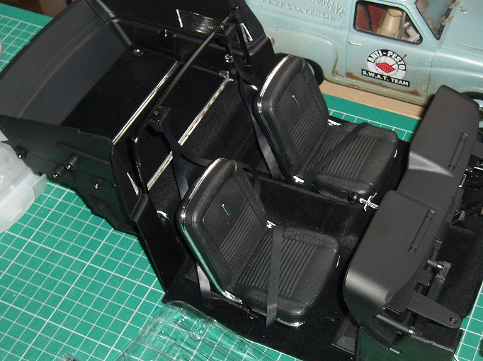

I spent about 3 hours trying to cover one of the seat parts in real leather.
Now, anyone who followed any of my previous builds will know that leather trimming upholstery holds no fears for me.
I've re-trimmed more model cars that I can remember.
The problem - the kit seat parts are made from a soft vinyl that will not take glue or D/S tape.
The leather covering just comes away from the seat.
I de-greased the parts, scrubbed them, dried them - no effect.
The leather will NOT adhere.
The only upside is that the seats are actually quite realistic and do look like the nasty vinyl/rexine that was used in the '60's.
I hate to leave the car innards 'as-is' but there's little else I can do.
Ho-hum.
On we go.

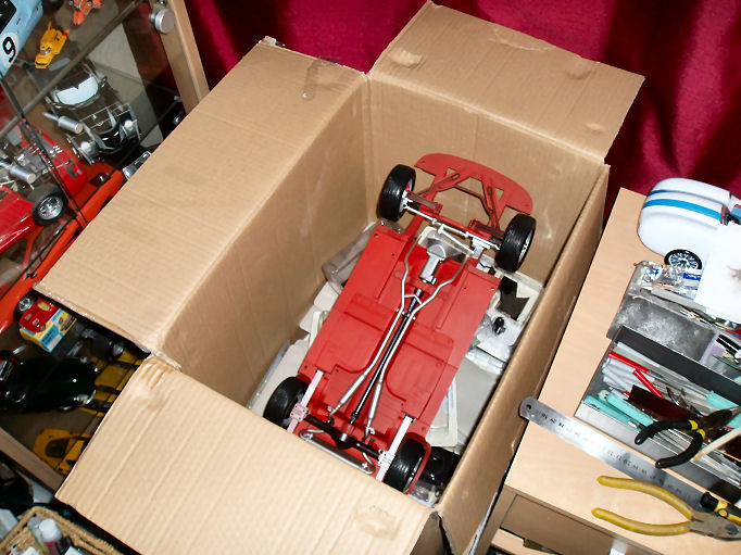

Last update for now, maybe last update - full stop.
Possibly get back to it later but at the mo, not a priority build for me.
Back in storage for however long.
Absolutely NO disrespect to the kit - it's great.
Just not 'me' at present.
Keep peeping in - I might finish it one day.

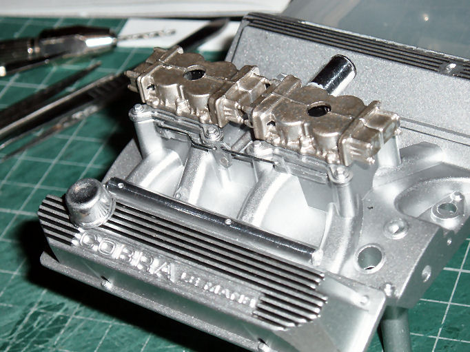

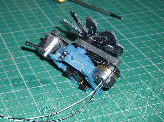

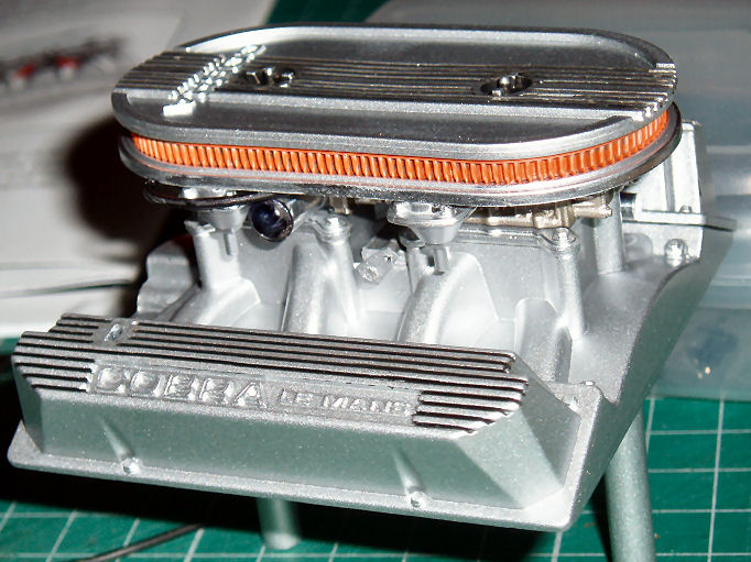

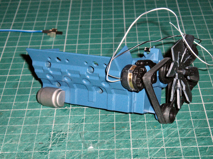

I'm back on the engine (for me, the fun bit) and some of the parts have been cleaned up, repainted and assembled.
I say 'cleaned up' in the broadest sense.
The fan belt part must surely have the biggest seam lines ever seen on a kit...
I had to resort to a fairly rough grade metal file to remove the 0.5mm ridge running all the way around the belt.
However, once smoothed with 300 wet and dry, the belt surface looks quite authentic.
The alternator was repainted according to Google reference and the wiring added, to be connected elsewhere later.
Also, the 'gas filter' (I suspect, starter motor) was de-seamed and repainted.
I'll need to do some research on that piece to verify exactly what it is...
