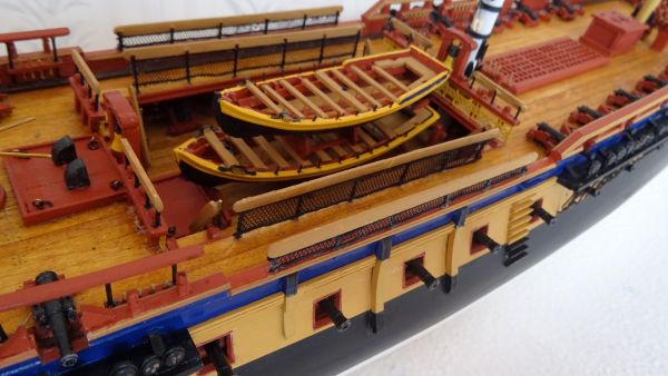

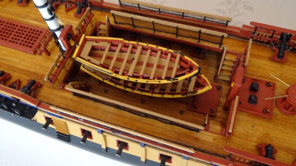

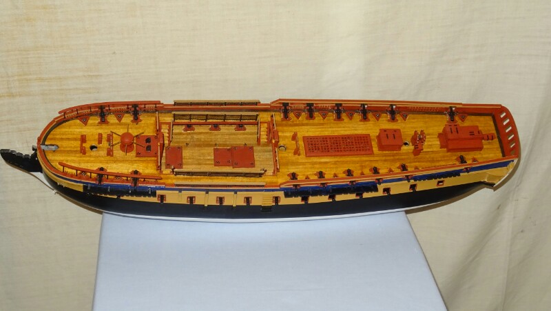

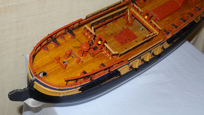

#12 Posted : 19 February 2018 19:11:08
Joined: 25/08/2017
Posts: 14
Points: 51

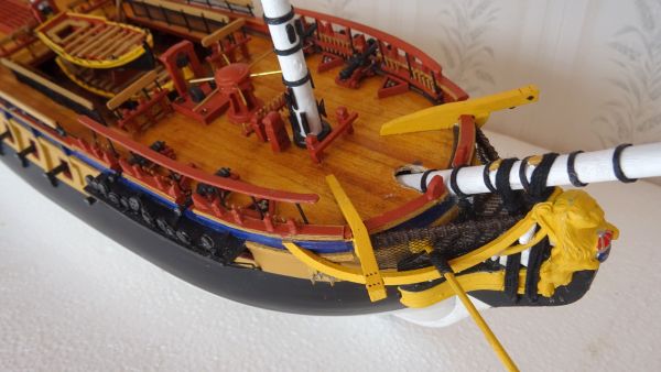

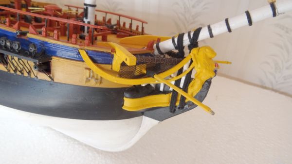

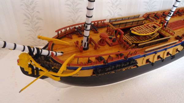

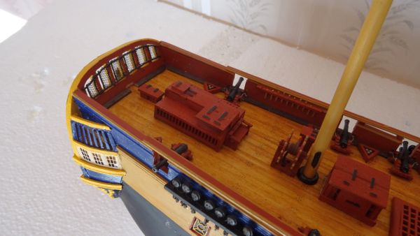

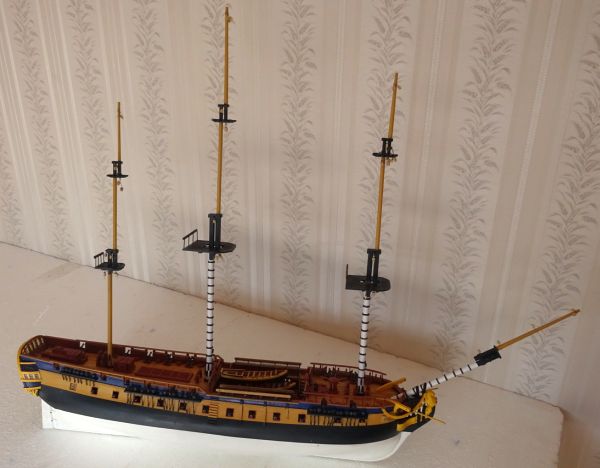

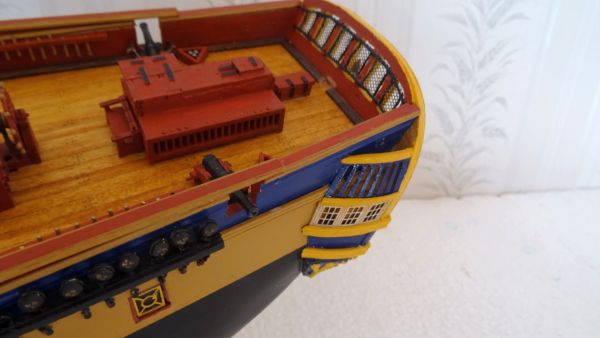

Hull finished and I have just started on the rigging. I am worried about doing that as I have done no rigging except on a 14 ft sailing dinghy. I don't expect that will be much use. Having looked at the instructions for the rigging, only pictures, no written instructions, I am expecting to have problems so will probably need help.. Had no real problems with the hull, my biggest problem was gluing some of the smaller items onto already painted surfaces. Tried several different approaches but still find I am breaking the smaller items off during subsequent work. Paintwork was good initially when stage 16 had been completed but has deteriorated significantly since then. I attach a few pictures of the finished hull. The camera has shown defects that I didn't know existed.
Norman.
clockmaker attached the following image(s):
#13 Posted : 19 February 2018 19:55:57
Hi Norman,
Looking at your build to date and judging by the quality of your work then I'd say don't worry about the rigging, I'm sure you'll do a great job. Looking at the instructions they look fairly straight forward and once you get started you'll find it all making sense. If you post up your progress on a regular basis then I'll be able to see how your doing and be ready to give you guidance if needed. Any problems then by all means get in touch with me and I'll respond....Cool Cool .. Help is always at hand....

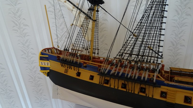

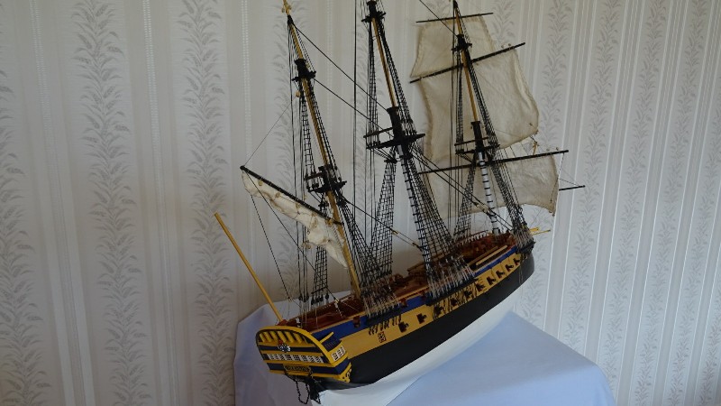

#17 Posted : 13 September 2018 18:44:07
Joined: 25/08/2017
Posts: 14
Points: 51

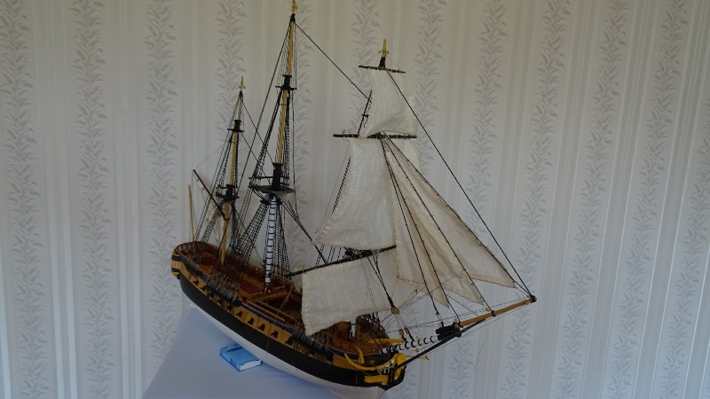

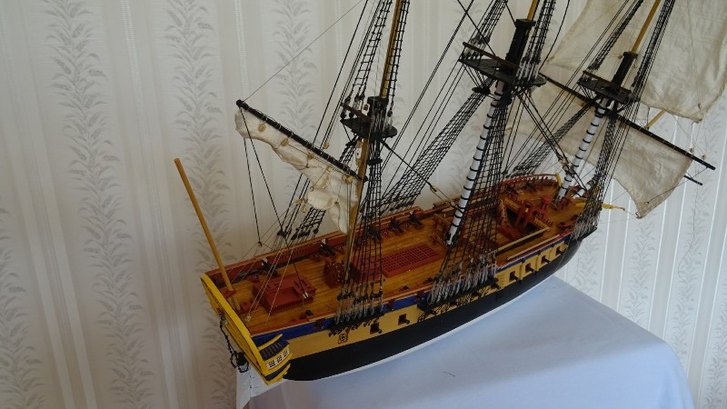

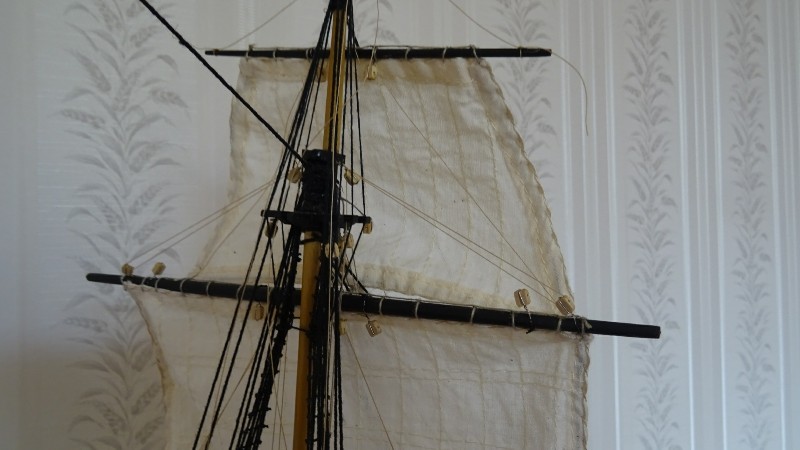

Just a few pictures showing where I have got to before hitting a major problem.
Had no major problems with the standing rigging but have found rigging the sails difficult
clockmaker
#18 Posted : 13 September 2018 19:02:41
Joined: 25/08/2017
Posts: 14
Points: 51

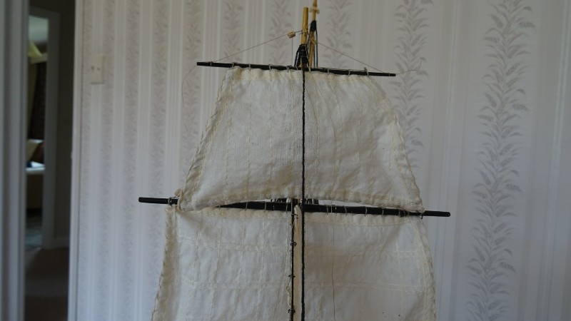

Now for the major problem.
If you look at the uppermost sail in the attached pictures you will see that it overlaps the yard of the lower sail. On checking all the dimensions of this mast and checking against the full size picture supplied with the kit I find that the length of the upper section of the mast TR3 (given in 24.PDF image 912 ) is incorrect. I believe the length should be nearer 136 mm. Unfortunately to correct this means a lot of work removing shrouds, splicing an extra section on to the mast and the replacing with new shrouds.
I would appreciate it someone would double checking this dimension. If this error can is verified can the manufacturers of the kit be notified
#19 Posted : 13 September 2018 20:37:51
Hi Norman, I'll take a look at this and come back to you.....
She's looking really good....Cool Cool Cool Cool .. Lovely work...
