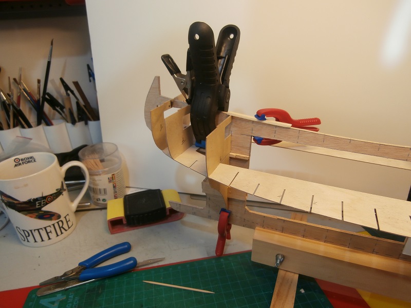

The keel piece was traced onto 3mm ply using carbon paper and cut out with a Stanley knife. I cut out a 3mm wide section where the prop shaft will be fitted and glued 3mm ply strengthening pieces across each side of the cut out, this forms a pilot hole which will then be drilled out to take the prop shaft. A similar operation was performed for the rudder tube. Pic 2 shows the keel held in a keel clamp.

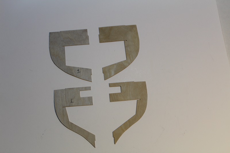

The frames are produced as half frames, Pic 3, and there are 24 frames (48 half frames) in the hull. To cut these out I scanned the drawings and then printed the frames out. These were then glued to the 0.8mm ply with photomount and then the individual half frames cut out. The frame number was then marked in pencil onto the ply and the paper removed from the frame.

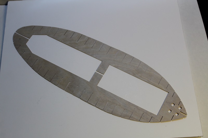

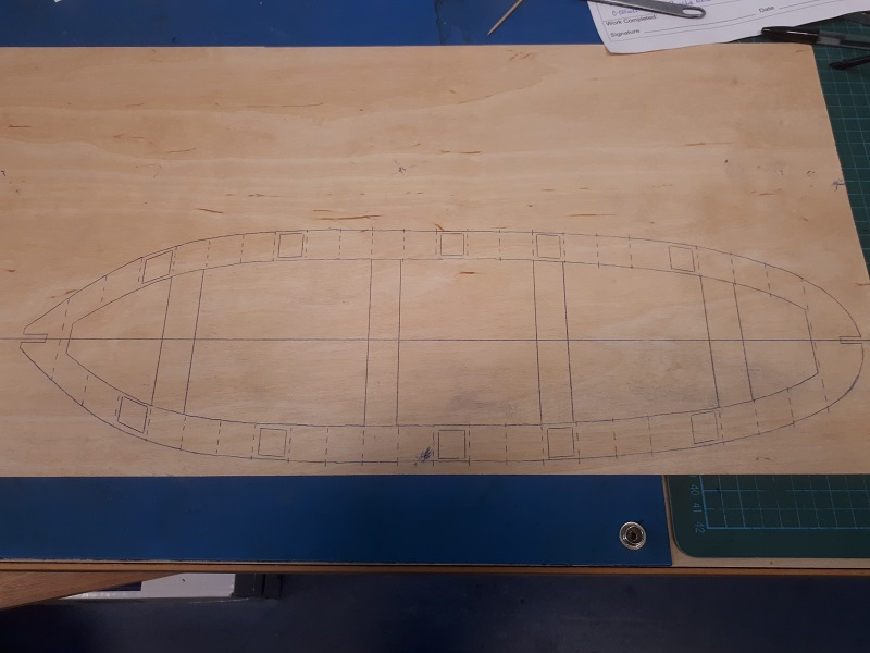

A waterline deck piece, with slits cut to position the frames, is used and this was again traced out using carbon paper – this time onto 0.8mm ply – and again cut out with a Stanley knife, pic 4.

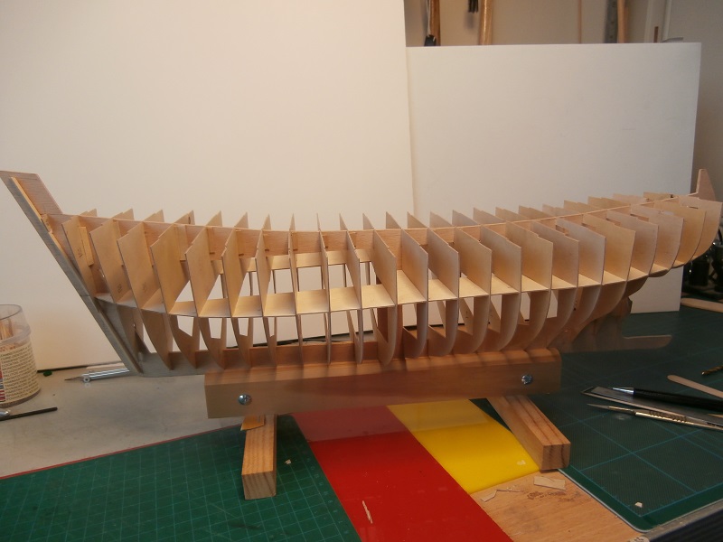

A scupper deck runs around the top of the frames onto which the main deck is later screwed down. Pic 5 shows the scupper deck traced onto 0.8mm ply prior to being cut out. The marked square sections are the positions for strengtheners to be glued under the deck where the main deck screws will be located and the four cross sections are temporary stiffeners which will be cut away later.

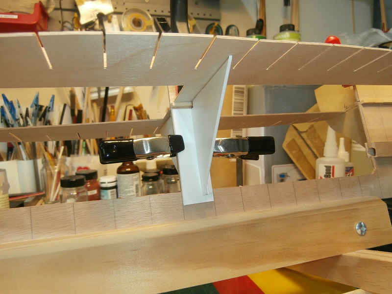

3mm square strips were glued to the keel at the waterline to support the waterline deck (these can be seen in Pic 2) and I made a couple of supports from scrap plastic card which were clamped to the centre of the keel to temporarily support the waterline deck until some of the frames were glued in place, pic 6.

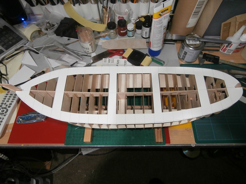

Just a brief update, I have now attached all the half frames to the keel and apiece of triangular bead to each side of the keel at the bow to support the hull plating when fitted.
I checked the beam measurements at all the frames and compared them to the marked out scupper deck and found some slight discrepancies where the actual beam was slightly wider than the traced deck - probably poor tracing on my part - so I have decided to make a card template first then, when correct, use it to mark out the ply.

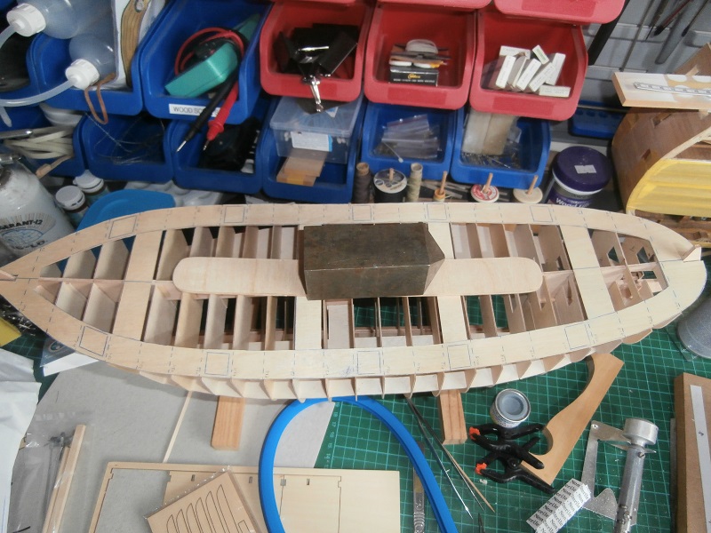

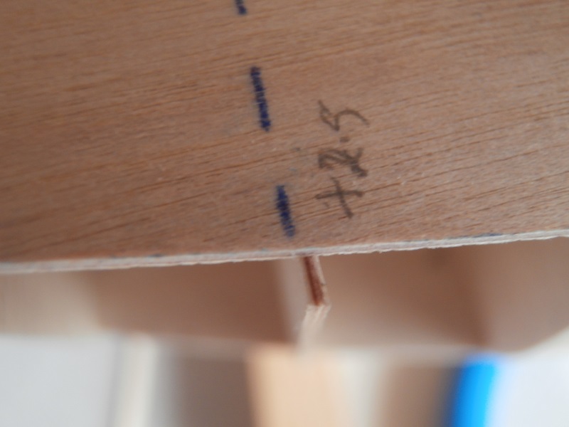

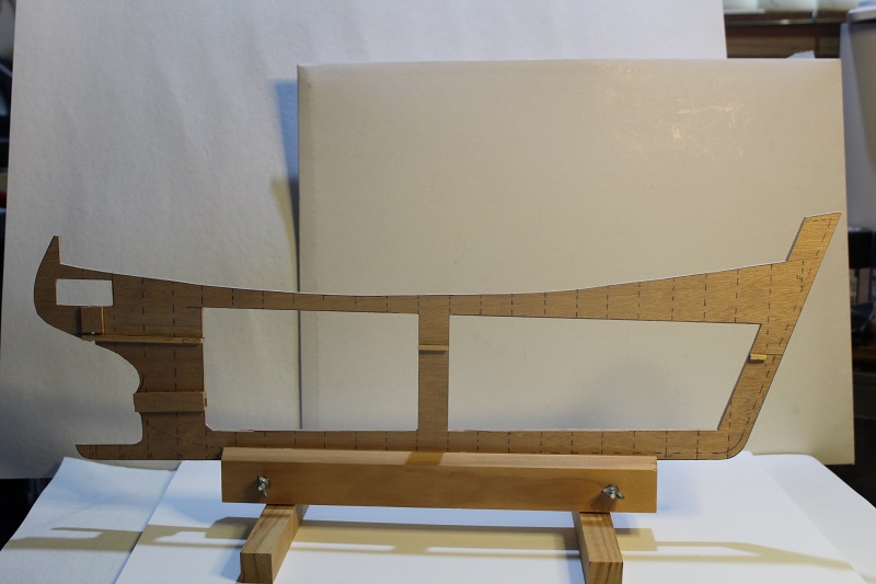

#13 Posted : 20 October 2017 10:15:46
Thanks for looking in and the comments guys.
As I said in my last post, when I test fitted the scupper deck it was short of the edges of the frames in several places. To rectify this I weighted the deck in place, Pic 1, I then measured the discrepancy at each frame position and noted this on the deck, Pic 2.
I then placed the deck on a piece of card and drew round it. I then marked the correct positions at each frame and using a flexy curve re-drew the deck outline. This card template was then cut out and test fitted on the hull, Pic 3, and was found to fit correctly.
This template will now be used to cut out a fresh scupper deck but that’s for the next update.
