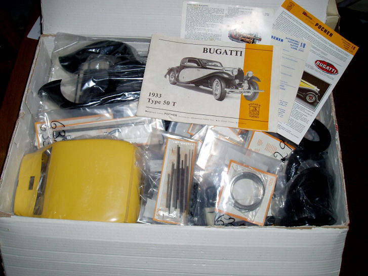

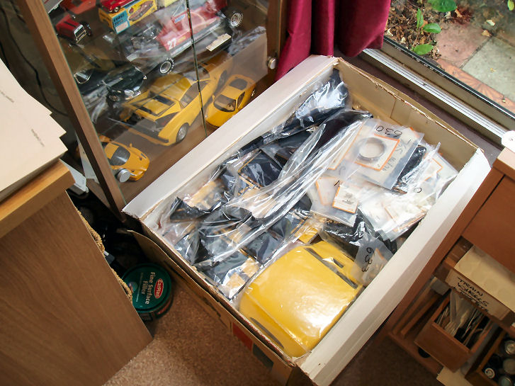

Time to have a look at this one. It's been in my stash for a long time, along with the Pocher Mercedes.
I chose to have a look at this one as the Merc is harder to get at in my pile!
No idea on a final colour scheme yet. I do like the black and yellow but it seems a bit 'done to death' with this kit. I'll do a bit of Googling for ideas.
This will be a long project I imagine as it's a monumental kit with godness-knows how many thousands of parts. Also, I already know there are umpteen missing details.

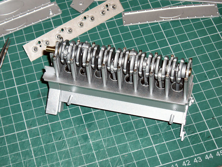

Righty-ho chaps.
Off we go.
I haven't posted a particularly detailed WIP here before, so now I'm going to bore the pants off everyone.

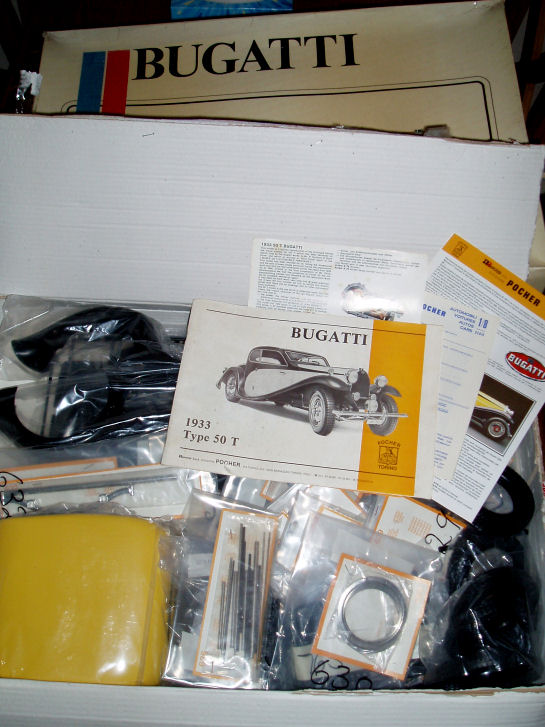

To begin - I got this kit for a ludicrously cheap figure a good few years ago.
If you're looking for expensive kits, look at Ebay around January. EVERYONE is skint, and expensive items often go cheap.
Such was my Bug.
It was sold as 'started' but I asked before buying.
A very small amount of the engine was built but everything had been checked. Nothing missing.

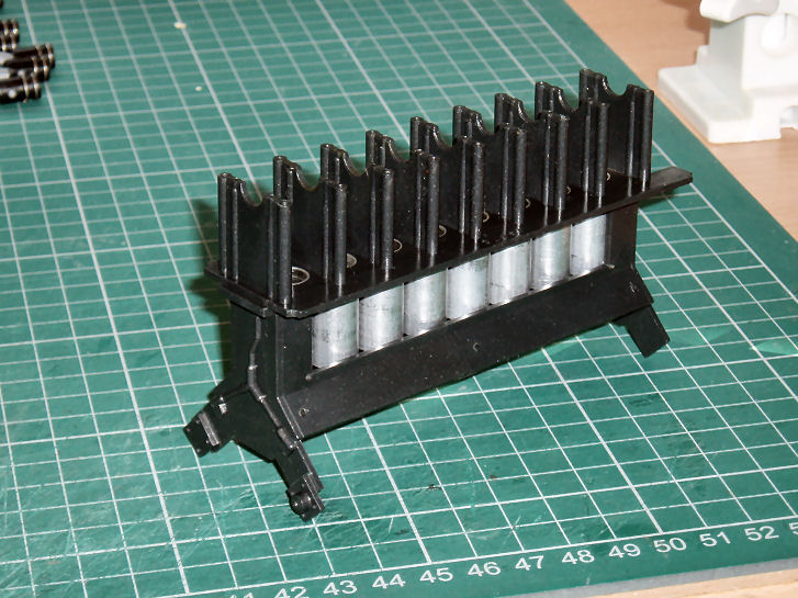

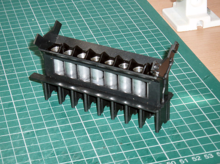

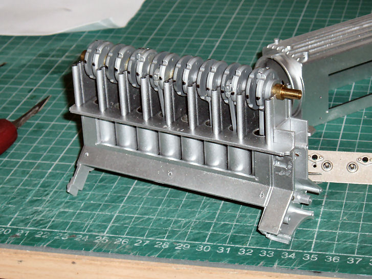

First order of the day - dismantle the built parts.

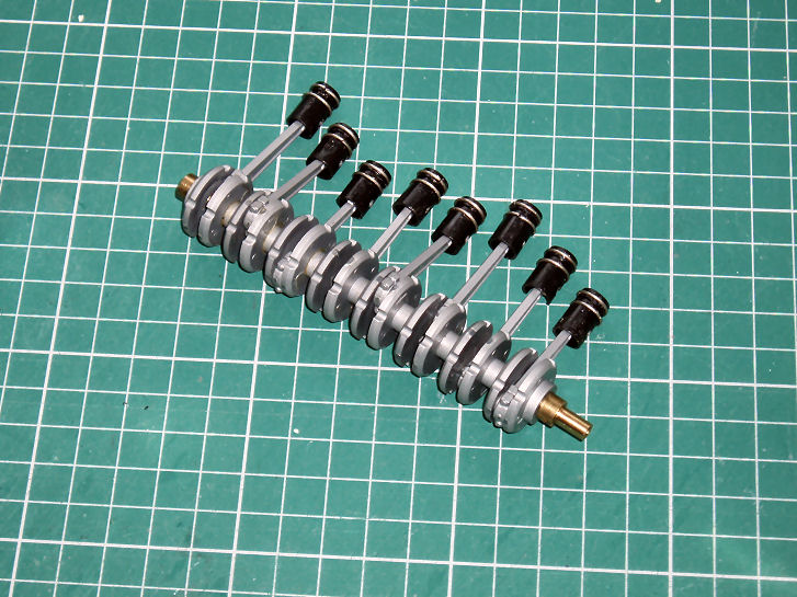

The crankshaft/pistons were already assembled and glued.
OK, not a lot I could do there but they had been put together properly and as they are never seen in the end, it mattered little.
The main engine parts were cleaned up, painted and assembled.
A very simple first task.
However, the detail and hard work is about to begin...
Roy.

This kit even has a full working geared differential... Why...?
Metal Mech

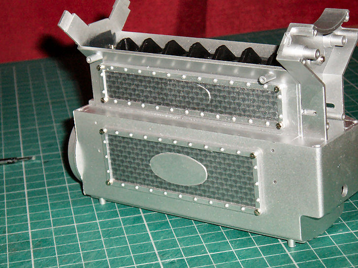

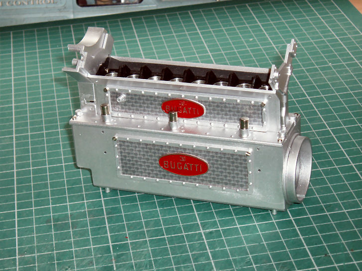

I decided long ago that for me, there would only be one way to replicate the semi-circular engine turning pattern on various parts of the car.
I printed a high resolution sheet of decal on clear film using an equally high res image of real engine turning.
As the decal is basically transparent, the aluminium colour behind shows through the pattern on the decal.
It doesn't show up very clearly in the pics but the result is quite effective.
I also have enough decal to do the firewall in the future, and the cam covers.
The Bugatti badge ovals will all need trimming out before the actual badges are fixed in place.
Roy.

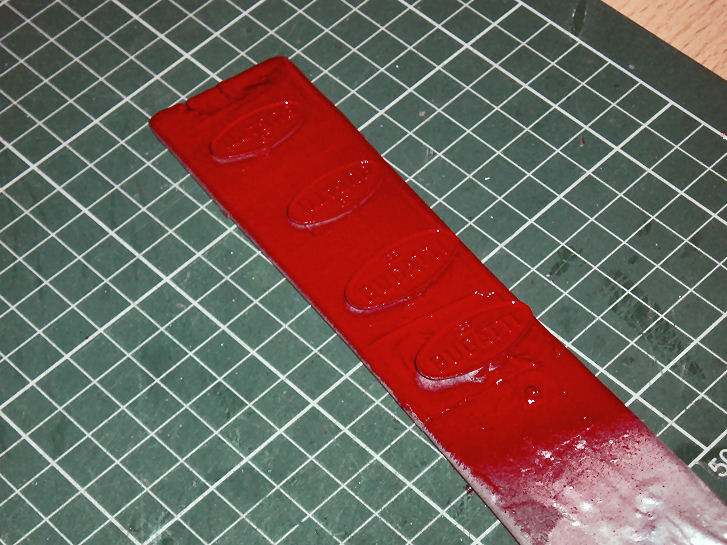

The Bugatti badges were painted red and surface-scraped to reveal the metal and are now in place.
On we go...

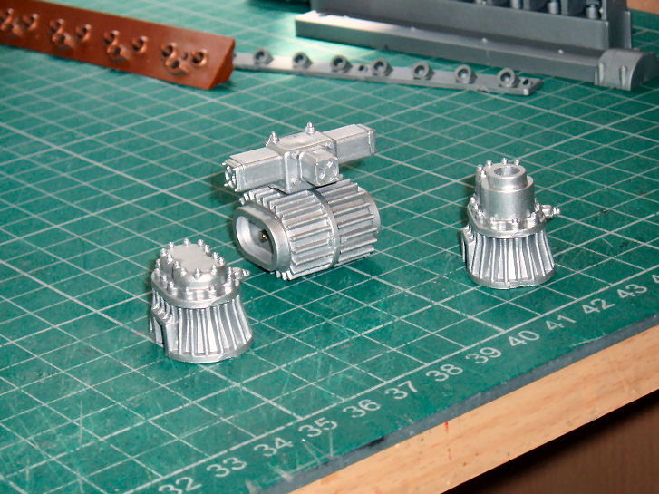

#20 Posted : 24 June 2017 16:29:42
Points: 15,326
Many thanks Keith.
I've been on this forum for a long time actually but now it's the only one I post on.
My last build was the Pocher Ducati. It's here somewhere...

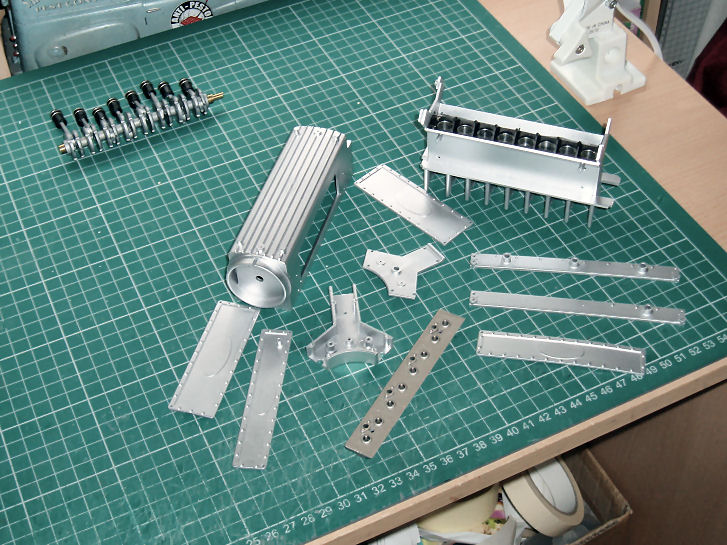

Anyway - I've started preparing the supercharger.
The pics show the pieces placed together but they aren't at all fixed yet as there's a lot of missing pies and linkages to add. One of the pics show the first of many small holes that have been drilled out to accept the scratch made stuff.
As with all 'old' Pocher classics, the parts fit where they touch - or not, as the case may be.
LOTS of cleaning up, sanding, smoothing and fettling needed on almost every part.
I can already tell this build will take a LONG time...
