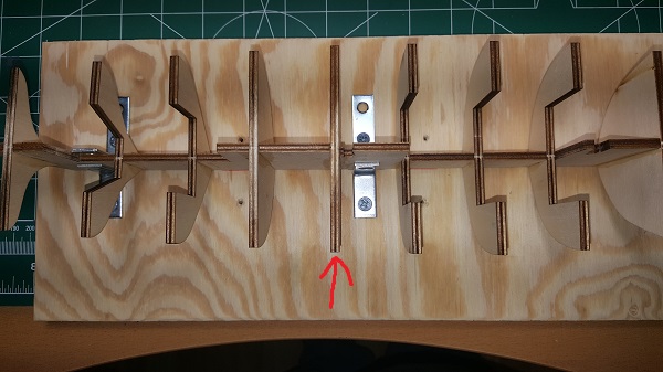

#9 Posted : 12 June 2017 20:44:18
Joined: 11/11/2015
Posts: 278
Points: 807
Don't know if this picture helps much. The keel is straight in the jig. The red arrow is the wonky bulwark frame.
Nytetrain attached the following image(s):
Best Regards,
Ron
In the Stash: Losing count...
#10 Posted : 12 June 2017 20:56:37
BigGrin Hi if you have used PVA glue a drop of hot water on the joint should soften the glue so you can remove the bulkhead and realign it Cool just wondered if you can show a pic of the keel out of the jig
Cheers Martyn

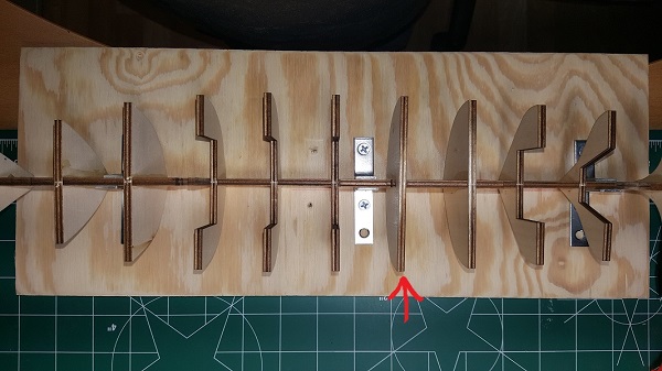

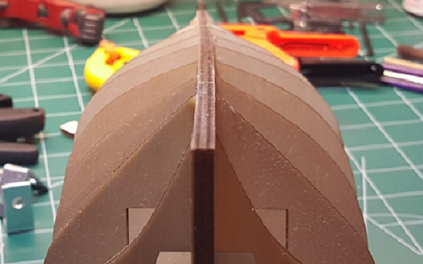

#12 Posted : 12 June 2017 22:00:32
Joined: 11/11/2015
Posts: 278
Points: 807

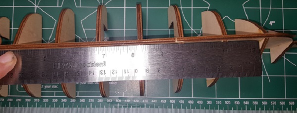

Ok so this worked out pretty good. Took Martyn's suggestion and painted the joint with VERY hot water. Gave it a wiggle and re-clamped it.
Pic 1: Measured both sides with the caliper and the square and it looks pretty good.
Pic 2: View down the keel of the bowing in it:
Pic 3: Put a straight edge along it best I could. I am hoping this will be fine when I glue the decks on. When it is in the jig everything is straight and square. This was a one piece false keel and I did notice the bow in it before I jigged it up. What should I have done to get this straight before I jigged it?
Best Regards,
Ron
#13 Posted : 12 June 2017 23:24:02
Hi Ron, you say everything is ok when in the jig. If that is the case then leave her in the jig until after you have the decks in place and the first few rows of planking done. The purpose of the jig is to make sure everything stays straight and true. The planking rows will keep everything straight but you mustn't be tempted to remove her from the jig until after those first few rows are in place.....Cool Cool Cool .. Check after each row is applied that everything remains as it should. So far looks like you're off to a good start, will be following....Cool Cool
#14 Posted : 13 June 2017 10:38:36
Hi Ron!
As Alan said - keep her in your jig as long as you can - and always check that everything is straight!

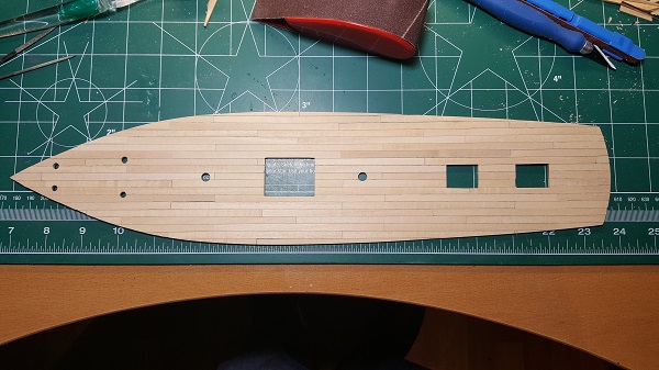

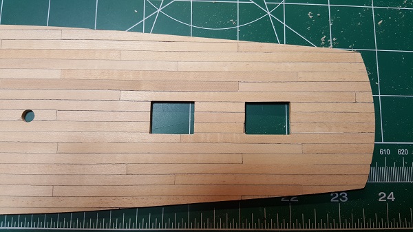

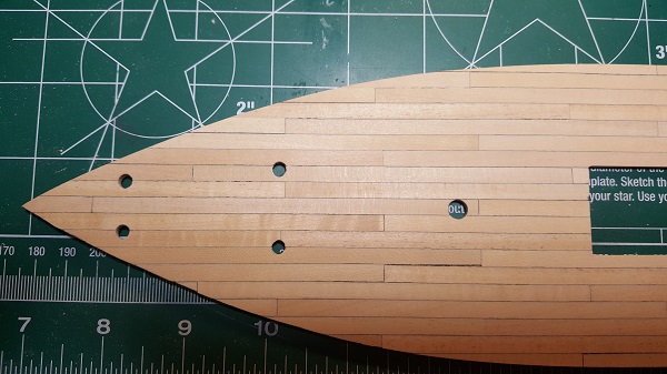

#19 Posted : 08 November 2017 01:49:55
Joined: 11/11/2015
Posts: 278
Points: 807
Ok guys here is an update: Against what you guys said I went and glued the deck planks on before attaching it to the frame per the instructions. I used tissue paper on the planks to simulate the caulking. I test fitting it to the frame several times and there is no separation of the planks. I did screw up my planking offset order but you cant tell unless you look really close. A couple of the planks had larger then normal gaps in them. I am guessing this is from them not being even all the way down. An one was a bit short by a millimeter or so but it will be covered up by the hatch frame. This is my first wooden ship build so I am learning from my mistakes for when I am ready to tackle the Cutty Sark and the Constitution. I will post more pictures when I have the deck attached to the frame completely.
Best Regards,
Ron
#20 Posted : 08 November 2017 06:27:14
