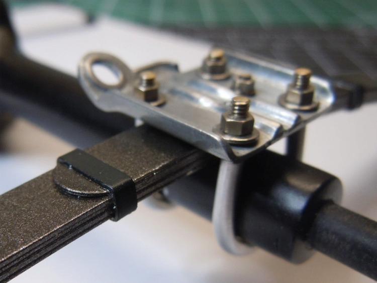

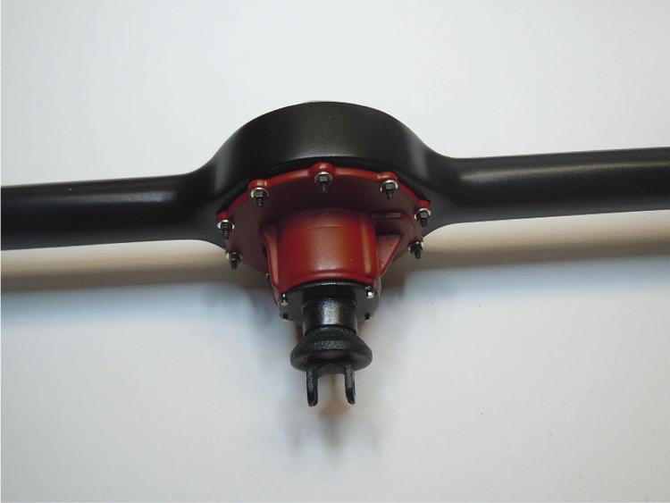

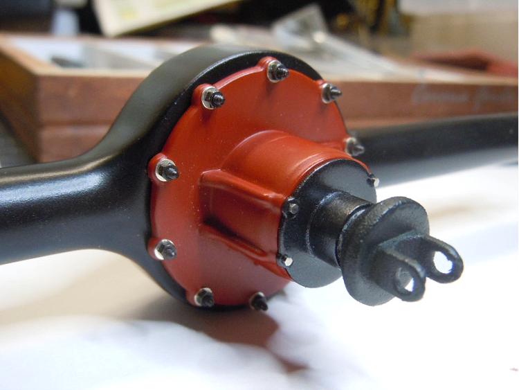

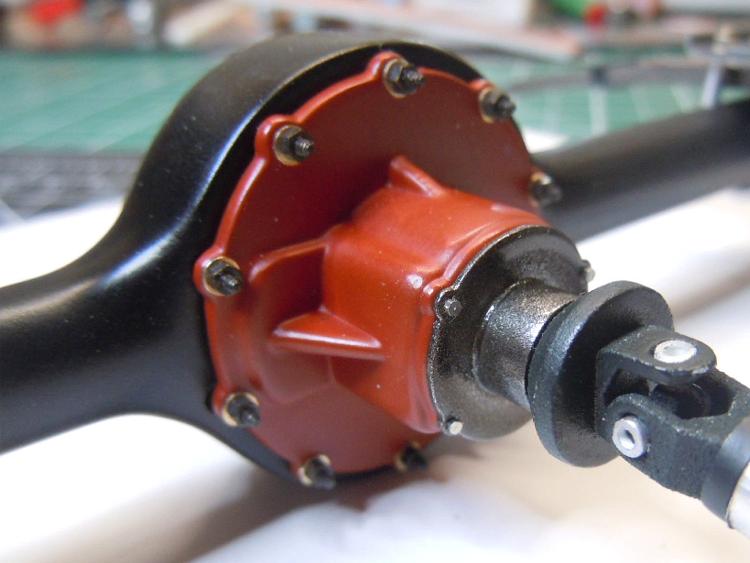

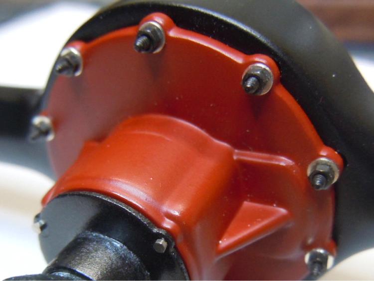

Rear end modifications
StevieDisco attached the following image(s):

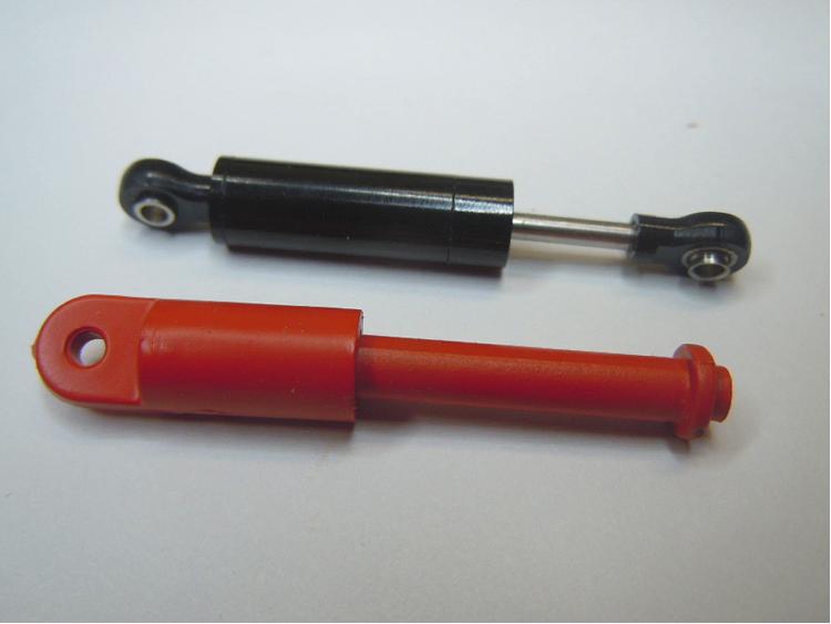

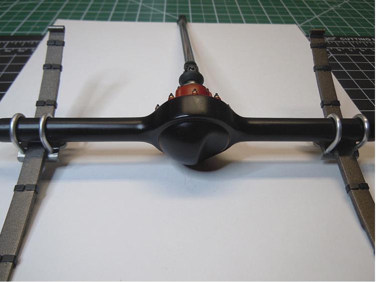

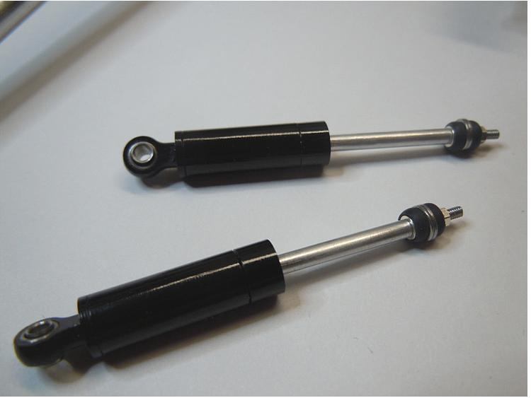

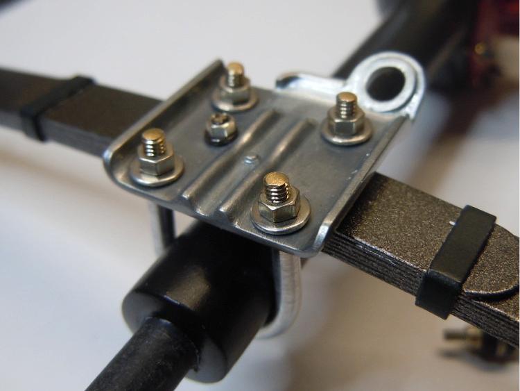

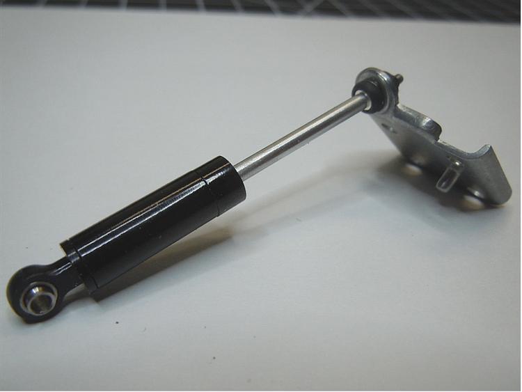

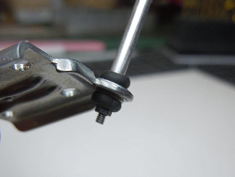

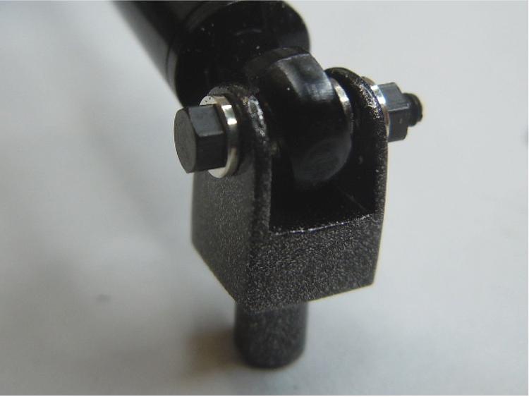

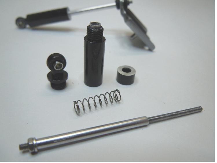

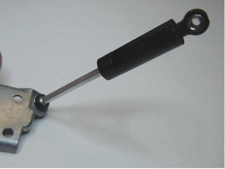

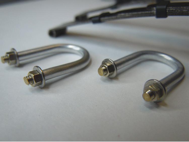

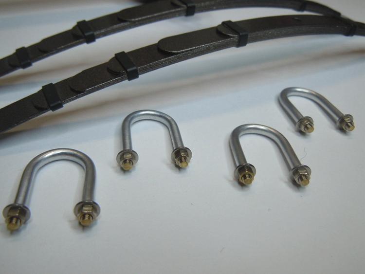

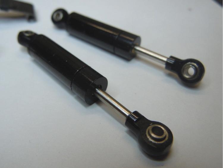

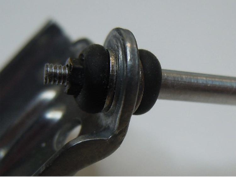

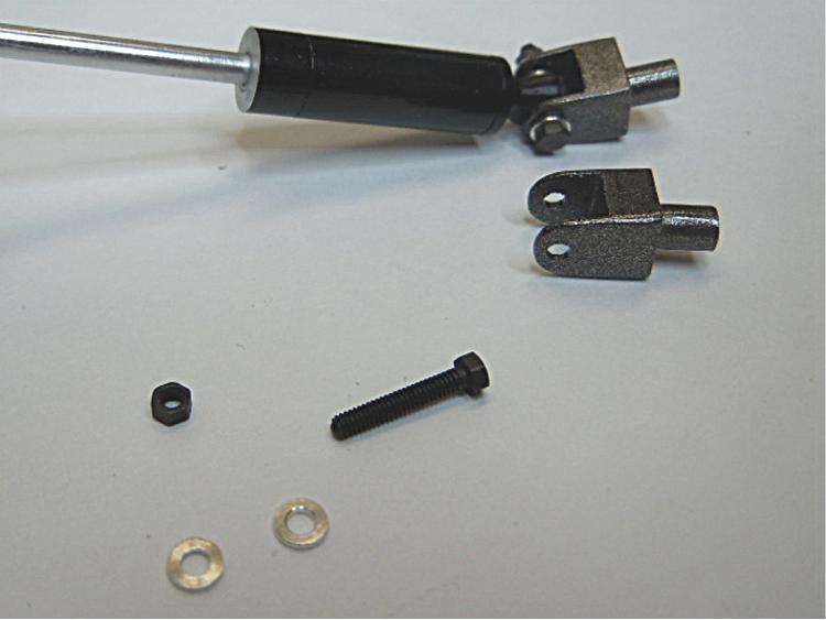

Thanks guys. Previously I posted a photo showing some 1:10 scale RC shock absorbers before I modified them for use in the Shelby. They're all metal and disassemble easily. Since I deleted the coil springs from the rear axle I need some operable shocks and these work really bice. I used 3/32" aluminum tube with 0-80 threaded rod inserted. I also had to make a new bushing out of 1/8" tube. Some rubber tube and 2 sizes of washers and a nut and that's it. They might seem a little long but when I made my own u-bolts that jacked the rear end up slightly and I'm also making my own upper shock mount which jacked it up a little also. I don't mind a little rake but if the shocks turn out to be a little too long it's easy enough to make a new lower tube.

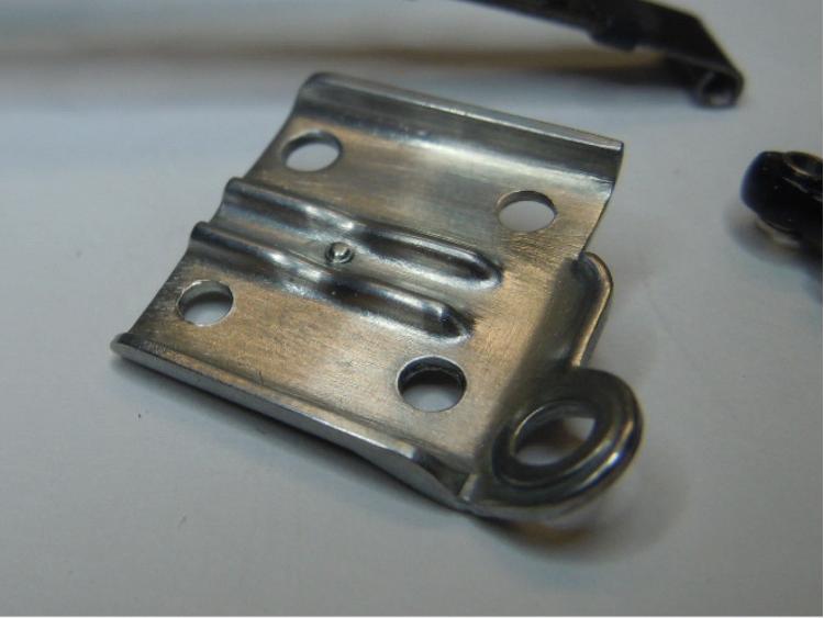

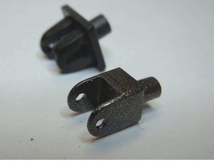

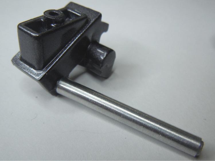

And here are the rear upper shock mounts, made from Evergreen square & round plastic tube and strip. The hardware is 0-80. The kit mount is shown for comparison. My version will mount in the same place and manner as the kit piece.

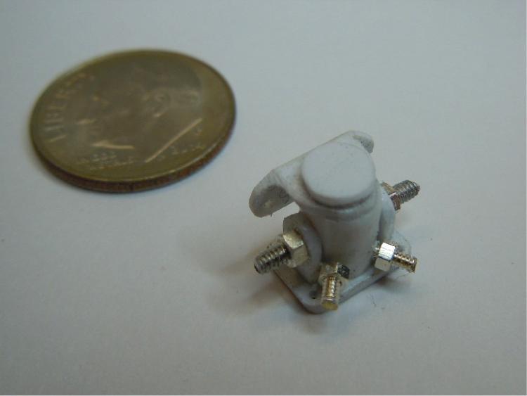

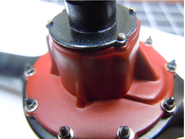

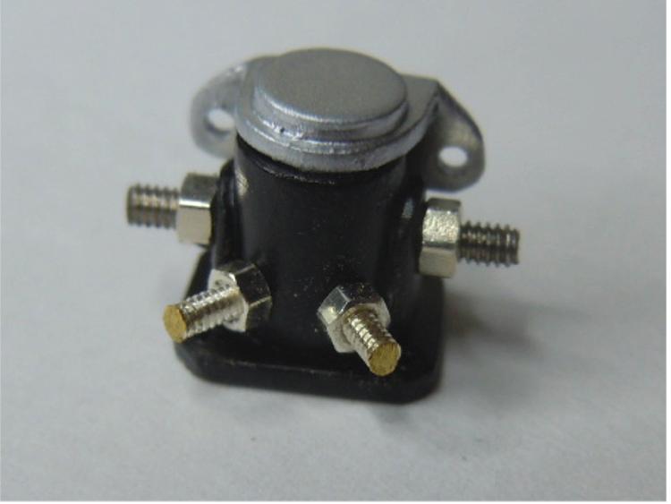

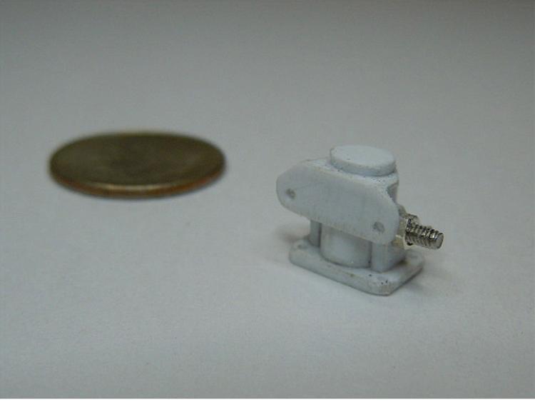

Here is my prototype starter relay (solenoid) for the Shelby. I used 1/4" Evergreen angle stock, 3/16" round tube, .040" sheet, 0-80 and 00-90 screws & nuts. I need to tweak it a bit but overall it looks to be both functional and visually acceptable. I'd appreciate any comments and/or suggestions as well as maybe photos of other members versions. I'm also making a voltage regulator.
On another note, I had to re-do my front brake calipers after inadvertently putting the brake line fitting on the wrong side. That's what happens when you work in the shop until the wee hours of the morning. Oh well. It gave me a chance to re-paint it bright red instead of Italian red which just didn't look right. I should have those done by this weekend and will post pictures.
Thanks again for all comments and suggestions.

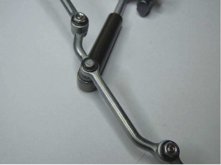

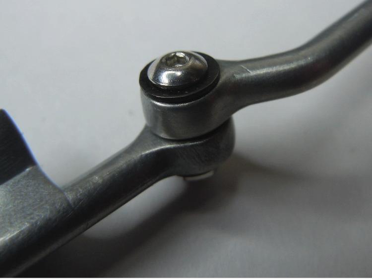

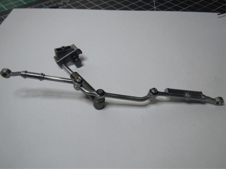

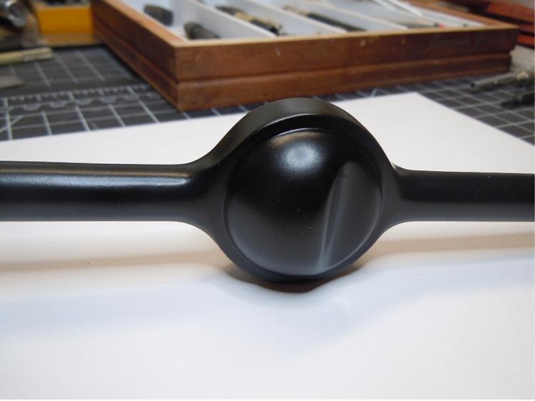

But I did work a bit on the steering rack and track rods. After stripping the paint off the parts I polished them with steel wool and then sprayed on a coat of lacquer. I'm using button-head cap screws to connect the rods as I prefer the rounded head in this application. When I actually install this assembly I will substitute lock nuts for the standard hex nuts presently securing the rods. I painted the steering box (metallic gray) and cylinder (gun metal gray).
I also finalized, built and painted the starter relay mentioned earlier. It will mount near the battery on the right side inside fender well and connect to the battery, starter, voltage regulator, etc.

Thanks guys. I got a little inspired and decided to mock up the rear end. Everything seemed to fit okay. The driveshaft is aluminum tube that will be cut to length once I know the exact length. The driveshaft universals are 3-D printed units.

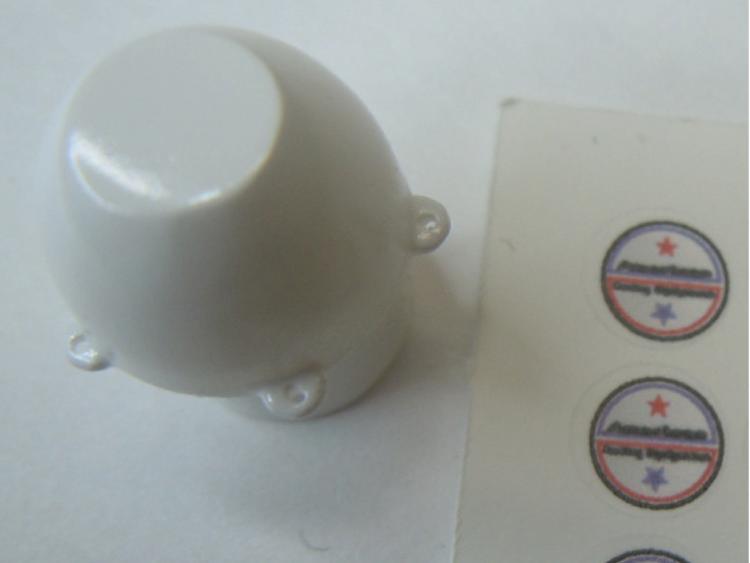

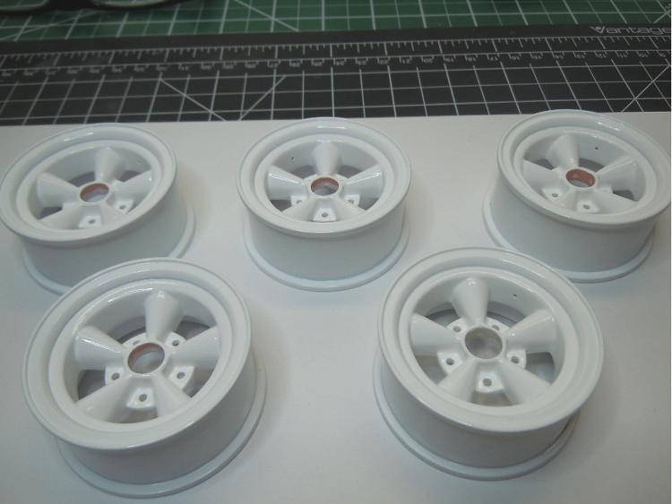

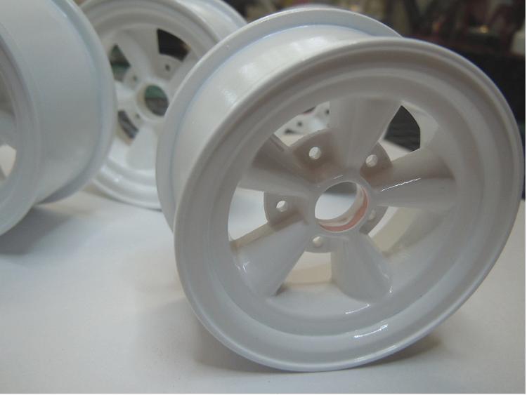

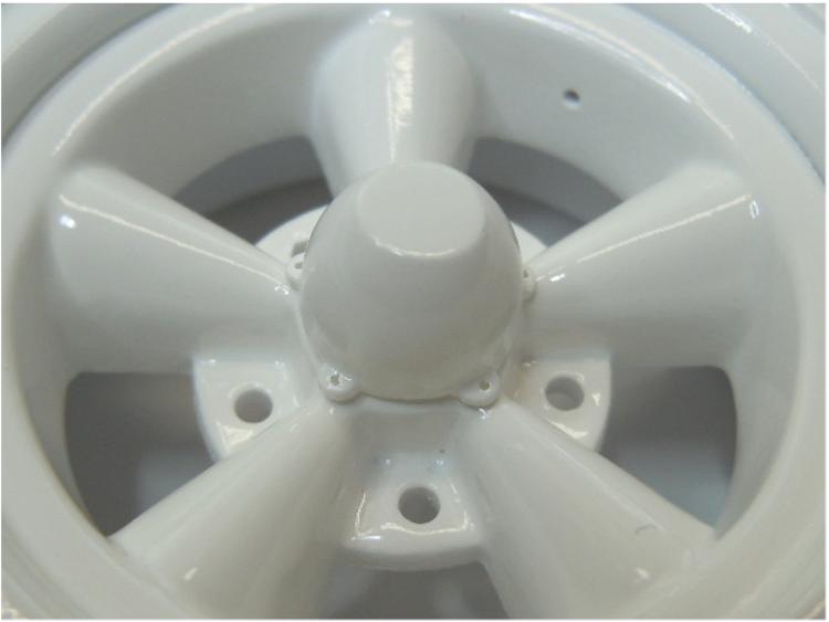

I finished applying the lacquer to my wheels so they're ready to send to Bob at Chrome Tech USA to be chromed. The American Racing Decals were done by Geoff at CustomHobbyDecals.com in Australia. He uses an ultra high-resolution printer and his work is amazing. I'll be adding valve stems from RB Motion later as well as miniature hardware for the center caps and acorn nuts for the lug nuts.

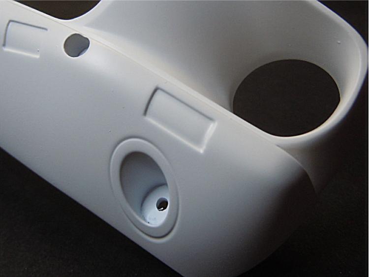

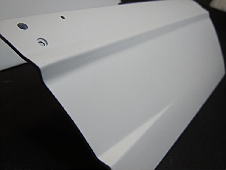

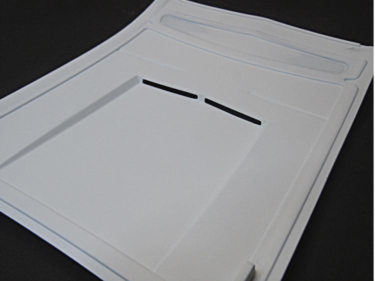

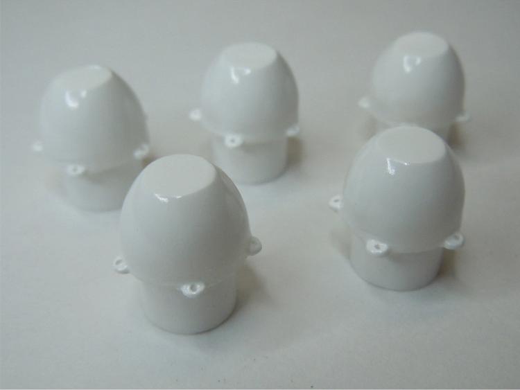

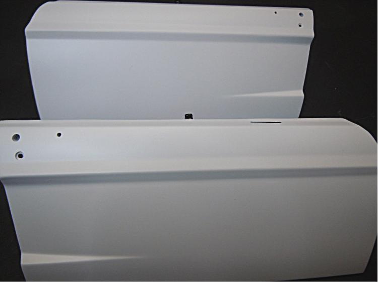

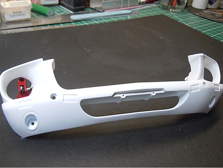

I'm also going to repaint the body. I use a paint stripper and a wire brush and steel wool to remove the paint followed by soaking the parts in Castrol Super Clean (de-greaser). The kit body parts are very nicely tooled pieces but still needed some TLC. Flat sanding from course (in places) followed by medium and fine (600 grit). I then sprayed on several coats of Tamiya Fine Primer. Next step will be to wet sand a spray on more primer. I'll then store the parts until I receive the remaining body parts and give them the same treatment. I'd prefer to paint all of the body parts at the same time for consistency.
Note also that I decided to remove the hood-pin locks from the hood.

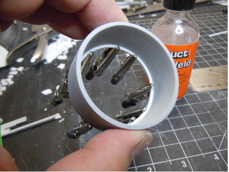

StevieDisco
#19 Posted : 15 June 2017 15:15:15
Joined: 09/01/2017
Posts: 50
Points: 150
Thanks. I'm leaning towards Tamiya Racing Green but I think all black would be nice also.

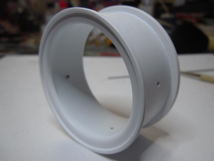

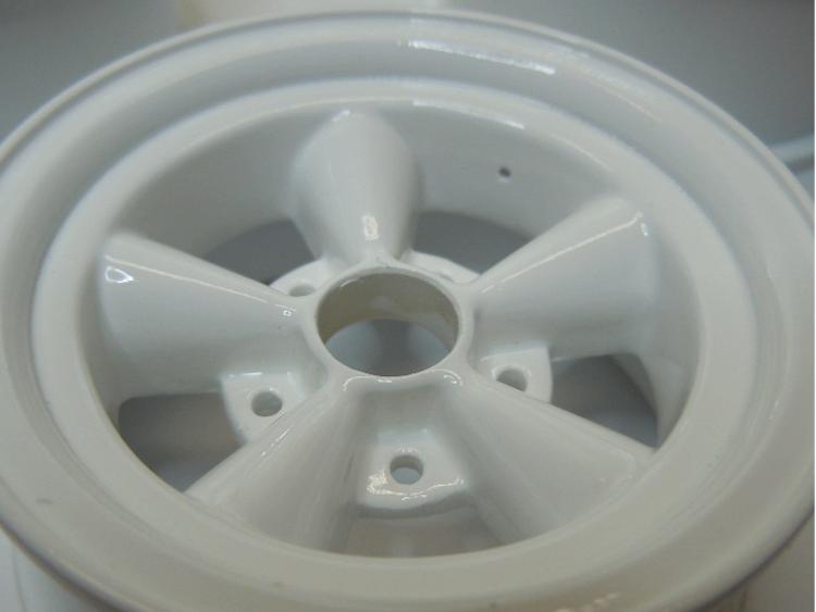

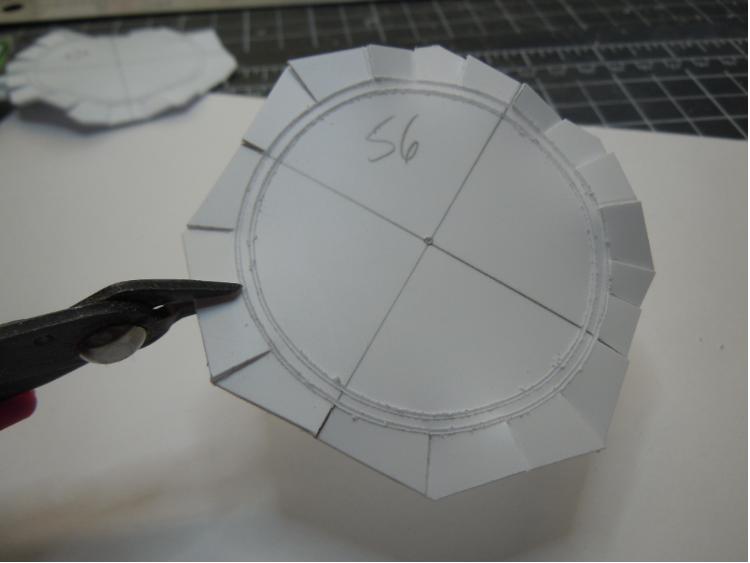

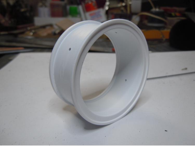

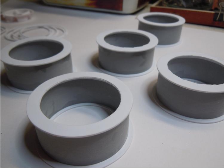

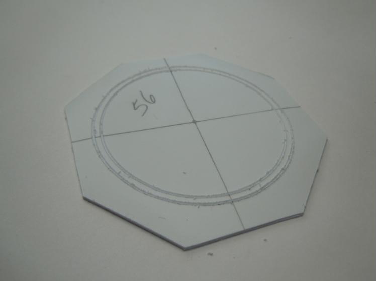

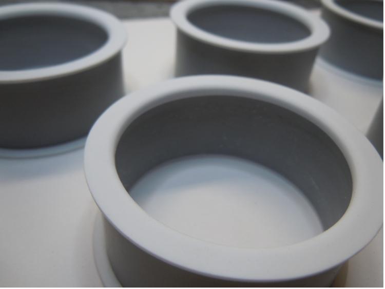

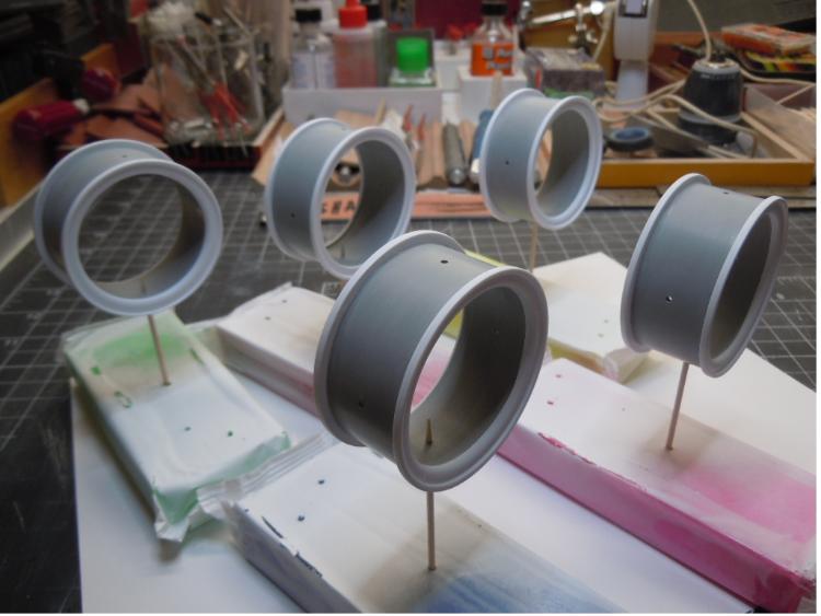

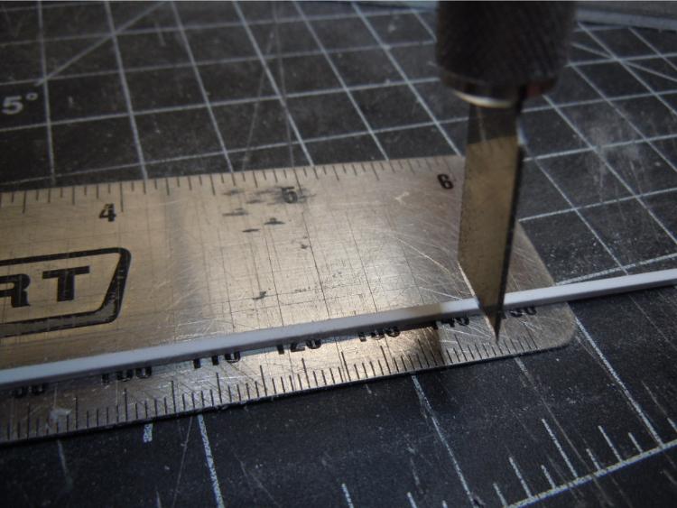

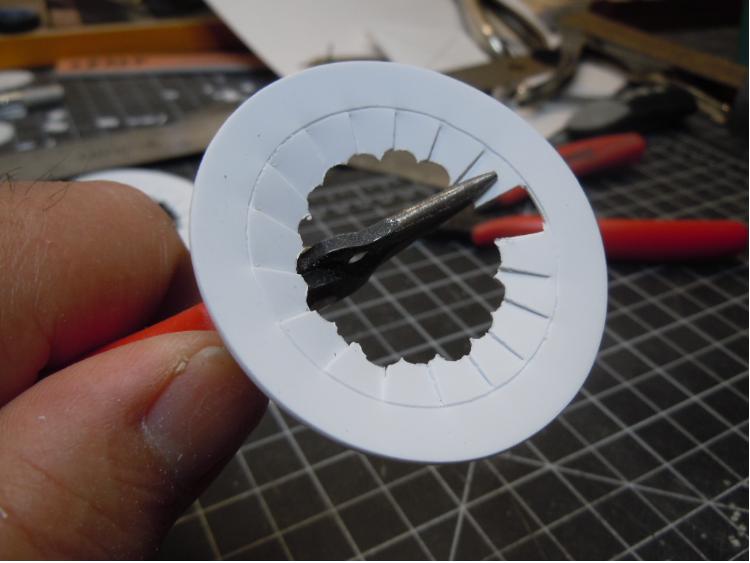

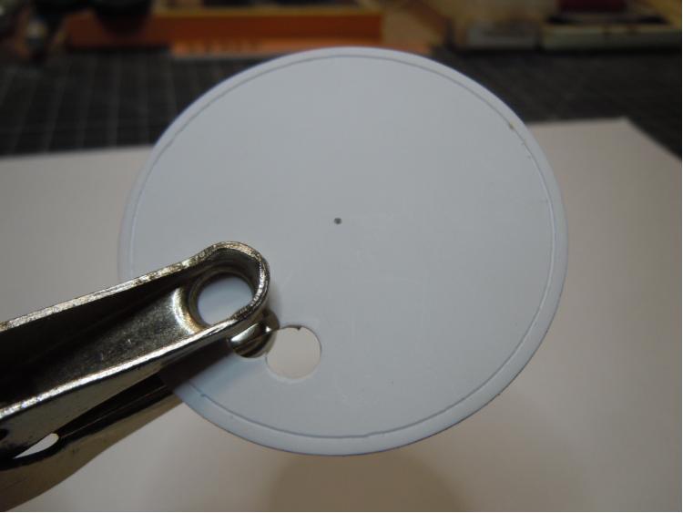

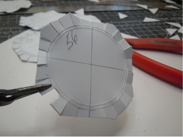

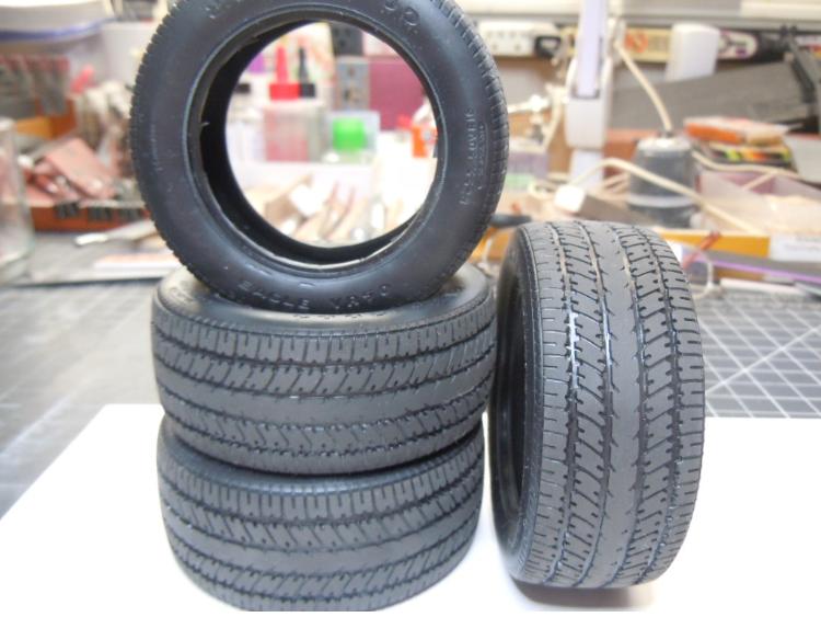

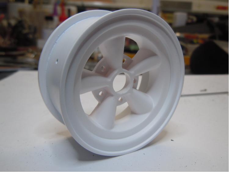

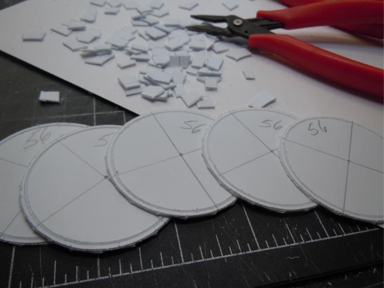

As far as the wheels, the idea started with a set of tires from a Monogram 1985 Corvette. They’re the same diameter as the Shelby tires and slightly wider. They’re also a lot easier to work with. I wanted a Torq-thrust looking mag so I used the 5-spoke inside part from a Revell Big Tub kit. I just had to figure a way to make them fit the ‘Vette tires. The inside dimension of the tires was exactly 2” so I went with 2” PVC tube for the body of the wheel and used .040 Evergreen sheet to make 2 different inside diameter rings for each side of the wheel. The larger ring fits the groove on the tire (note that the outer rim was 56mm and the inner rim was 54mm for some reason so I had to make 2 sizes). The smaller inside diamter ring sits on top of the larger ring. The pictures show the assembly progression. A piece of Everegreen .040 x .040 strip goes inside the PVC tube flush with the outer edge. That’s what holds the spoke portion in place (it gets mounted from the rear). That’s about it.
"A picture is worth a thousand words but a model is worth a thousand pictures" - Harley J. Earl
