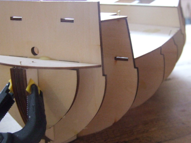

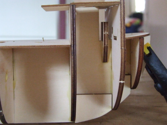

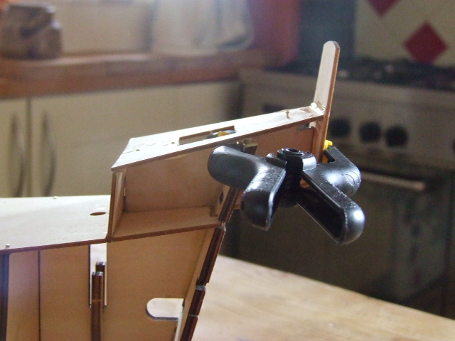

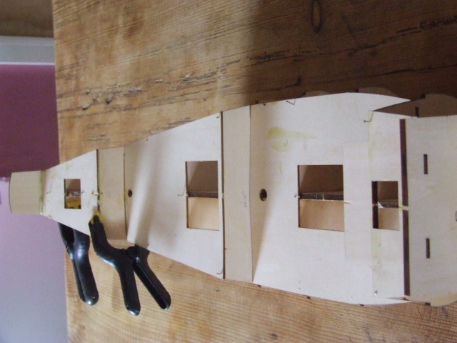

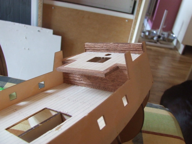

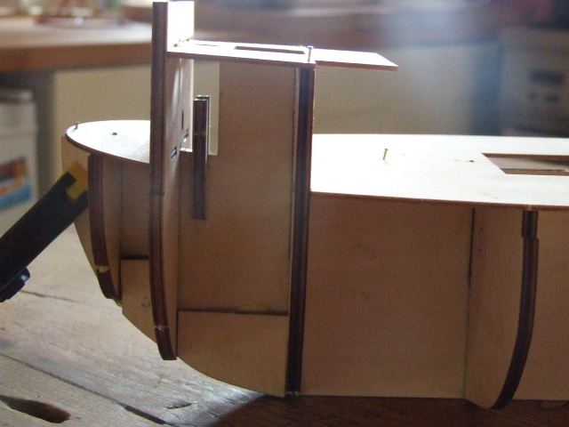

Finally after a long wait I got the first parts through. I have completed the basic framing, and decking, as the pics will show, when I put them up.

First lot of pictures.

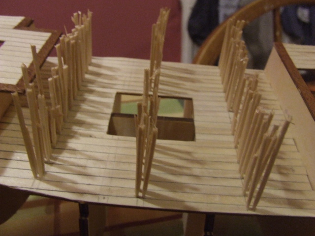

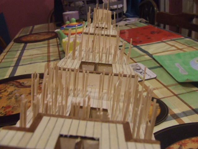

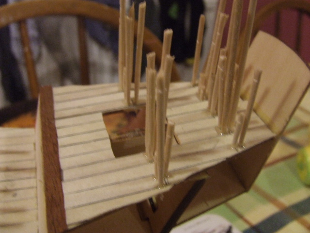

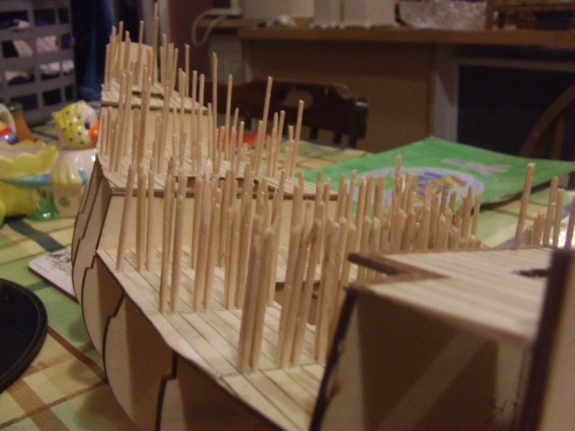

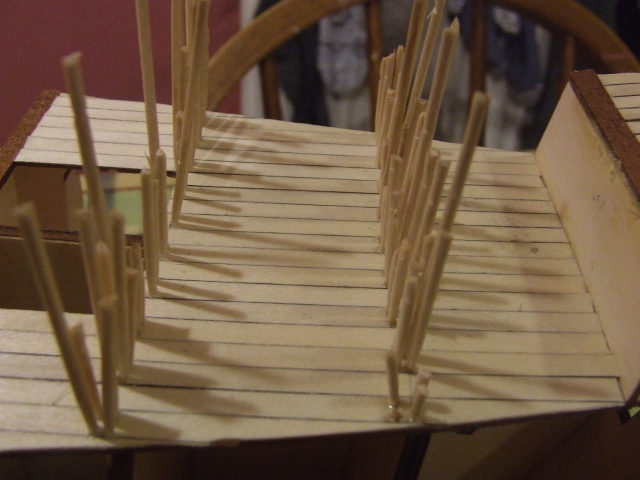

I've gone down the trenailing path, to see how it would turn out.

Looking really nice there.
I must say though, that i think members on this site must hold the record for the number of cocktail nsticks used.
Keep the pics coming.

Just don't sit on it! LOL
I almost did !!
I sat it down on the sofa while I answered the phone, finished the call, made a cuppa and came back through and without thinking was about to sit down, luckily one of the kids saw and quickly moved it out the way. Could have been embarrassing. Blushing

saint you could always use it scrubbing yer back in the bath,then topedo it afterwards.
seriously though,I cut off one stick with side cutters,then sharpen it up again to do the next one and so on.

Looking good there saint, its a very theraputic job doing those treenails lol (not)LOL but the finish is much better and it adds a bit or realisam to the finish keep up the good work.Drool

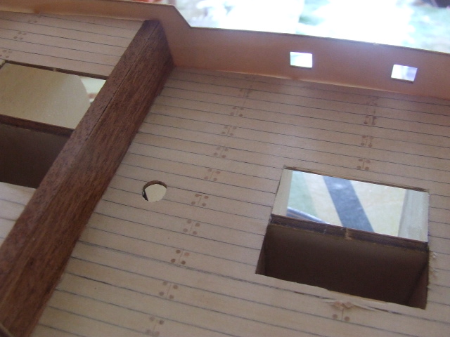

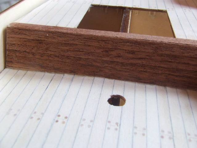

I've now snipped the sticks off and sanded, the effect does look good. The one thing I have learned is to be very careful sanding when the deck planks are only 0.6mm as I've gone a bit too far in one area and almost took the wood back to the plywood decking base. In future if I do this I'll use a thicker wood to allow for the sanding process. I'll put some pics up later once I get some batteries for the camera.

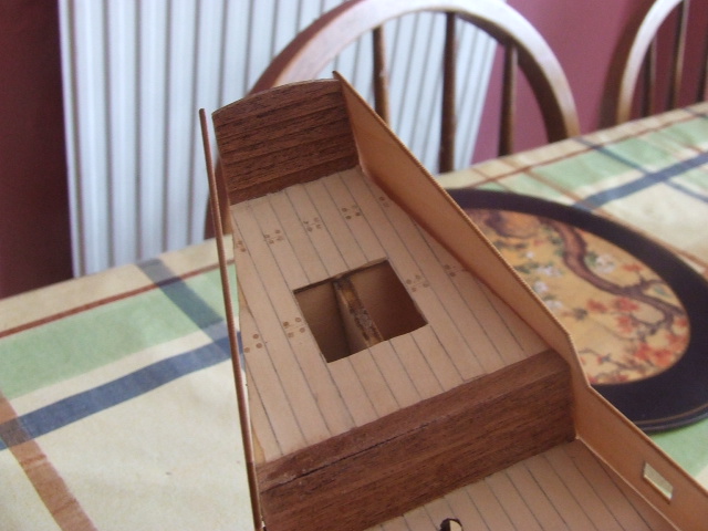

More pics attached after trimming and sanding the sticks.
I have pinned the bulwarks on temporarily, mainly so I don't lose or damage them while waiting for the next parts.

Nice work Saintsman
jonny7england
#14 Posted : 25 April 2011 10:08:49
Joined: 22/03/2010
Posts: 2,065
Points: 6,295
Location: Gorleston-on-sea
Very nice in deed, keep the pictures coming...ThumpUp
#15 Posted : 25 April 2011 12:08:31
Looks Awesome M8

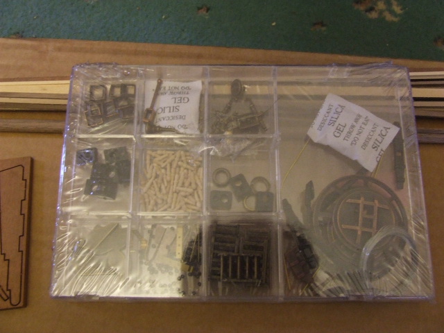

After getting what seemed the wrong parts in my second delivery, I was surprised by some of the parts that arrived with the third delivery.
Here goes
I now have 2 sets of crows nest bits, one set the same as Magpies the other is bare cast metal.
All the rear gallery supports are duplicated in wood and metal, even though the parts list specifically says "Cast in metal"
The guns have arrived as a kit, similar to Victories, with separate wheels, sides etc.
The gratings, again supposedly cast in metal to be painted in a wood finish, well they are normal wooden gratings as used in Victory. This is proving a slight problem as I'm not sure if I have enough applewood or mahogany supplied to build them
Ladders, I have 2 sets, one set in metal one in wooden kit form (which proved handy, as the latest ladders I got for Victory were very poor quality, so I used them on Victory)
Even the rear lantern has been duplicated, this ones a bit strange as both lantern parts are the nice brassy metal, but one set of lantern top, and support are in the brassy metal , the other set is plain cast.
Both plastic boxes had the same layout of parts, the only thing missing and not duplicated are the rudder hinges.
I feel very honored to be sent 2 sets of parts as they are going to come in handy for a future project.
So has anyone else got these duplicate bits and pieces?

Perhaps they are in a transition period of upgrading the parts?
My complete kit came with wooden ladders and gratings,
cast metal gun carriages,
plain cast metal rear lantern
wood gallery supports,
metal crows nest

Admin these are the parts I received the other day, as you can see they are different to those you have shown to me.
