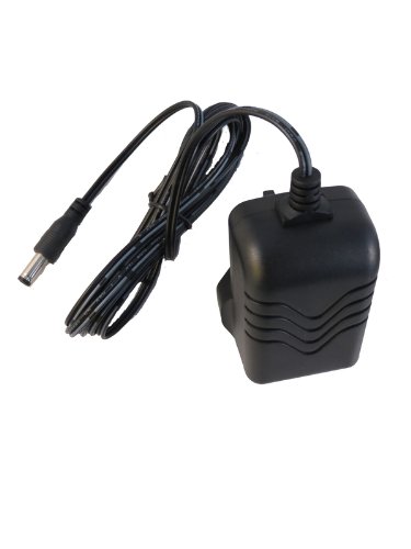

Millennium Falcon Mains Power Adaptor.
Spec:
UK 3 Pin plug fit.
Input: 240 Volts AC 50 Hz.
Regulated Output: DC 9 Volts/1amp (1000ma)
Connector Type: 5.5 x 2.5mm Male
Internal heat sinks (for reliable continuous operation).
Over current protection & Short circuit protection.
IC Controlled Stable Voltage with Input & Output line filters.
CE certified and ROHS compliant.
Please Note: The mains adapter is warranted to power the BTMF supplied lighting and ramp. It is NOT warranted to power any electronic addition or modification of the supplied build.

Help! I tried my AC power supply and nothing lights up with it in place. My battery pack works just fine, but I would like to add more LED's to the Sublight engines. I disconnected the battery pack at the extension before plugging in the power Supply. I also cycled the power switch on the Falcon. Still nothing.
Is there some sort of trick I am missing?

For what it is worth, I have the same problem. Removed the batteries, plugged in the adaptor, and nothing. Opened up the drive cover to check the wiring and all appears in order. At some point I need to test to see if there is any power coming out of the adaptor or if it is internal to the Falcon.

I purchased the power supply from DeAgostini. I thought about matching the specs and saving a few dollars, but in the end I thought better to not go cheap at this point and use one approved by them. I checked the power supply with a Multimeter and it is delivering the 9 Volts it is supposed to provide. The only reason I disconnected the battery pack versus taking out the batteries was that the pack has a screw in it and I didn't think it would much matter if the batteries were out or just disconnected. Lazy, I know. I guess I will try and use the multimeter to check the voltage at different points to see if I have another issue. Thanks for your time and help.

Today, I took out the batteries from the pack and used the AC Adapter. Still no lights. I tested the power from the Power supply again and got 9 volts. I tested at the jack in the Falcon and had power. I finally managed to find power at the plug that goes into the board. To top it all off, I have a second board they sent me when some parts were bad. I got out that board, used the switch and Jack that came with it. Plugged it in to the Battery pack and it worked like the other one. Then I tried the AC adapter and again no lights. I have some spare LED strips that have some bad LED's in them, but they work for a test. Essentially, I cannot make the AC adapter work.
