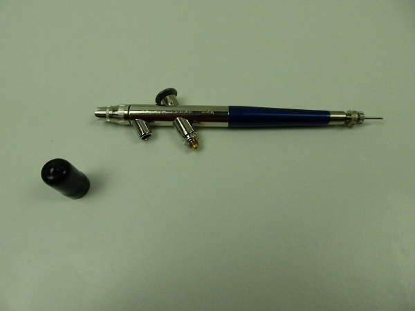

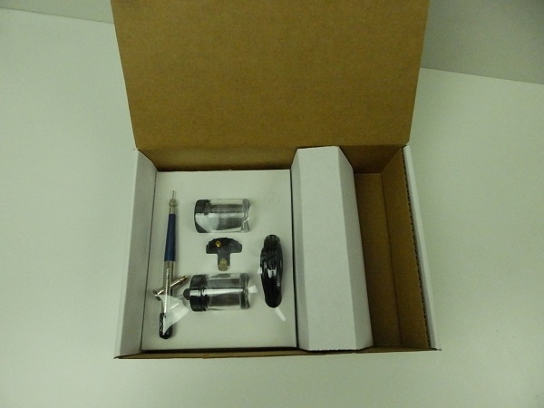

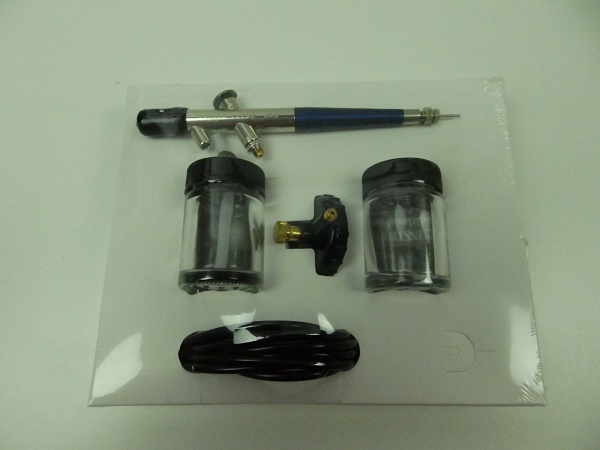

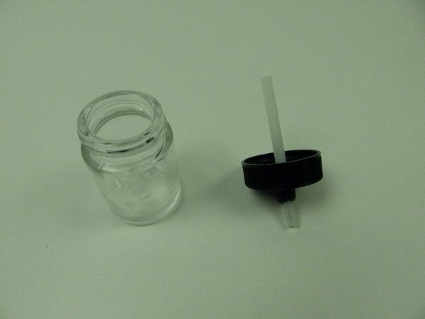

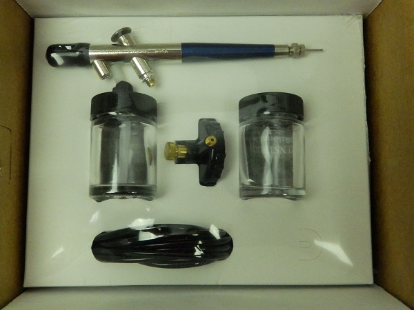

The airbrush is packaged in a sturdy cardboard box surrounded by a color printed card sleeve that on opening you find the airbrush and its supplied parts mounted in a card box and all held in position with shrink wrap. The gap on the right is where the air canister would be if it was supplied but due to postal restrictions aerosol cans are not allowed to be posted anymore.

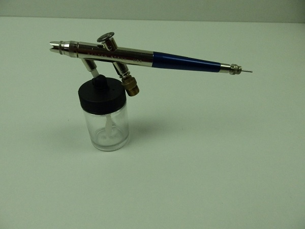

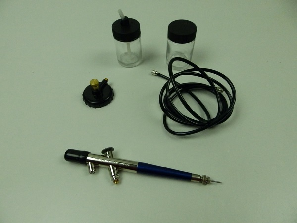

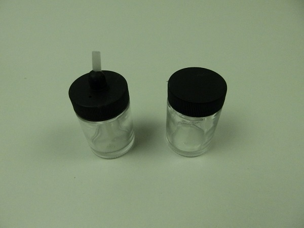

Once the shrink wrap was removed we have the airbrush, two jars one with the siphon tube,pressure regulator, vinyl hose and inside the box the instruction leaflet in several languages. The instructions for use are easy to follow and it also has a broken down illustration to aid in part identification if they are ever needed.

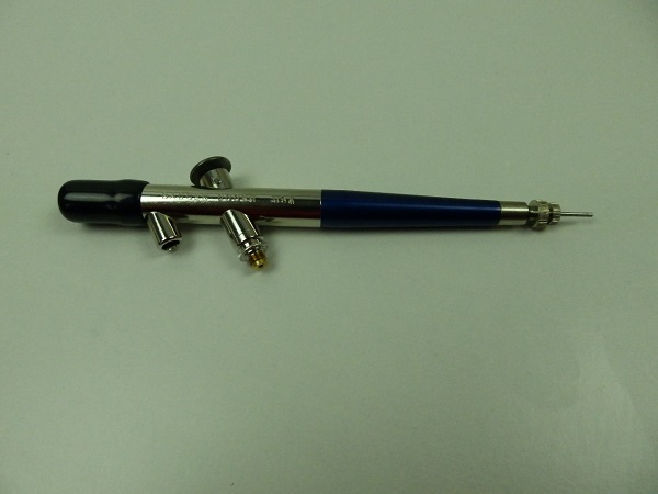

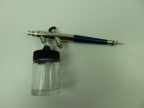

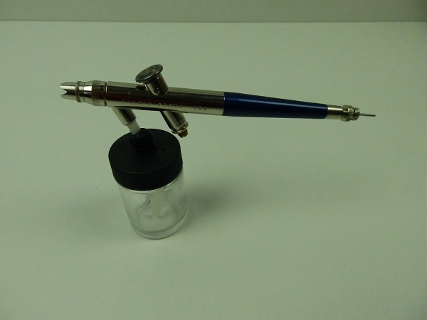

The airbrush itself has a nice weight with badgers standard blue and chrome finish that sits easily in the hand and with the paint bottle attached has no tendency to dip its nose through the the weight of the paint and jar as in some cheaper airbrushes that are around. The airbrush is supplied with a protective vinyl cap that is easily removed. The trigger is single action that is precise and smooth that allows the air through in a strong and steady stream. The spray characteristics are 1.6 mm upto 50mm width so close work can be achieved and larger areas also accommodated.

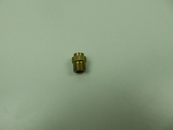

The supplied hose and regulator cap are both standard items and fit onto the airbrush and regulator using threaded ends. If you have a compressor you will need to get an adapter to fit the correct air hose to the airbrush.
Overall a very nice and easy to use beginners airbrush that with the correct cleaning will give many years sterling service. I will be reporting on its spraying characteristics in due course.

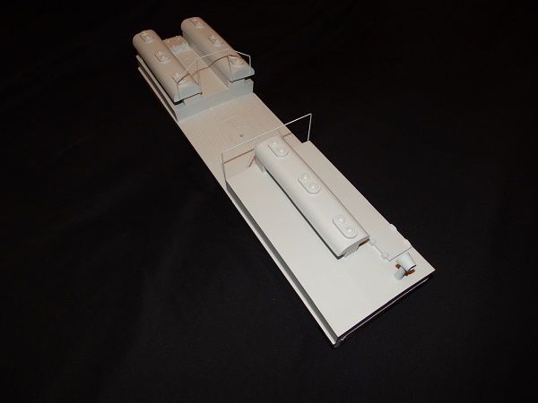

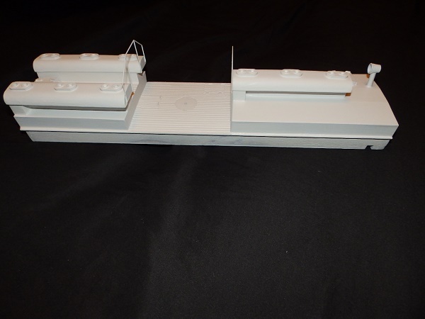

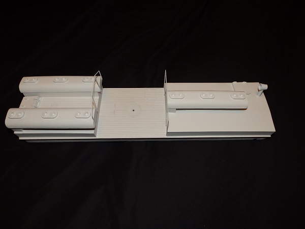

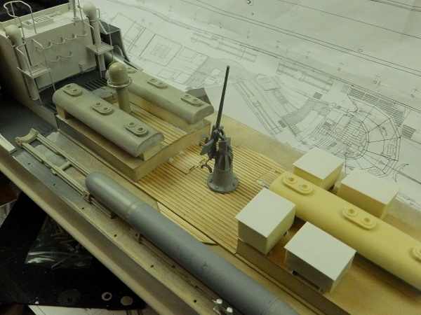

I have been using this airbrush as often as I can lately but thought to give this a proper test lets see how it can layer several thin coats of grey/white on the Schnellboot build.
The main hatch that covers the motors is a large piece that needs to be sprayed up white first and then the graphite grey decking color added after after masking.
The hatch cover was firstly sealed with a coat of sanding sealer [ dope and talcum powder if you want to mix your own] then sanded back to remove the raised grain and then a white undercoat was firstly sprayed in two light coats. This was then left to dry for 24 hours.
Once the undercoat was cured the top coat white was mixed in both paint pots provided in the set this was done to ensure the mix was the same to keep the color constant. White is white I hear you say but so is black and like white it has so many hues the last thing you want is a color change from the front to rear.
Then I proceeded to spray the cover with light coats of paint, the reason for several light coats was that there are hollows a to fill under the exhaust/ air intake stacks that if you spray heavily will just cause the paint to build up in those cavity's and then run thus ruining the paint job.
So all the cavity's and undersides were first given a coat then the front centre section and after the lower sides were covered this just left the upper exposed area's to do. to get a decent job took around 6 to 8 coats but worth it.
What I love about this Airbrush is the simplicity of use. load up the paint and off you go and it works every time the trigger is smooth in action and is instant with paint control. Adjustment of the spray area is as precise as you want it to be, a half turn of the screw at the rear screw adjuster makes a noticable difference to the spray cone.
In conclusion it did all I asked of it and came through with flying color's, easily adjustable with an accurate action and easy to clean after use.
