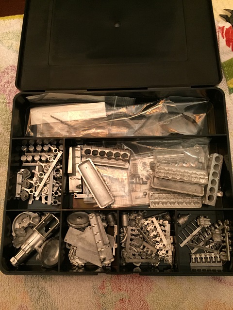

Well after my crash and burn on the MFH 1/24 Daytona Cobra I decided to try my hand at their 1/12 GTO kit.
This is a mostly white metal kit with some clear resin parts so you can see the pistons moving.
Here is a video showing the tappets moving
https://www.youtube.com/watch?v=8awmlGsSjLM

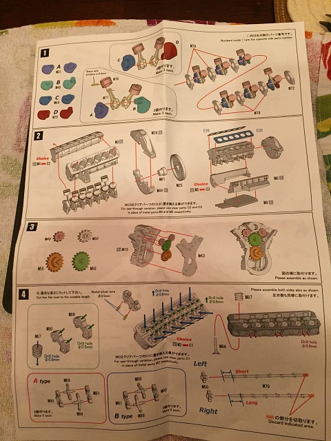

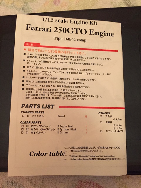

It has hundreds of tiny white metal parts, some wire and some decals. The instructions are pictorial and pretty good.You have to drill about a million tiny holes to facilitate assembly so I set up my drill press with a micro compound table so I can accurately place the parts for drilling. I will be keeping a count of how many holes I drill in this kit, but I know right now it will be a LOT of holes.The holes are 05.,0.6, 0.8 and 1.0 mm in diameter.
Here are some pictures of the parts and instructions.

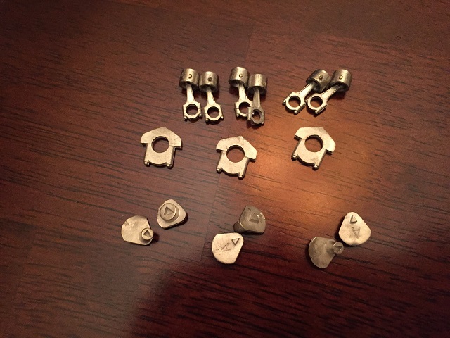

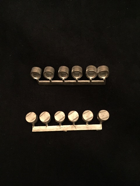

#2 Posted : 26 April 2016 16:19:08
We start with the pistons.They need clean up after removing from the sprue and then you have to drill 0.8mm holes into either side of the piston heads to pass a gudgeon pin to attach the connecting rods
So far 24 holes drilled.

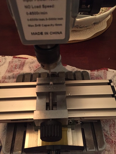

More drilling.Here is a picture of my drill press set up.I have the micro compound table set up so I can accurately position the piece I am drilling.I have now drilled the holes in the pistons for the gudgeons and drilled the holes in the connecting rods so I can assemble the piston assembly.
It is a bit time consuming using the drill press, but it is the only way to get the holes exactly where they need to be.If i want the pistons to move in the cylinders I need to be precise.
total 36 holes drilled (all 0.8 mm).

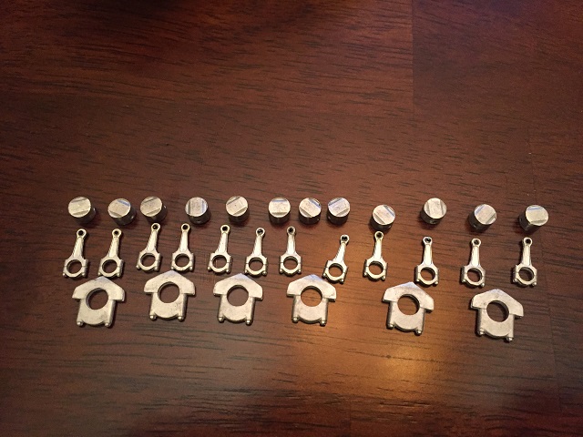

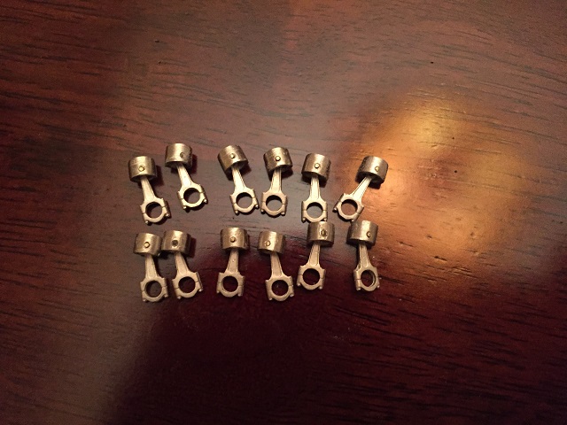

#17 Posted : 05 May 2016 15:58:53
So here are the 12 pistons and connecting rods.You connect them with 0.8 mm brass wire and then assemble them on to the crankshaft
