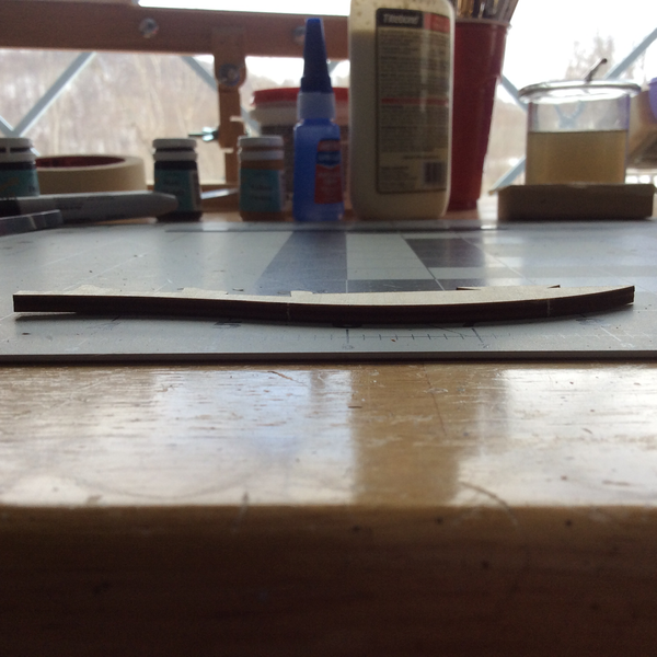

I guess it's about time for this.

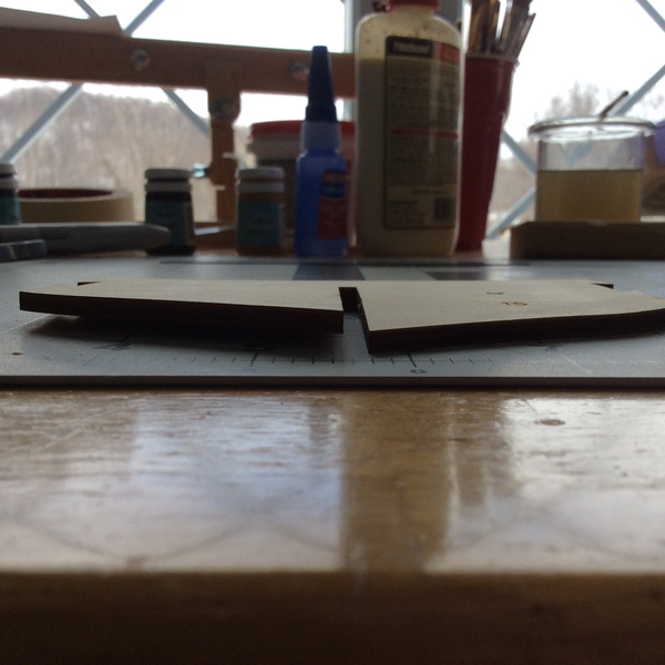

My name is Shannon and I am somewhat new to wood ship modeling. I started a couple of kits years ago but gave up in frustration both times during the planking process. I'm hoping to push through that barrier with this kit.
So far, I am a bit disappointed in the kit, particularly for the cost involved. In the first three stages, I have 8 pieces (including both sections of the keel in those stages) which are warped. I am trying the "warm water and heavy weight" method, and it seems to be working. However, it is taking the parts several days to dry.
I hope these can be fixed as I would rather not request so many replacement parts. Any tips on further fixes or whether I should go ahead and request replacements would be appreciated.
Anybody else have this problem with their kits?

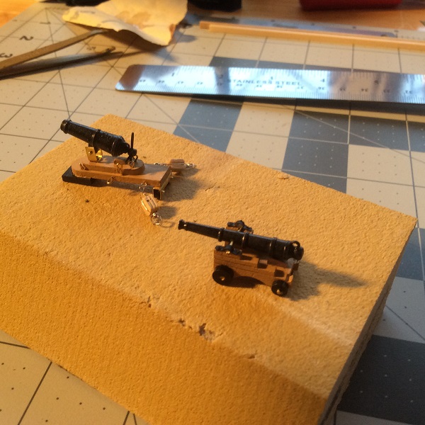

In the meantime, I have finished the anchor and the carronade. I think they look ok for my first attempt at modeling in 10 years. Not like some of the stunning work I've seen here, though.

I personally would not go to the effort of asking for replacements as the slight warp you have pictured is correctable as you have found.
You are right that depending on weather conditions the parts can take a few days to dry out thoroughly.
I would suggest a couple of pieces of kitchen paper towel above and below the part before you weight it and that should draw the water out quicker.
I had similar issues with my Sovereign ribs in a couple of instances but as you are dealing with wood its to be expected.
Make sure you jig the keel when you start your build to keep eveything straight and true.
Don't be disheartened at this early stage as you are starting on a fantastic build that has so much support material on this site you are going to find support all the way.
Hope you enjoy your build.
#5 Posted : 13 February 2016 18:11:54
If you decide you want replacement parts just PM me.I resize my pics to 640 by 480 and they show up in the post that way.
I have built a few ship models and there are often issues with parts.My suggestion is to get everything as straight as possible because often small amounts of warpage can really effect the shape of the hull.I constantly recheck everything as I assemble the hull to make sure everything is square.I am sure you will find as you build the model your skills will improve.The folks on the forum here are very friendly and can really help you along the way.

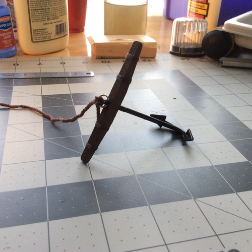

I ran out of thread on the anchor, but I fixed it by using extra thread shamelessly stolen from my wife's sewing kit. I am wondering if I should paint the wooden portion of the anchor. I am painting the model, so I probably will. It looks so nice as it is, though.

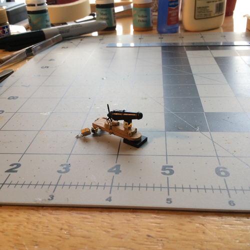

On the carronade, I noticed the gun sits way too high. However, as I am still newish to things, I opted to leave it as I want to follow the instructions as closely as possible. Also, I found it easier to install the wheels and then clip the axles to length rather than size them, clip them, and install them. I had to use the micro drill to widen the holes in the brass as the axle rod was a little wider than the hole. Lastly, I had to file down the wheels to get them to line up with the holes in the brass part. I thought the hardest bit of the carronade was working with the thin wire and the blocks. I did a fair job, I think, but it is not as nice as others I have seen here. Plus, I poked my fingertips a few times with the wire. Ouch!

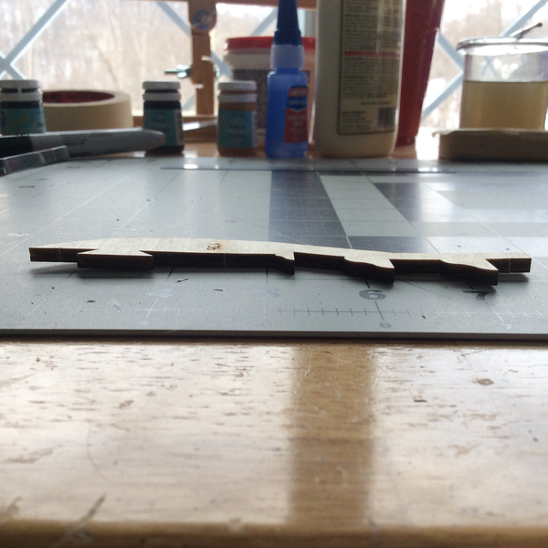

An update on my progress.
I have had to do the soak-and-press method with about 1/3 of the bulkhead parts as well as the keel up to this point. The infamous Bulkhead 15 still has the same warping as the photo I posted earlier. I'll try to post a photo of it later today.
I wanted to start on the launch, but that too is warped so I will have to soak-and-press that sheet as well. Of course, I will wait to do that after the current bulkhead parts have finished their time in the press.
Very slow going.

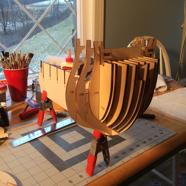

Current framing.
