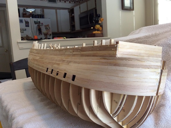

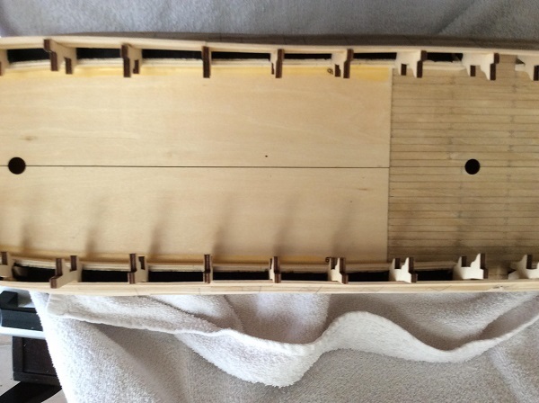

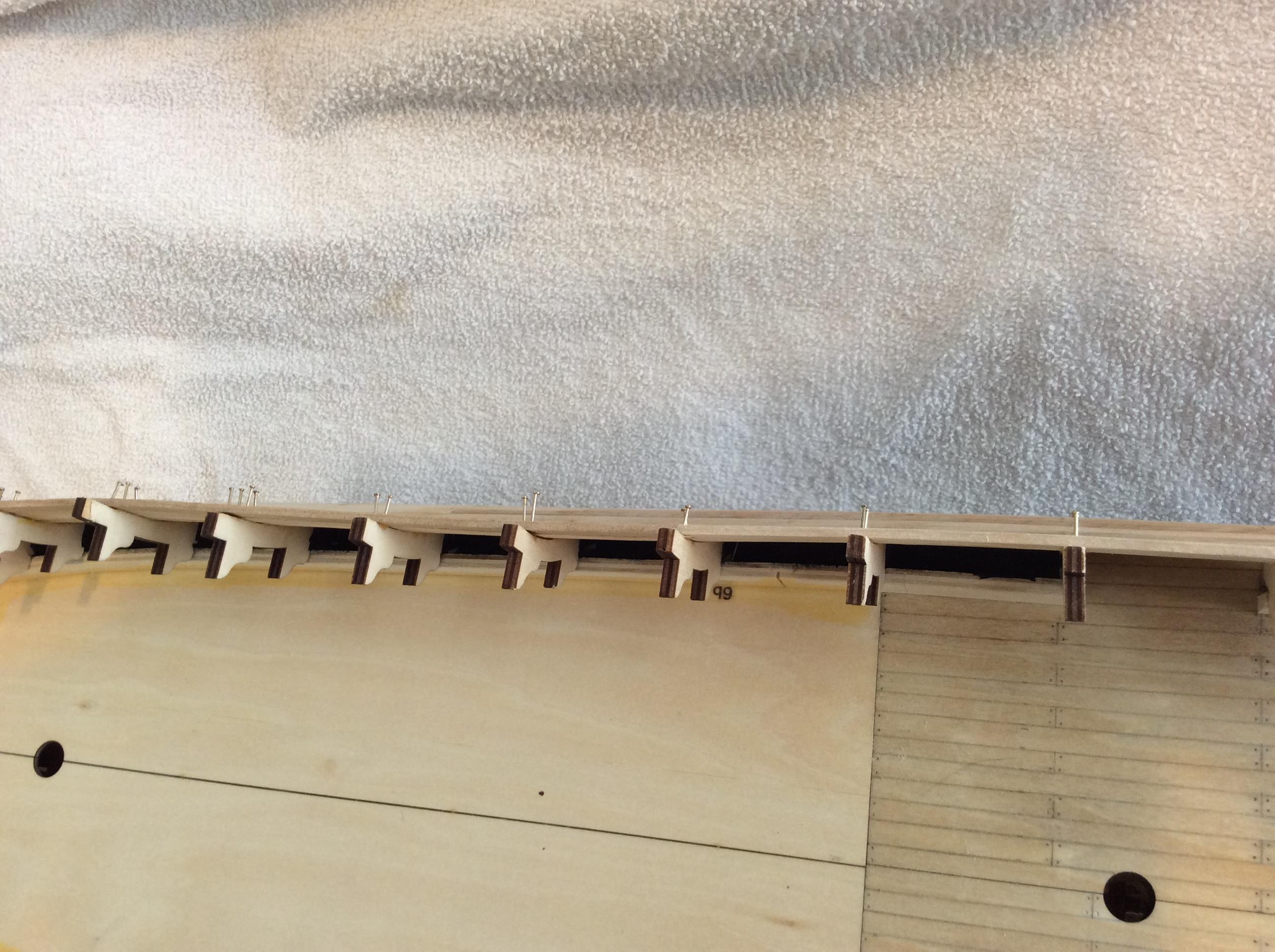

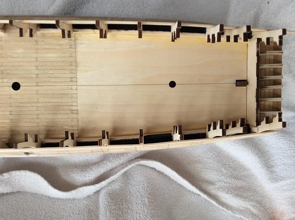

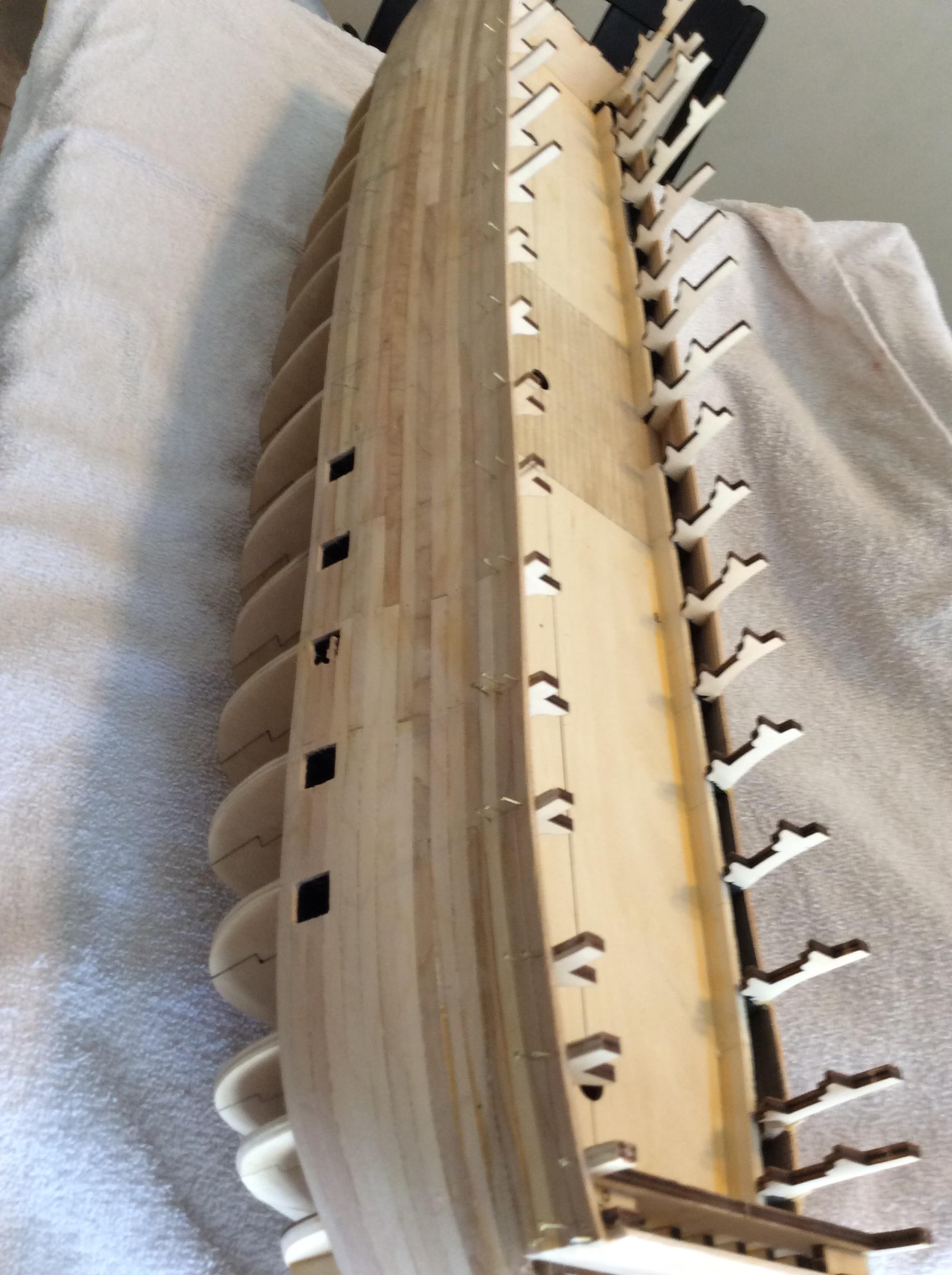

You can see I've created disaster already. I have a wave going down the side. Should've done a better job with the fairing. One side is not real bad. The other looks like gargage. Debating quiting. Starting over. Hoping there's a fix. Hoping it won't show later. Or that the actual ship did have a wave down the side.... Cursing
#6 Posted : 25 January 2016 01:18:01
Hi MBL, great to see you building this wonderful kit and thanks for posting pics.... On the pics, if you resize them to around 600x480 pixels then they'll show up as pics on your post rather than members having to download. Cool Cool
As for a disaster, far from it, she's actually looking very nice and for a first attempt at wooden ship building I think you're doing a great job. The wave on the hull can be fixed so there is no need to scrap and start over.Cool Cool .. Can you post a couple of pics looking straight down the length of the ship from bow to stern so we can see exactly the extent of the wave and come up with a fix for you....Cool Cool . A couple of pics from directly above would also be very handy....

mbl attached the following image(s):
mbl

#11 Posted : 25 January 2016 10:12:20
MBL
I had exactly the same situation with mine and in the same place.
One good thing (certainly in my case) was that the dip in the planking only covered about 4 plank widths.
Too get around the issue inhad i very gently prised the planks away from the frame at this point and inserted a shim between pkank and frame using a scrap of 0.5mm wood.
It worked on mine without having to resort to removing all of the planks.
mbl
#12 Posted : 25 January 2016 16:16:58
Rank: Amateur Level 1
Joined: 08/06/2015
Posts: 31
Points: 89
Location: Richmond
birdaj2 wrote:
MBL
Thanks. This is my idea as well. I'm just terrified to dive in. Not sure best how to go about pulling the planks away from the ribs. This wood glue is far stronger than I thought it would be.
#13 Posted : 25 January 2016 16:43:32
Best way to separate is to use a small brush with hot water. Gently brush the glued joints with the hot water, after a few minutes the glue will soften enough to separate the parts without damage. This is assuming you have used PVA glue in the first place. Put the shims in place and re-glue...
Hope this helps.
Hope this helps.
Ahh yes. Will try this. My experience with PVA is very limited. Thanks Alan.
#16 Posted : 25 January 2016 19:38:53
MBL,
Had the same concerns having used TITEBOND but the guys advice on here had me doing the same.
I also used a chisel edge blade in an xacto handle but you will probable get away with using a small flat blade screwdriver.
Remember to use plenty of glue because you will be gluing back 2 surfaces if you use a shim (shim to rib and shim to plank).
While its probable stating the obvious (sorry for that but bear in mind I got caught the same way) run a dry, unglued plank across the ribs in future and looking down on this you will spot any gaps on ribs that might be slightly narrow and you will spot the gap quite easily.

birdaj2 wrote:
MBL,
Thanks. I learned this lesson the hard way. I was smart enough to use a shim in a different area. The force of the plank pull the shim away from the rib because I didn't wait long enough. Patience is not my strong suit.

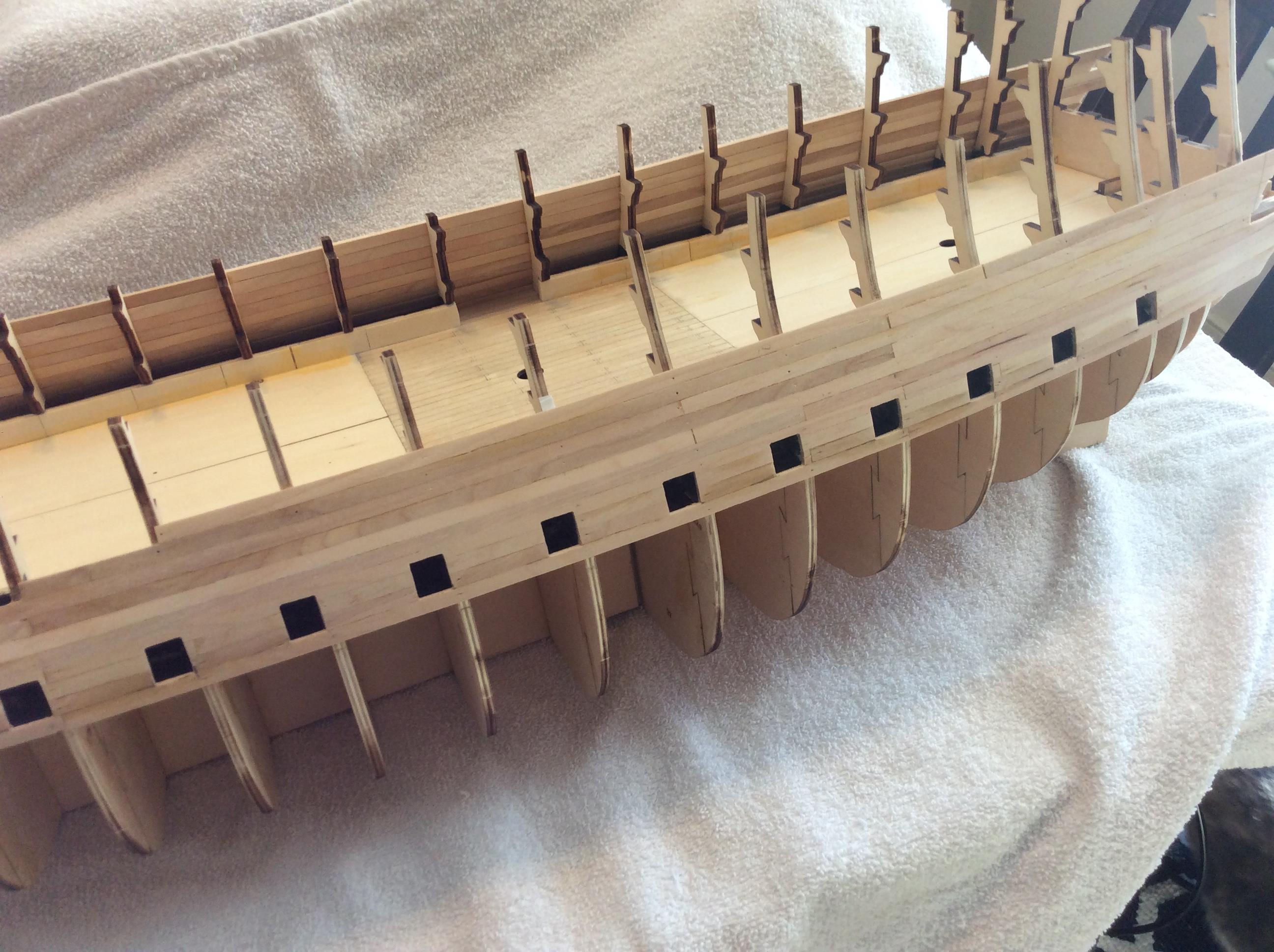

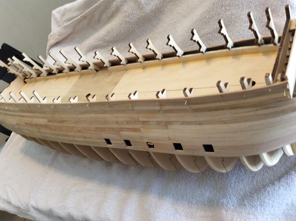

Thanks for the advice and the kind words. Did the best I could without ripping all the planks off. It's not perfect but much better.
