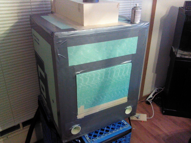

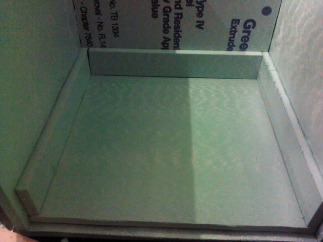

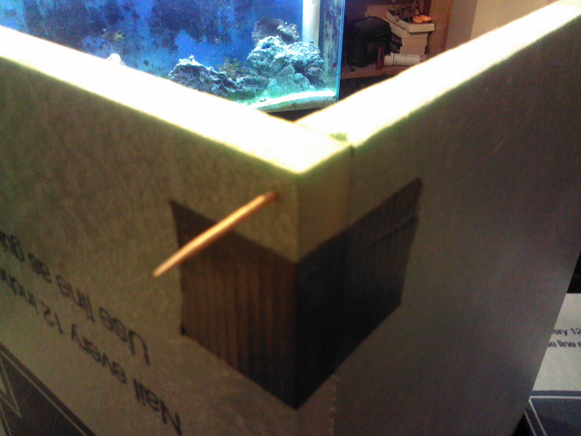

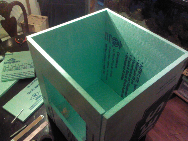

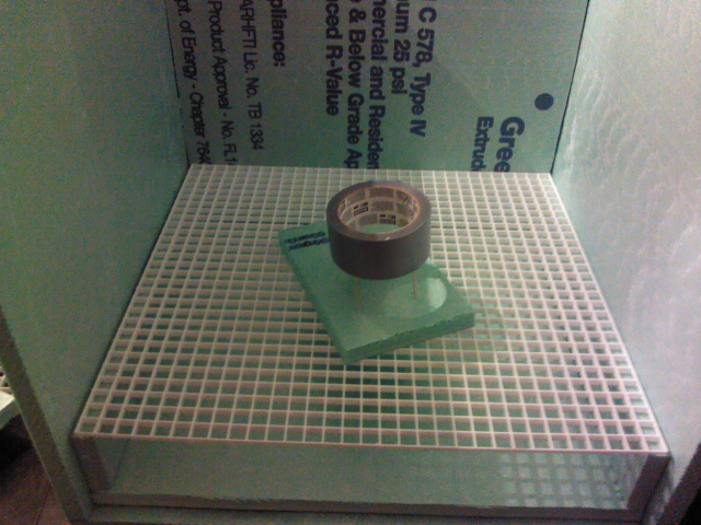

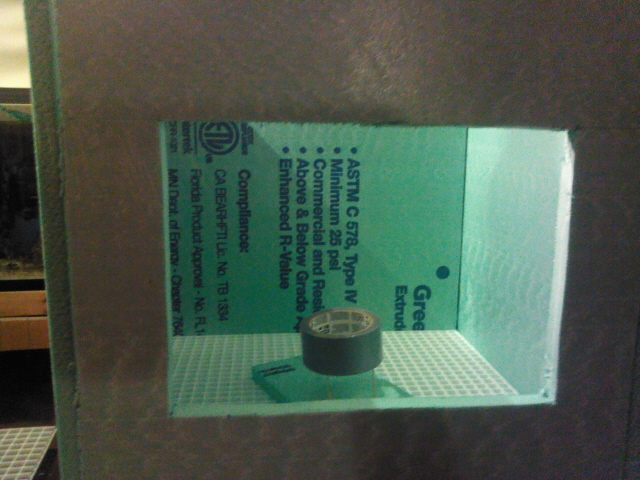

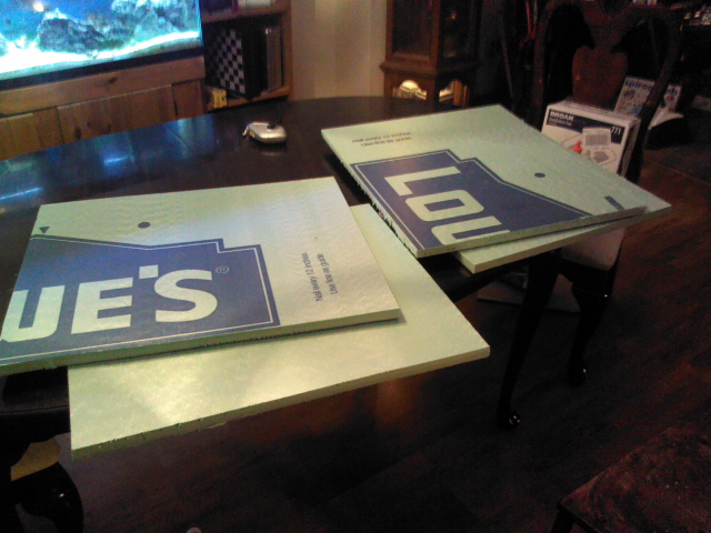

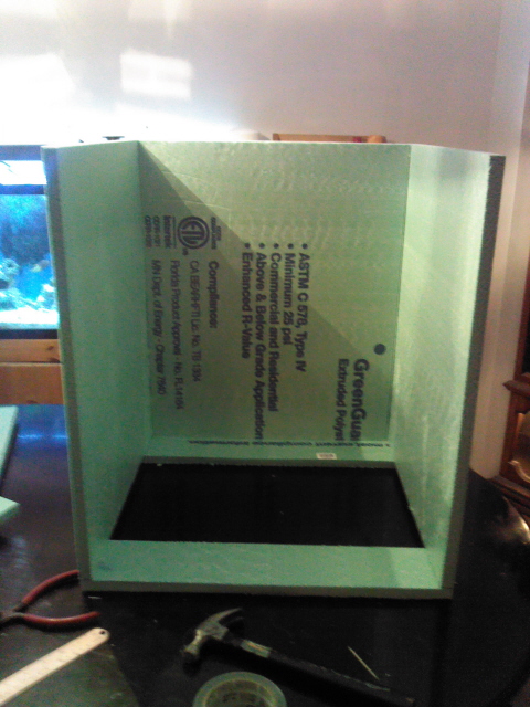

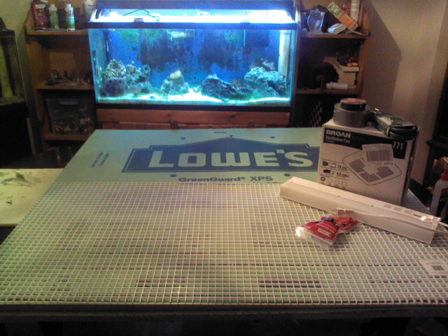

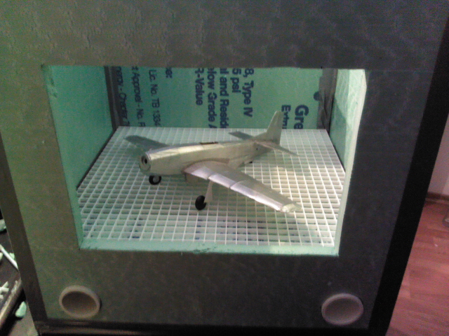

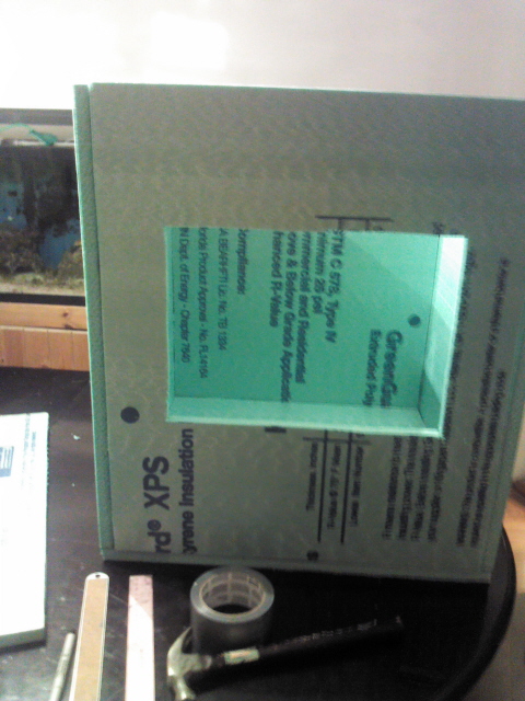

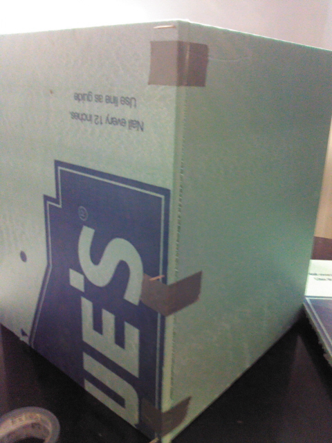

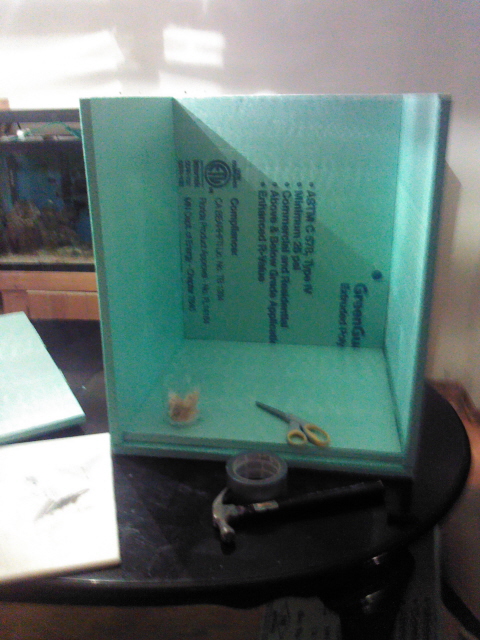

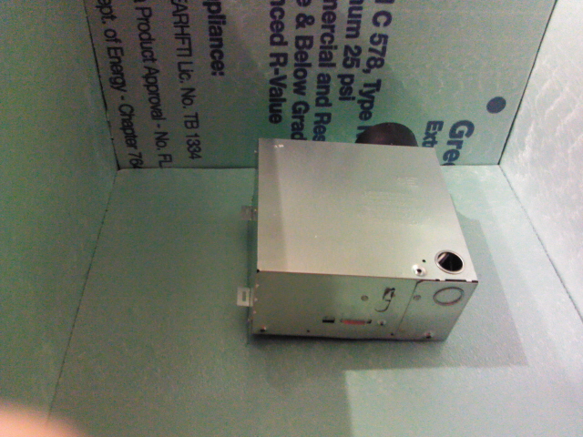

Well not the Falcon but I am at least building something, still need to work on the top with the light and fan...

Could you explain a little about how your paint booth works...does it pull the air down and out the front?

The way I hope it works is that I have a bathroom fan that will be on top the draws air for the tubes and opening in the front.that way it will pull air up and out, i also will be able to close the front panel so that i can leave things in the booth to dry. the whole thing works off of the idea of (neg) pressure, i know it looks really large but i wanted this way so i could airbrush larger objects.

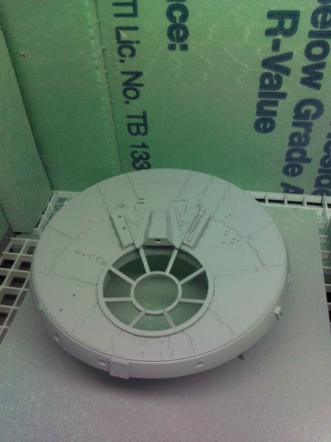

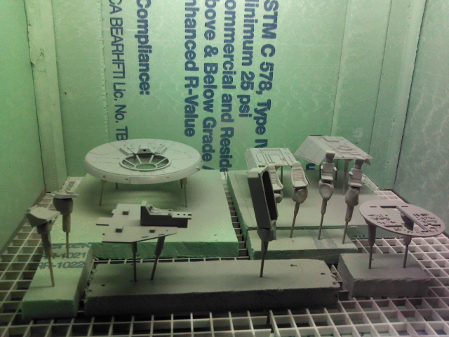

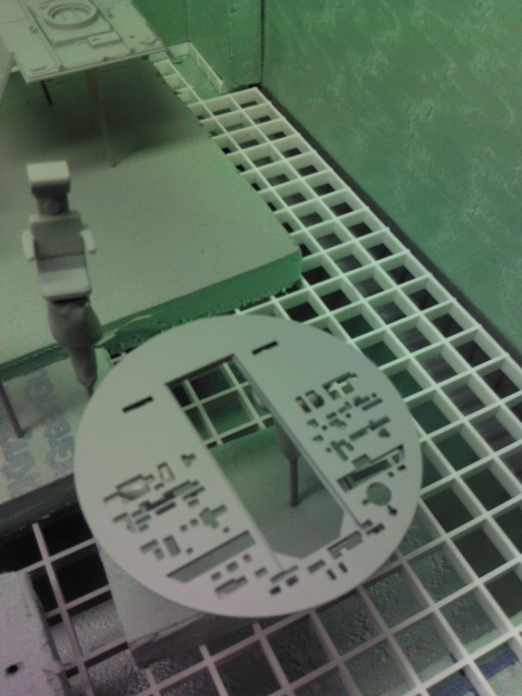

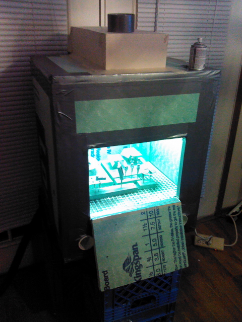

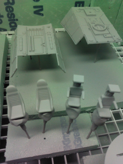

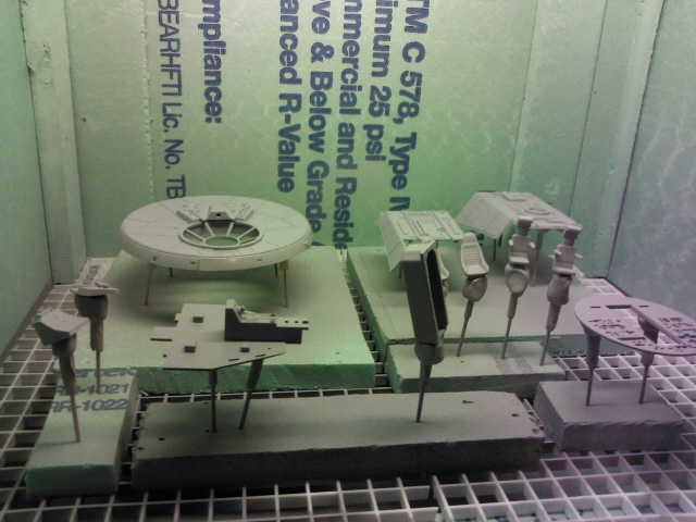

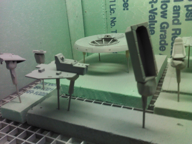

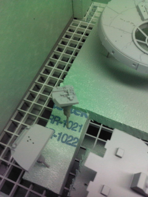

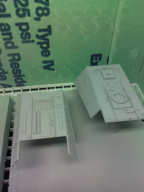

Well the Paint Booth is working great and got my first order of plastic Model parts primed and drying for the night... tomorrow will start on the metal parts.

Nice, I really like that paint booth! Does the fan filter the fumes at all? Could you vent it out a window with a dryer vent tube perhaps? I am thinking of doing this too, as I am in an apartment and have no where to paint.

the fan does vent out side, if you look at the top, that box looking thing on top is duct work that i made that directs air to the back of the booth to a hose that i can put out my door or a window... the whole system works great just have some minor air leaks to fix and it seems to help dry everything too
