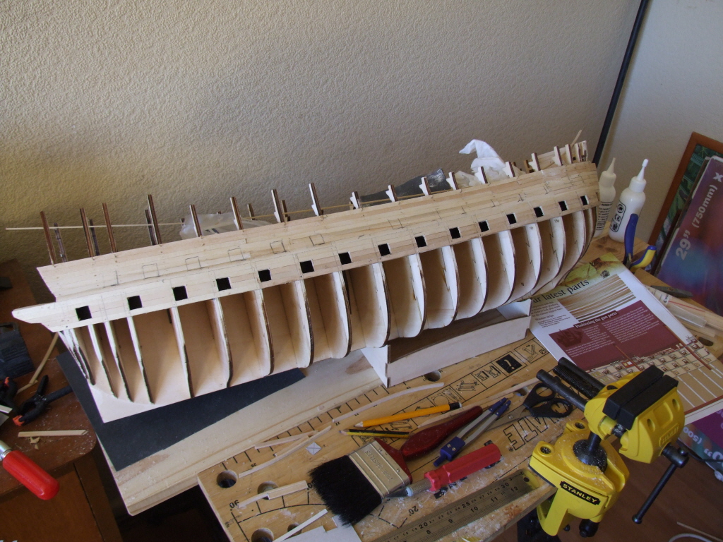

yorkieboy1
#11 Posted : 10 October 2010 10:49:06
Joined: 30/03/2010
Posts: 126
Points: 335
Location: Bradford West Yorks
hi Jon andZ I have had a little trouble with mine but after much fettling and sanding (fairing) I have got mine sorted out and the planking is falling on will be posting pics in a while
victory 002.JPG (462kb) downloaded 98 time(s).
jonny7england
#12 Posted : 10 October 2010 10:55:55
Joined: 22/03/2010
Posts: 2,065
Points: 6,295
Location: Gorleston-on-sea
Looking good yorkieboy1, glad I'm not the only one with a cluttered work area LOL LOL I'd be lost if mine was tidy LOL LOL There in my madness..Laugh
