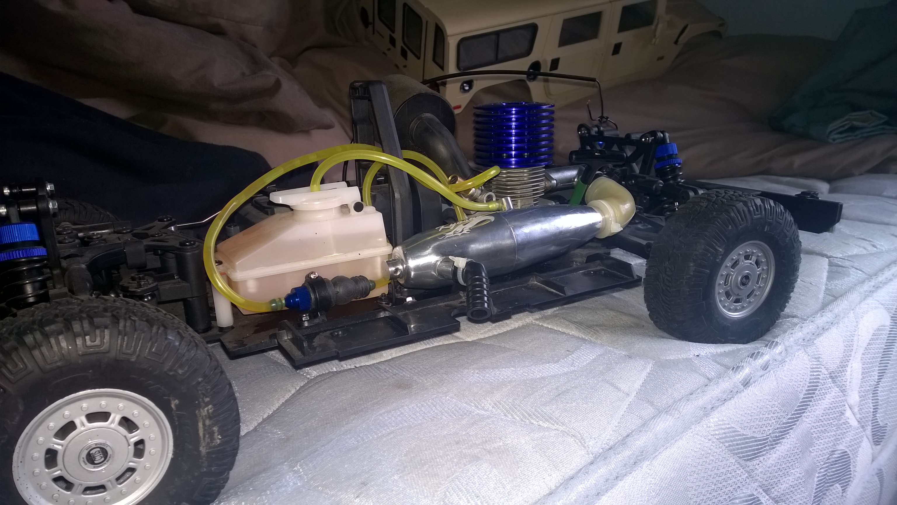

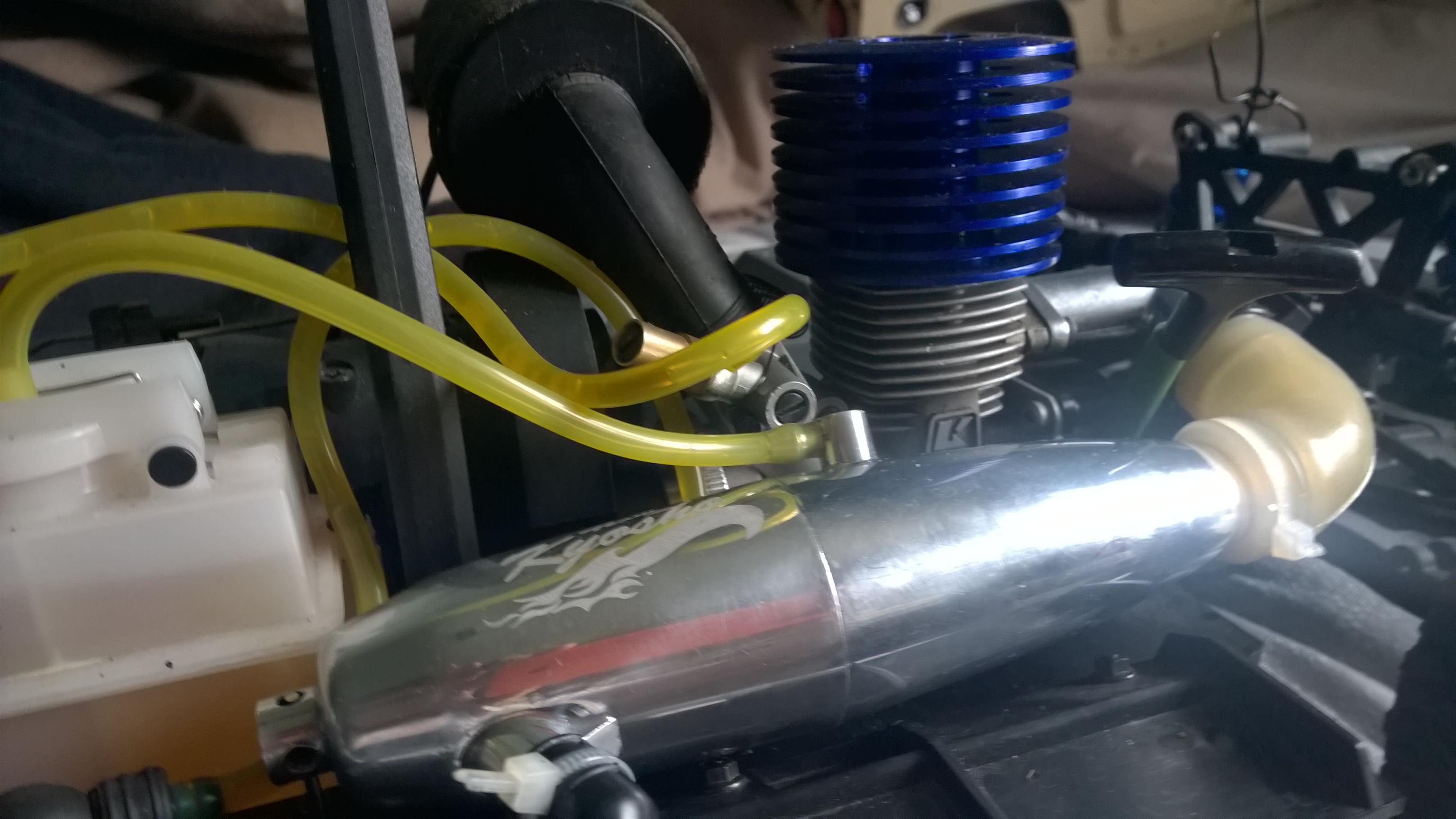

can't get running no matter what i try
back to factory settings and won't start
fuel in header, no go
have put fuel pump on chassis but will not ignite, glow starter and plug burning bright
tried different chassis and exhaust, as it seemed like there was no pressure in the tank.
not happy, got same engine in kyosho buggy and that starts
got both 16% & 25% fuel

still not able to get going, it would seem that there is no pressure in tank as lid does not close tightly enough creating air bubbles in line.
is there a parts list for the car, or an exploded view??
will be changing fuel tank and exhaust for more pressure.
full of design flaws this thing.
