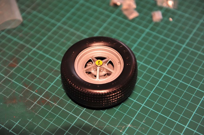

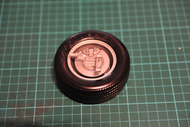

I'm happy to announce that with the help of some proper screwdrivers and washing up liquid (who would thought!) all the screws are in all the way. Yippee Ki Yay, you... screws.
OK, so the next thing was to get the tyre onto the rim. Guys, I think I can skip the gym today. Even with an aid of hairdryer this was an uneven fight. That I won, somehow. Bards will sing about this for years to come...
Sorry for the quality of pictures, I need to set up some proper lighting rig at last...
michu attached the following image(s):
Happy building :-)
