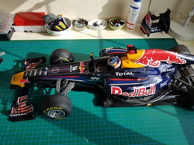

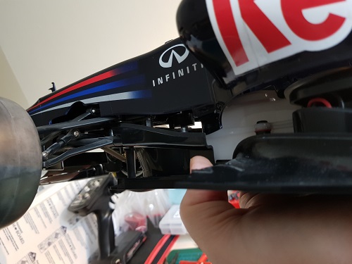

Lets see if I can figure out how to attach some photos. From prior to glueing the two parts together, I know the nose/front wing had no problem with the fit as it was once screwed in place. I am less certain with the main display body. Together they just dont slide all the way in place. Very annoying!
...no it will not allow my phone photos to be uploaded.
Toby
#7 Posted : 21 March 2018 06:43:24
Joined: 30/12/2016
Posts: 16
Points: 93
Location: Qatar
OK finally... with help from another post I have learned how to resize photos.
Took these this morning. Ground clearance is as per racing spec so should be OK in that respect.
Toby

Toby attached the following image(s):
Toby

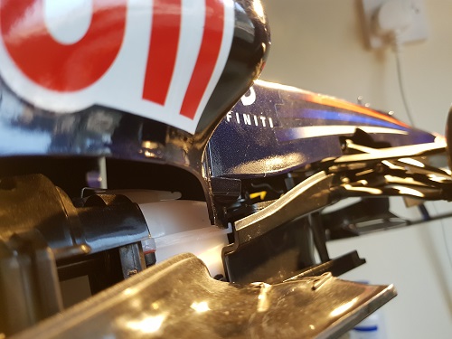

Finally it worked using resized photos to 500 horizontal pixels (which is less than the magical 140kB limit per photo that could have been an informative instruction) but not until I transferred the files back to my phone again and posted them from there. Anyway, any advice is welcome.

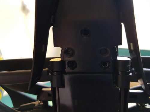

Possibly its a misaligned glued 'display' front wing assembly onto the display body?
It's a little late now to re-test the fit of the display body up to the display front wing at the point of my photo #4.
I would remove the barge boards and vanes as they are delicate and so you can get a better look.
Toby
#11 Posted : 21 March 2018 16:28:46
Joined: 30/12/2016
Posts: 16
Points: 93
Location: Qatar

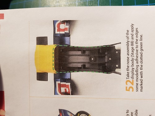

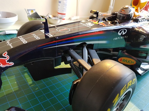

Thank you Tomick for finding the reason to my problem and verifying that display front wing and main display body should never be glued together.

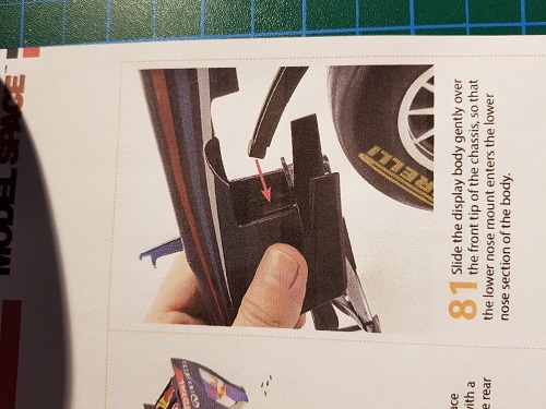

However, this puts me in a very confusing situation. All I have done is to follow the instructions given to me by Model Space. And indeed, the instructions tell me to glue these parts together. I even gave it the three minutes suggested to make the adhesive dry properly.
#12 Posted : 21 March 2018 16:38:31

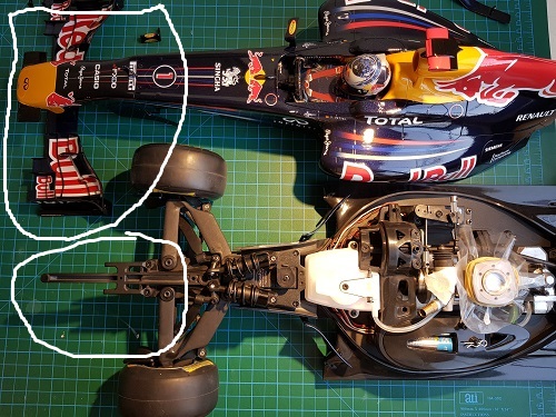

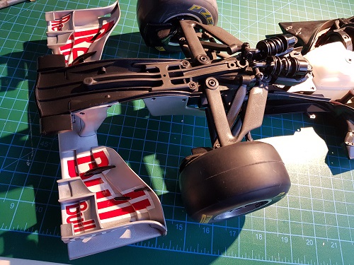

It's hard to tell from your photos as to what is hindering the fit of your display body. Have you test fitted the racing body and racing front wing yet?
The display body should slide backwards so that the rectangular cutaways in the nose sides accommodate the protruding front control arms - Make sure that the display body is sitting level with the bottom of the chassis.
The white line gap marker in the photo below on the underside is a clear indicator that something in the assembly is not quite as it should be.
Does your "racing" front wing fit in place ok on its own and did the 'display' front wing fit in place ok before the display body was added to it?
Can you post a photo of the rear of the car from above?
Toby

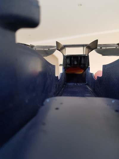

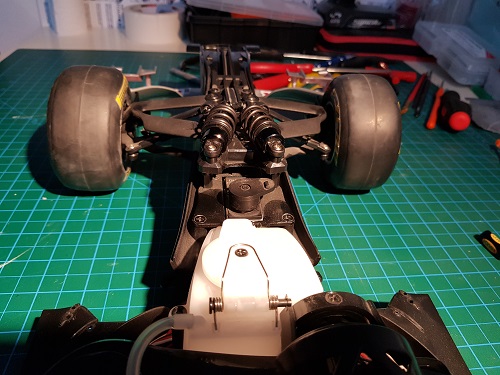

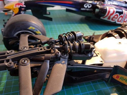

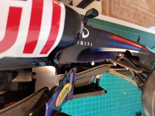

I am aware this cannot be easy to resolve though remote viewing but I have posted some more pictures hoping it would give some clues.
- The remaining side boards are now off for better viewing
- Indeed, the picture you drew white lines on is capturing the focus of my headache. That is why I took that picture.
- I mounted the running (silver colour!) front wing without any problem. I also previously had no problem with mounting the display front wing before glueing.
- The racing body is yet to be completed. That is my next job but I wanted to complete my display car first.

Can you post an overhead view of the entire top side chassis of your RB7

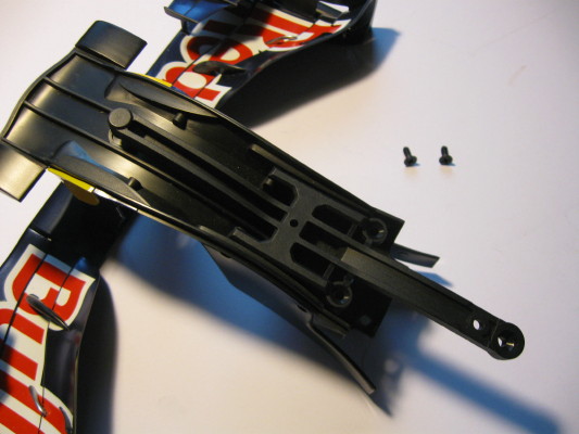

I can see nothing at the forward end of your chassis that would prevent your display body from sliding backward onto the chassis.
Therefore I suspect its something within the nose that is preventing the body moving backward by what looks to be 6-8mm or so., And as the nose now has very limited access, its difficult to see what the cause/obstruction might be and therefore difficult to resolve.
An option to consider is to cut-off approx 8mm from the end of the nose support (as highlighted in the photo below) which should allow the body to move further backwards.
It will mean that the end screw cannot then be fitted into the underside of the forward nose mount, though the nose should still be secure onto the chassis with the four remaining screws. At worst you could always request a replacement issue which contains the nose support if the cut-off does not do the trick.
Toby

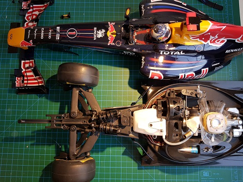

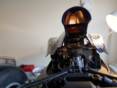

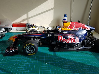

Ok, I am back. Please see photos with overhead view of the entire chassis. Strictly following instructions where everything seems to be put together nicely, the display body still does not slide all the way and as a result is sticking up quite a bit at the rear of the RB7.
#18 Posted : 08 April 2018 09:03:33
Without being able to see what the conflict is within the nose, I think your only way forward would be to make adjustment at the very end of the nose support as mentioned at post #16. It certainly seems that the problem lies within the nose.

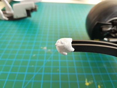

#19 Posted : 08 April 2018 09:05:36
Joined: 30/12/2016
Posts: 16
Points: 93
Location: Qatar

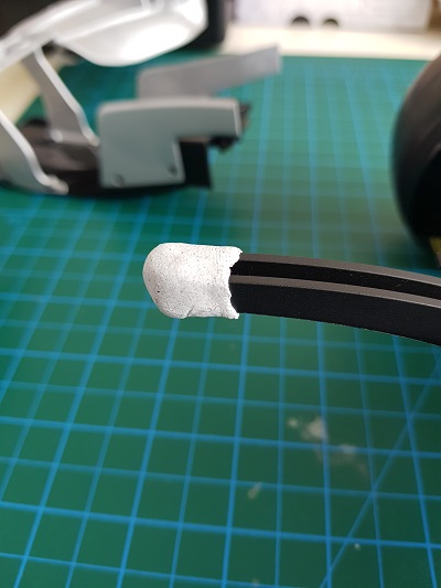

Investigating the matter, I attached some blue tack where the problem seems to be. After trying to fit again I could see on the imprint that indeed there is not enough clearence within the nose. The third picture shows the yellow lip that seemse to infringe on the available space. The lip should be there as per instuctions but it ought to be shaved down. This is tricky given the lack of available space.
#20 Posted : 08 April 2018 09:11:39
Perhaps a long needle file might do the trick?
