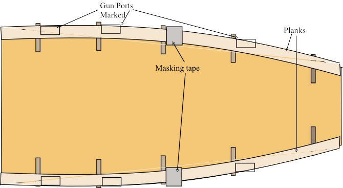

Little tip:-
Pick a rib and put a length of masking tape over the planks on the side of the rib the gun port will be then wrapping the tape over the top plank. Now repeat on the other side so that when you look down from the top, the tape is next to the rib on the same side. Then mark your first gun port on the next rib so it matches the tape as the tape shows the side of the rib the gun port should be on, turn the ship around and repeat on that side. You will have a gun port mark on each side remove the tape and mark the rest of the gun ports on both sides.
Son of Bulwark attached the following image(s):
