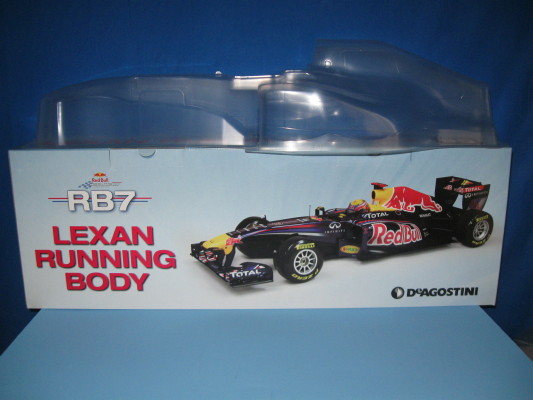

Anyone got a photo or picture of the actual racing shell?
Would love to see whT that looks like..
#2 Posted : 05 September 2014 16:56:53
Lexan bodyshells tend not to have the defined detail compared with injection plastic, and being clear, there isn't much to see until it is painted on the inside.

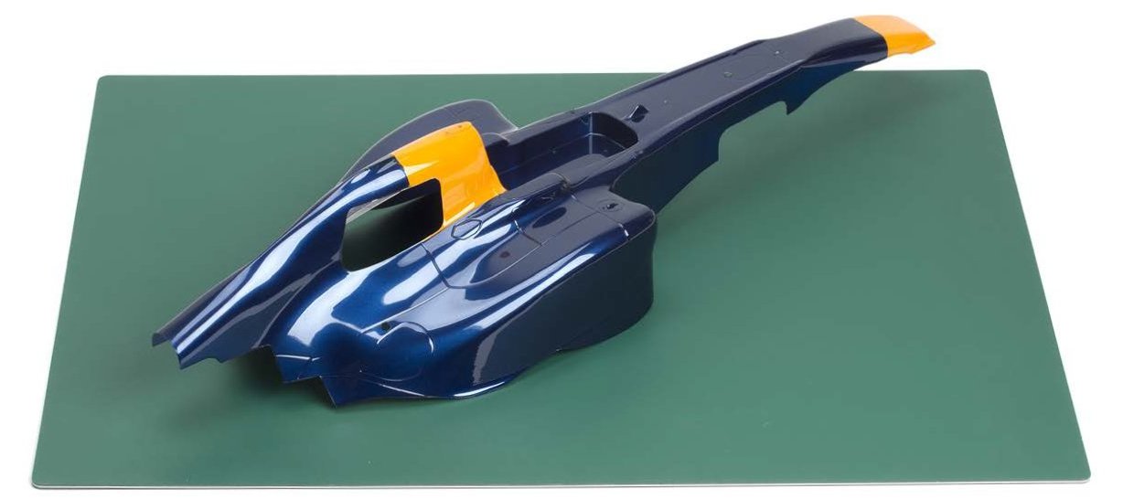

#5 Posted : 11 September 2014 13:45:40
Here you go..

A pic of the racing bodyshell painted but without decals..
kenjara
#10 Posted : 15 September 2014 13:15:55
Joined: 05/04/2013
Posts: 540
Points: 1,630
Location: England
Looks good and easy to mask too. I am probably not going to bother with the display body at all.

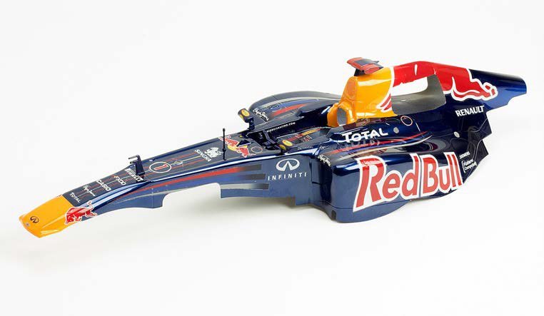

Hi Tomick
What colours did you use on the racing body, I dont think I will go the TS-89 pearl blue route due to the decals on the front wing being installed beforehand. Did you use a clear coat on the racing body before you applied the paint?
From South Africa
Building-
RB7
#18 Posted : 26 November 2014 11:33:34
You should not use TS-89 pearl blue on the lexan racing body or any of the TS range. The TS range is not suited for use on lexan (polycarbonate).
For the lexan racing body, I used PS-59 dark metallic blue backed with black (yellow elements backed with white).
There is not requirement to apply a clear coat on the lexan racing body and its unwise to do so.
Are you confusing the display body with the racing body, the paint type differs for both.
