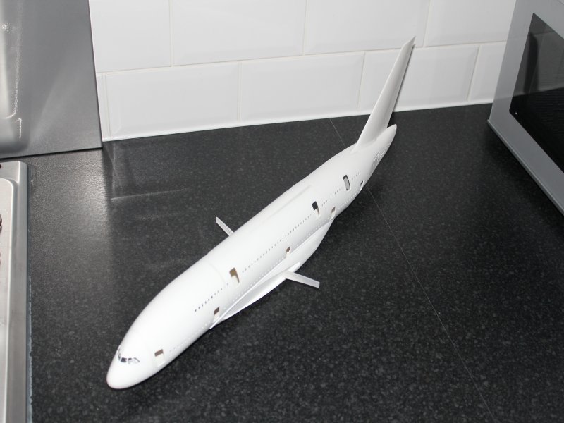

Hi Folks BigGrin
One of my favourite Civil aircraft of late has to be the enormous Airbus A380 after seeing it in action at the Farnborough Airshow about 4 years ago if my memory serves me right..

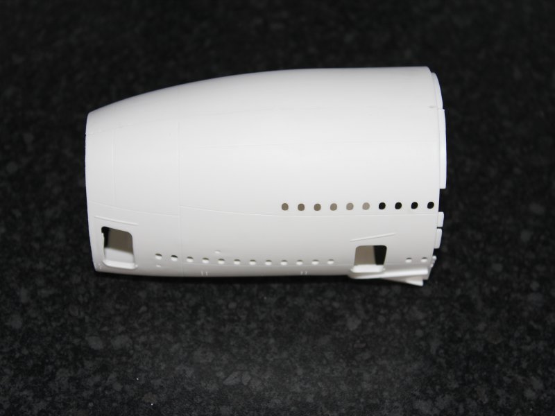

So having looked around I noticed that Revell did a 1/144 scale kit and although its big, I wanted bigger. So after looking on Ebay I got myself the Heller 1/125 beauty, paid my monies and awaited delivery.

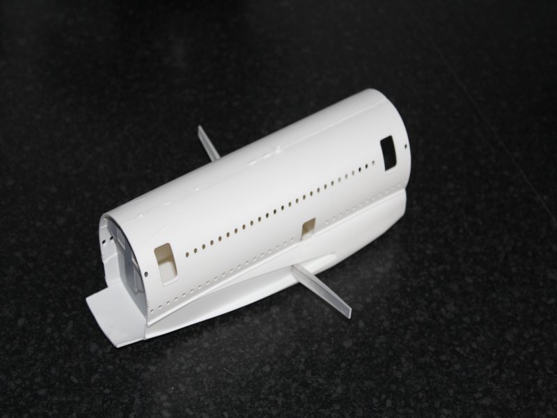

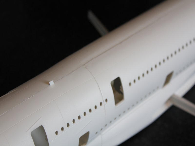

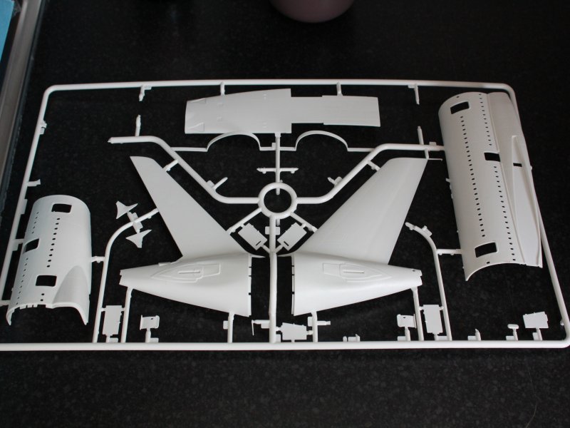

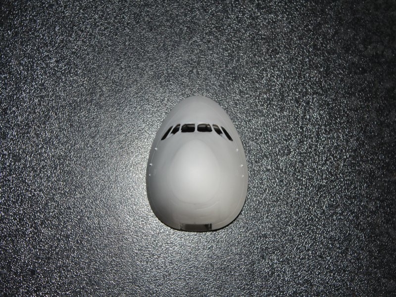

A few days later a nice big box turns up and I quickly unpacked it to inspect the contents... So far so good and the lines and detail are good and minimal flash to worry about. Yoy will notice that the kit is made up of sub-sections due to the size of the fuselage and was to be expected but I did'nt expect some of the problems that awaited me in getting a good fit! Well in for a penny in for a pound as they say.
I started off with the nose section and worked my way to the tail and as you can see by the photo's I have my work cut out for me!

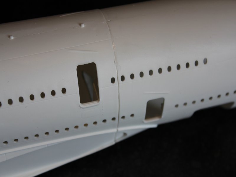

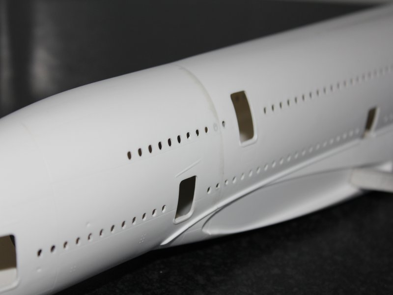

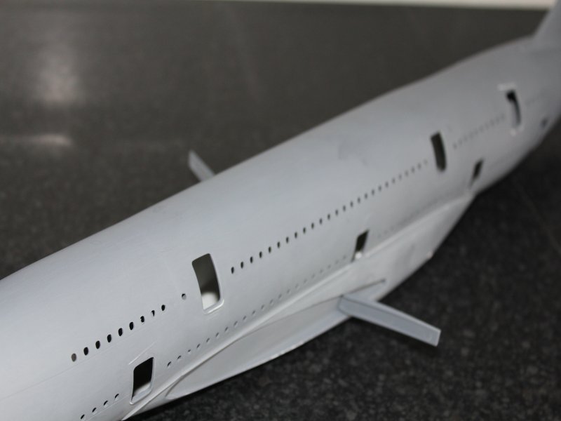

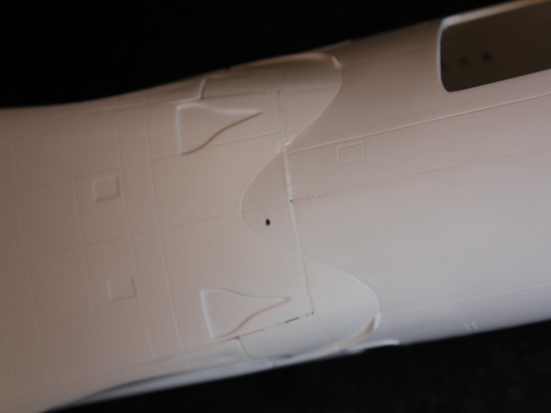

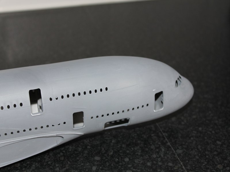

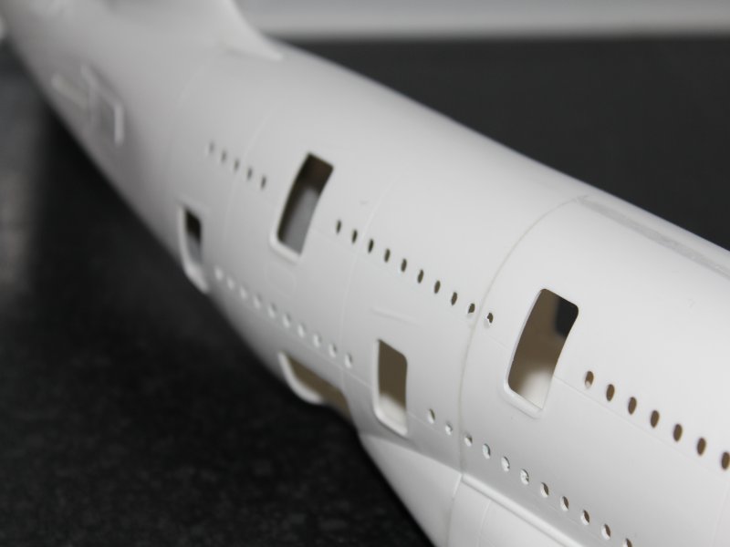

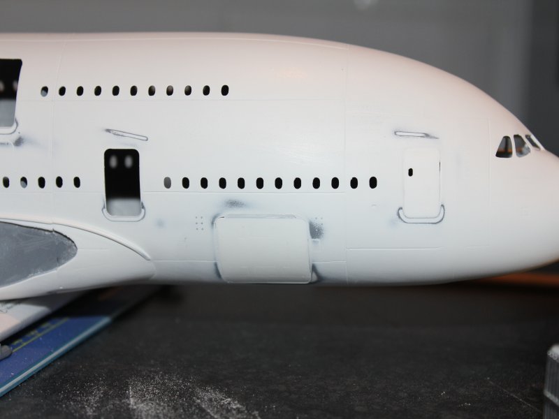

This latest update tackles more horrible joins of the fuselage sections as you can see by the first 2 photos. Once they where all put together using EMA MEK some slight tweeking of the sections was done to get the best possible fit and only then was putty filla added to the areas ready for sanding and blending the fuselage. Once this was complete it was given a coat of Halfords grey primer and allowed to dry for at least 24hrs before some more filla in areas that where highlighted by the primer.. more to come soon including the four mighty engines and the the wings and some re-scribing of the panel lines that where removed during the sanding process..
#8 Posted : 08 July 2014 00:21:13
Like it Spence, nice and smooth. I take it your not going to be super detailing the interior then, seating, overhead lockers, passengers, cabin crew, working toilets....etc, etcLaugh Laugh LOL Laugh

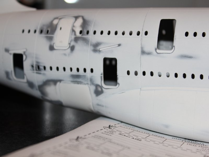

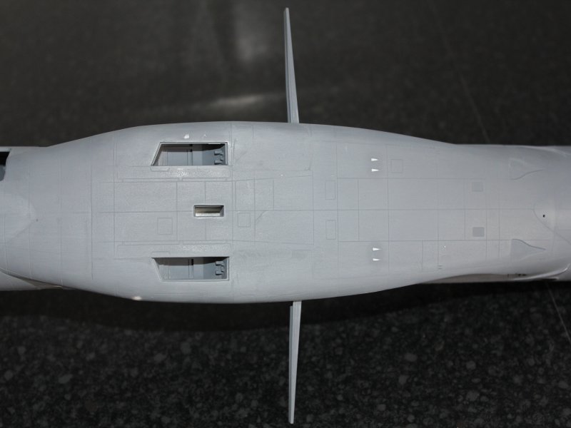

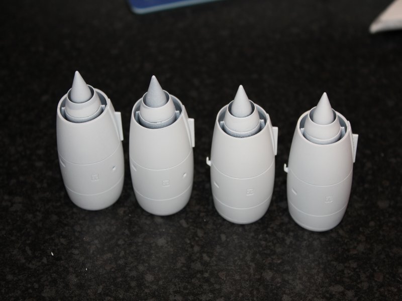

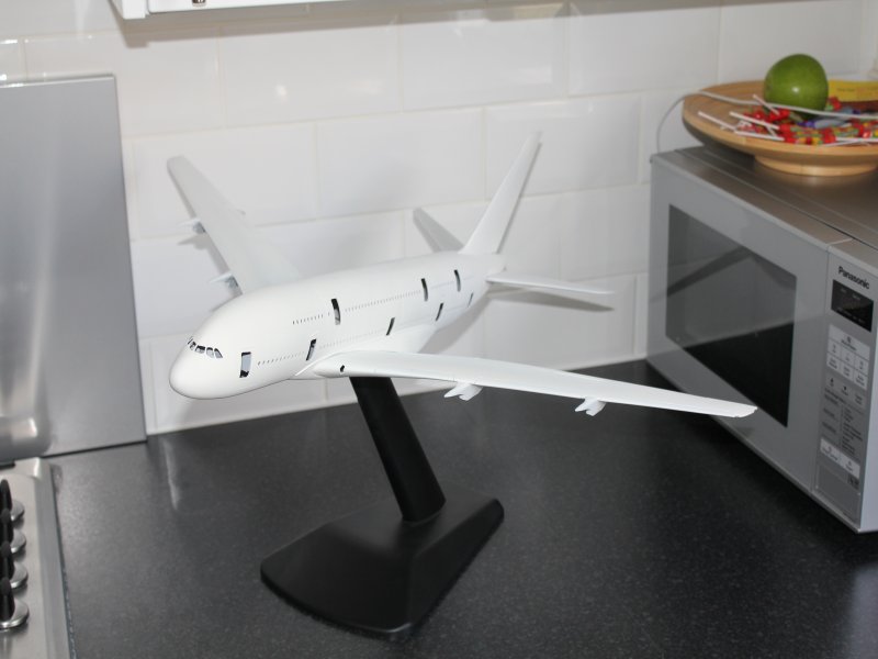

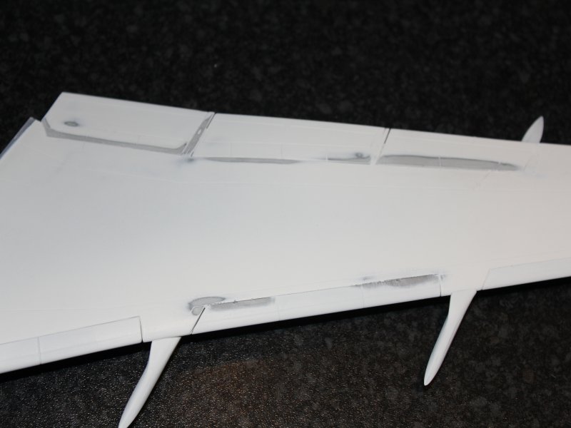

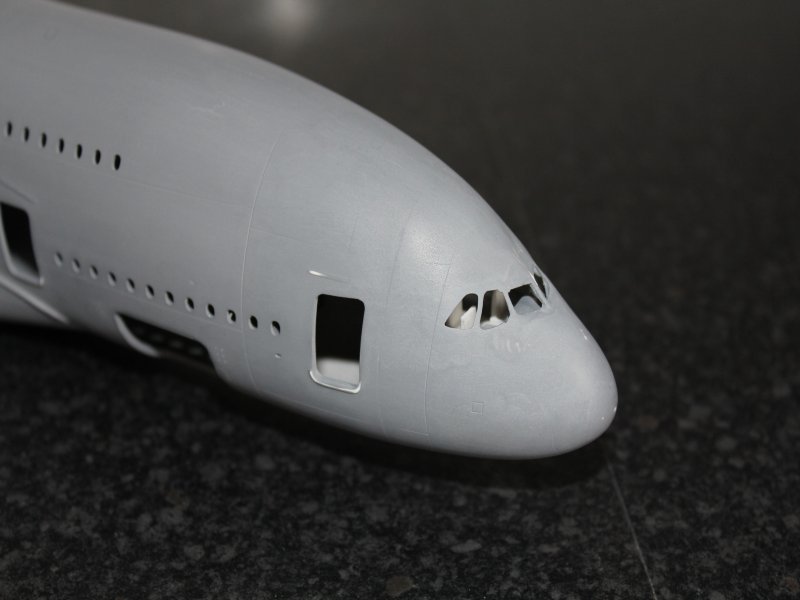

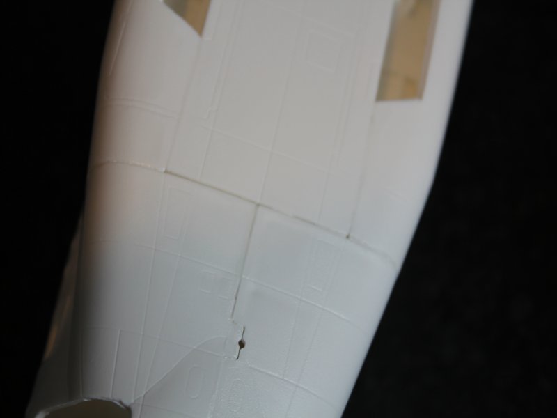

Another day and another update.. more filling and sanding was required to the fuselage and after another coat of primer it was time to start rescibing the panel lines. Onto the wings and once again some major sanding and filling of joins etc as everything was either too high or to low at the joins. The four main engines where assembled and given a coat of white primer ready for more sanding and filling..

#18 Posted : 16 July 2014 21:27:53

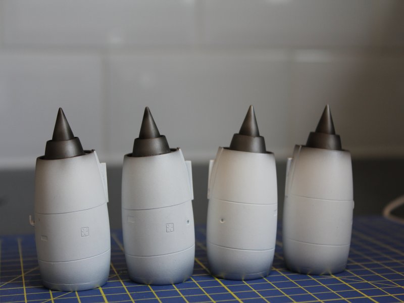

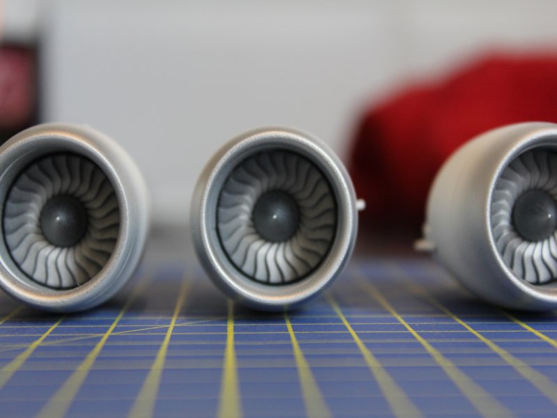

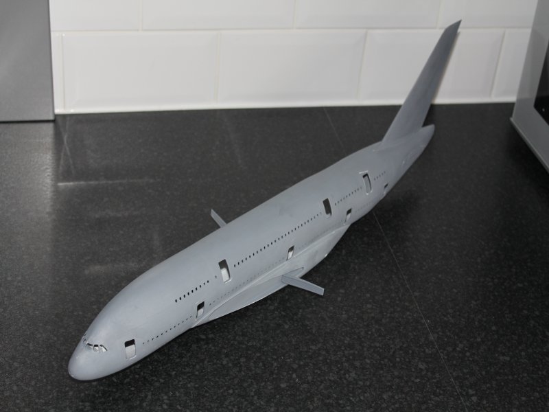

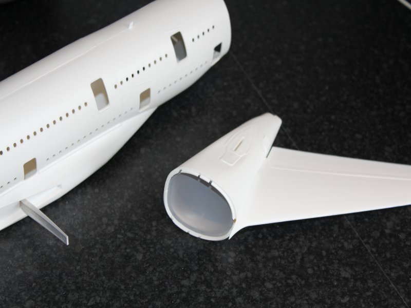

Some more work done on the fuselage with the addition of fitting some of the doors.... once again plenty more filling to do around that area as you can see and some more priming to get rid of any further imperfections.
The exhaust nozzles have had a coat of Alcad Manifold and stainless steel and the wings assembled and then any bad joins once again filed out and filled ready for rescribing etc..
