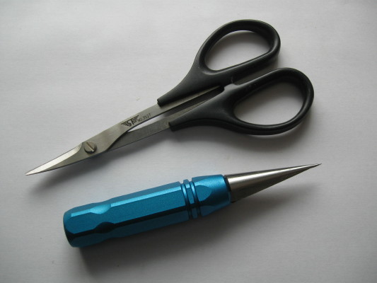

Note that a lexan bodyshell reamer and lexan curved scissors will be required to complete the racing body.

I am surprised that the Lexan is not even pre cut.
If you don't have a reamer a marker pen and drill work just as well.

I just have to say I recently picked up a schumacher body reamer and highly recommend one to save getting the drill out.
Finished 3D Printer, RB7, Hummer, Skyrider drone & Combat tank collection
#14 Posted : 27 June 2014 14:25:52
Saves the drill bit skating across the surface and does not leave a burr on the inside, and also gives the optionto open out the hole in small increments.

It also saves worrying about drill bit sizes as you can make the hole as big as you want.
Handy as I think I have about 3 different body post sizes between my models.
