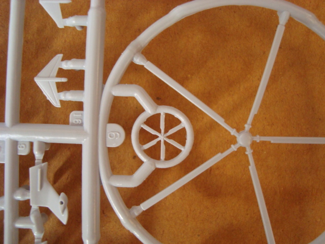

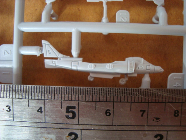

#16 Posted : 15 May 2014 20:36:57
Thanks for the input Robin, all ideas considered when the time comesBigGrin (and then prob just end up being lazy and painting them)LOL

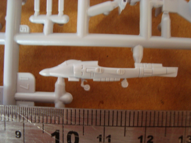

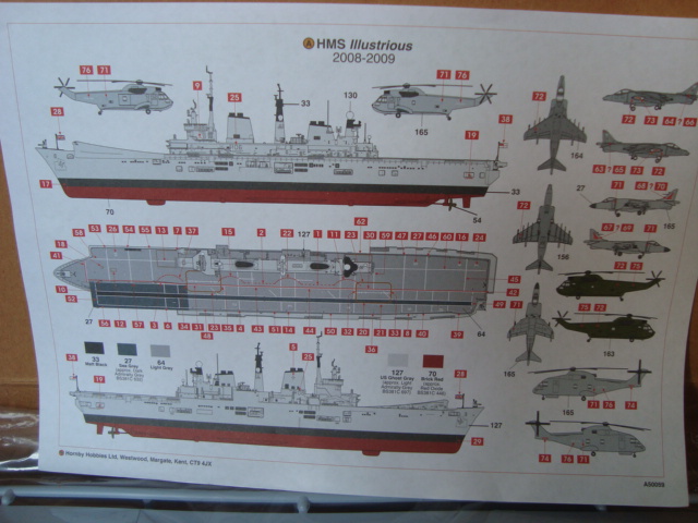

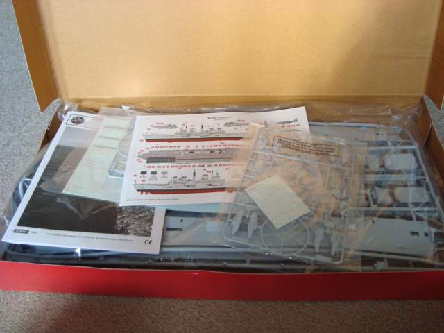

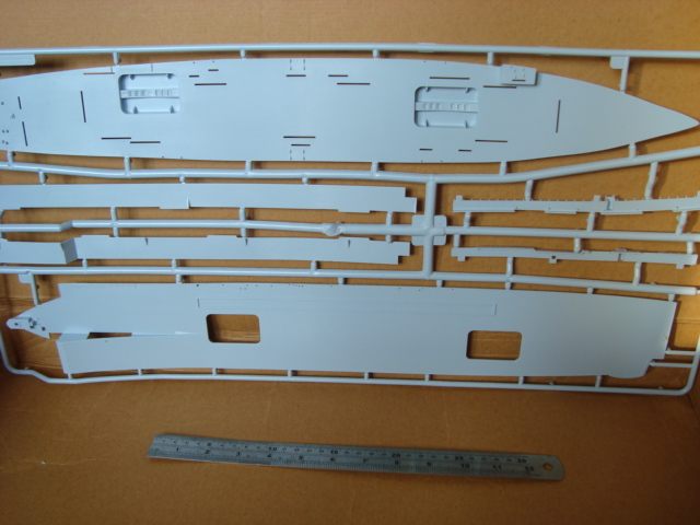

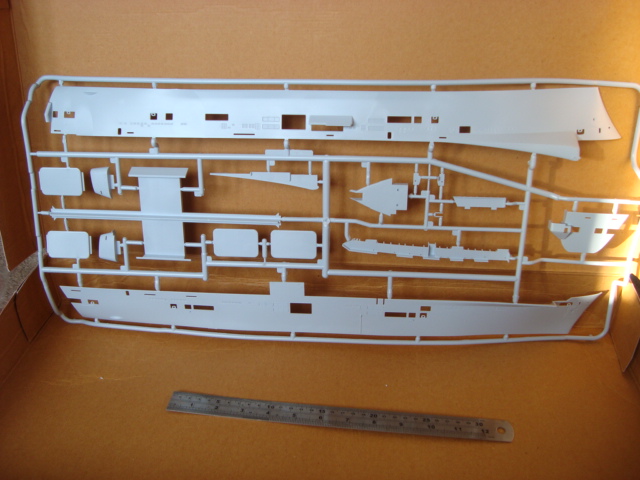

Thought Id put up some content shots to show the size compared to Vic, and the size of the sprues etc. The ruler is 12 inches. Some pics also of the 2 different harriers showing the size also.
One of the pics also shows the tail rotor for one of the helo's - looks like its on that sprue nice and safe, no danger of it falling outLaugh
It's a very nice looking kit though, really well moulded and excellent instructions and decals - there is even a full colour book on the real Lusty. The box is also very nice and is hinged opening and double printed top and bottom with some good reference pics.
My etch kits for the main model and airwing still havent arrived as there is a stock problem so I cant start this one yet anywaySad
