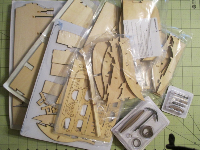

Here is my Victory build log. I have been wanting to do a model of the Victory for years. I tend to get put off when confronted by a large box of parts, and seem to inevitably stall out on the build. The Partwork format is perfect for me, and I suspect others over here in America will feel the same.

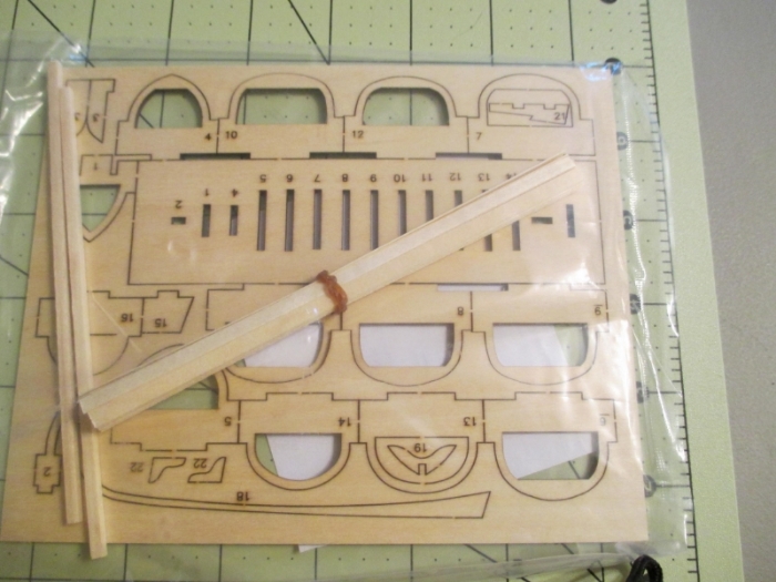

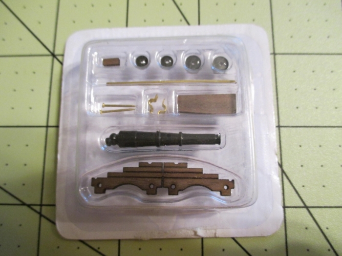

The parts packs are very well packaged, in GIANT padded manila envelopes. The initial parts pack had several smaller "kits" blister packed. These included one of the launches, a cannon, and a carronade. I am taking an immediate departure from the building sequence as depicted in the very nice instruction manual, and will assemble these at a later date. I would hate to build these little gems, and have them damaged in storage until they are required in the build. Tomick has done a magnificent job describing the builds of these in his official build log, so anything I have would be redundant anyway.
The first set of parts went together perfectly. The laser cutting is superb, and everything is a tight fit. The only issue I faced was that I was missing the parts for 3 frames, but an email to customer service had the parts on the way in a day or two. The log reflects the build to the point of the missing parts.

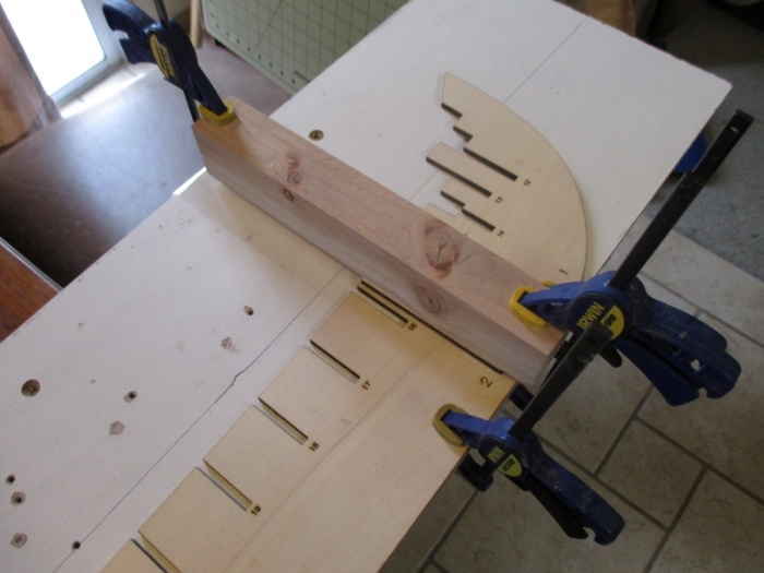

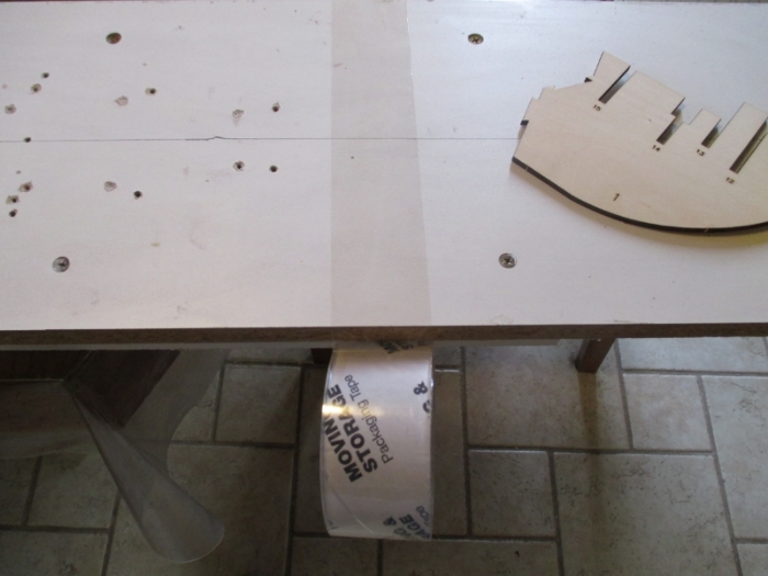

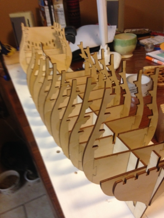

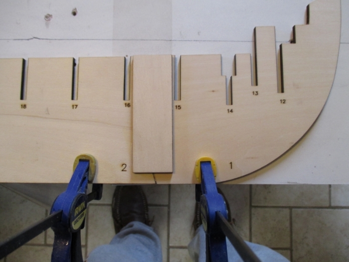

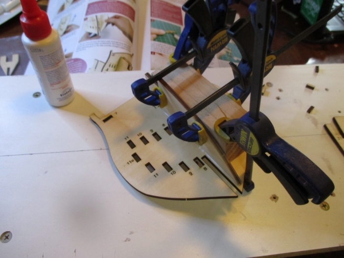

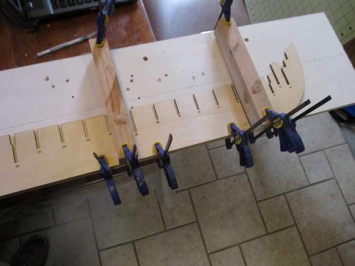

Sorry for the lack of pics this morning! My Photobucket account was giving me absolute FITS! Anyway, here are the pics. My build board is from other projects, but it works great for this. I laid down clear packing tape to prevent the parts from sticking. I am using a glue available here in the States called Weldbond. The block shown in a couple of pics is my answer to the perennial legos. If I don't see another lego before I die, it will be too soon! I stepped on far too many of those little ******** when my kids were young. The bevel on the block is to give squeeze-out a place to go without gluing my block to the whole thing.
Anyway, the pics!

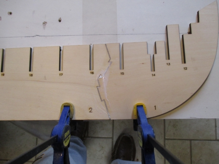

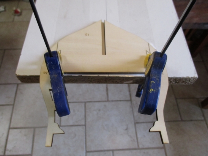

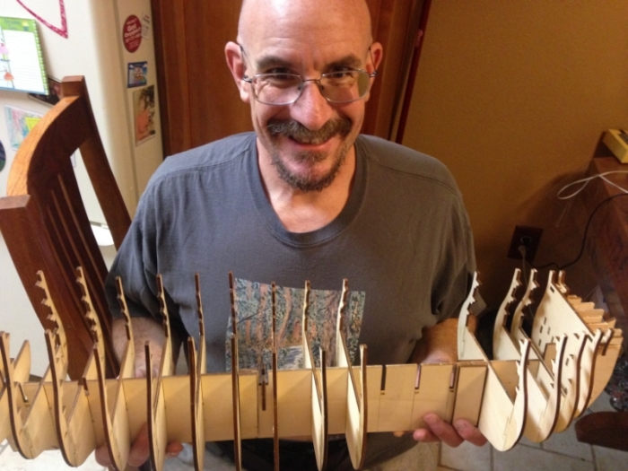

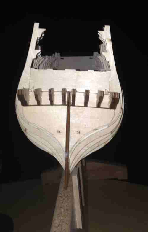

Here are some more. The keel is pretty badly warped and twisted, but in looking at the design of the kit, the next set of parts should pull it all together, and get it all in line.
You'll note there are a couple of missing frames. They apparently went on walkabout before they arrived in Nevada, but an email to customer service had replacements on the way in a couple of days.
The last pic is of my goofy self. I always like knowing who is "on the other end" so for all you US folks who have talked to me, there ya go!

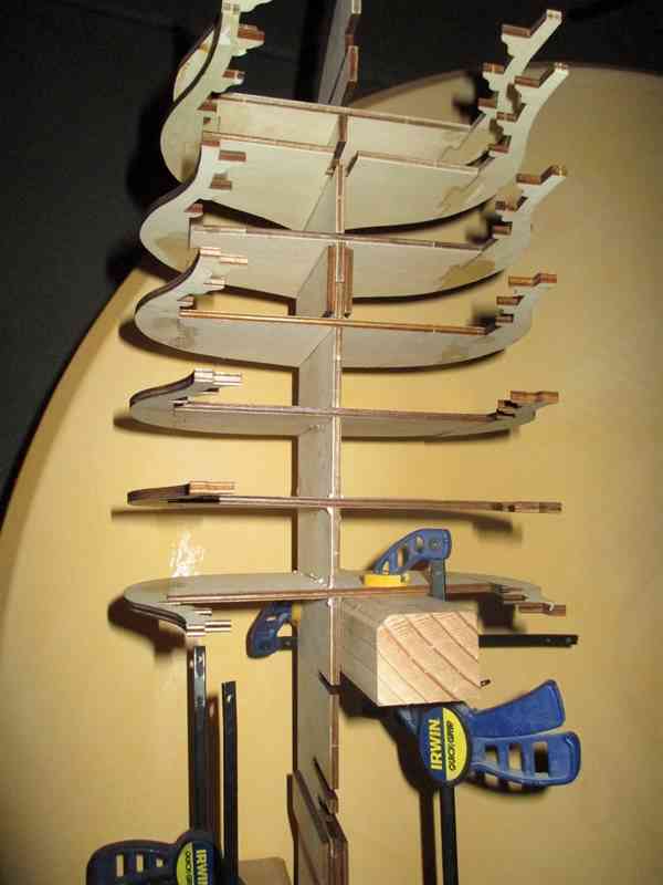

Hi Guys,
A bit more progress on my Victory. I am finally close to caught up on life, and hope to get (much) more bench time. It helps that I can actually SIT at my workbench for longer than 15 minutes too!

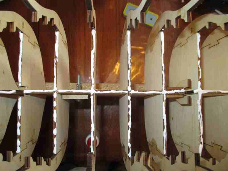

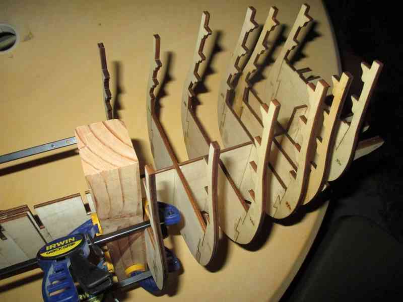

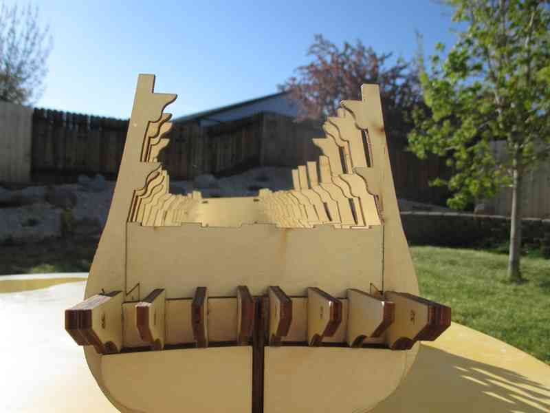

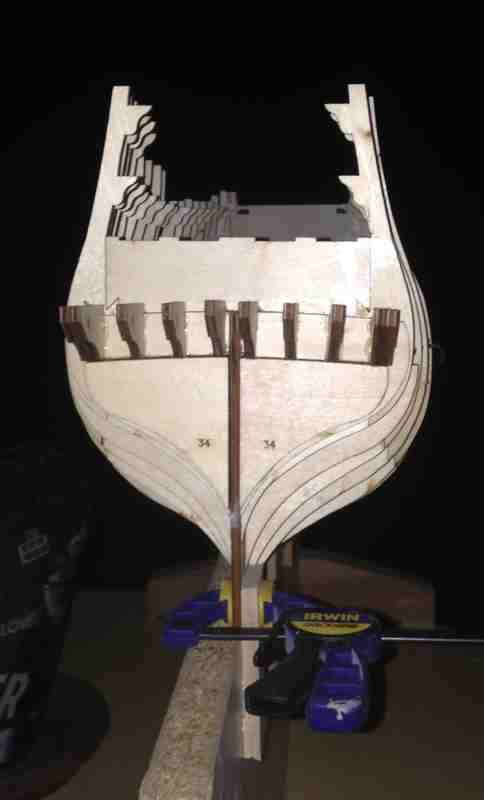

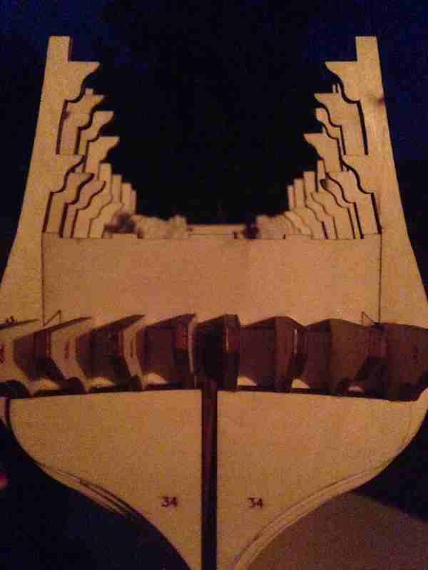

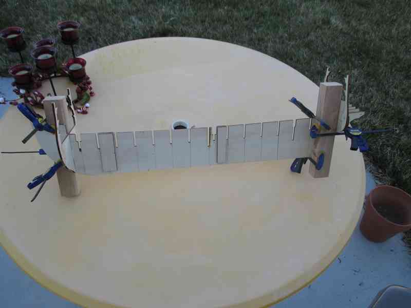

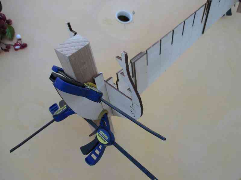

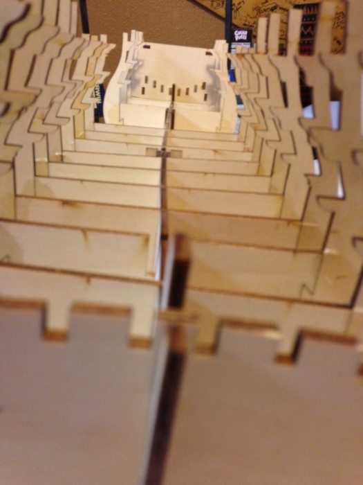

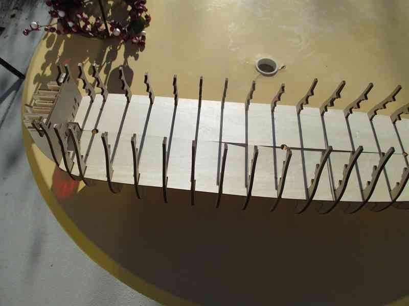

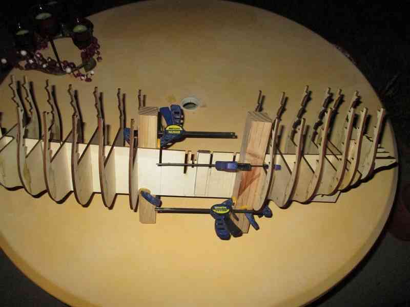

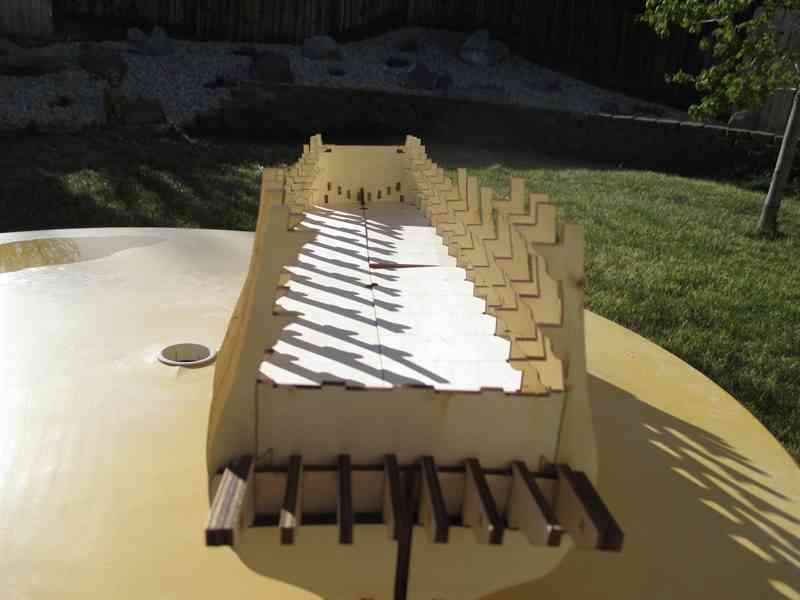

The stations are now fixed to the keelson. Due to the large degree of both warp, and twist, I have deviated from the recommended sequence a bit. I have glued all the bulkheads to the keelson, and let them cure with the gun deck former dry fit in place. I have an idea for a jig to hold the hull straight and true while I fix the deck reenforcing strips into place, and start the hull planking. I'll post pics of this as soon as I get it built.
I have the coppering set on the way from my contact in the UK, and will have that is aq week or so. I am pretty far from being ready for it, but I want to start patinating the tiles in multiple batches to bet many different variations of color.
Now, the pics! The first few are of the bulkheads being glued onto the keelson. I discussed my blocks previously. The last couple illustrate the twist to the hull.
experten attached the following image(s):

Thanks everyone!
Actually, if you look at one of the last photos, there is a nasty twist to the whole thing. In doing a dry fit of the deck, and then the support beams from issue 17, it doesn't want to come out. I do have a jig in mind, and as soon as all the company departs tomorrow, I'll get it built. (Pics soon)
I also steam bent the deck support beams. I'll try and figure out Youtube and post a link. It is dead simple to do, and is far stronger than kerf bending the pieces.

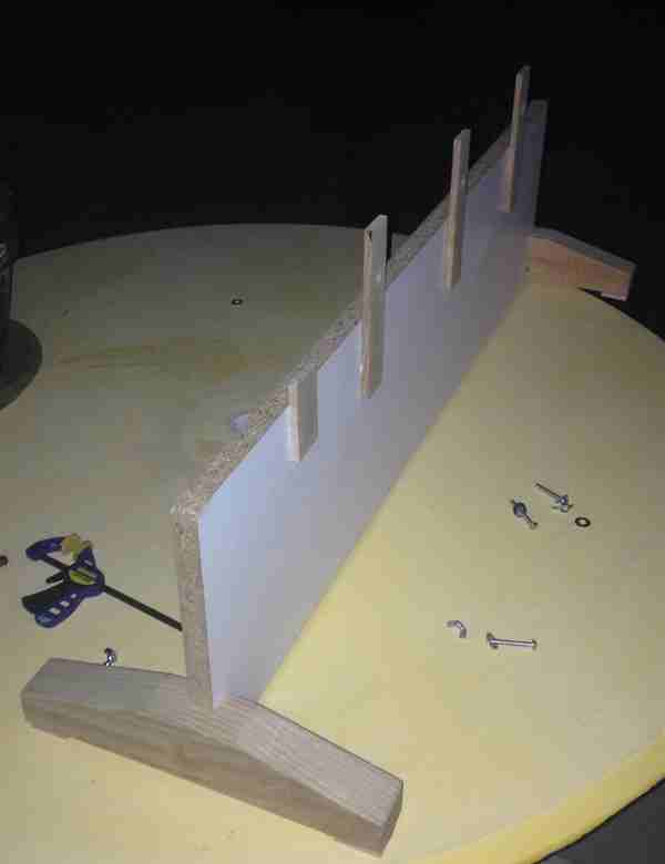

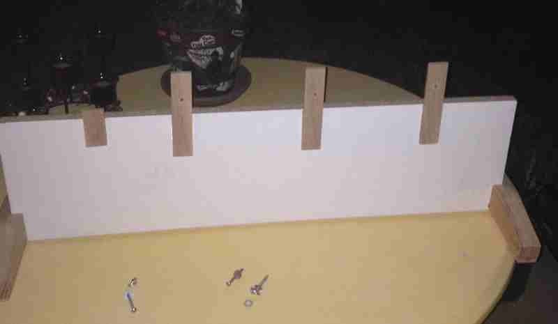

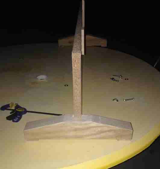

As promised, here are pics of my jig. I also have a couple of "before and after" pictures of the hull. You can see the twist, but what doesn't show up is the warp. I ran 3 bolts through the keel, and they are secures with wingnuts. The last little vertical I needed as it wasn't quite where I wanted it to be, but with a clamp on that, holding the keel, it is dead-on.
I built the jig out of scrap melamine from my other building board, and the legs are scrap 2x4, with little ash feet, also scrap. (One of the joys of being a woodworker, no shortage of scrap, or firewood!)
I plan on cheating outrageously in securing the decks to the hull and the deck braces to the frames. I have a 23 gauge pneumatic micro-pinner that will make short work of it.
I am also using a new CA that is available over here called "NexaBond." It is designed specifically for wood, and is sort of stringy with a medium liquid carrier. It works marvelously!
Anyway, the pics!

#16 Posted : 12 May 2014 08:40:08
Hi Mark,
This jig looks interesting but don't fully get how it works...
If you have fastened it to the jig, won't it just spring back to being out of shape when it comes off? what are you doing to permanently sort out your twist and warp?
experten
#17 Posted : 12 May 2014 15:14:38
Joined: 10/02/2012
Posts: 475
Points: 1,237
Jase, As soon as I get the first runs of planking on it, it will stop moving. This is a spin on a strongback for building a canoe. The planking will add both torsional and lateral rigidity. The vertical pieces on the jig are bolted to the keel, which pulled the twist out. These are all perfectly parallel, while the keel had the twist. (They kind of function like the bits of angle bracket you see on a lot of the build boards in the various logs for the Hood or Bismarck)
Tired, Old, and Cranky!
#18 Posted : 12 May 2014 18:48:11
Right I see
Not convinced it's any easer than the more conventional build jigs that everybody else uses? But thanks for sharing your novel idea.
I will be interested to see the result once you have started the plating, as you will have to undo the fastenings and I am sure the keel will still pull out of shape, which it would not be able to do on a conventional jig.
Have you used this method before?

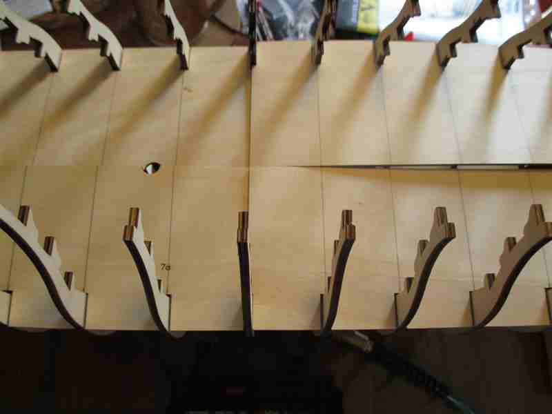

#19 Posted : 21 May 2014 07:06:42
Joined: 10/02/2012
Posts: 475
Points: 1,237
Hi again!

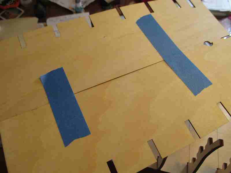

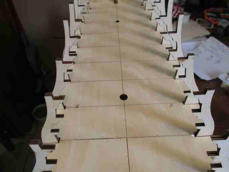

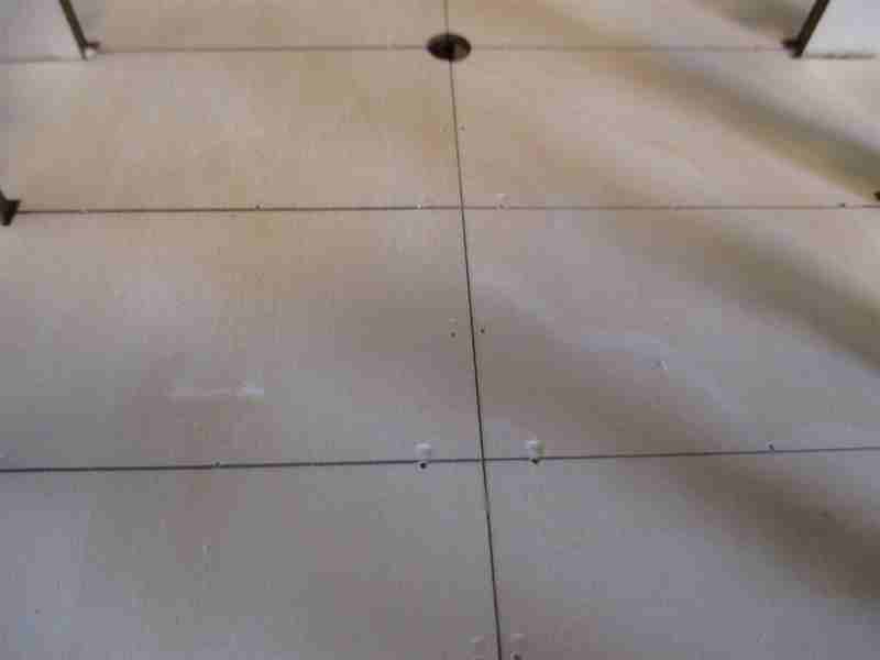

Today was a lovely, rainy day. 9It is snowing a couple of hundred feet up the mountain by the house...) This is a rarity here in Nevada, so I took advantage of it to get the first deck laid on my Victory.
I am going to adopt a bit of different approach to my build log here. You guys have seen multiple Victories done, and know the kit, and how it goes together ad nauseum. I will attempt to bring a bit of my "other" experience into my build log, and maybe show some tools and/or techniques you've not seen before. I have been a professional woodworker for 30 years, and have worked in cabinet shops, done aircraft composites, and build and restore antique and new wooden canoes. I was also a machinist for the Army, and am a certified welder. So, I have a bit of a different skillset to draw upon. I do tend to over-think things from time to time, and Jase's mystification at my build board approach got me going off in this different direction.
My Victory suffers a badly warped and twisted keel. I am pretty sure it is a result of the arid climate I live in, and not deficient quality product. The ply in the keel is above reproach! My build board was pictured above.
Jase said that he thought my keel would pretzel again, as soon as it was off of the build board. It may get a bit of the warp back into it, along the bottom, but I really don't think it will twist again. If it does warp again, I can fix that right up with the garboard runs of planking. The reason is this; I am relying on the torsional resistance of the mechanical/glue bond in both the various decks, and more importantly, the deck braces to hold it all in line. The joint between the frames and the brace in particular should preclude this from happening.

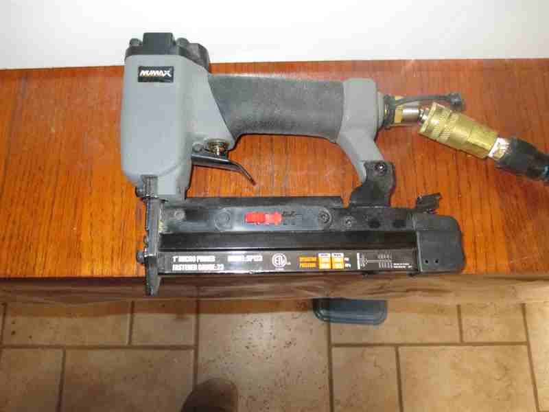

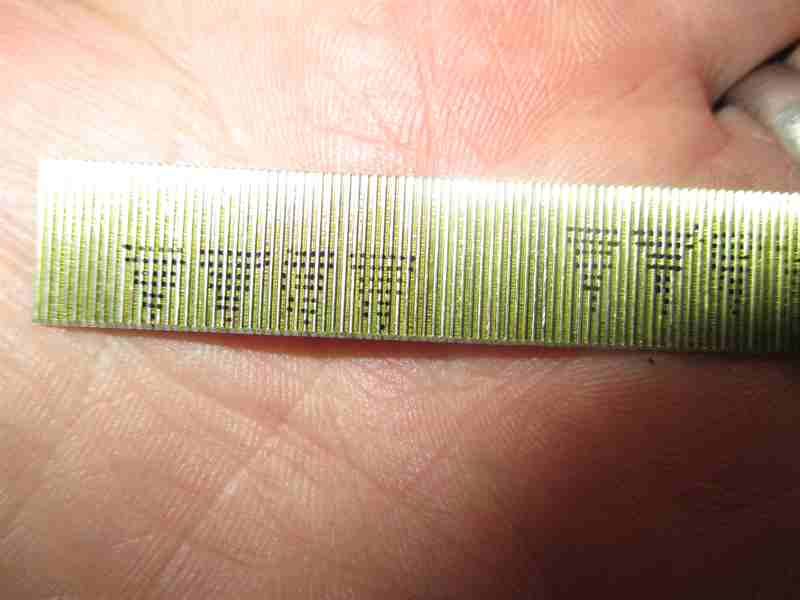

I brought in a toy from the shop, a 23 gauge micro-pinner. This shoots headless pins that are .02525 in diameter, and 1/2 inch long. I ran the gun at 30 psi. It took about 10 minutes to fasten the decks down with this. I laid out the lines, as per the instructions. I took a different approach to laying the deck, based on the twist, and warp. I made a gate fold with blue tape, and laid the deck by folding it into place. This worked like a charm. I then pulled the tape off, after I fastened the deck down with the micro-pins.
I got the deck braces mixed up, so there will be pics in the next couple of days of those going in, as well as a link to a YouTube video of how I steam bent them.
Now, the pics!

#20 Posted : 21 May 2014 10:36:15
Wow. You are not worried about the potential for damaging the wood or weakening the joints through the impact of nailing?
If it is working for you great but would scare the hell out of me.
I wonder why I have never seen anybody do it this way before?????
