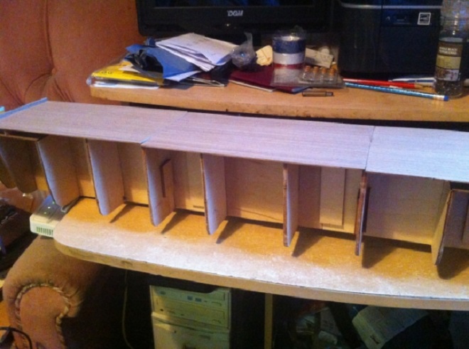

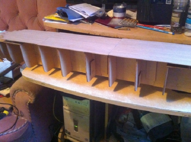

I have started the strip back to see what`s underneath Huh
The answer, NOT GOOD.
Not a single laser cut edge cleaned before glueing. Crying
Rear rib put in wrong way round. Crying
Glue only touched where it was lucky. Crying
Now the latter comment was to be of my advantage.Cool
So where did I go with the recovery?
Firstly, removed panels and planking from port and starboard sides.
These had only been fixed to the central part of the hull.
I have managed to rescue nearly all of the removed parts due to the bad fixing used. (A Result)
Some parts had no glue at all applied, just pinned Confused
Cleaned up the edges of the ribs and here`s the results.Pic 1+2

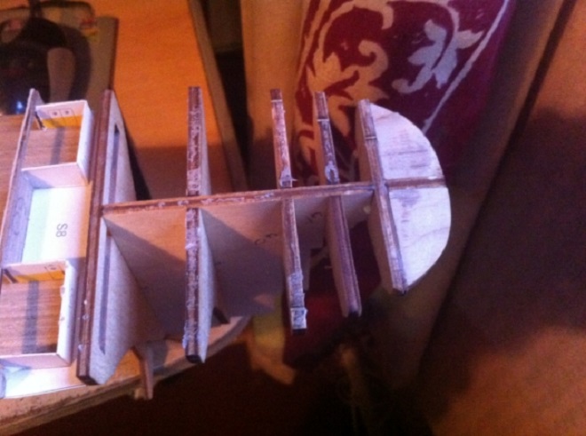

Having turned it back to this point, I took a look at the stern.
OMG OMG OMG
The stern deck did not touch either the last rib or centre keel section.
There were also 3 stern shaping sections to port and starboard.
These were not touching, centre keel or stern rib, just stuck to the deck above.
So, removed said parts and refitted the stern keel shaping pieces.Pic 3
