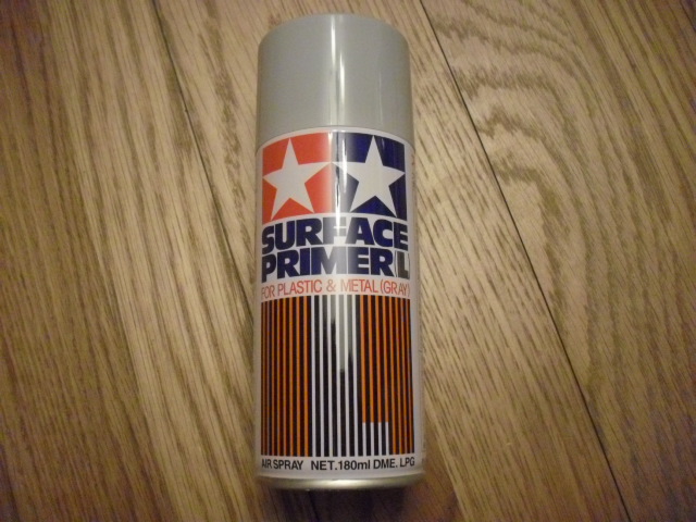

#6 Posted : 13 May 2013 09:18:09
Hi I use Tamiya primer avialable in handy cans, I have used it on wood with no problem. here is a photo
Kind regards Mike
