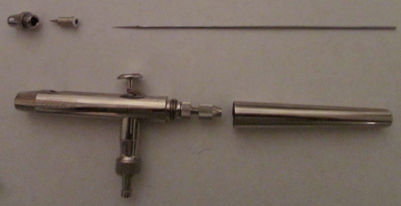

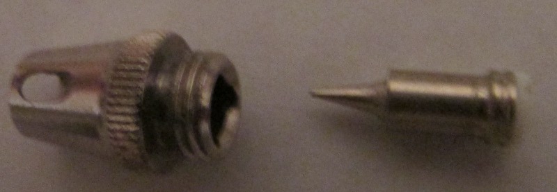

STRIPPING DOWN & CLEANING.
The picture below shows a stripped down Harder & Stenbeck Brush. This brush has a push fit nozzle, many brushes have a screw fit nozzle but the cleaning procedure is the same.
My method for sdtripping down:
1. Clean as per instructions for changing colours.
2. Turn off air supply, bleed system & remove supply hose.
3. Unscrew rear of brush & set aside.
4. Unscrew airbrush cap & set aside.
5. Remove nozzle, if push fit - pop out, if screw fit - unscrew using spanner that would have been supplied with Airbrush. Be very careful here, you do not want to drop nozzle or damage seals.
6. The tip of your needle will know be exposed again this is very fragile. Loosen thumb screw/locknut at rear of brush (no need to remove fully) Remove needle from FRONT of Airbrush. This aviods dragging any paint or particles further into the brush.
7. Control lever will now be loose so be careful it does not drop out, you don't need to remove this item.

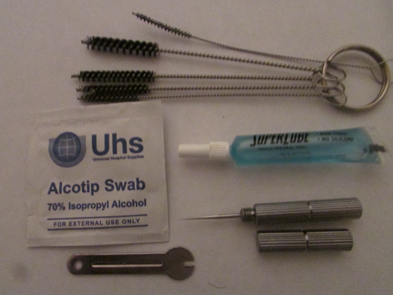

CLEANING
The picture below shows the items I generally use to clean the airbrush.
The nasty looking sharp item ia a reamer for the nozzle. These have a tapered 'blade' so are useful for any nozzle size. They have to be used with extreme caution, I only use mine if I have a nasty blockage in the nozzle orifice.
Wilfy the Sea Dog attached the following image(s):
Wilfy the Sea Dog
#4 Posted : 06 September 2013 23:41:18
Joined: 06/06/2010
Posts: 566
Points: 1,657
CLEANING.
The order of carrying out the cleaning is not really important, the steps I use are as follows:
1. Using an alcohol swab I polish the needle to remove any paint residue, this will remove all paint even hard spots.
2. Using the same wipe I will clean out the paint cup.
3. I will now put a couple of drops of airbrush cleaner/IPA into the colour cup (careful here as it will run out if you tip the brush) Now insert the appropriate sized cleaning brush into the orifice at the front or rear of the airbrush & clean using an in/out motion, you may have to do this a couple of times, dabbing the cleaning brush onto some kitchen roll inbetween.
4. Give the front cap & nozzle a good wipe. If there appears to be lots of paint (especially if it looks dried) in the nozzle, it can either be soaked in cleaner or reamed. In my experience either of these are seldom necessary. If you have one & do decide to ream. procede with EXTREME CAUTION as too much presure will destroy your nozzle. The other alternative is to pop into an ultrasonic cleaner if you are lucky enough to have one.
5. All that remains now is a quick wipe over the body & you are ready for re-assembly.
