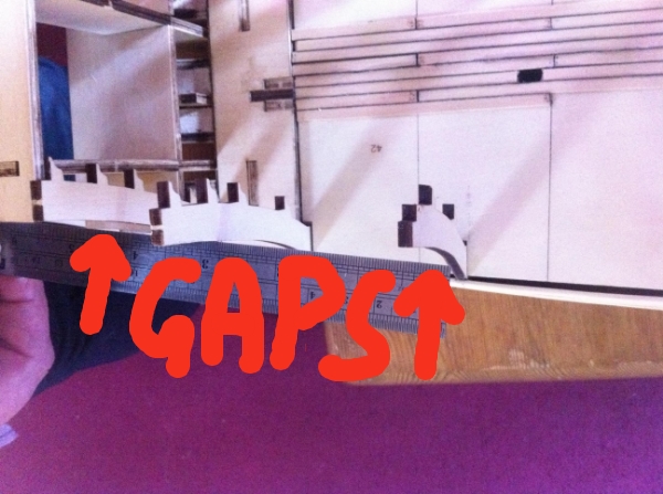

First: Gauge how big an issue I was dealing with.
The good side (Port)Pic 1

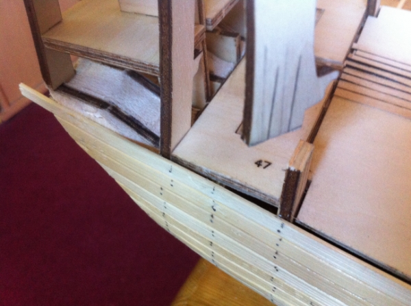

The bad side (Starboard)
Note the gap between rib #22 and the ruler.Pic 2

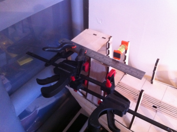

Next:Mark where the rib needed to end up.

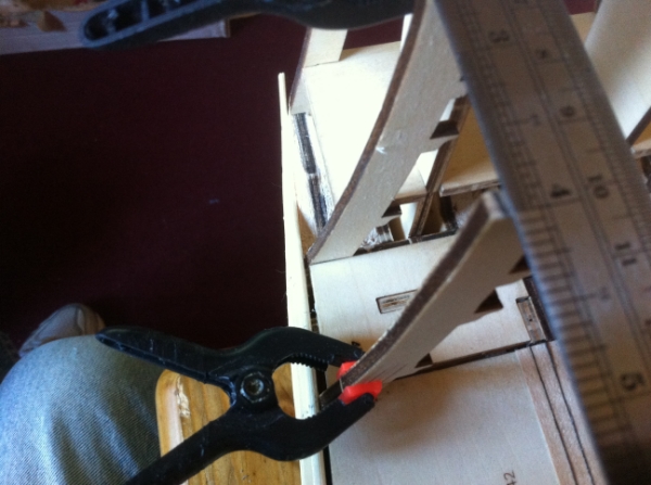

I placed a ruler along the outer edge of the top plate of the gallery and marked where it crossed rib #26 on both sides.
PORT. Pic 3

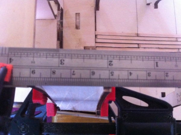

Starboard: note the line of the ruler and the second mark on the rib which is the point that should be in line with the ruler.Pic 4

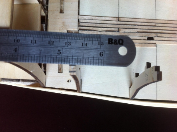

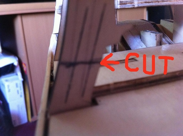

I moved the ruler up from the deck level, whilst against the ribs until things went out of line and marked that point on the defective rib. I also at this point put two lines top to bottom as guide lines for the reinforcement rods that are to be installed. Sorry pics a bit fuzzy - got to close for camera Blushing Blushing. Pic 5

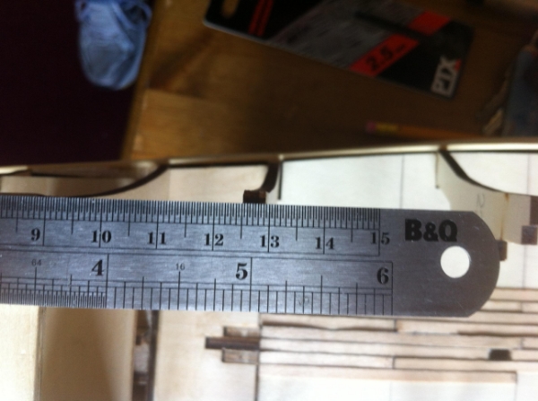

It is at this point the knife gets a brand new shining bladeLOL LOLand I very carefully removed the offending rib.Pic 6

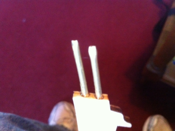

I am using 2mm brass tube for reinforcement so drilled 2.5mm holes in both halves of the rib to allow the adhesive a bit of grab space.
I have used brass tube for two main reasons:
1: Allows the adhesive to flow inside so you dont just push it back out of the holes and
2: Easier to bend very slightly to obtain correct alignment with holes in upper part of rib.

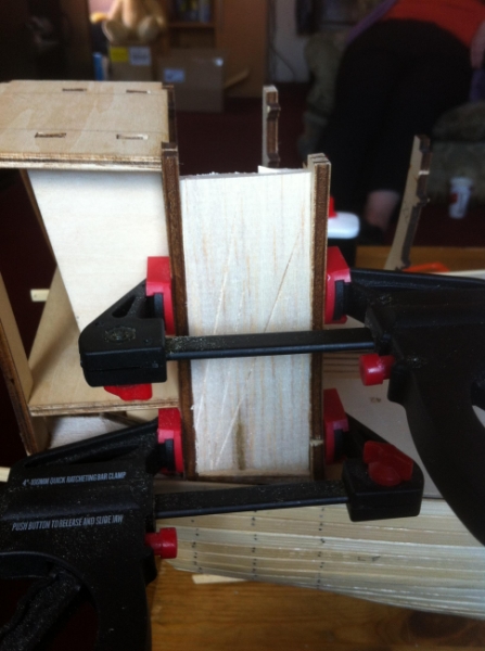

Before the parts see any adhesive I checked that everything would fit to give the desired cure to the problem.Pic 8
Please note that the ruler is not exactly on the mark but very close. Final adjustment to come.
It is critical at this point to realise that the rib also needs to be kept in the correct vertical plane in respect of the other ribs, so I cut a 34mm balsa wood spacer.Pic 9
Then came the second dry test fitting.Pic 10

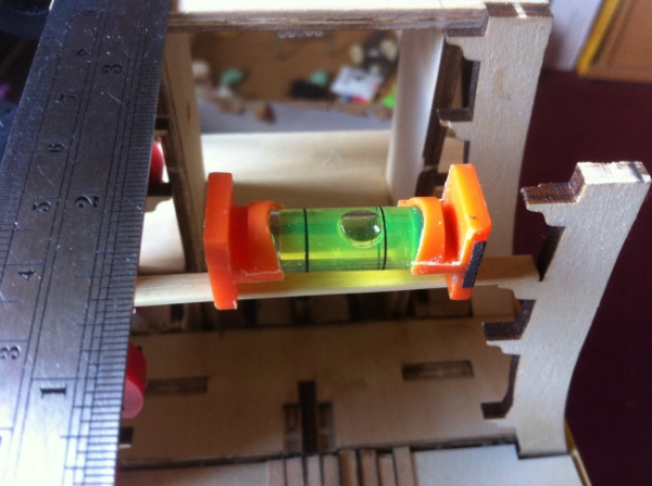

As a final check, were the deck support extensions on the inside of the rib level? Pic 11
It was close, but final fitting will get it better.

Next fix the pins into upper part of rib and glue.Pic 13
