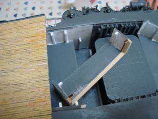

This time, I introduce a stern side tray as a land mine of this model. All tray parts are movable in this model so that it makes possible to show various seen of the Akag's inside..Half of stern sided tray part is under the stern flight deck that is fixed on the walls of the hanger deck. Since I had guessed this tray was too long to be moved after fixing the stern flight deck, I fixed the deck part without setting the tray part. After glued the flight deck, I found I had been right. Cool
#1 I could not insert the tray under the flight deck, because the tray was too long.
#2 I divided the tray part to be able to insert just the stern side part..
#3 Bow side part was slightly extended to embed the gap between the tray floor and lift floor.. An original tray part was so short that there was a gap between the floors.Cursing
#4 Paint the bow side part and set it after the stern side part.

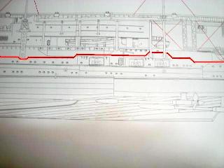

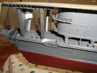

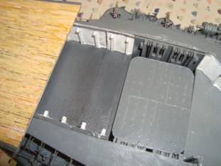

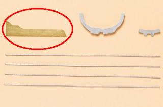

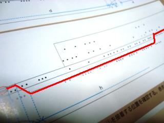

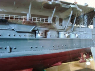

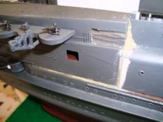

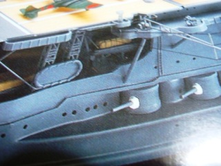

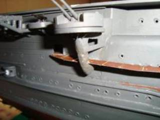

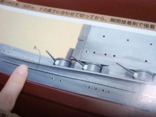

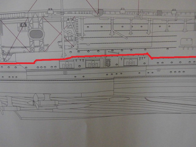

But there is a severe problem, DeAGOSTINI Japan told us to make the cable be attached under the 20cm guns.Blink Pic #1 is a part of the plan from Hasegawa Co. Red lines are the cable. You can see they are above the three 20cm gun. Pic #2 is a photo from the series guide book that was a annex of the issue 1st magazine from DeAGOSTINI Japan. You can also see that the cables are above the guns.

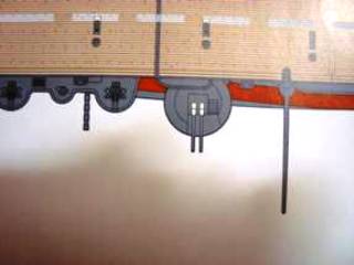

However they had been correct at beginning, they had mistakes at issue 57,58 and 59.Cursing Pic#3 is a part of plan from DeAGOSTINI Japan in issue 57. Red lines are also the cables. You can see that the cables are under the guns and are more closed to water line. Pic#4 is the photo from issue 58. A person attaches the cables based on the incorrect plan.Angry Many Japanese Akagi builders believed it.Cursing

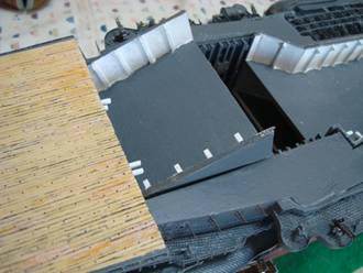

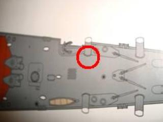

I guess DeAGOSTINI Japan might misunderstand how to use the fire wall parts that is shown in the red circle in Pic#5. They told us to make the wall parts be attached later stage of this series, I thought the cable should be attached on the wall .
I had to wait for attaching the cables after attaching the fire wall parts on the hull as Pic #6.Cool

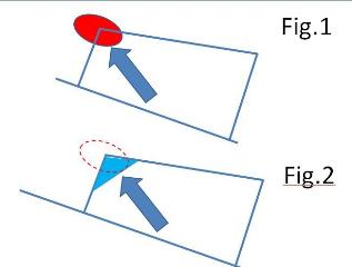

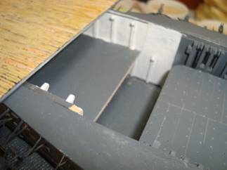

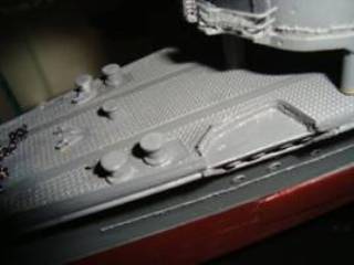

This time, I show you a small mine about the spare anchor bed of the bow deck.
There are four flight deck's props on the bow deck as shown #1. One of them are on (not "near") the spare anchor bed in this modelMad .
I attach a schema. If you build it as DeAGOSTINI's indication, the port side stern prop is put on the bed (Fig.1). So I piled putty there(Fig.2,#3,#4). Otherwise the prop would be hanging from the flight deck.Cursing
Best Regards,
Yutaro

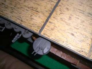

Hi Andy!
As I promised, I have attached the image of the location of the cable near 20cm guns on the starbord.
I hope this helps your building.
Best Regards,
Yutaro
