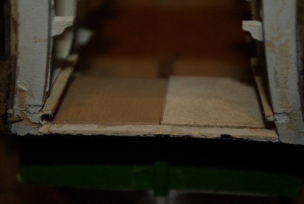

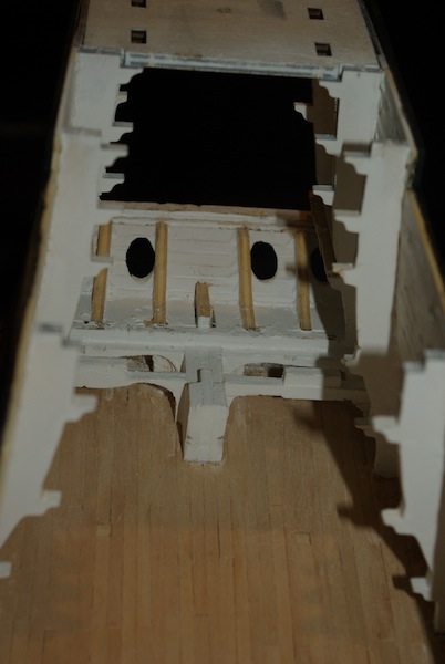

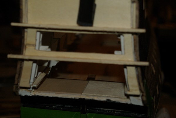

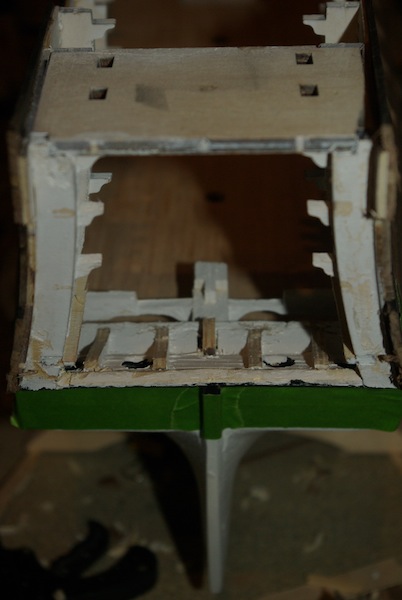

while working at the stern I noticed that I would not have room for upper deck stern chasers due to all the bits and bobs of the stern construction. The only thing I could do is rip it all out.

#28 Posted : 24 August 2013 12:13:06
Hi Sandy
Had the same problem,I am back at it with the dremel this weekend.I have purchased one of every type of ornamental cannon Amati make.My decision is full carriages throughout.These cannons are so nice,they just have to be fittedLOL .
Kind Regards Nigel
SandyM
#29 Posted : 24 August 2013 12:49:21
Joined: 13/09/2012
Posts: 149
Points: 435
Location: Highlands of Scotland
NMBROOK wrote:
Hi Sandy
Kind Regards Nigel
Hi Nigel,
I agree they are very nice, I have decided on the 40mm (barrel 37mm) for the middle deck. I think the 50mm ( barrel 45mm ) is to heavy for the lower deck even on a smaller truck there for I am extending the 37mm barrels for main battery in the lower deck.
Sandy
