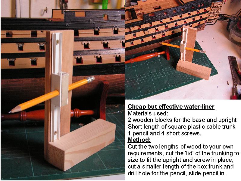

Hope this is the right place for tool tips and suggestions, here's a very cheap method of making up a water-liner. In my own case it was built up completely from off-cuts, spares and left-overs so it didn't cost a penny!Flapper
Once constructed the box section with the pencil is simply moved up and down the 'rail' to the correct height and 'snapped' into place. This one was made for my 1/100 scale Victory, for your larger builds you could have a bigger base section perhaps with those little friction-less furniture gliders for easier movement?
In use, the one thing to remember is to have the end of the pencil stuck out far enough to reach all parts of the hull including the 'undercut' regions at the stern! (I got caught out the first time!)

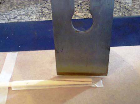

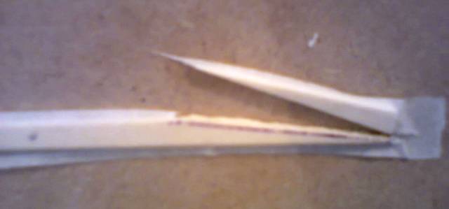

Cutting Tapers
Any carpenter has one of these, laying on a shelf. I use the blade (50mm wide)of a wood planer to do straight cuts.
Demonstated in the picture I used the Bamboo strip taped down with masking tape on a Superwood cutting board.
The Masking tape (used in Vehicle Spray workshops) mask the pencil marking. If you made a mistake in the marking, just replace the tape. The Tape keeps the strip in place for precision marking of the cut line.
The Masking tape is a tip out of this forum.
