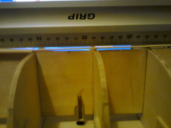

SOTS Bottom section
When I started the build of the SOTS, I had to tweak the rib-slots to level out the deck.Glare
I am to plank the hull now, only to found the waves of the deck been tweaked, has moved down the hull to ribs #13; 15; 16; 20.
The deepest gap (+- 1mm) is at #15 where the two planks joins in the middel of the rib.Crying
Blink If I follow the false keel's line, all the bottom planks immediately next to the keel should be in a straight line from #7 up to #21.Confused
I enclosed a photo of my dillema. Please help me to rectify if it needs to be tweak. Confused Any info regarding this matter is highly appreciated.
Thanks
Marcel
Cool
Marcel attached the following image(s):
"Rather try and fail than had failed to try".
Sovereign of the Seas
Model Space forum: Marcel's build
NMBROOK
#9 Posted : 15 August 2013 10:00:56
Hi Marcel
I would glue some stripwood to the low areas and when thoroughly dry fair the strips to remove the dips.
Kind Regards Nigel
#10 Posted : 15 August 2013 14:43:29
hi there. the bulkheads do need to constant i.e. all the same in the middle section of the false keel. if you used pva or aliphatic glue removal will be easy of the affected bulkheads, just use a paint brush and warm water to soften the glue,then adjuste slot in the bulkheads to rectify. I recommend you do it this way, otherwise the decks won't sit properly.
