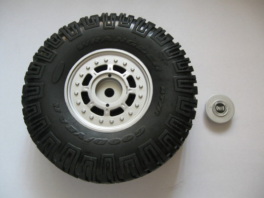

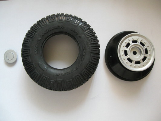

#1 Posted : 10 July 2013 10:37:54

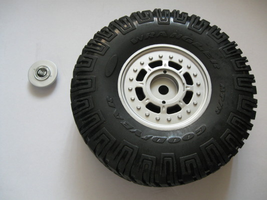

Stage 17 - Contains a tyre, wheel rim and hub cap.
Fit/glue the tyre onto the wheel rim as before. Then cut-out and place the hub cap decal onto the cap as before.
Thats it for this stage.

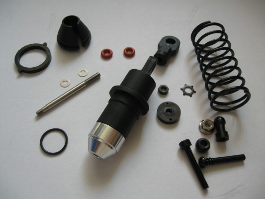

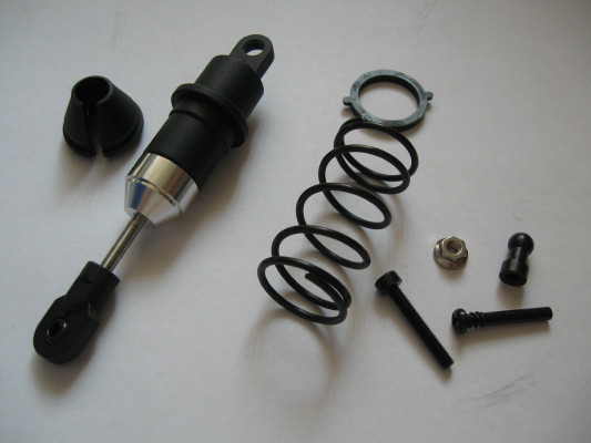

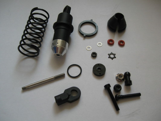

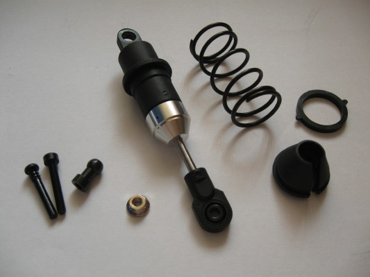

#2 Posted : 10 July 2013 10:39:05
Stage 18 - Contains shock absorber parts.
Assemble the shock assorber as before and carefully store the remaining parts.
#3 Posted : 10 July 2013 10:40:07
Stage 19 - Contains a tyre, wheel rim and hub cap.
#4 Posted : 10 July 2013 10:42:39
Stage 20 - Contains shock absorber parts.
Assemble the shock absorber as before and carefully store the remaining parts.
At this point you can fill all four shocks with the oil provided in Stage 9, following the instructions on Page 238.

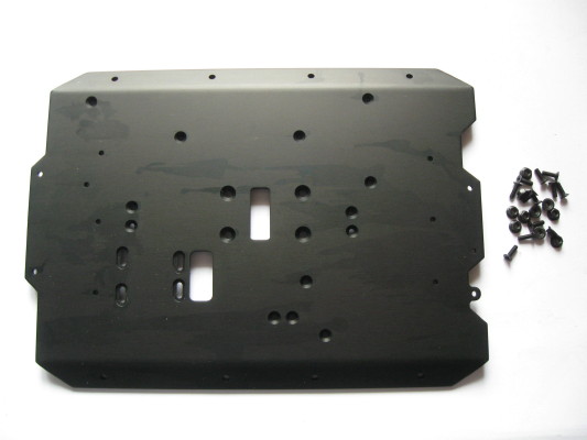

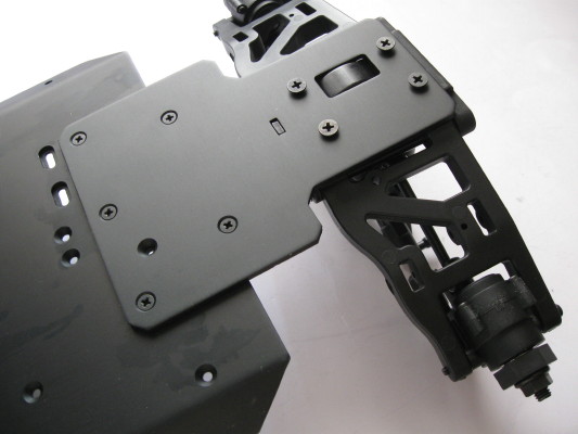

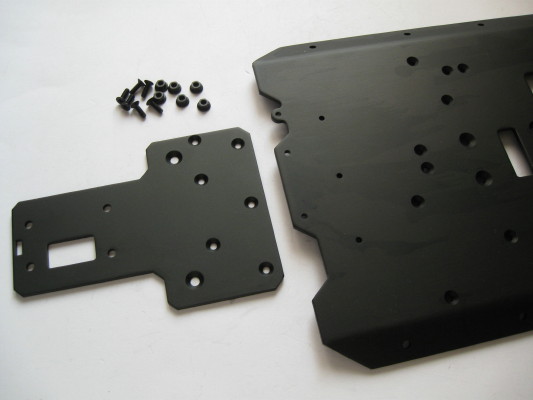

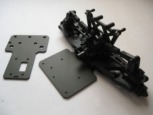

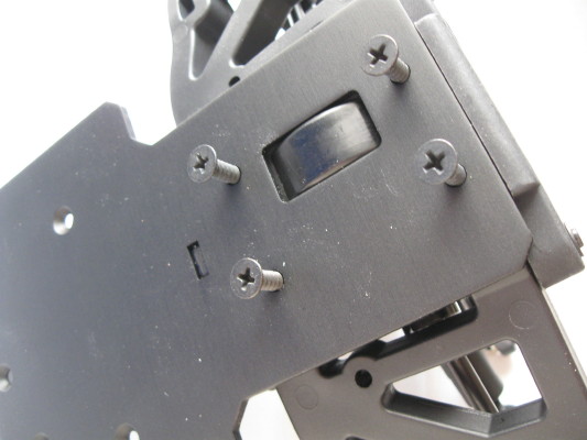

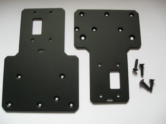

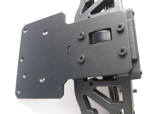

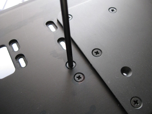

#5 Posted : 24 July 2013 11:20:59
Stage 21 - Contains black aluminium front and rear chassis plates and screws.
Note the difference between the front and rear chassis plates, then take the rear plate and set the front plate aside for the next stage.
Take the rear suspension/gearboxx assembly previously constructed. Place it on the the con counter sunk side of the plate, then secure the plate to the assembly using four 4x16m screws.
You'll notice that their heads are stand proud of the plate. Later on theses screws will be removed to add a further part which the screws will seat into. Take care not to overtighten the screws.

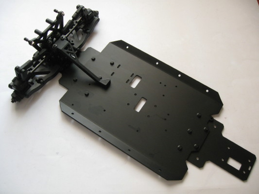

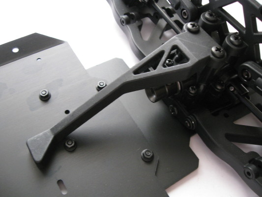

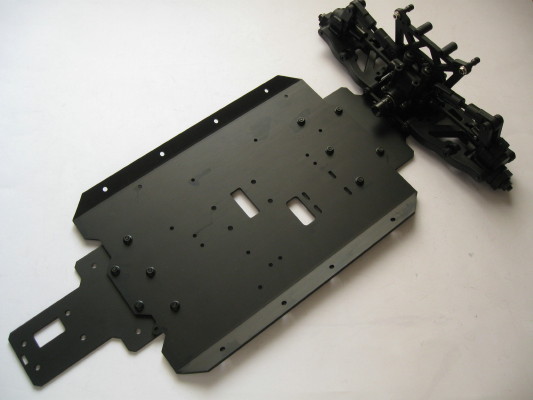

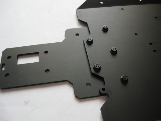

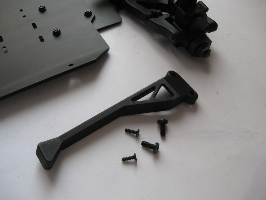

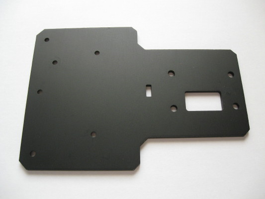

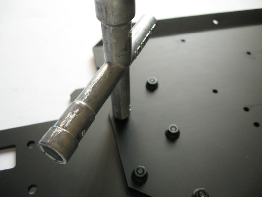

#6 Posted : 24 July 2013 11:24:09
Stage 22 - Contains the aluminium middle chassis plate, screws and flange nuts.
Identify the front and rear of the chassis plate and also the countersunk side.
Take the front chassis plate provided at the last stage, secure it to the front of the middle plate using five screws and flange nuts. Locate the screws from the countersunk side and secure each with a flange nut.
Repeat to fit the rear chassis plate assembly at the rear of the middle chassis plate.
Retrieve the torque rod and screws provided at stage 8.
Secure the rod onto the rear suspension assembly with two 4x10mm screws, and also on the underside of the chassis plate with two 3x10mm screws.
This completes this stage.

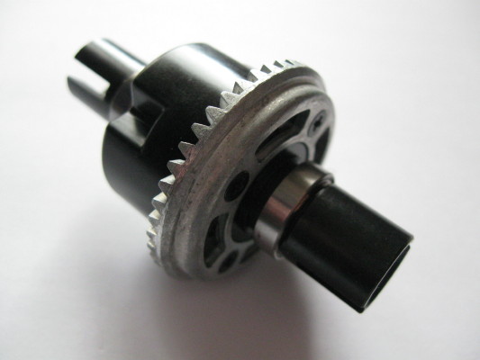

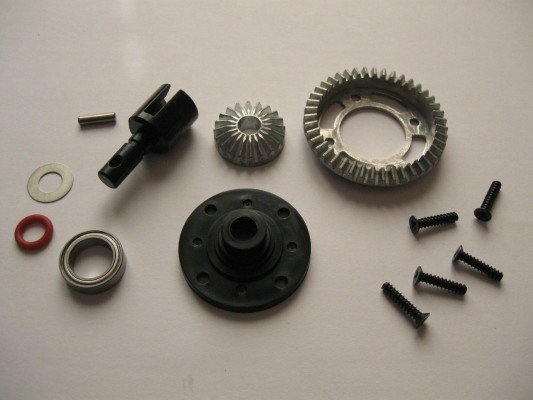

#7 Posted : 24 July 2013 11:28:12

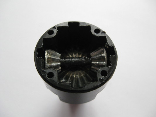

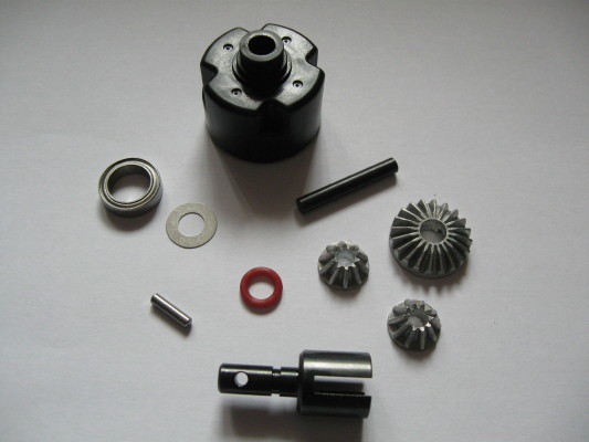

Stage 23 - Front differential parts.
The front differential is assembled in a similar way to the rear differential assembled at stage 5. Therefore I won't repeat the description other than to provide final assembly images.
Thats its for this stage.
#8 Posted : 24 July 2013 11:29:47
Stage 24 - Contains differential parts.
The front differential is assembled in a similar way to the rear differential asselmled at stage 6. Therefore I won't repeat the build description other than to provide final assembly images.
