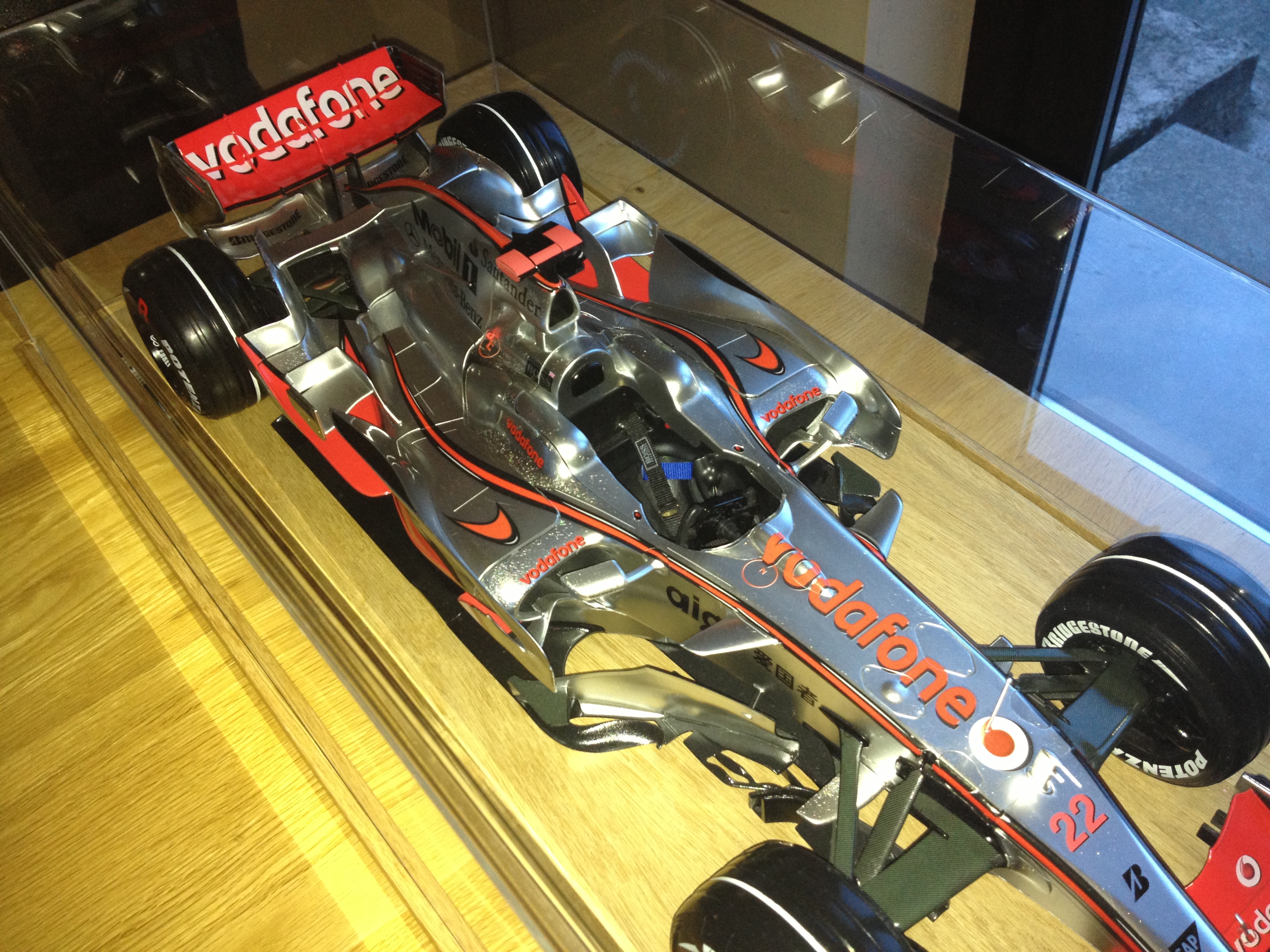

Do not use Tamiya TS-13 on your model as a clear coat.
It looks brilliant at first but after a few months under LED lighting(No heat) and in a display case the paint work has started to crystal.
This was applied in fine even coats as advised but still has had adverse effects on my model.
It looks like I may have to strip down and respray.Mad So Be warned!

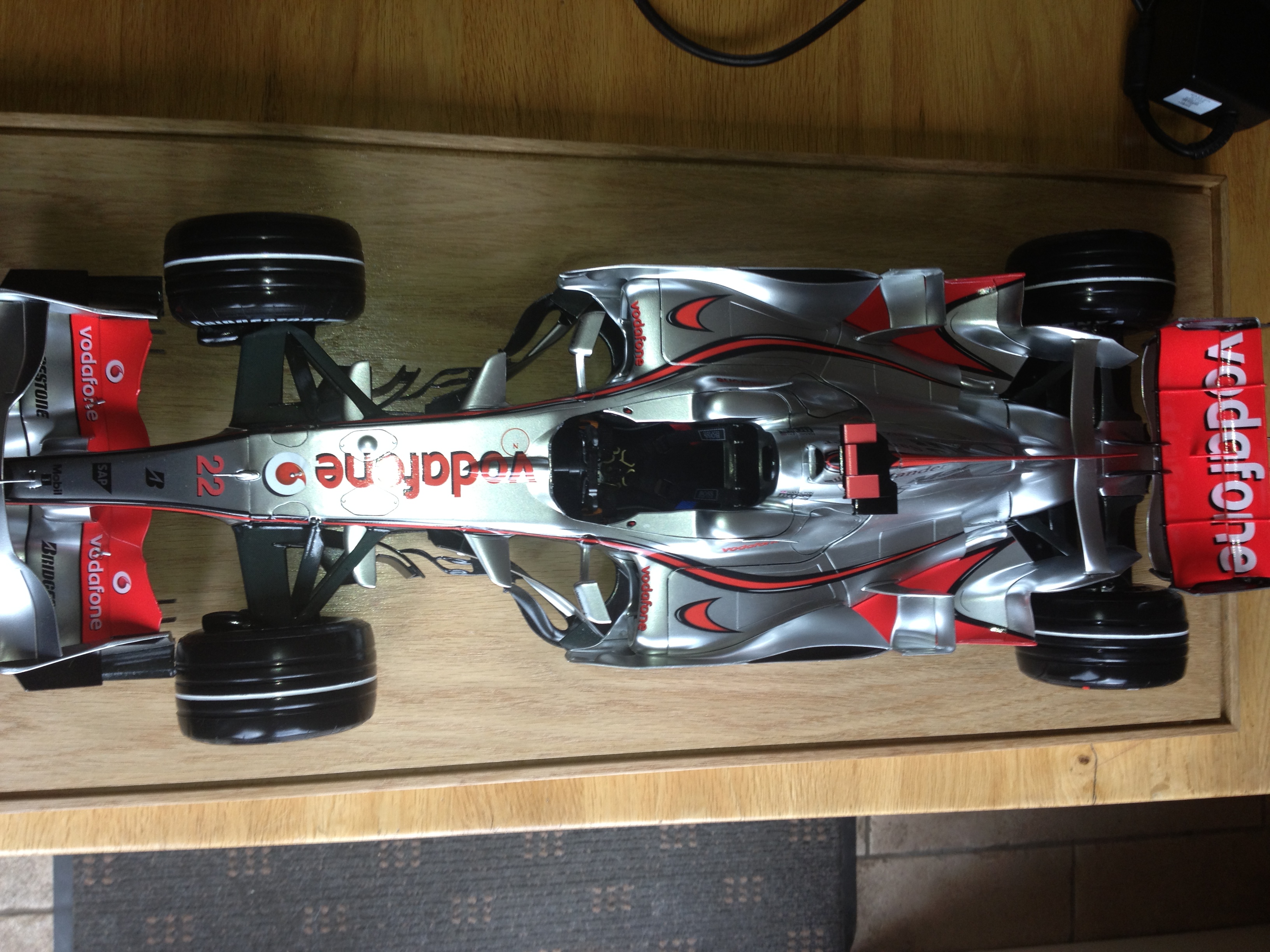

davyp1 attached the following image(s):

You will see from my completed model a few weeks ago that this has got worse over time.
I can only assume that the model that took 1 year plus to build will be destroyed in a few months by the TS-13 spray.

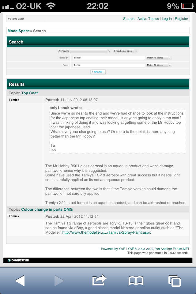

There has been lengthy and numerous discussions in this forum about the type of clear coat to use for this model, where the DeAgostini advice was to use an aqueous (waterbased) clear coat, such as the "MR Hobby B501" aerosol product. Its also been stated a number of times that TS-13 is not an aqueous product.
You will find one or two members that tested the TS-13 product on front nose parts and reported success, though it is good to have you warning about your experience of having used it. However, you will notice in your copy that I said it could damage paintwork, and I have also mentioned in many instances about using an aqueous clearcoat and the Mr Hobby product, also my diary build provides a link to the PDF information about "glossing your model" which is noted at Issue 78 of my build..
http://forum.model-space...aspx?g=posts&t=4830
DeAgostini provided specific "Glossing the car" information within the PDF, which is posted as a sticky at the top of the McLaren discussion page, which states to use a waterbased clearcoat..
http://forum.model-space...aspx?g=posts&t=5133

I've used a 2K clear coat on my large scale E Type Jaguar and the finish is amazing.
A large rattle can is around £9 delivered, goes on in a very fine mist, seems impossible to make the stuff run and dries in 10 minutes, like glass.
I'm tried it on my built-up front wing/nose.
DON'T USE IT!!!!
It turned the silver a dull mottled grey - totally wrecked.
Fortunately, it was my 'spare' front wing.
Amazing gloss though........
Roy.

All Gloss's are good for the right aplication and putting anything apart from an aqueous gloss on any metalic paint that contains fine particles of either silver, gold etc will be affected.. it may not be obvious at first but over time it will react... I've done enough testing with the McLaren and other builds to know and lucky i have had spare parts to test.. I will always do research and testing on any paint before i apply a finish because once you start theres no going back.

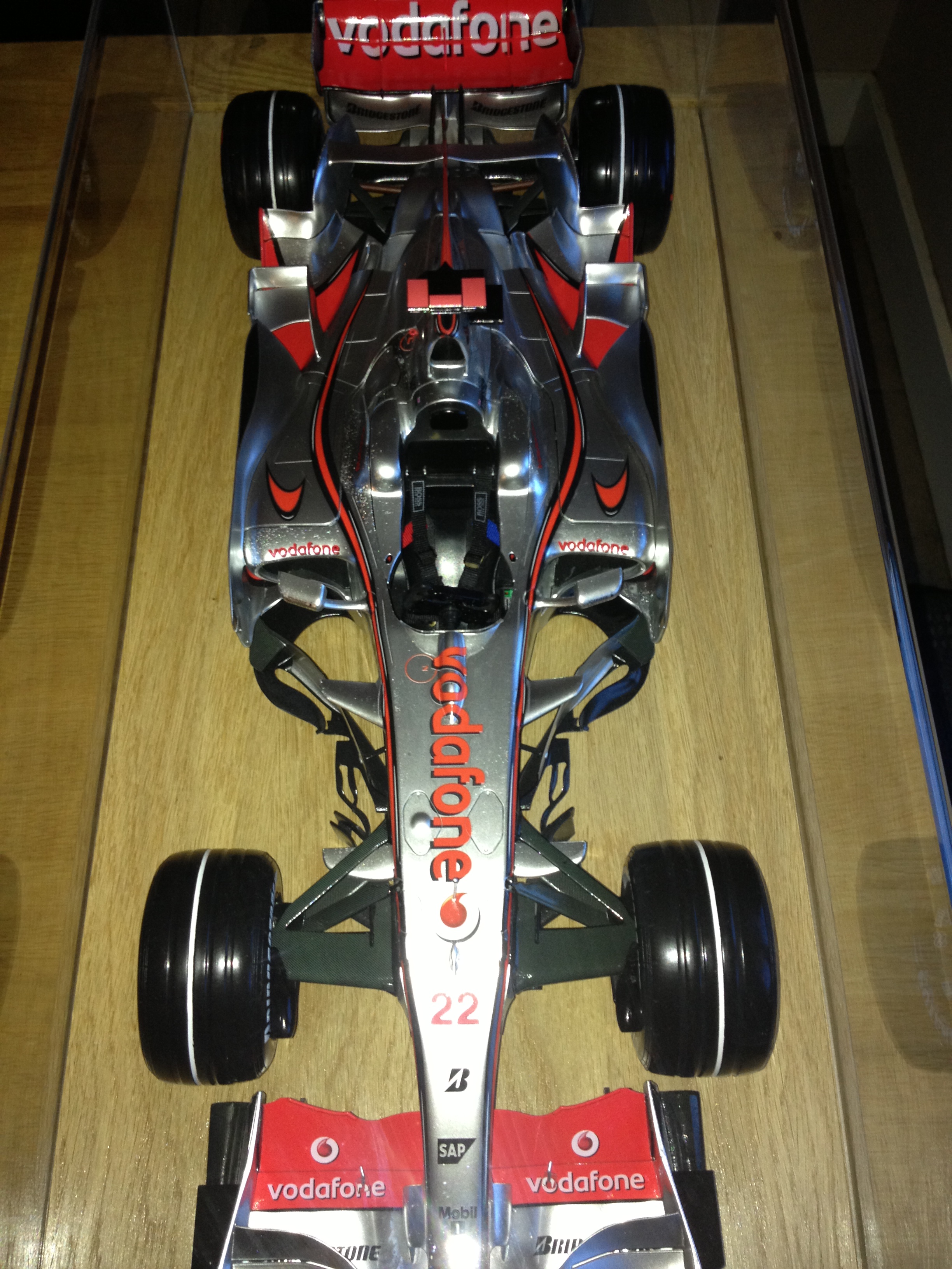

Thanks for the very generous offer again Spencer.I must be the only person on here that cant apply this klear polish.
I applied with soft brush first of all but this didnt leave a even coat and milkly stains present.I tried again with a cloth and this worked better but as appling it was catching everything I was trying to avoid.
1st I knocked off the orange fuel cover ring then caught the rod up the side off the engine cover and took it half off.Cursing
At this stage Im thinking just put it back on the shelf.I think I can live with this at the minute.Ive attached 2 photos as requested.
1 under lights and the other under natural light.
Cant see anything wrong with the model in natural light.
Alougth I would love this model resprayed by yourself spencer I would feel that it wasnt mine anymore if you know what I mean.
