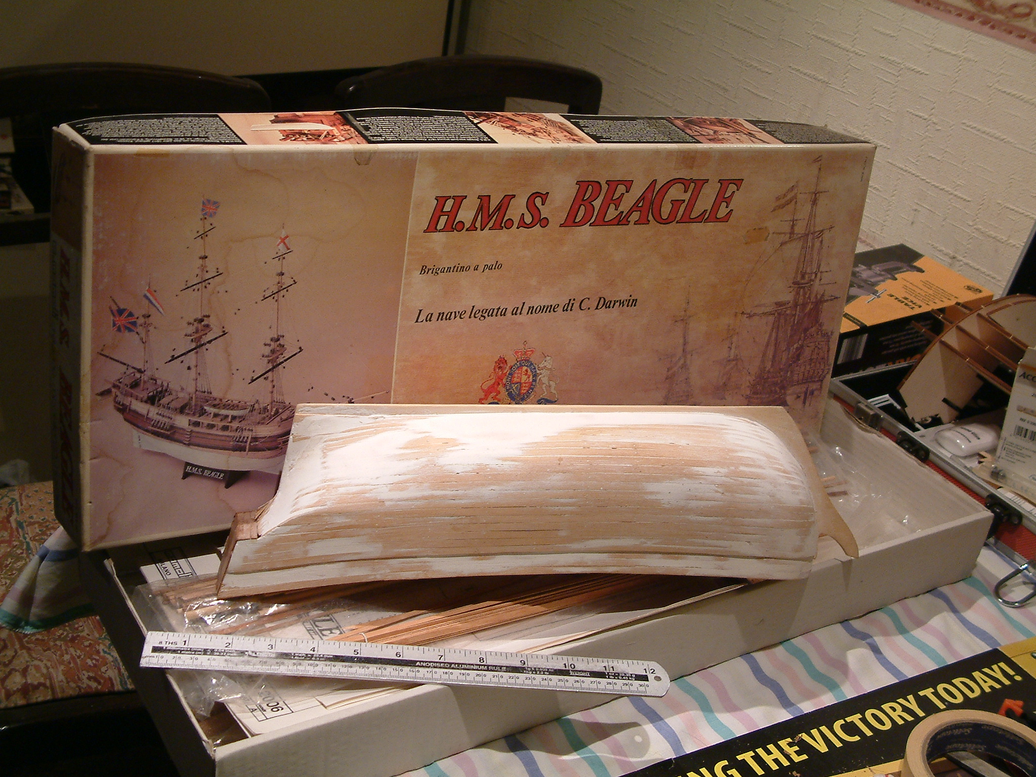

Eureka. I have discovered what I was doing wrong in order to include actual photographs. Talk about short planks!Blushing
Kit box and state at point of build restart showing filler applied to poor primary planking
First 7 planks applied showing use of lancets for clamps
The lancets are supplied for diabetes blood checks by Roche Accu-check Softclix in packs of 200 obtainable from your chemist. They are very sharp.
I was not happy with the tapering of this planking an was starting to give problems at the bows. It was therefore decided to remove the 7 planks and start again.
This was done by soaking the planks with water plus a little washing up liquid to help the wetting. The planks were then eased off with the pack of a scalpel. The filler tended to come away with the planks.
Back to square one! The hull after planking removed. The filling needs to be redone.
The stern after planking removed showing the poor primary planking. More filler!!
Watch for the next post where I shall be attempting to follow the Planking for Beginners tutorial after filling and sanding back.
