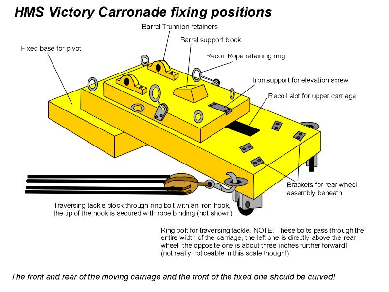

I've just checked the diagrams of the carronade in my Alan McGowan Victory book and the result is as follows:
The rear blocks that you mention are for the traversing tackle which basically moves the carriage rear left or right to aim the weapon. In the diagram the anchor point for these blocks is directly over the little rear wheels on the vertical side of the carriage. The block is attached to a ring bolt via a metal hook which means the actual block is about one and a half 'block lengths' in front of the ring bolt.
In operation there would be no problem with the carriage running over the ropes as the ropes on whichever side the carriage was moving towards would have to be taut literally pulling the carriage towards them so they would be up off the deck away from the wheels.
The tackle shown in Karls super photo is the recoil tackle, used to run the carronade back to it's firing position. Strangely, that tackle doesn't appear at all in the diagrams! BigGrin
Hope this helps
Robin

Unfortunately I only got the first issue of the Victory so I don't have the pics you refer to. I'll try and draw up a diagram from my ref book over the weekend (so I don't break any copyrights) to illustrate how it looks in the book. That should show it much easier than describing it in words.

BigGrin That`s just what I needed thanks. All be it in the distance it does show the block mounting eyelet at least above the wheel/maybe slightly behind, certainly not in front as per the mag.

Just finished the drawing! Hopefully with Karl's photos this should show you how the damned thing goes together!
Best of luck!
Robin

Absolutely brilliant, many many thanks Robin. That is most appreciated mate, have had to cure another problem with the basic build of the carronade with the parts supplied, in that the forward mounting block was only half the thickness it should have been in comparison with the depth of the rear wheel assembly. Used a bit of scrap to double the thickness of the part and now the long base plate will sit level to the deck.
Once again many thanks for your efforts,
