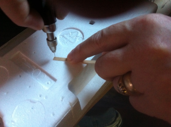

Having cut some planks to the correct size drill two holes in each end of them. I done this with a 0.4mm drill bit whilst holding the plank on to some polystyrene, it stopped planks splitting or breaking. I also passed the drill through from both sides so as to aid the flow of dye for the tree nailing.Pic 1

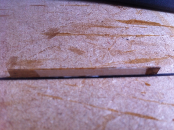

Next you need to cut some very thin strips of the black paper.(new blade time).Pic 2

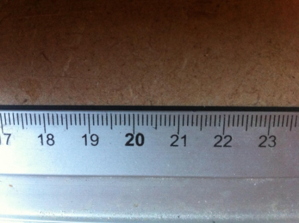

Now sticking thin paper to thin wood is Cursing work. So I used the following method with masking tape.
Stick one end to the board, flatten and stretch the strip out carefully and stick down other end.Pic 3

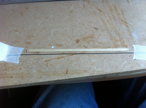

I then very slightly watered down some PVA to assist adhesion between wood and paper. This was then brushed along the appropriate edge of the plank which was then placed on the paper strip. (Make sure the side of the plank to be the top is as close to the edge of the paper strip as possible).Pic 4
You can now cut one end of the paper flush to the end of the plank and cut the other end leaving enough paper strip to cover the end.( Which way round you cut the strip depends on which way the plank will be laid). Now brush PVA on the plank end and stick the paper to it.Trim when dry.

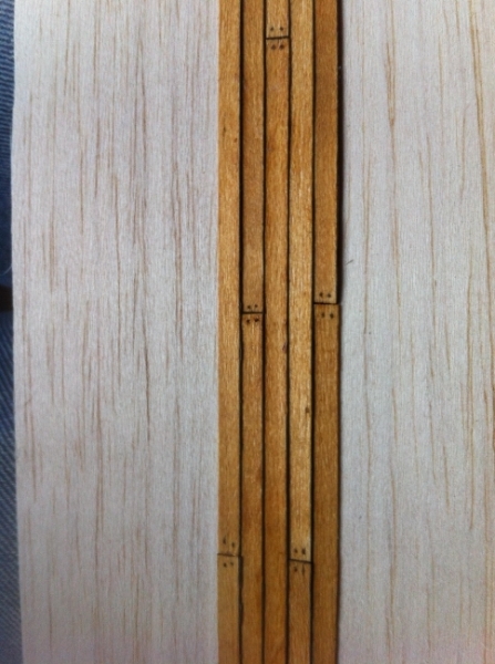

When you have marked up the deck to be planked you can stick down the planking. the deck is stained natural oak.Here is a test plate I have produced, please note: as this is for demonstration purposes only it has not been sanded or varnished, you will notice some high spots of paper above the deck planks.Pic 5
