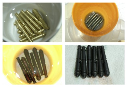

#3 Posted : 27 September 2011 19:14:38
Hi Stuart,
Here is the said tutorial..( I Leave mine for a few hours but if stubborn over night is ok.)
Firstly, You need to buy blackener, mine was from CMB. Also some Alchol solution or degreaser. I use Isopropyl Alcohol from the chemists(Only from Chemists as its very inflammable and is used in explossives so is only sold in 1/2 litre bottles).Also needed are various sized plastic only pots/cups or tubs.
First you need to put your brass parts in the Alcohol for 10 minutes and swish around to degrease them.
Then prepare your solution which is mixed 1:1 with water. The weaker the solution the lighter the Black. Hot water Activates the process quicker but don't boil the solution.(cold water slow process/warm water faster process).
Next put the Brass part into clean water and move around and lightly scrub the part.Being careful not to handle too much.
Remove from the water and put into the solution wet. Stir the part around with WOODEN spatular( Plank in my case). Leave for 15 minute stirring every now and then. check for coverage and leave for longer if required.
Personally I got a jug of hot water. My solution was in a plastic cup so I sat it on the water so it warmed the solution.
Once coloured to the shade required remove the part from the solution with tweezers or long nose pliers and rinse in cold water. Place on paper towel until dry. You will notice a black powdery coating get a small soft cloth an Buff the part which will uncover your hard work.
Chris...
BEWARE>>>>>> The solution is toxic so follow the instructions provided for the handling of the solution>>>>>>>
